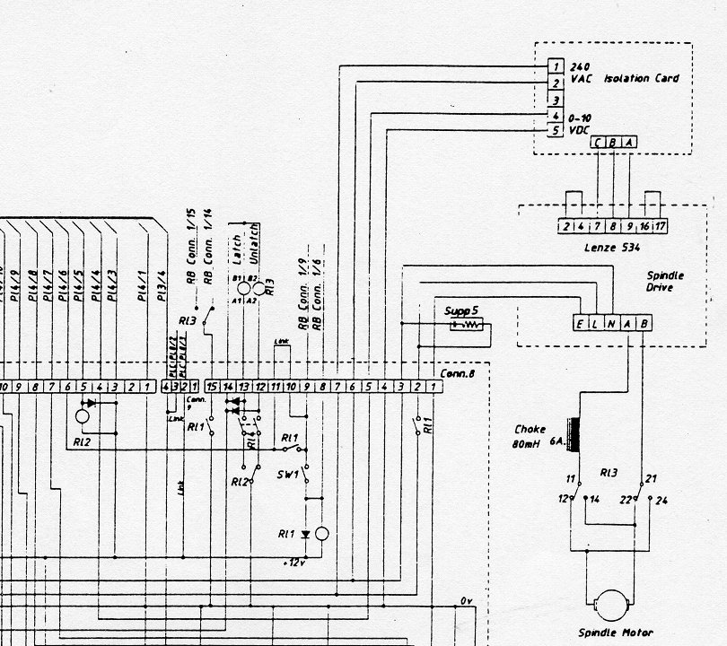

    Have just bought one of these .
    Am told all the motions work manually but Boxford wont support it with suitable software . So conversion to Mach or whatever is required
    Presuming the existing steppers are working is it just a question of changing the input software or is there something mysterious required .

    I've got 2 of these and both of them have had the Boxford bespoke controller and driver boards removed. The only thing that is re-used on one them is the spindle DC speed controller and PSU etc. This also depends which DC speed controller they fitted.!
    The other has had everything removed, including the DC motor which as been replaced by a standard AC motor and run form a VFD. I didn't do this and I wouldn't recommend it because it's a unsightly mess that is hacked onto the side.
    If you look around I think some folks have managed to Hack into the Boxford boards but the cost of 2 new drives and a cheap BOB (break out board) are not worth the bother IMO. If you use Linux CNC for the control software which is free then for less than £50 you could be up and running.

    Yes couple of drives and a BOB will see it converted so it can be used on more modern controller.
    The spindle drive is a little more complex and depends on the Spindle controller fitted to what's needed to make it work. You have to be very careful with these speed controllers because they are unforgiving regards wiring errors and wrong voltages etc, also they often run at Mains potential so very easy to damage other components and High risk of electrocution if start sticking fingers in wrong places.!!
    One of the machines I stripped out because all the boards are bespoke to Boxford and couldn't be bothered to mess around hacking wires, so the only thing I've re-used is the Spindle controller and PSU, contactors, relays etc. This runs or it will do when I get around to it on Mach3.
    The other came to me converted but was in a shocking state and that one had the hacked on motor. It's currently being tidied up and setup to work with Linux CNC by the Linux CNC maestro and all around good egg Clives S because he likes a nice project and it's got ATC for him top play with.

    This the problem with these Boxford machines.! They come with different cards and setups, this one is completely different to the one I stripped out. I've got a feeling this one you can break into the top board which as the drives on it, the bottom board is the controller which you just leave in place.
    I've also got a feeling the Lanze speed controller can not easily be re-used because it's got it's on interface card which talks to the Boxford controller but I'm not 100% on that.
    I suggest you go look on the Boxford forum and look for some wiring diagrams or info on which pins are for the step and direction. Or like I did just pull it all out and fit new drives with a £5 BOB, just some of the cheap TB based drivers are more than good enough for these little machines and you can get them for about £10 each.

    Hi
    The lenze board looks to be a 536 ,manuals are online google, the board on the front of the lenze controller is a optoisolator board, and is easy to connect to ,you need a 10v output on your breakout board, this goes to the 10v and 0v terminals on the opto board. there is a inhibit input i connected it to the Emergancy stop switch, i also had the mains to the speed board run through a relay, switched from the control panel.
    see that big relay in the middle leave it in and you can simply wire the input to two relays. you basically want to wire the outputs of the new relay to the inputs of relay to the inputs of the large changeover relay,
    The new relay input you can take from your bob using the spindle dir connector..
    You can either use the original transformer or replace it with a power supply, leave the choke in.
    close the back of the lathe, turn the rotary switch at the top of the rear door, if all is well, there is a circuit breaker just below the mains socket on the rear door of the lathe, you will need to reset it, if that goes well.
    If all is well turn off all the control panel switches , depress the red button(emergency stop switch), release the E stop button you may get a few clunks thats just the relays, press the on/ off switch on the control panel , if it all lights up sweet, then press wither of the x or z jog buttons(make sure the pot on the control panel is at zero(ish).then try the motor ,simply press the fwd or reverse buttons a couple of times, each press speeds it up or slows it down.
    In the auction pics it looks like a fuse is missing just behind the large capacitor, so replace that before you do anything else.
    Don't rip out all the wiring as it' mostly still useable. Replace the mains cable , leave the, control panel wiring in as it make wiring it bac up easier, also leave the interlock wiring as again it's easier to wire.
    i have a few files that i will try and find to upload here one is a partial wiring diagram, which will help in wiring the speed controller..
    the main board on yours looks different to the ones I've seen (i think it was pot luck, if all the components were on the boards ;) .
