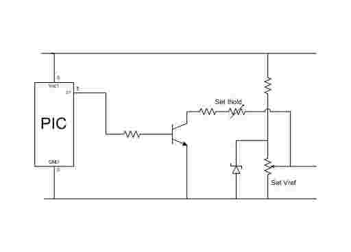

    Thanks for the very kind offer, Unfortunatly I have no idea where to start with the code. I can only guess that an output needs to modulate (or switch low) the vref line to set the hold current (possibly adjustable from a trim pot) and then an input needs to look for the clock pulse to reset full current when a signal is seen?
    I would imagine that the timing's are going to be the hardest bit as it might loss the first step whilst switching back to full current?
    Is there any reason why this couldnt be put on a separate board and just send the Vref lineto the driver board with the other signals?

    Looking at his (later) reply with the rough idea of the code, that looks sane to me, and roughly how I'd go about it.
    INT0 would be the interrupt from the INT pin; INT1 would be the Timer0/1 interrupt.
    DIP switches for the timeout's a neat idea - especially if it'll be used by someone who doesn't have reprogramming capability.
    I have a slight concerna about using the PWM - if the PWM controls the direction control (i.e. oscillates between output 0 and open-collector), then that would be fine. However, from memory, it'll only oscillate between 0 and 1, then you'd need to be careful of the PWM pulse width - you could end up going too high with the VREF signal. Still doable though.

  2. Quote Originally Posted by tribbles View Post
    There's nothing stopping you from putting it on a separate board.
    Depends on the chip and whether an O/C output is available. If not, a single NPN small signal transistor and base resistor on the output would suffice.
    Having said that, if you are using a transistor, why not put a trimmer on the output side and not use PWM at all... would simplify the code and you could adjust the holding current to your hearts content.

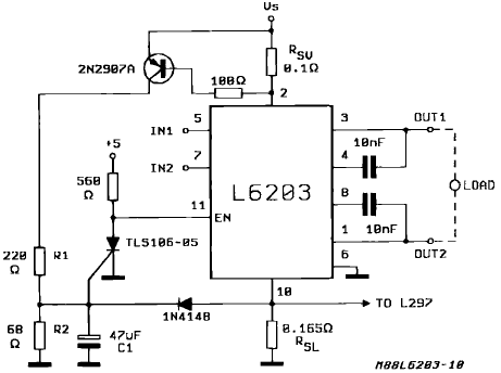

    Thanks graffian, I think I was about to make that mistake. I'll have to look for that thread, will it still apply to the L297?
    Wouldnt this then be the same as using a 555?
    From what I remember, Mariss had just noticed the A3986 thread and it started with a comment he could programme a CPLD, pretty much as the gecko stepper drives minus mid band resonance, to do what the A3986 was meant to do. Then another post suggested he would be able to sell them for $5! I imagine you would drive bridge drivers[ir2184?] from the cpld?
