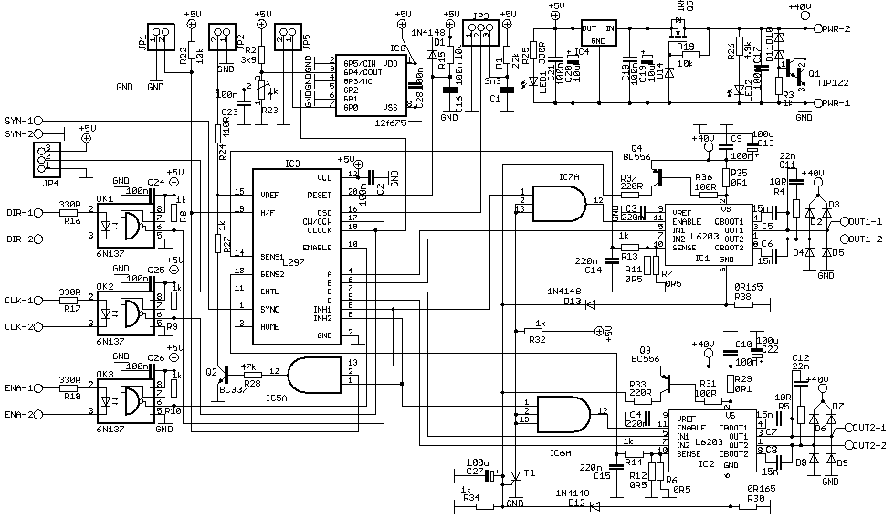

    Thanks Irving, Is that an offer to create the code? :clap:
    I have a programmer that I bought many years ago, but never built, that supports that chip. So the final decision is wether to include the short cuircuit protection as it dose complicate the board a tad. Is it really worth the hassel? I first thought it was also an internal overload but after finding the application sheet it is only for output short circuit, maybe I'll just have to be carefull with the motor wiring :whistling:

    I'd use the 12F675 (or possibly 12F629, which is the same as the 12F675, except doesn't have the A2D converters) - the 16F84 is significantly larger than needed (only 2 of the IO pins are required), and also needs an external oscillator.
    10F20x doesn't have an INT input, so I'd discount them (although there's nothing stopping you from polling an IO pin instead of waiting for the interrupt signal).
    I've got some spare 12F683s from a project I didn't need them for - they're similar to the '675, except have a PWM output capability (I was going to use them for a fan speed controller).
    I'd be willing to program one up and send it on - but I'd feel a little uncomfortable doing the code without knowing exactly how it's meant to work (willing to discuss it though).

    Wow thanks guys, thats a great help, now if i could just get someone to convert the schematic to a pcb and mill it for me.....:lmao:
    Irving
    The short circuit protection is for the the output chips, (see below)
    Tribbles
    Thanks for the very kind offer, Unfortunatly I have no idea where to start with the code. I can only guess that an output needs to modulate (or switch low) the vref line to set the hold current (possibly adjustable from a trim pot) and then an input needs to look for the clock pulse to reset full current when a signal is seen?
    I would imagine that the timing's are going to be the hardest bit as it might loss the first step whilst switching back to full current?
    Is there any reason why this couldnt be put on a separate board and just send the Vref lineto the driver board with the other signals?
    Thanks again

  5. Well lets think this through...
    Whats the slowest meaningful step rate, 1 step/second? how long after the last step do we want to wait, 10 seconds?
    So every time there is a clock pulse, reload an 'n' second counter. when the counter reaches 0 start a PWM output with a frequency of 100Hz say, and a mark/space ratio controlled from 2 dip switches giving 100 (off), 75, 50 and 25 settings
    Use a couple more DIP switches to set the initial delay 'n', say 20, 10, 5, 2 seconds.
    Pseudocode:
    Interrupt routines:
    If INT0 (external)
    read delay value
    reset main counter to delay value
    set PWM output high (open collector)
    reset INT0
    return
    If INT1 (main counter reached 0)
    read PWM value
    initialise PWN registers
    start PWM running
    reset INT1
    return
    Main program:
    set PWM frequency
    set PWM output high
    configure counter clock divider
    configure INT0 on external trailing edge
    configure INT1 on counter timeout
    read delay value
    enable INT0
    enable INT1
    halt
    obviously, depending on the chip used you may have to synthesise the PWM function with counters and a lookup table to determine the correct counts for each DIP setting.
    I can do the conversion of the schematic - I've done a fair number of PCBs myself (using Eagle PCB). Just send me the schematic, an idea as to what size you want (and also any heatsinks - most of the stuff I do is low-current digital, although the fan control was high current).
    However, milling it... I photo-etch them myself, since I have the capability.
    Thanks again
    I actually meant discuss with Irving
    Looking at his (later) reply with the rough idea of the code, that looks sane to me, and roughly how I'd go about it.
    INT0 would be the interrupt from the INT pin; INT1 would be the Timer0/1 interrupt.
    DIP switches for the timeout's a neat idea - especially if it'll be used by someone who doesn't have reprogramming capability.
    I have a slight concerna about using the PWM - if the PWM controls the direction control (i.e. oscillates between output 0 and open-collector), then that would be fine. However, from memory, it'll only oscillate between 0 and 1, then you'd need to be careful of the PWM pulse width - you could end up going too high with the VREF signal. Still doable though.
    There's nothing stopping you from putting it on a separate board.
  9. Quote Originally Posted by tribbles View Post
    Depends on the chip and whether an O/C output is available. If not, a single NPN small signal transistor and base resistor on the output would suffice.
    Having said that, if you are using a transistor, why not put a trimmer on the output side and not use PWM at all... would simplify the code and you could adjust the holding current to your hearts content.

    Thanks graffian, I think I was about to make that mistake. I'll have to look for that thread, will it still apply to the L297?
    I will definatly take you up on that offer, If you make the board bigger than 4"x3" will i be able to veiw and output it myself? Good info on the PCB fabrication but think it will be too costly for a one off, as i plan to mill future pcbs.
    You've got me sussed, I'll go and sit in the corner then.:heehee:
    Wouldnt this then be the same as using a 555?
