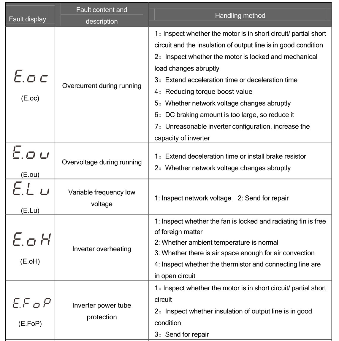

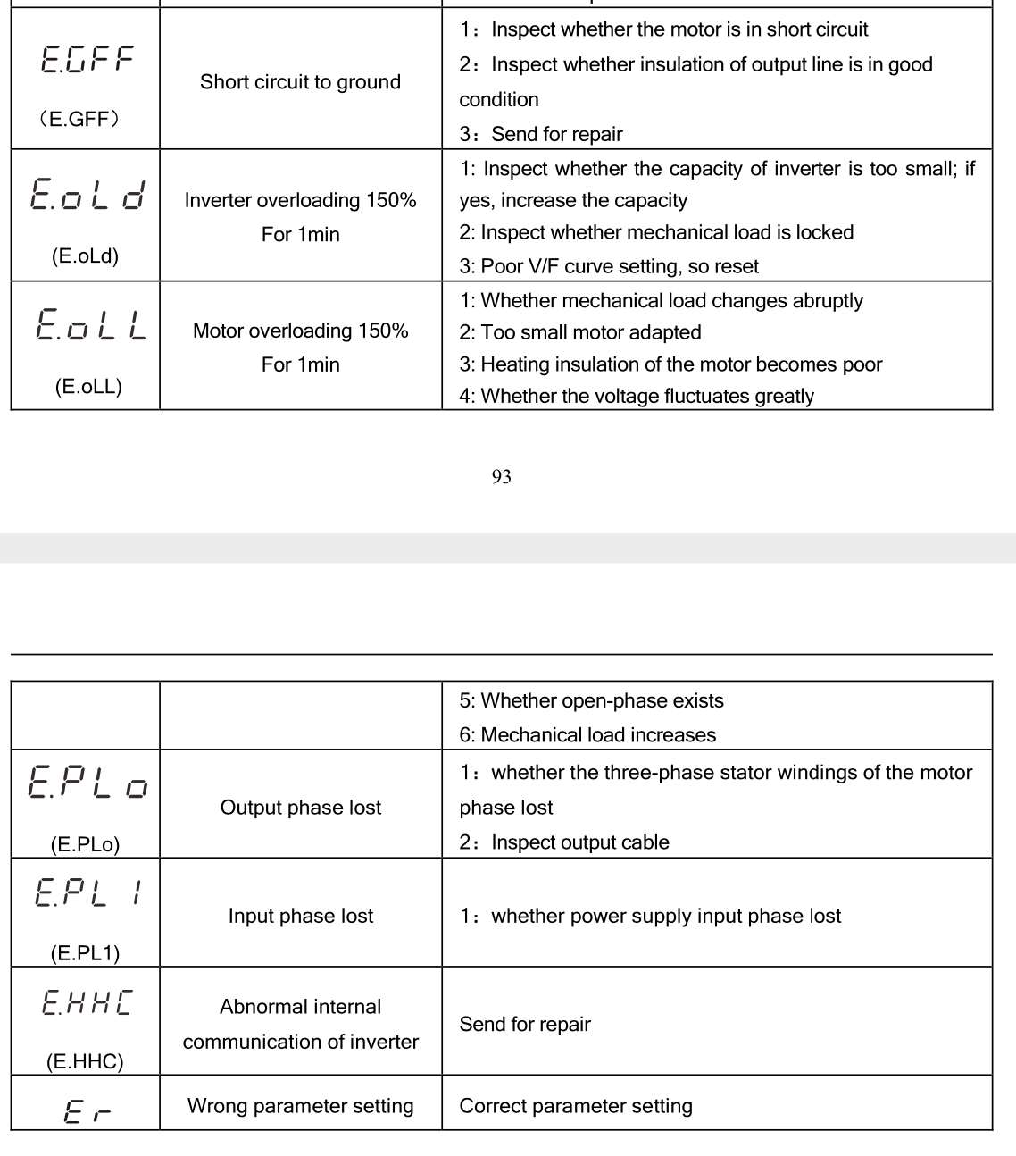

    Thanks - that makes sense (although clearly not what we want). My problem is that you earlier said e-stop, where the manual (if applicable - and that's by no means certain) only indicates the following messages on the 4-digit display...
Name:	Screenshot 2020-09-04 at 20.27.07.png
    ...and...
Name:	Screenshot 2020-09-04 at 20.27.20.png
    Is it possible that the display indicates one of these (left column) rather than "e-stop"?
