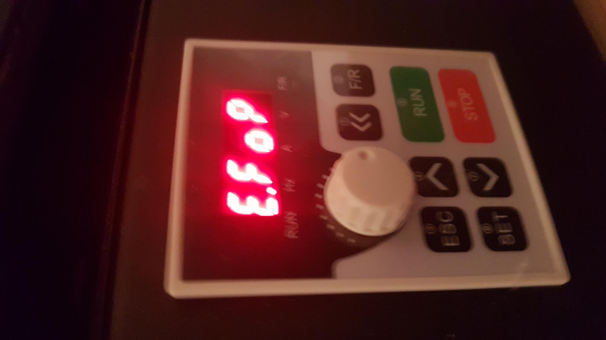

    I blew my multi meter a few weeks ago and am confident using one , but i also remember when i removed the cover of the black box VFD to take photos to post i un plugged it from the mains supply but there was a red neon light flashing on the BOB even though there was no power lead connected and even after 30 minutes it was still flashing so i am now asking myself in the name of safety should i just write to the company and say replace the box as there is an issue of a thousand pounds exchanging hands. your thoughts would be appreciated on this
    Doddy's Avatar
    Lives in Preston, United Kingdom. Last Activity: 4 Weeks Ago Has been a member for 9-10 years. Has a total post count of 1,364. Received thanks 188 times, giving thanks to others 66 times. Referred 1 members to the community.
    I think if that avenue is open, that would be an eminently sensible thing to do.
    Explain the Error Code on the VFD and the shock experienced from touching the metalwork of the machine.
    You could chase down the fault, replace bits, etc, but at the end of the day this is still the suppliers responsibility.
    The red flashing neon (LED?) could be the BoB powering from the USB interface - if still connected to the computer. If so, I wouldn't worry too much and wouldn't pollute the conversation with the supplier with that bit of info.

    Entirely possible. My thoughts are varied but includes insulation breakdown or stray wire from phase pin on the connector to the spindle housing.
    I'd pull it apart, but I wouldn't recommend others to try.
    The next test was to be a continuity test between the phase outputs on the VFD, then upstream to the spindle harness then the pins on the spindle, as well as a visual check on the terminal wiring but, again, I wouldn't recommend this if a replacement is an option.

    The Mrs will be using the machine a lot when i am at work and although its a temptation to let her carry on messing with it especially the 3 phase side
    i think its best to shut it down and request another spindle be sent .
    I truly thank you for all your help with this matter and i appreciate the input
