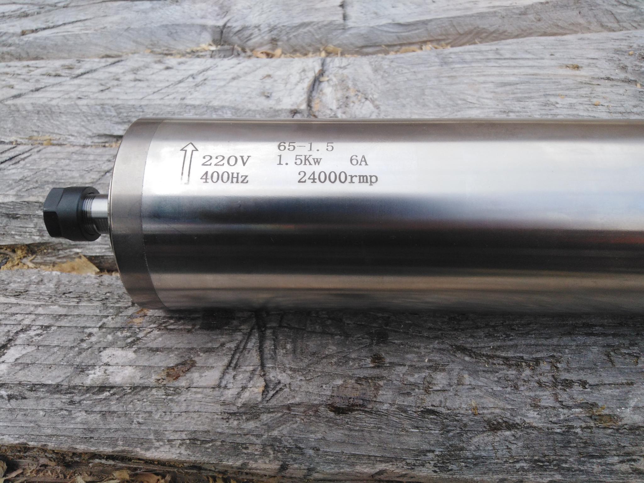

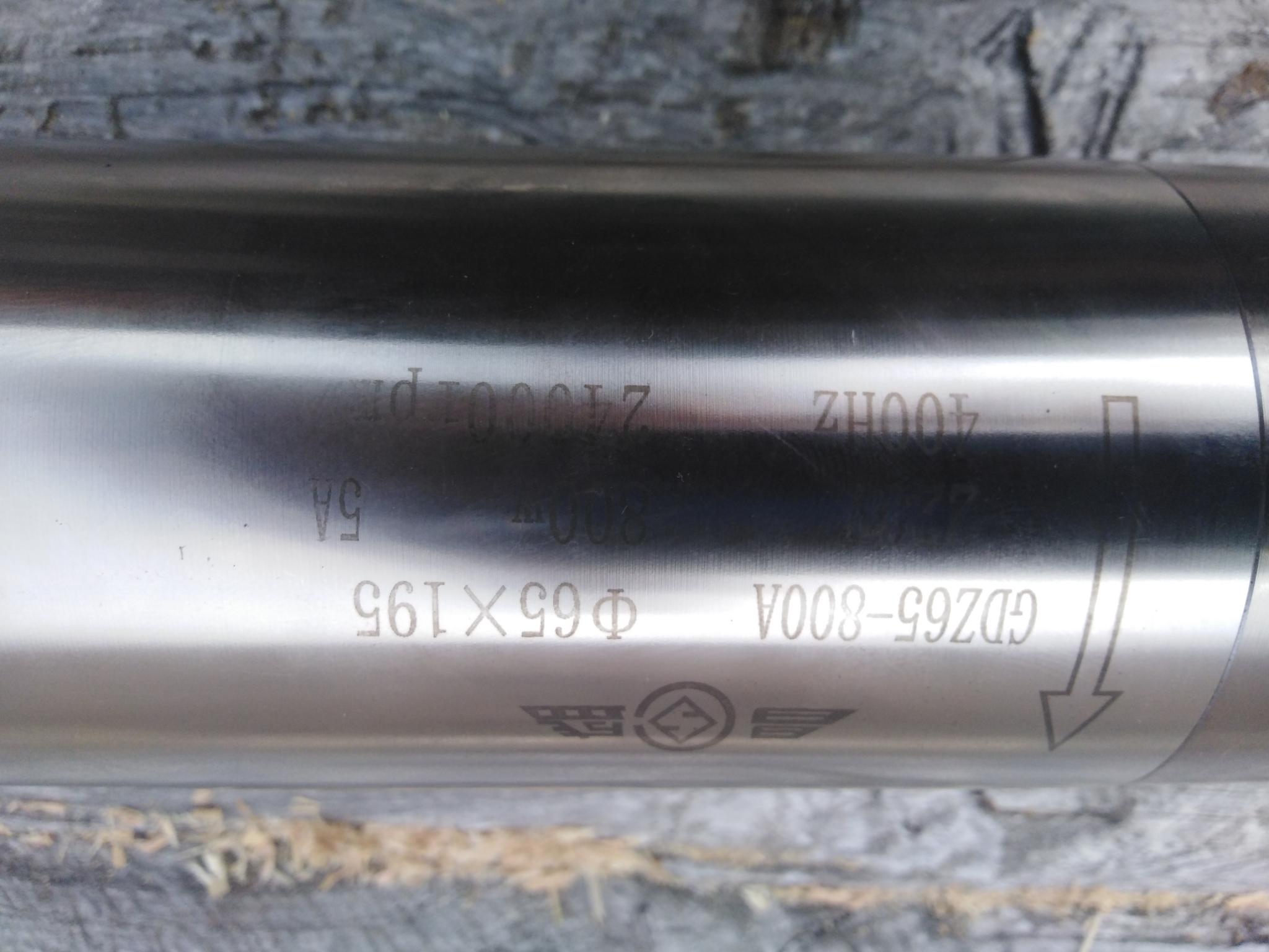

    Got the new spindle come today at last , but as you can see from the photos the old spindle has 4 wires connecting it to the plug but the new one has only 3 so is the 4th wire and earth and it just a case of soldering No 1 wire to pole marked 1 and so on , am not sure on this bit , any ideas please.
    And the new spindle is a 1.5 kw as the other was a 800w one so could i encounter any problems using the more powerful 1.5 kw spindle

    Okay, those two images are the old and the new spindle?... okay, can see the 800W and the new 1.5kW - makes sense.
    The bit that's confused me is that these are 400Hz motors, and the image from the VFD that you provided on the first page of this thread shows that the VFD is rated from 0~300Hz. And the best I can tell from a close-match on the part-number to the NowForever A100 manual (pdf randomly found online) - that's likely rated at around 750W.
    So... I have to ask... who's provided the replacement spindle - was this the original machine vendor?, your last post or so was talking about going back to supplier for a replacement machine?, spindle? If so, did they just supply the 1.5kW spindle?

    I cannot recommend using that new spindle with the VFD that you have. The limited frequency range I can handle (it just means a lower maximum RPM - 18k RPM), but the lower power drive means that you carry significant risk of damaging the VFD.
    There are settable parameters on the VFD that allow you to set motor current - but my feeling is that these are used to trigger the over-current protection, not to limit the motor current.
    The problem now is that you've sourced the spindle - the supplier may be reluctant to support any subsequent change.
    ...unless anyone else knows more about the VFD motor-current settings?

    The frequency is not much of an issue - the spindle is typically a 2-pole motor, which basically means each complete 3-phase cycle1 = 1 revolution. So at 300Hz (300 cycles/sec) = 300 revs/sec. 60 secs in a minute = 18000 revs/min. If you drive at 400Hz, 24000 revs/min. Yes, you can drive the motor at 18000 rpm or 300Hz - that works.
    With the original spindle - the VFD is rated correctly for the 800W spindle (or thereabouts).
    The problem is the new spindle is 1500W, which is likely to damage the VFD. That you can't spin the spindle as quickly as its designed is another issue, but wouldn't damage either spindle or VFD. Why would the supplier provide that VFD?, you'd have to ask them, but usual suspect would be cost.
