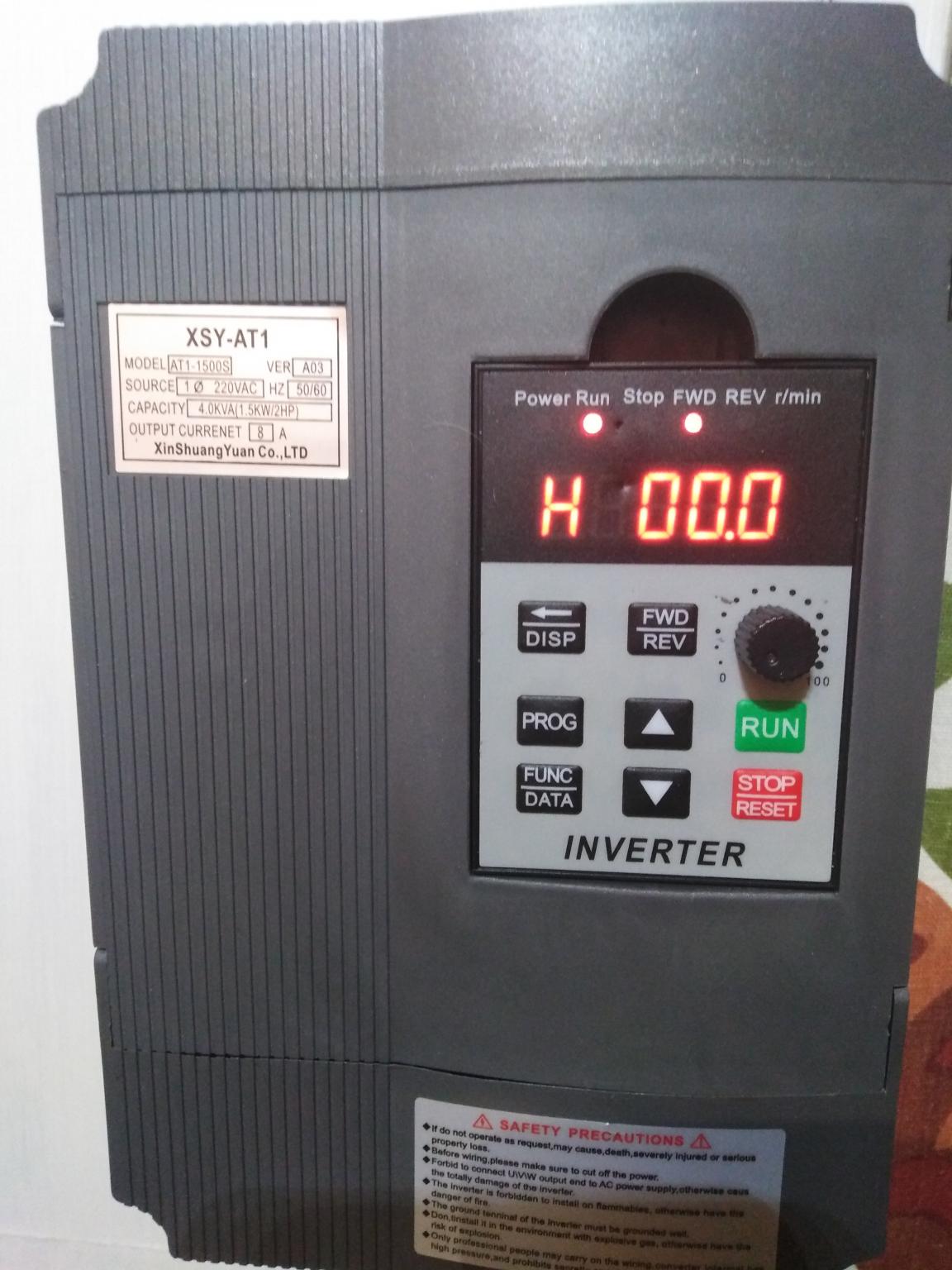

    Thanks Pete, appreciate that took a little time. Similarly it's taken a little time to review that. I can see where you have applied the settings linked in the other post on the same labelled XSY-AT1 VFD. Looking at your photo of your manual - there's some small conflict between your printed manual and the settings in the other thread. It could be that different variants of the XSY-AT1 have different settings - good old Chinese crap.

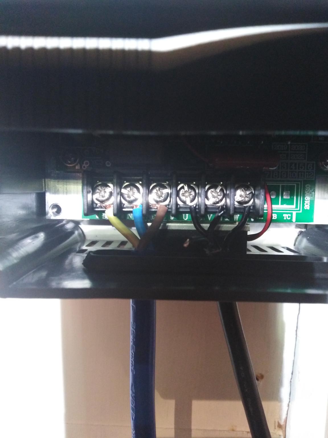

    Am checking my wiring from the start again . I wired as i said 1 to pin 1 2 to pin 2 ect but as another check is there a color code used as in say RED to U or Blue to W and so on
    Hooraaaaaay this poxy chinky spindle has finally started up and spinning and the problem was in the wiring now its running in reverse but that just needs a wire swapping over i am sure ?????? .
    The wiring from the standard black box that came with the machine was all marked from 1 to 4 and no colored wire So for anyone who has bought one of these i sugest you just unscrew the wiring jack on the top of the motor and check fromk the colors if that makes sense and not rely on numerics that someone has written on them .
    But now to swap the wires to get it running the right way .......any ideas please

    Swap any two of the UVW leads to reverse the spindle.
