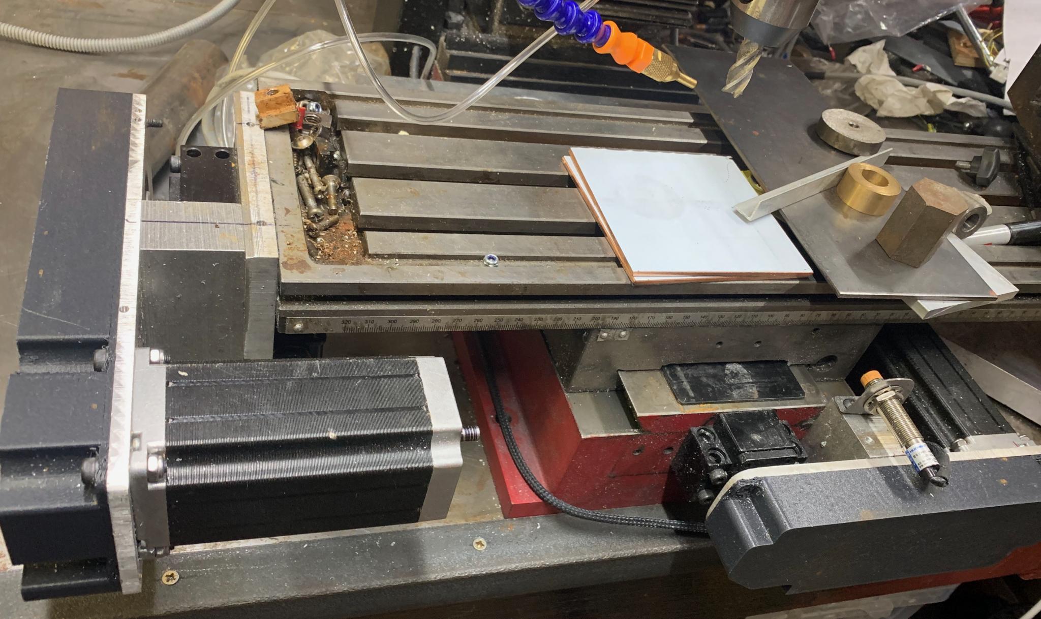

    Belts are designed exactly for this purpose - I run a 2:1 reduction for increased turning force (I was going to say torque), on the screws. It can help to reduce the working footprint (allowing the motor to be mounted inside the existing footprint). Don't worry about belts.
    Personally - standard 1605 ballscrews for me - but I'm a cheapskate (and space was a bit tight under the bed).

    From my point of view, if you are using steppers, they should be direct drive. If you are using servos, you may or may not include a reduction ratio. When I look at typical torque / speed curve for steppers, doubling the motor speed by introducing a 2:1 reduction ratio reduces the motor torque at a given speed by the best part of 50%, so you don't end up much better off. In the meantime, you've lost half your speed.
    With a servo drive, you typically have 3000rpm or so max speed with full torque available. With a direct drive and 5mm pitch, that would be an unusable rapid speed, even for bragging purposes down the pub (15000mm/min). So for a servo, a reduction (somewhere between 2 and 3) seems to make sense. A stepper couldn't pull the skin off a rice pudding at anything near those speeds.
    As for stall force, unless you plan to use your machine as a press, that doesn't seem to be an issue. How much radial force can a tool take before it breaks?

    I realise my explanation about about positioning steppers may be a bit half-hearted (it's been one of those days). Image below hopefully explains - a major drive for me is space so rolling the stepper back into the machine footprint was a big boon. Shown are X and Y axis motors.
