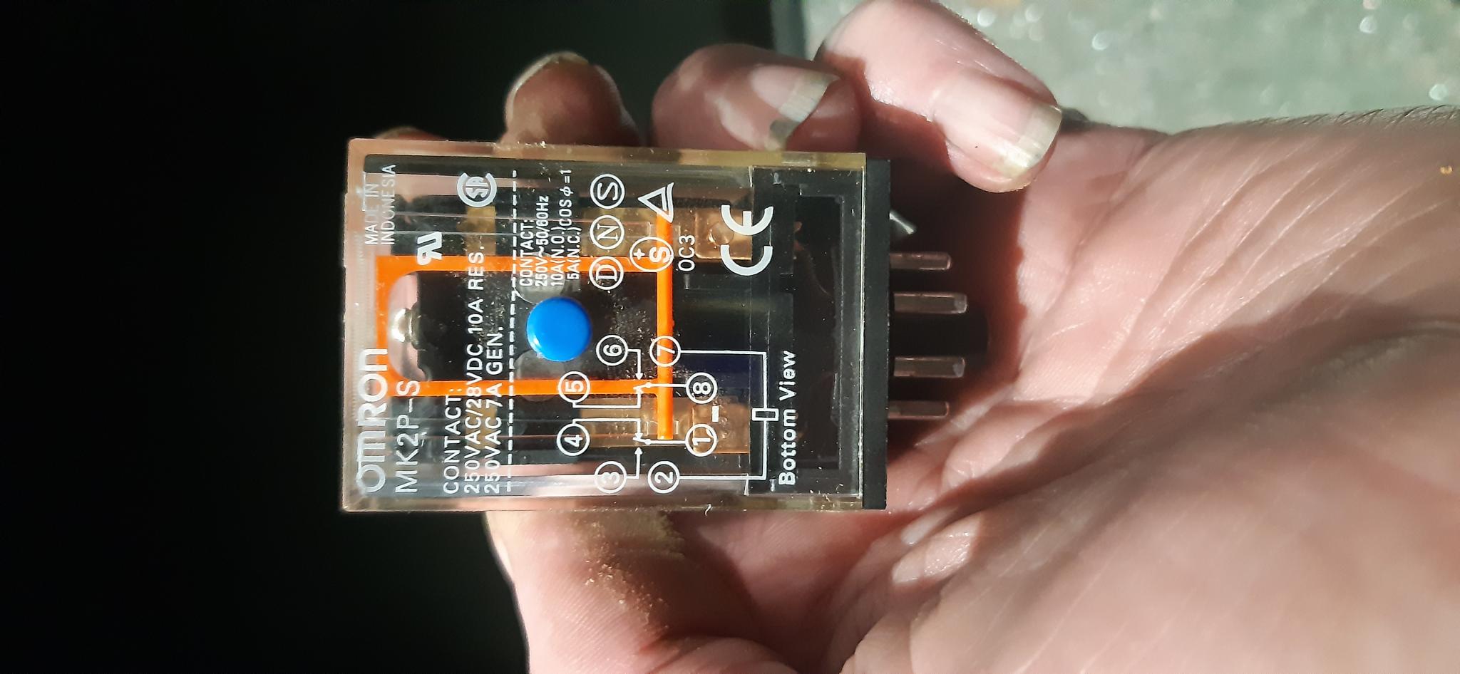

    EDIT: I have found this OMRON MK2P-S relay left over after my retro-fit. With my limited electrical knowledge I think it fits the bill? Click image for larger version.

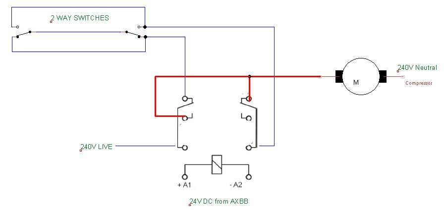

    Something like
Name:	Screenshot 2020-09-21 at 19.21.03.png
    All depends on your use-case. In this example UCCNC simply bypasses the manual switches to force the compressor on. Set the M8 command pin/port on setup/spindle page.
    You would still be able to turn on the compressor with the existing switches, but not turn off the compressor with the switches if enabled by the AXBB.
    That relay?, if it's the right coil voltage and current to suit the AXBB?
    EDIT: You could glam up the circuit but there's a certain KISS approach to the above.

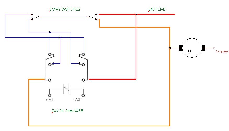

    I had a play and came up with this Click image for larger version.
Name:	compresor with relay.JPG
    It does what your diagram does but also isolates the live from the 2 way switches when UCCNC has control.

    That would give me a circuit like this (I think) you will have to forgive me I have some sort of mental block when it come to even the simplest wiring.

    Doddy - is my circuit in post #5 feasible? If so UCCNC has control so the manual switches have no effect.
    Regarding the compressor being left on I already have a signal lamp which comes on when the compressor is powered - this was put in before the 2 way switches as the compressor was often left running! The lamp is visible from our in workshop CCTV camera and we have a networked smart switch so the compressor can be turned off remotely
