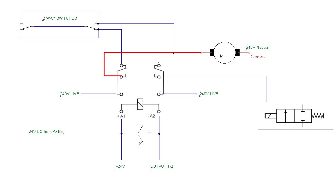

    Ah!, 240VAC coil N/C (powered to open) - from memory.
    I will have to look at my wiring - Click image for larger version.
