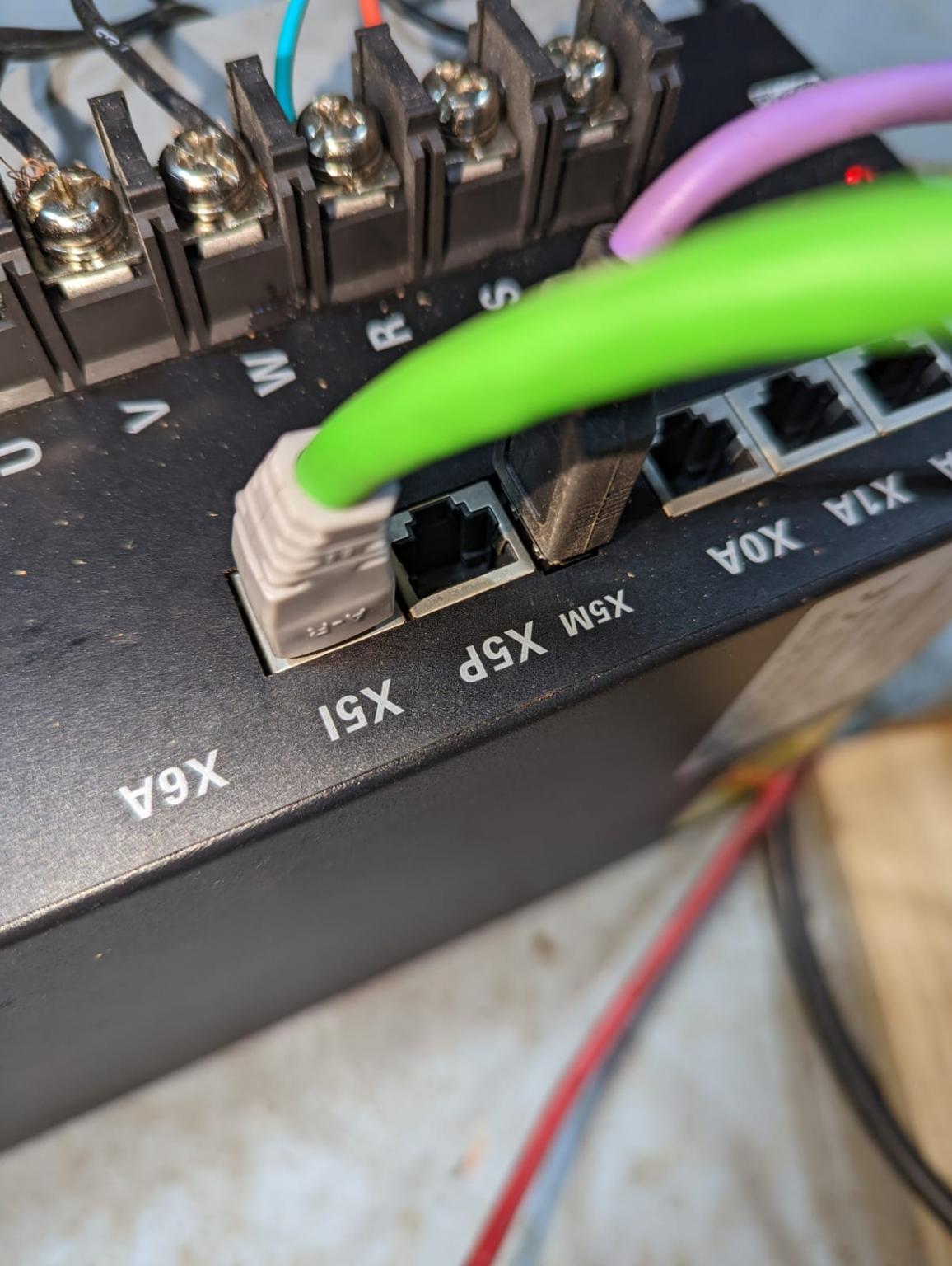

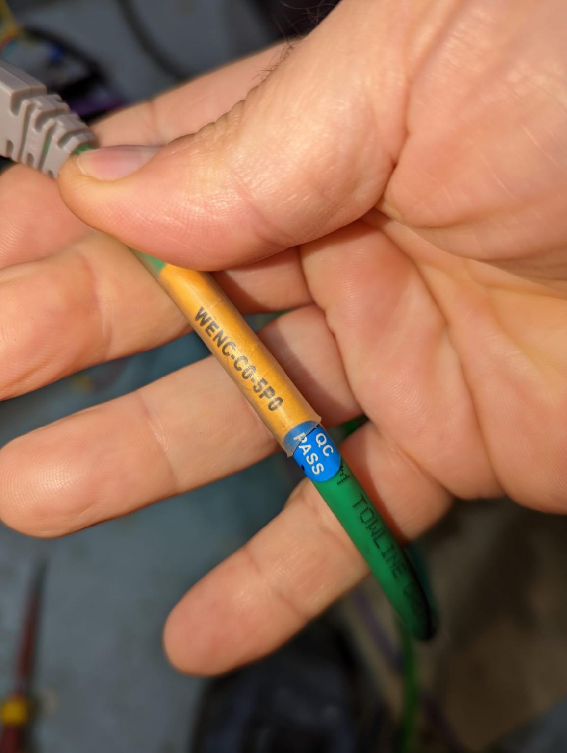

    So here's a clue as to what the issue was (clearly the broken wire was also an issue).
    Lives in East Lothian, United Kingdom. Last Activity: 3 Days Ago Forum Superstar, has done so much to help others, they deserve a medal. Has a total post count of 2,994. Received thanks 376 times, giving thanks to others 9 times.
    I'm sorry, but I've got to say it.
    Idiot!
    But it just proves, always check the basics.
    Chaz's Avatar
    So the cable marked with X5 DOES NOT GO into the X5P.
    It goes into X2A.
    I spotted in the manual that X5P = encoder OUTPUT, so I investigated further. X2A it is. I'm not sure why there is an X5 number on the cable.
    The other X5 cable (X51) is also marked X5 and goes there ....
    Anyways.
    In fairness, there was a wire off as well, so more than 1 problem it seems.

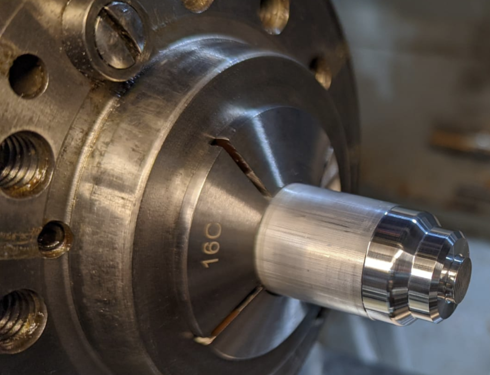

    So, progress. Started to rewire and tidy up the cabinet.
    First test cut (well, 2nd), - ignore the birds nesting, bad feeds / speeds.
    I need to work out why the spindle override is being ignored too. Speeds are being set by G50 S2000 etc. Need to see the details behind this, I'm using the Fanuc Post Processor.
    And then a pic, I missed facing it fully but you get the idea, really happy with this.
