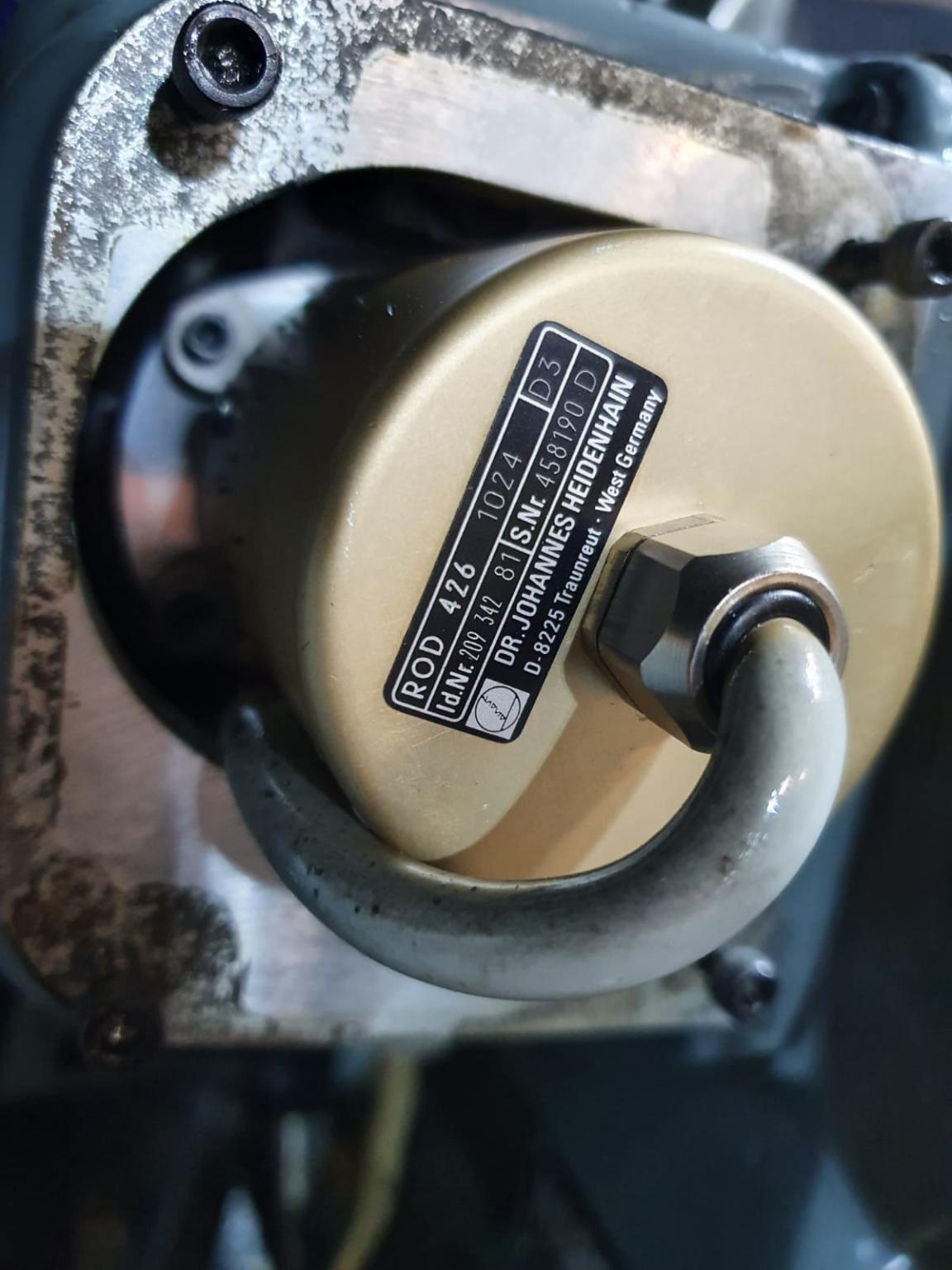

    Quick update - built a temp box out of ply for the controller + MPG plate. Opened up the cover for the encoder and noted that the limits are not hall effect, took a quick video, there is a cam system depressing the limits.
