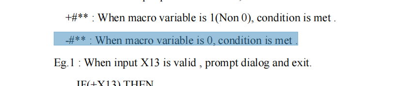

    Just a heads up, for a tool change macro this is a very handy thing :)
