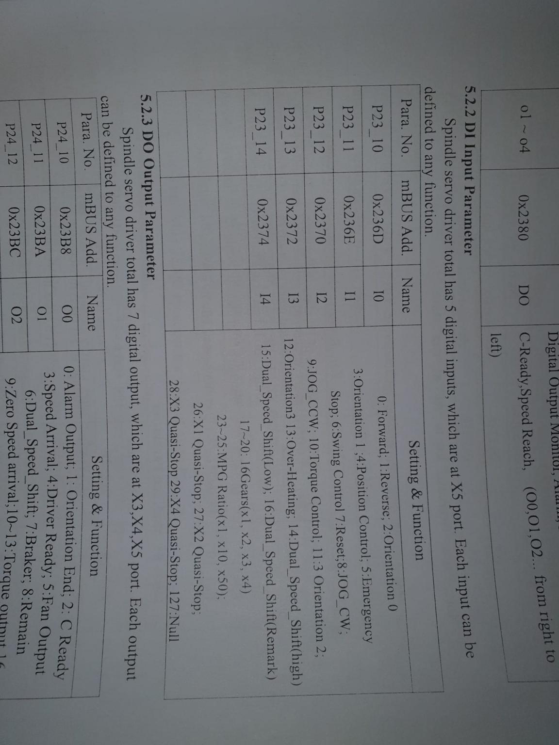

    Chaz's Avatar
    So here I can define Input Parameters. P23_15 was set to 13 (Overheating) but I set it to 127 (Set to Null). The problem is that in the list below, its only P23_10 to P23_14, Ill double check but I dont believe any of them were set to 13 (Overheating monitor).

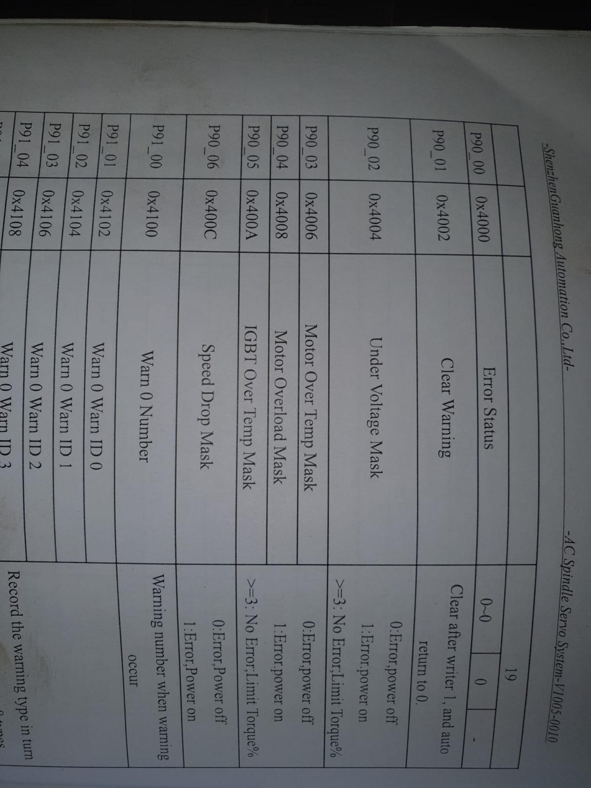

    Chaz's Avatar
    Interesting that in the next section down it says 'add 128 to the number to make it NC type'.
    The only other page I can see something related to motor temps is below.
    My 'reading' of it is as follows ... not sure if that's correct or not.
    P90_03 if its set to 0, it will Error and power off. if its set to 1, it will error but keep power on and 3 or higher it will 'no error, assuming it ignores' but offers limited torque %

  3. #83
    Chaz's Avatar
    So SZGH have confirmed that its a NC contact.
    The mapping goes to P23_25 (port MapToDi15). Ive been told to change this to 127 and disable it, I dont think you would know what port it was mapped to from reading the docs. Ill try that later and see.

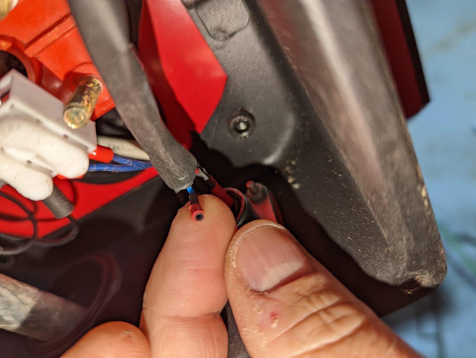

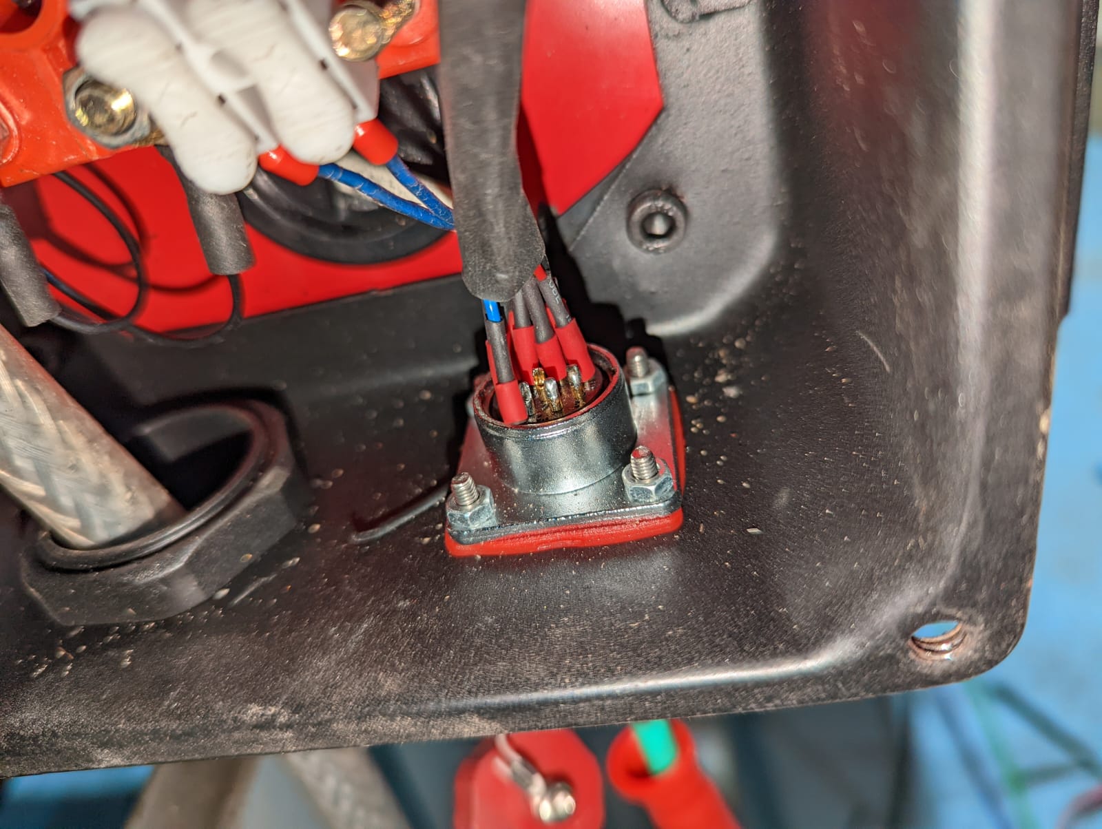

  9. #89
    Chaz's Avatar
    OK, so major progress but sadly no go.
    I checked the connector and rung out the wires from the cannon plug back to the RJ45 connector (but has 10 across, not 8). All looks OK.
    I then found something that explains the issues, a loose wire inside the motor. Joy of joys, would explain why the encoder doesnt work properly and why the motor heat error is needing to be masked.
    So soldered it back together, sadly no change.
    I did figure out how to do the the Op = 2 run again, its all in the sequence. It trips out on an encoder error. I dont remember if it did this before or not as I was getting the over temp error but I think it did the same.
    Its as if the encoder is simply not working. I can see no indication of a pulse or movement.
