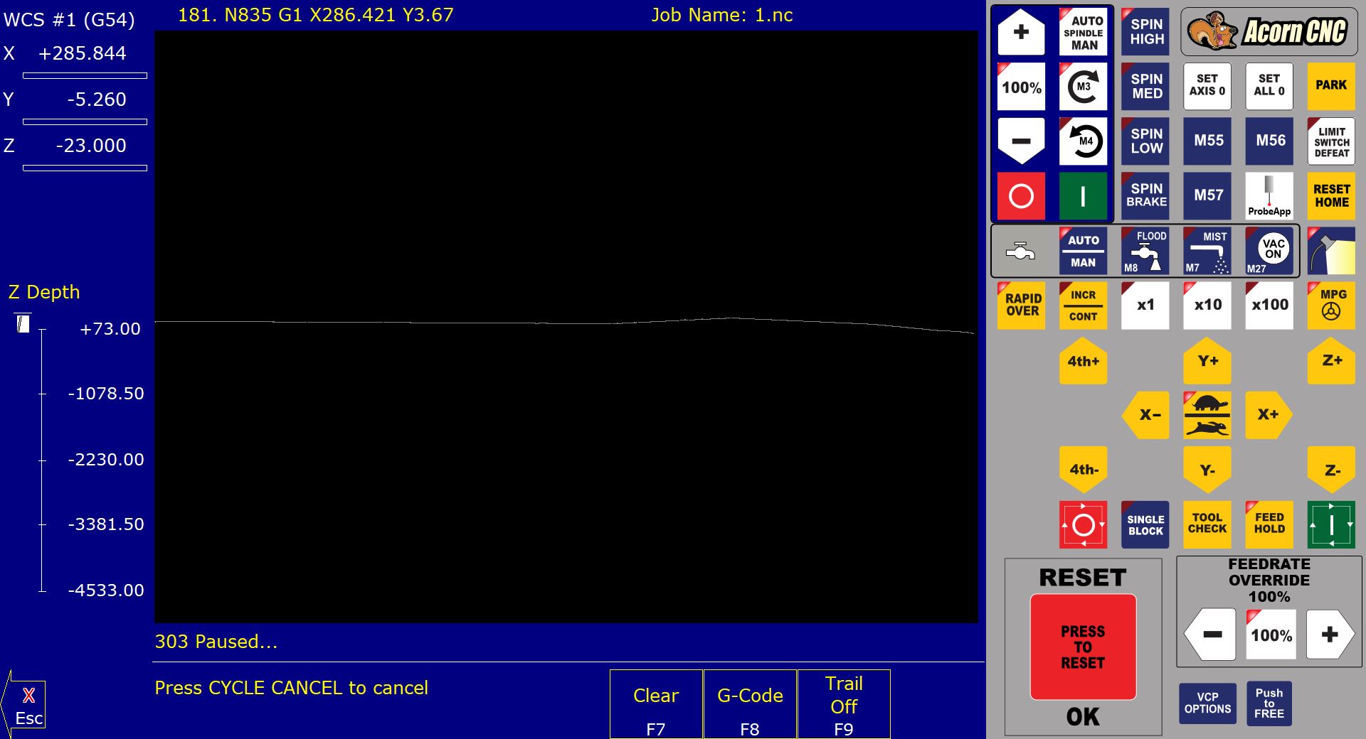

    Today I tried out Tim Paterson's add-in for Fusion. It didn't end well - or wouldn't have if I'd a) not been air cutting and b) stopped it after 20 seconds or so. It seemed to have planned to drop the cutter 4.5m below the reference point in Z and somewhere unspecified in X and Y. I'm guessing it got its absolute and relative moves mixed up.
    No criticism of his work, 'cos I know it's work in progress but just be warned that the Centroid post doesn't like it. I don't know if other systems get on better with it.
    Hope somebody better qualified than me can figure it out. Hopefully it's relatively straightforward. I've posted about the issue on his Git repository and will respond if I can help.
    FYI - Here's the offending g code. The add-in inserts comments where each replacement was made to the original, so it's fairly easy to see where the changes are.
    Ooof.nc
