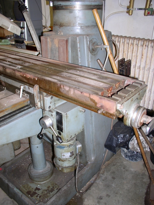

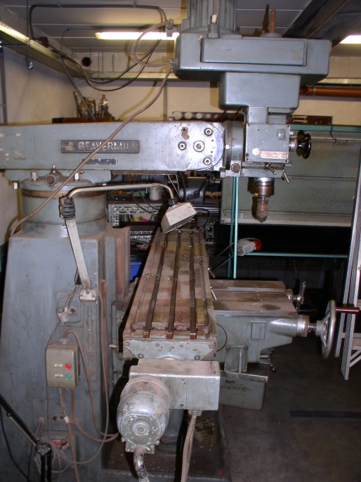

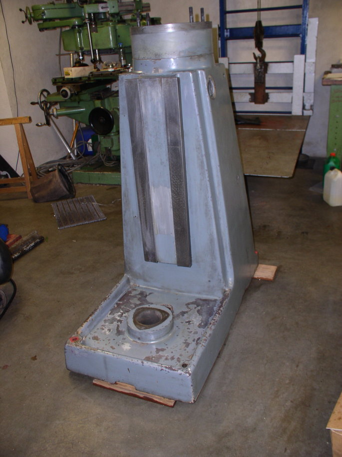

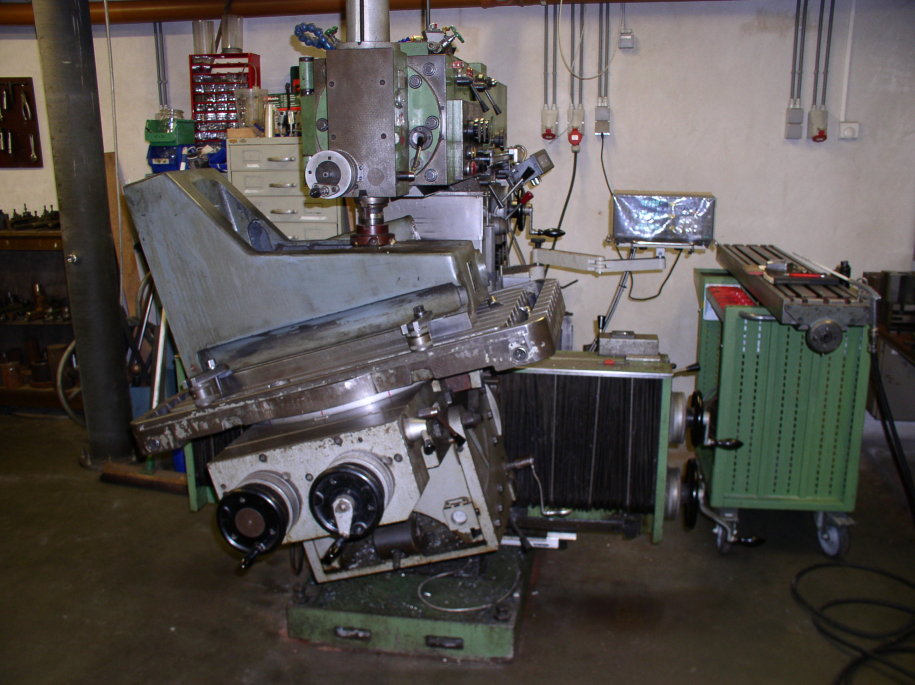

    I am a metalworker professionally and as my hobby. I always wanted to have a CNC milling machine.
    Hearing the prices of repairs on our CNC machines at work , I gave up my ambition to buy one.
    Then I met some people who build their CNC by themselves.Then the idea came to me to rebuild my old Beaver Mill .
    A decade ago I bought a Beaver Mill VBRP.
    After standing in a corner of my workshop all this time, I put him back in the spotlights. The idea is to convert him into a CNC Mill.
    Last Saturday I started cleaning him.
    I will let you know how the rebuilding goes along.
    Here are a few foto's from before the clean up;

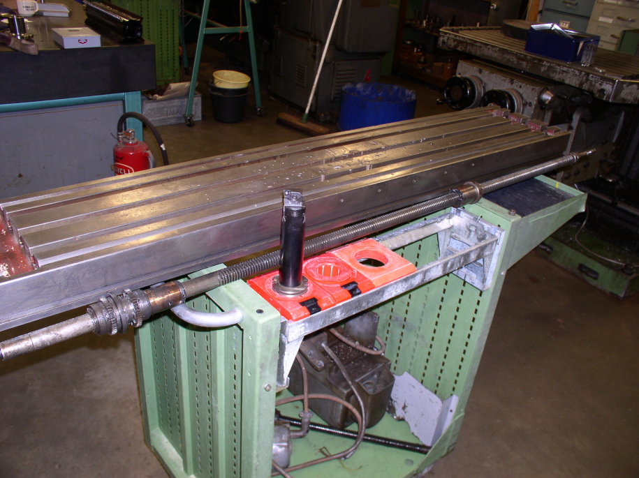

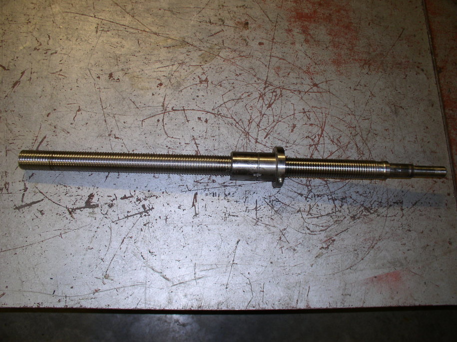

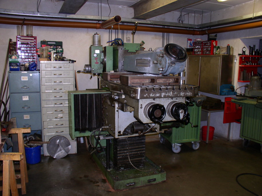

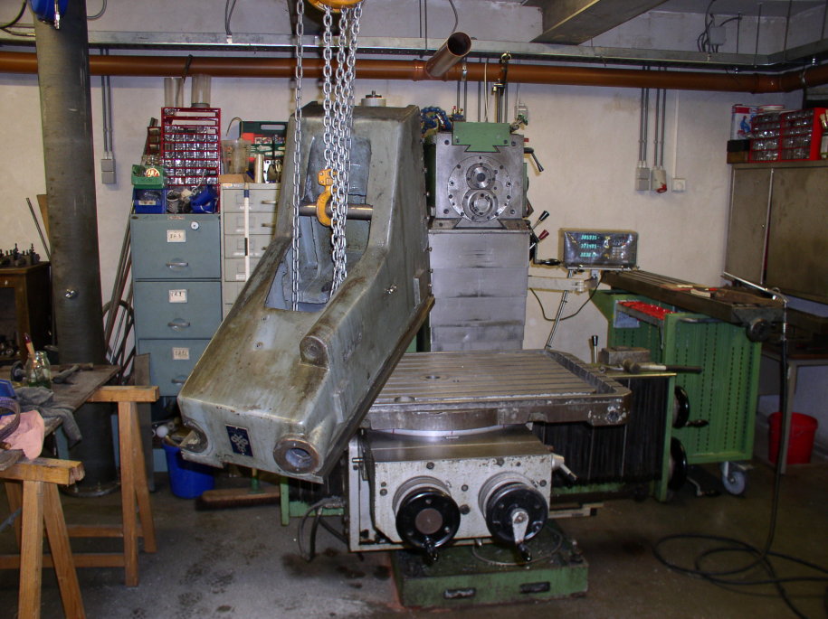

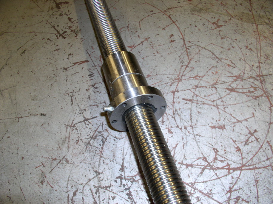

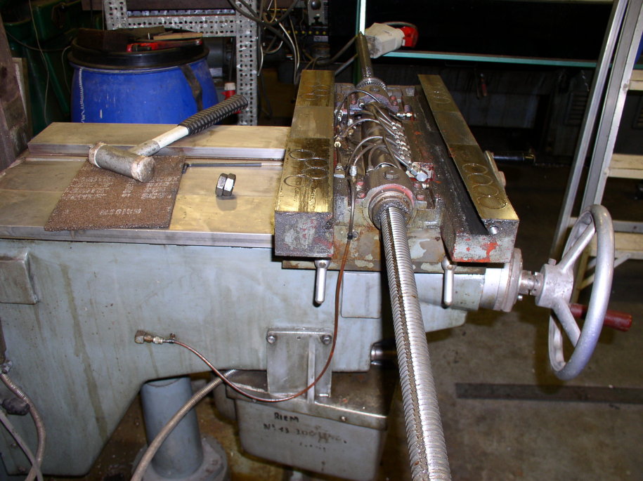

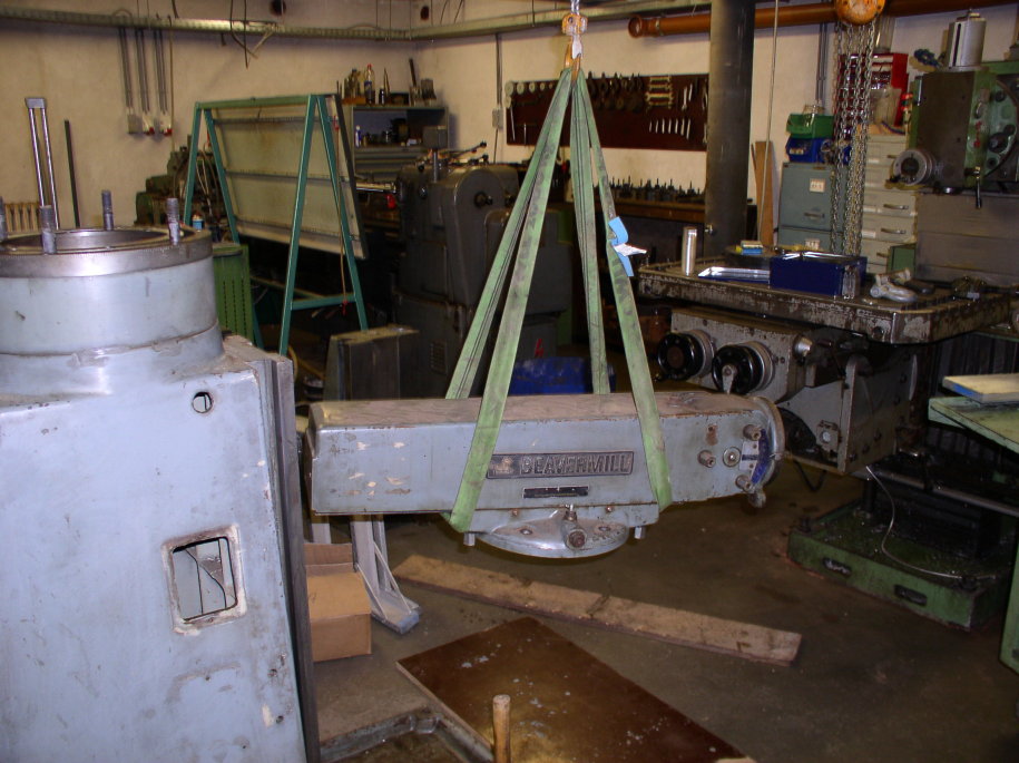

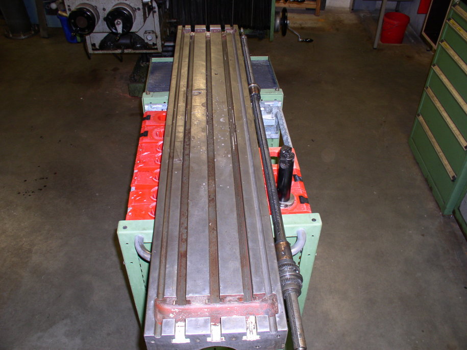

    Hello everyone,
    On Sunday I managed to partially disassemble the Beaver and to clean the table so it is presentable again.
    I already had a ball-screw for the Z axis from a CNC mill that was refurbished.
    And I am planning to change the X and Y axes with ball-screws as well.
    Does anybody know which are the best axial bearings with zero tolerance
    and preloaded so that I don't need belleville washers.
    I don't know what they use in real CNC mills as axial bearing.
    Kind regards ,
    Andre.

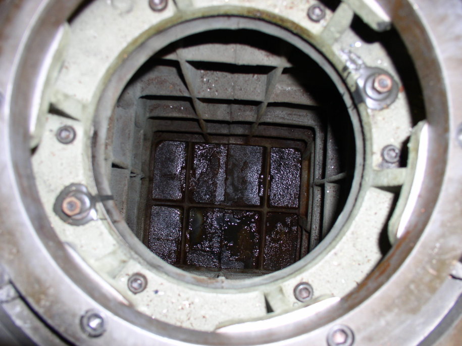

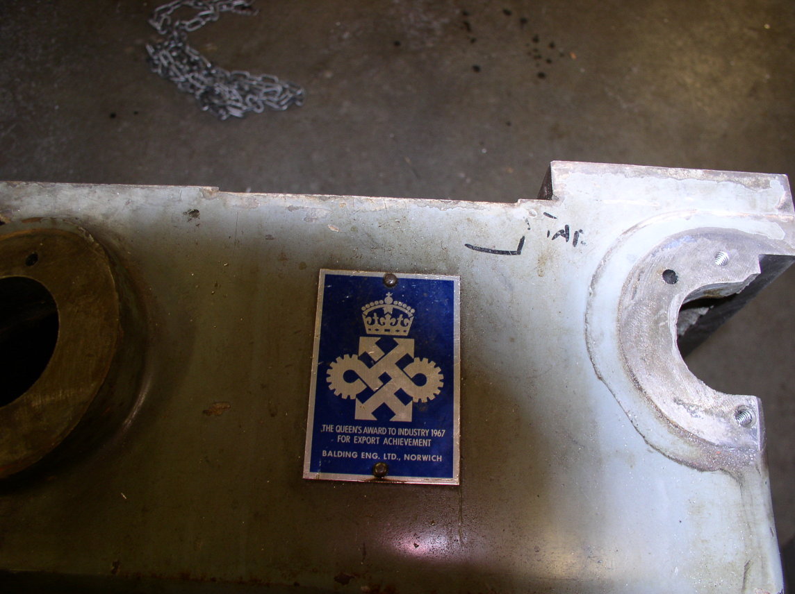

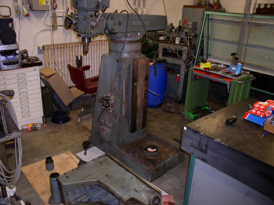

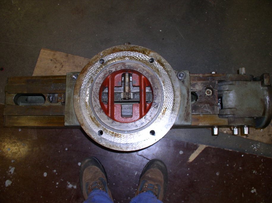

    On sunday I did some more work on it.
    I removed the elecktricity so we can put some new on later.
    Disassembled the turret and cleaned the coolant tank which was full off slurry . Dirty work it was.
    We also discoverd a tag with an award from the Queen.
    And as you can see the year is 1967 so I presume it is build in the same year.

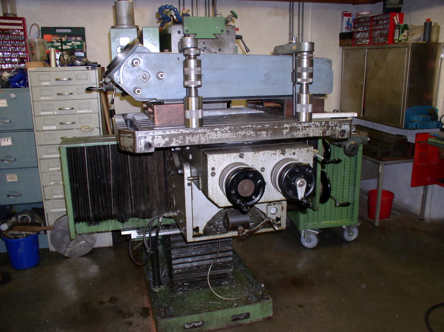

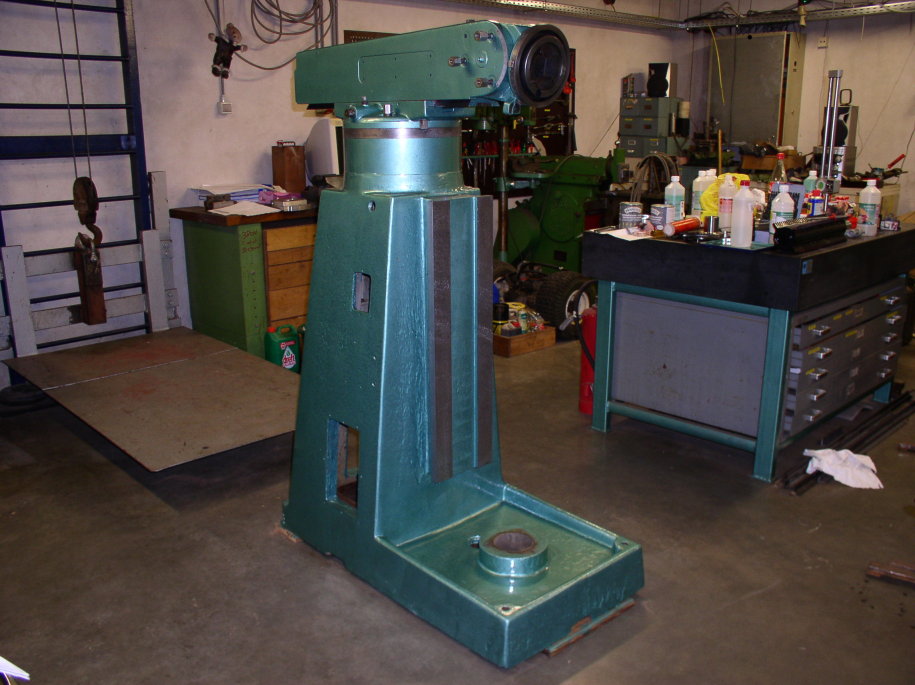

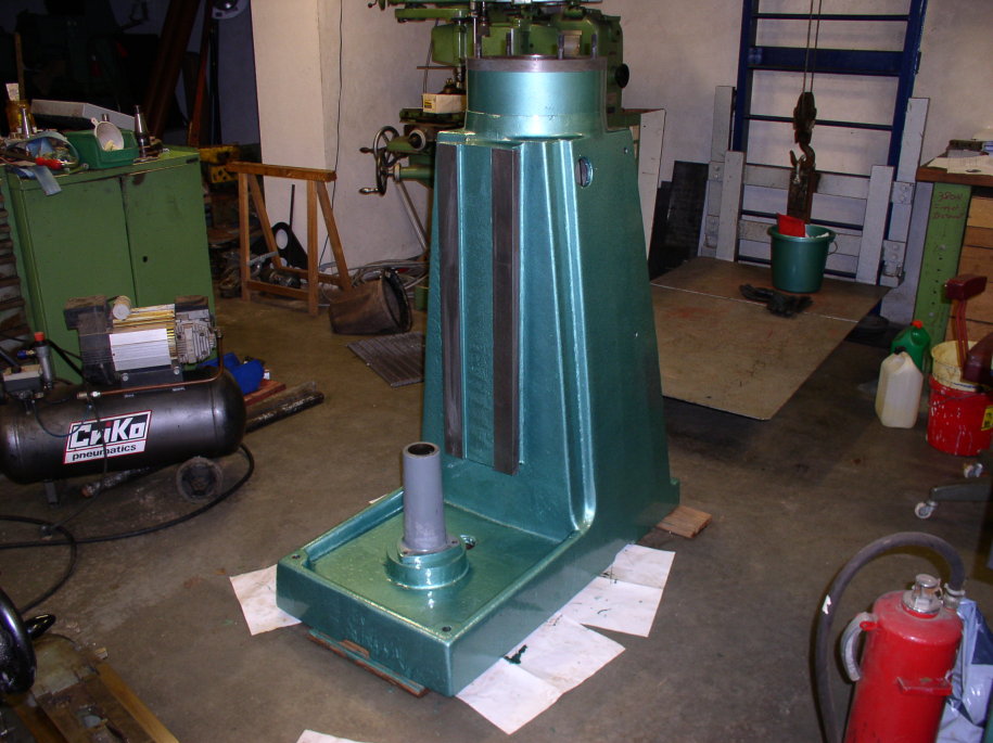

  8. #7
    On Wednesday I cleaned the body with prepaint and put some paint on it.
    yesterday we cleaned some parts off the turret.
    Today we did some milling on the ram so if at a later date I want to make a toolchange or something else than there is already a plane and holes to bolted it on.
    also on the rear I made some holes to connect a high speed motor.
    Later today we painted the turred and started some milling on the table console .

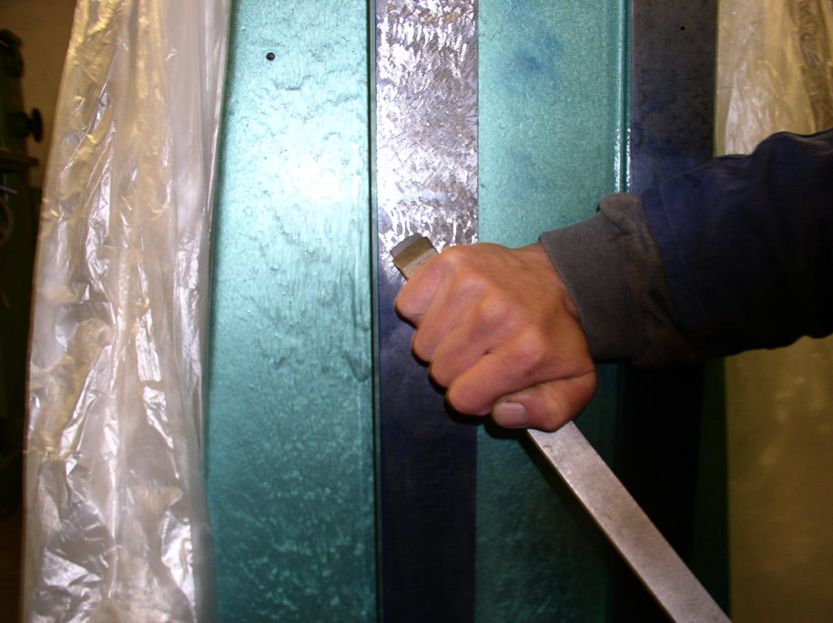

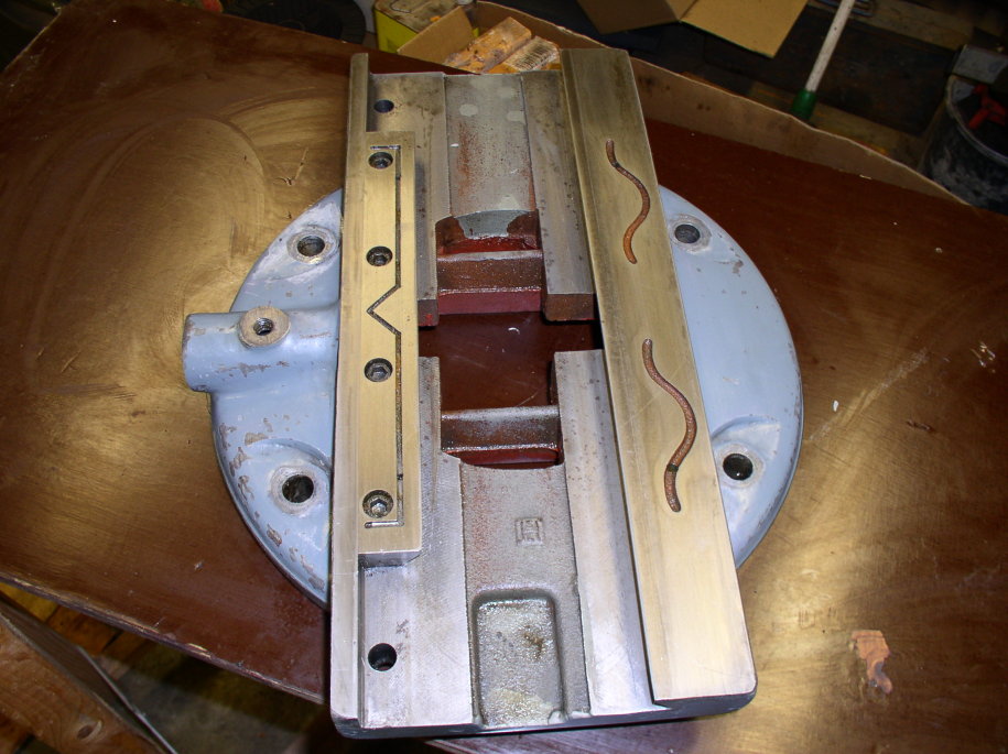

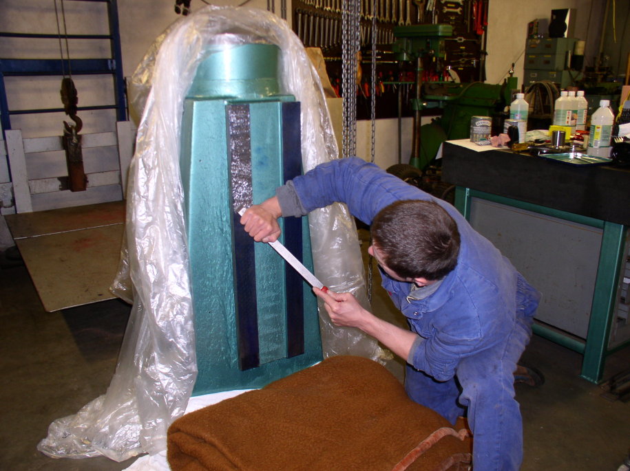

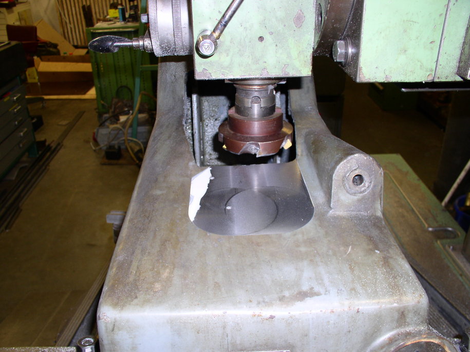

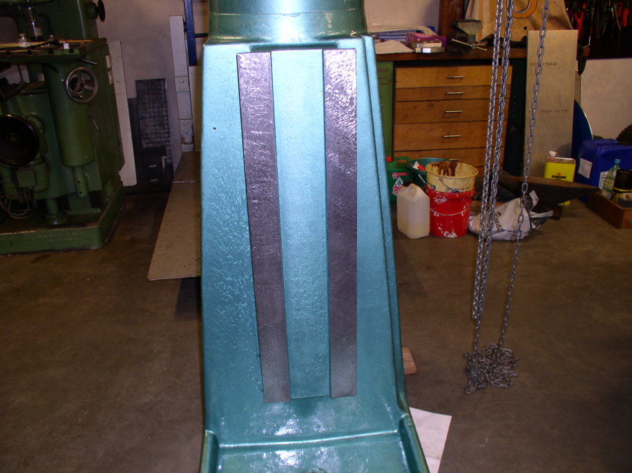

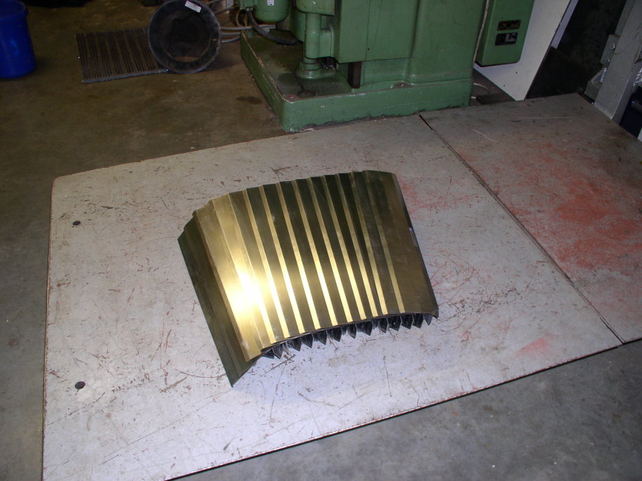

    Last week I had a lot of work with scraping the verticale slider mounting surface. on the link below you can see real pro's at work.
    http://www.moriseiki.com/dixi/englis.../scraping.html
    I did some assembling from the turret.And I found a protection for the Z axis.
