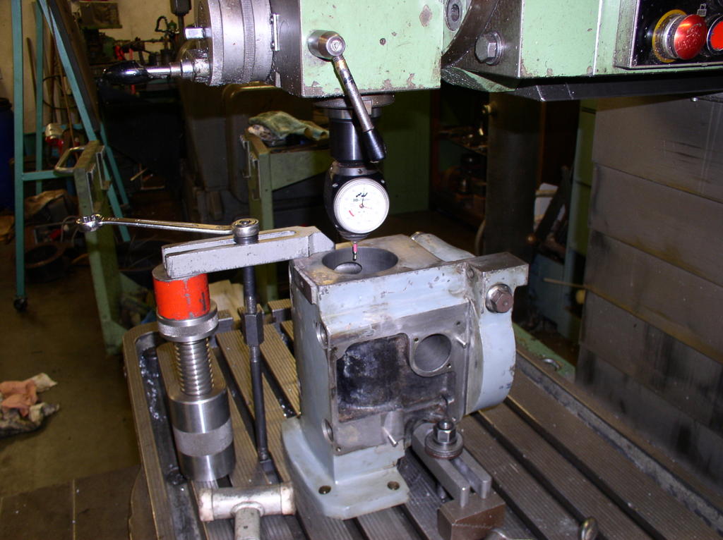

    The next thing I wanted to do was rebuilding the spindle.
    But first we had it disassembled.

    This was part of the dismantling .
    Now we going to modify it some and put it back together.
    First measure the part and make some notes and later I made some extra holes in it to be used in a later stage for mounting a ring to get cooling on to the workpiece.

    We have to make a new motor support because it is having a special flange
