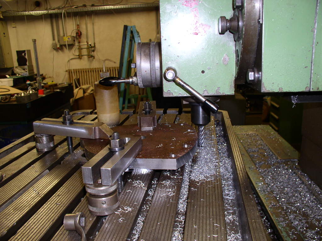

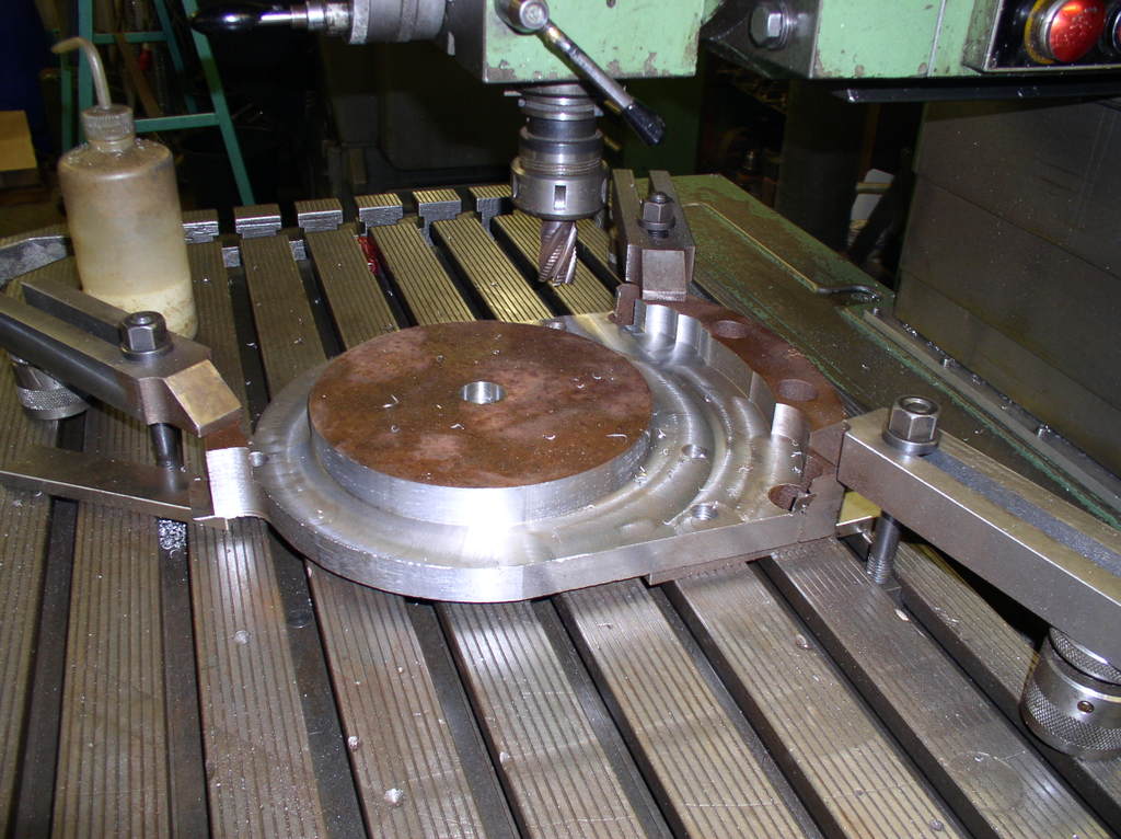

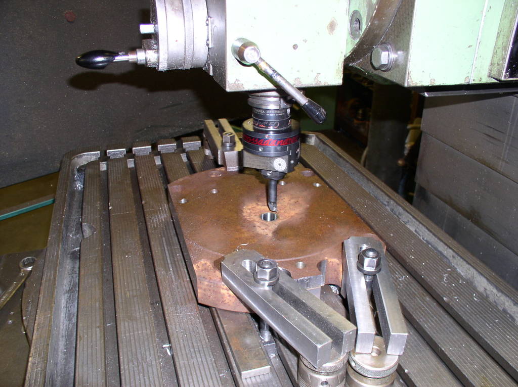

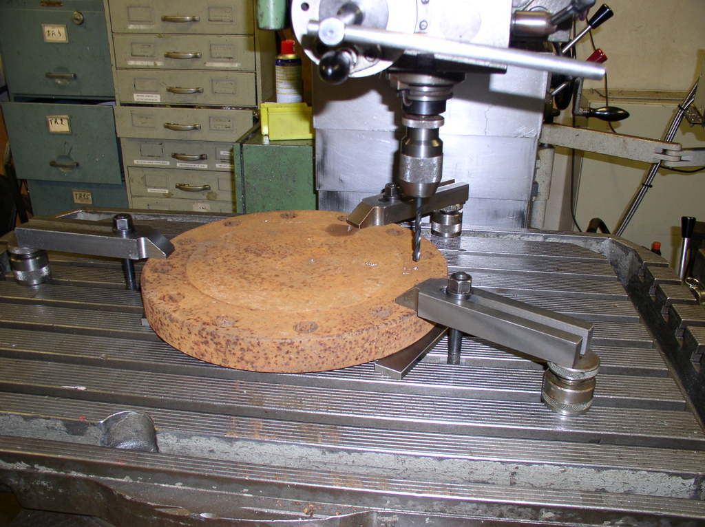

    First we put the flange on the machine and made holes in it so we can use them later as a center for alignment for milling the arcs of the part.
    And start with roughing .

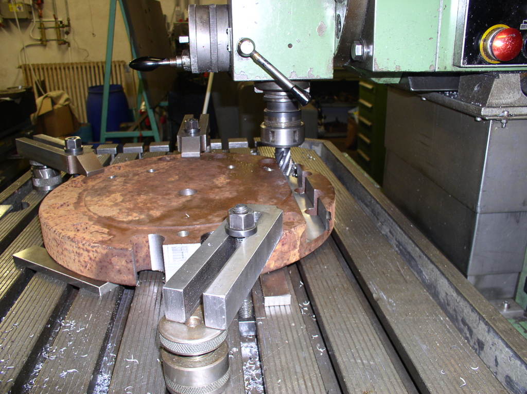

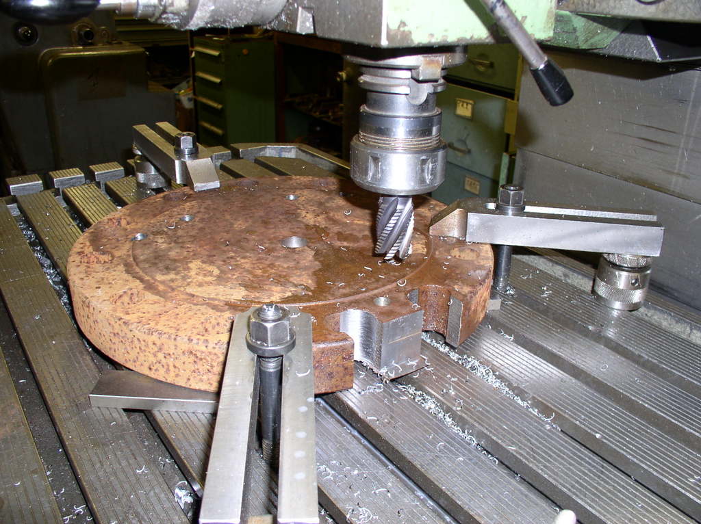

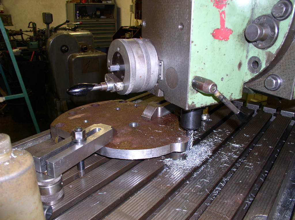

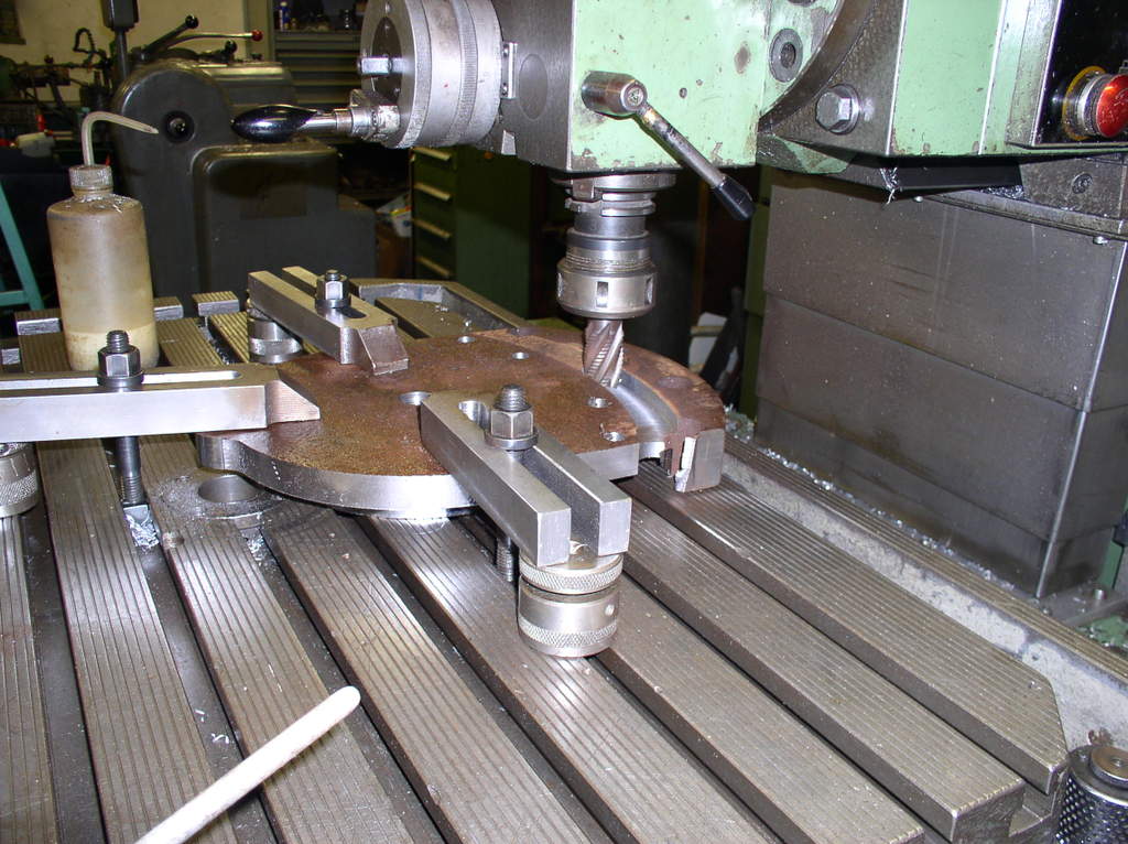

    After making sure the workpiece is in the center of the machine I started with
    roughing the outer arc.

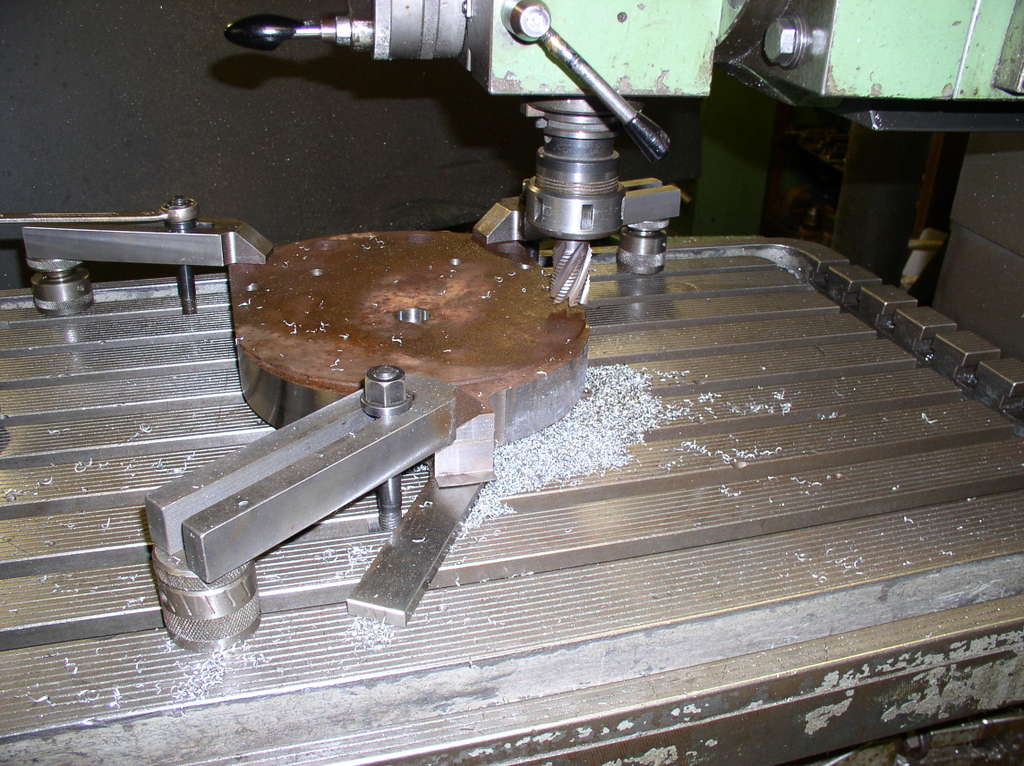

    After that we are roughing the cylindrical section and then turn over the workpiece and cut away the biggest arc.
    But first we made the small arc .

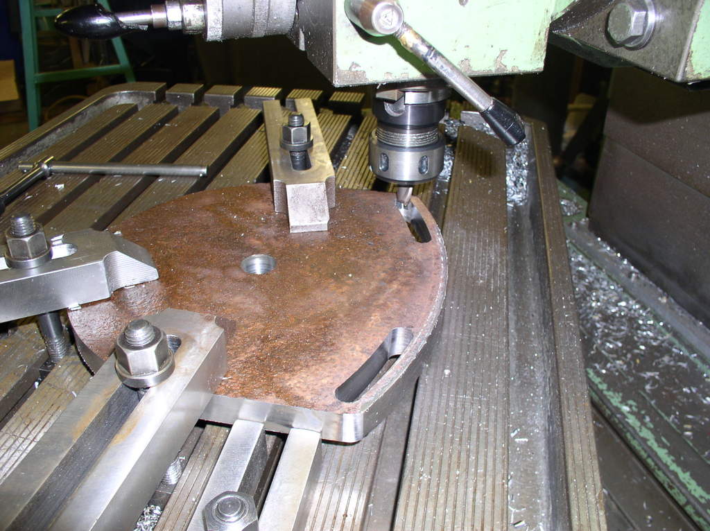

    After finishing the outer arc the arc shaped slots ware made.
ID:	3073   Click image for larger version.

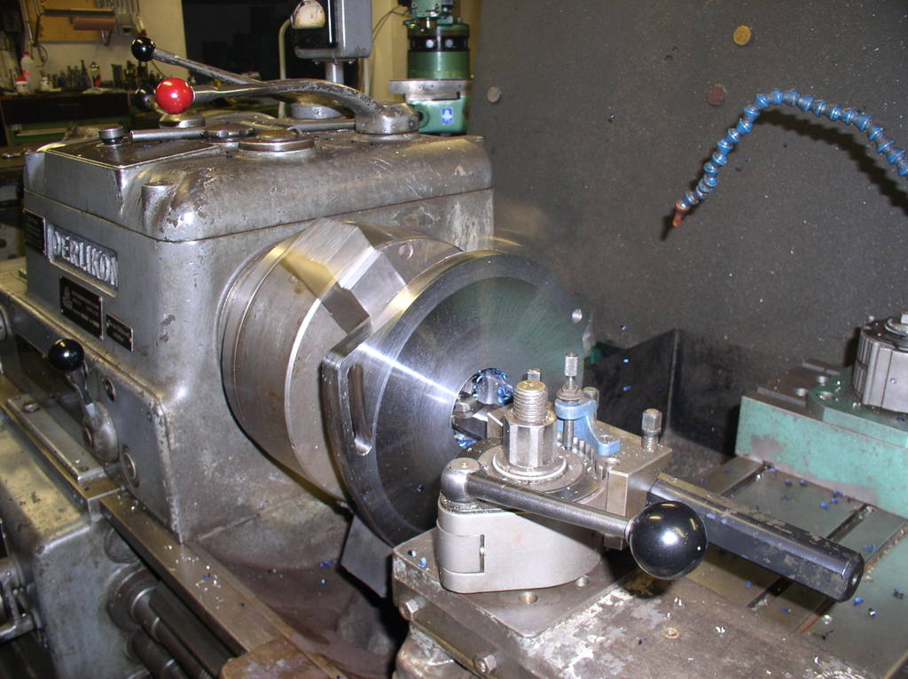

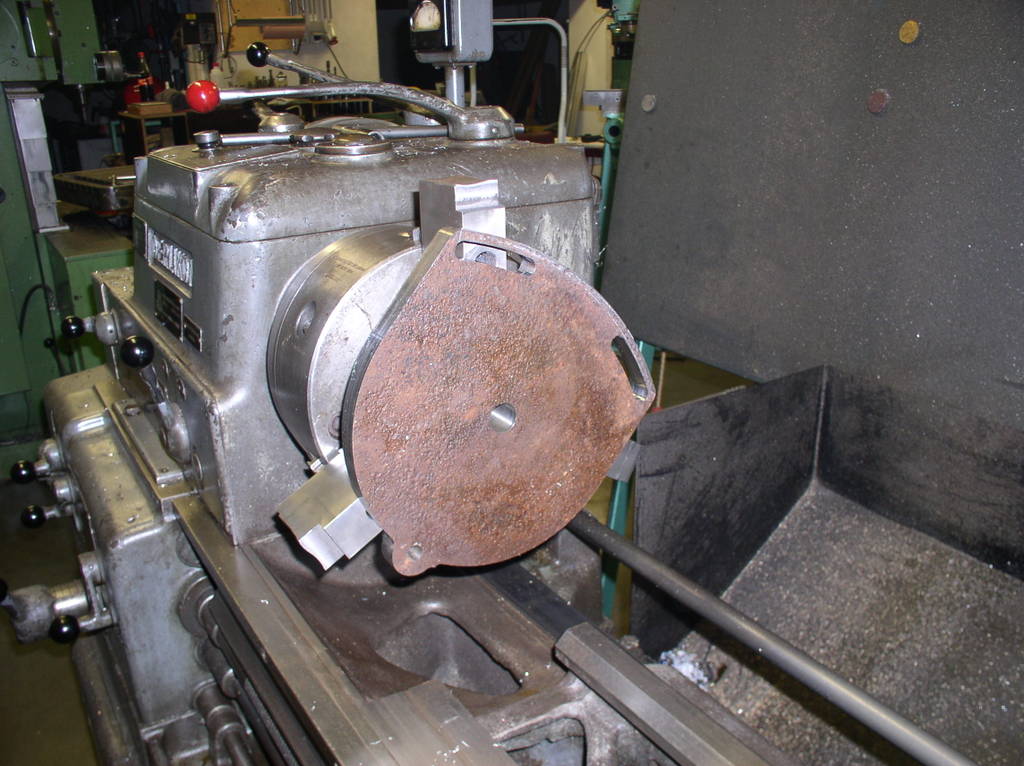

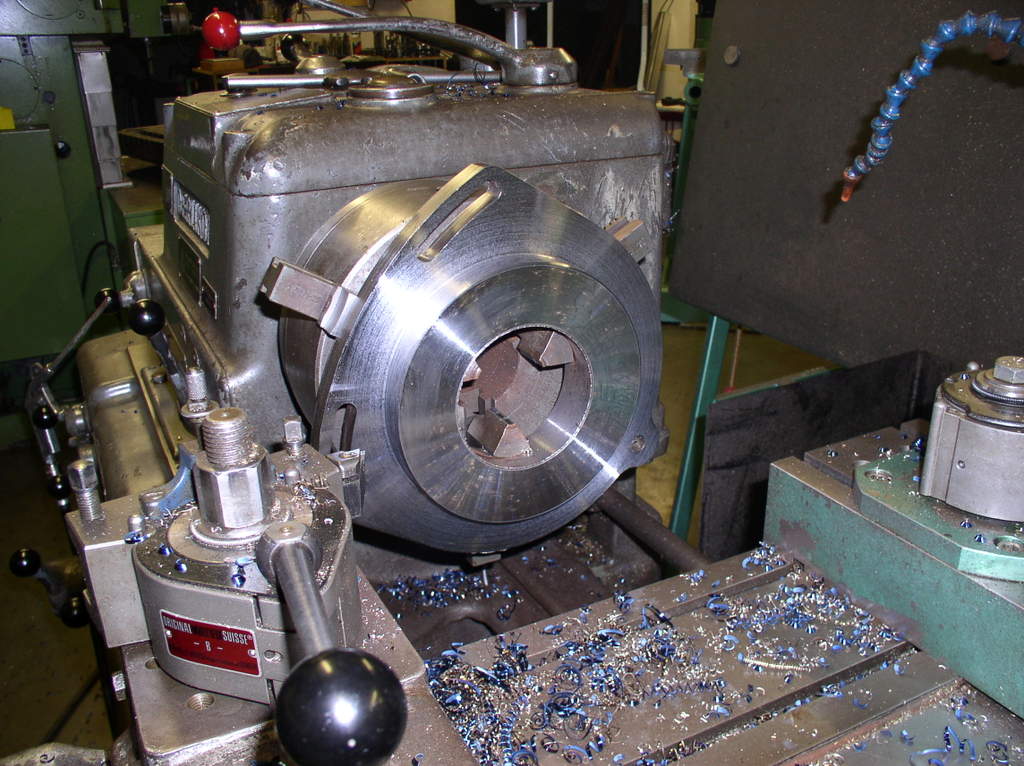

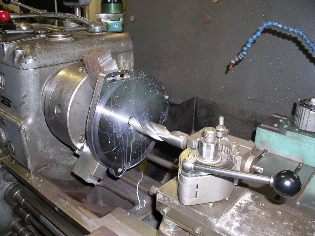

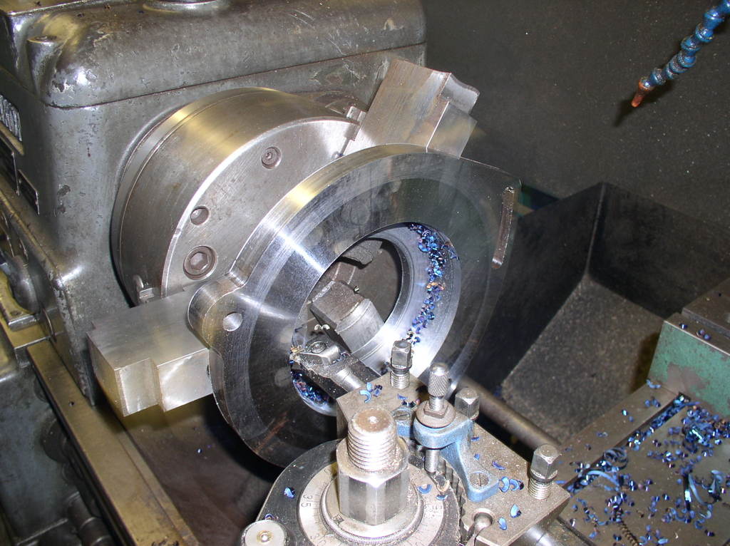

    In a later stage the piece is taken in the chuck of my lathe.
    The first operations are facing of and drilling .
ID:	3075   Click image for larger version.
ID:	3076   Click image for larger version.

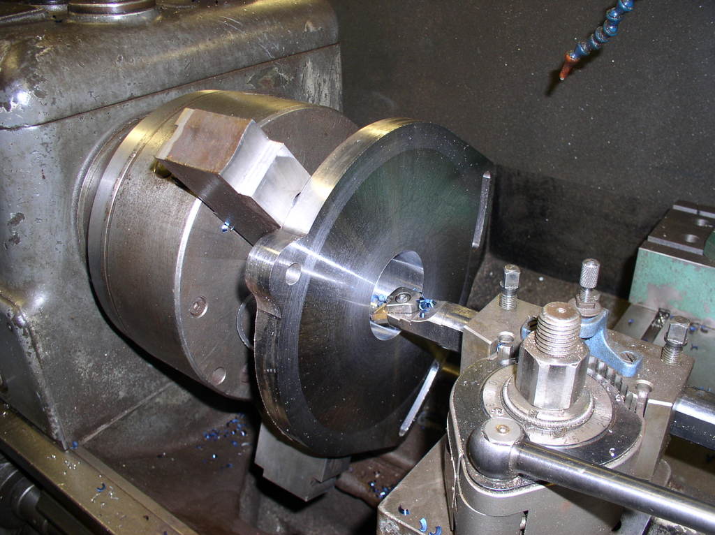

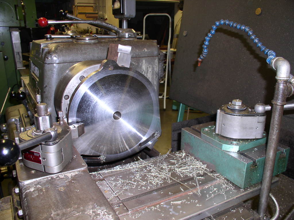

    With a other tool we made the chamber for the motor.
ID:	3078   Click image for larger version.
ID:	3079   Click image for larger version.

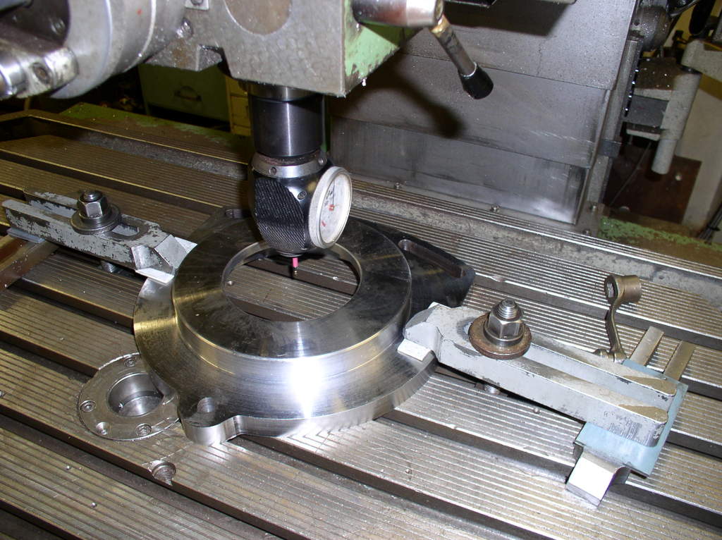

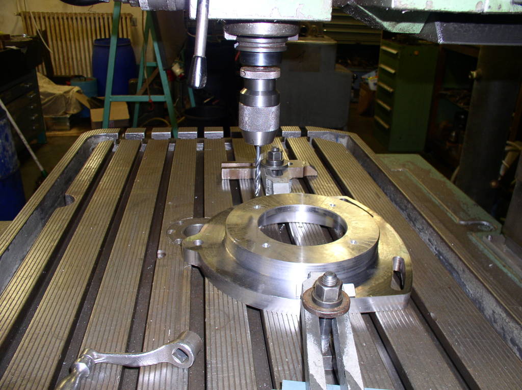

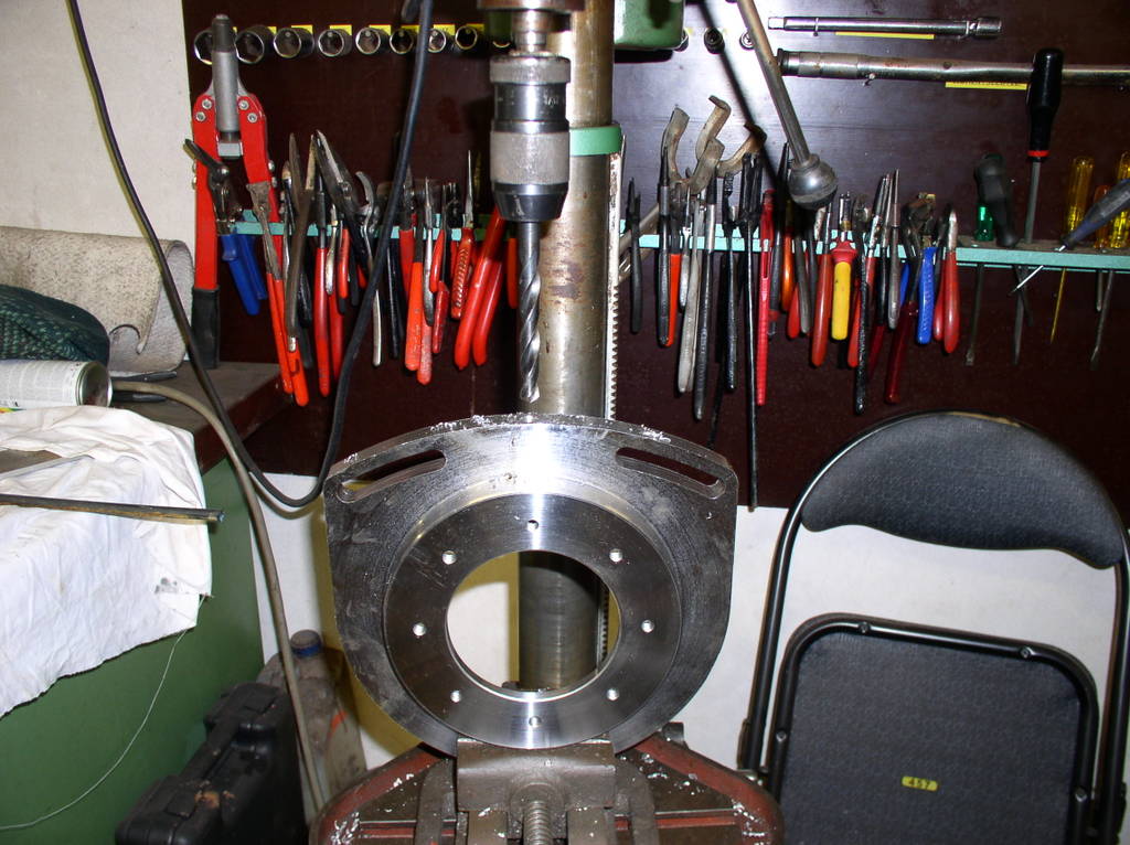

    Now the workpiece is going back to the milling machine and it is centered and holes ware made in to it so the motor can be attached .
ID:	3082   Click image for larger version.

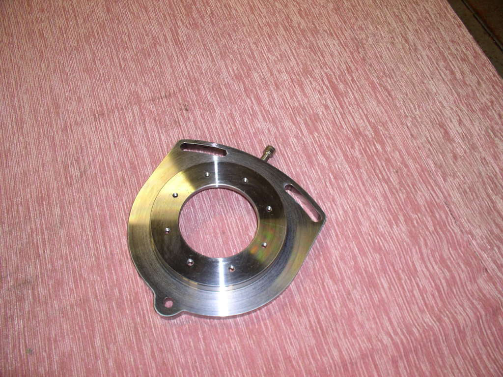

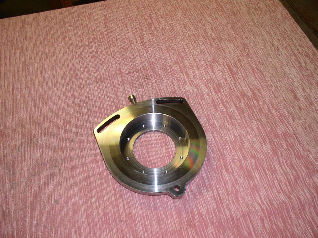

    In to the side of the flange a tapped hole is made to attach a handle for tightening the belt of the motor.
