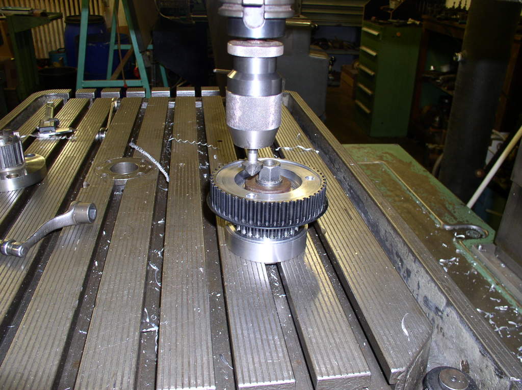

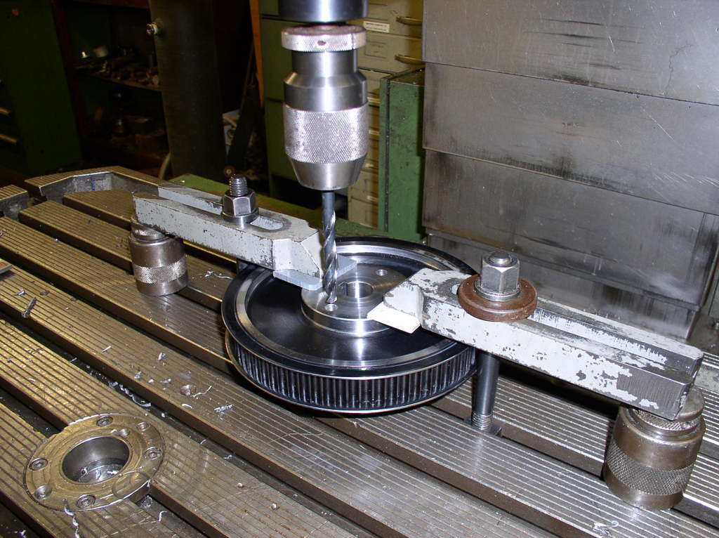

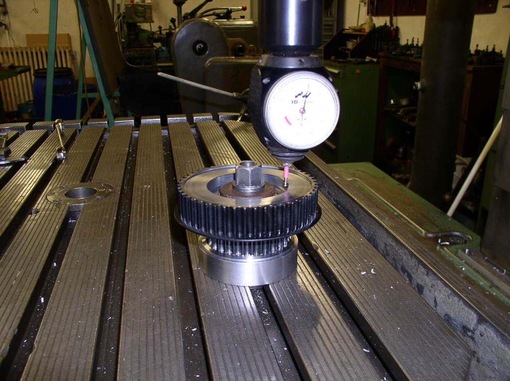

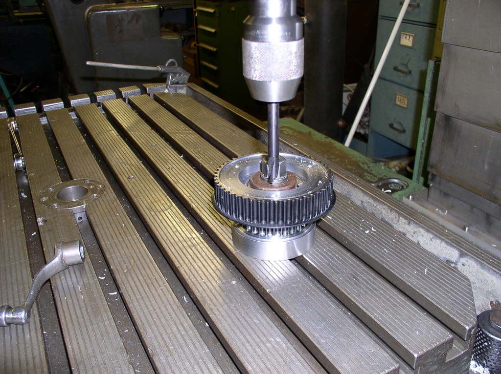

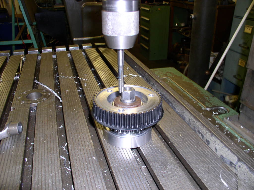

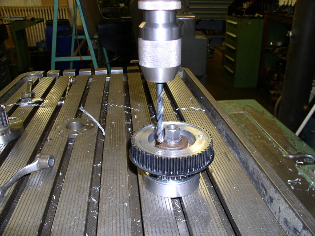

    Now it is time for some drilling operations.
    First thing to do is make sure your workpiece is correct centered .
    The next thing I do is make a centerhole.
    Drill with the right size so the holes who needs tapping also can be don.
    And break sharp edges.
