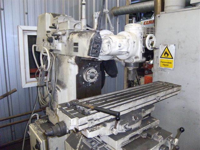

    Today I did the scraping of the X axis.
    I've needed the whole day for it and tomorrow I will also have a few hours
    to do before it is ready.
    I'm still not done scraping on the X axis it takes more time than I thought
    anyway I continue until everything is straight.

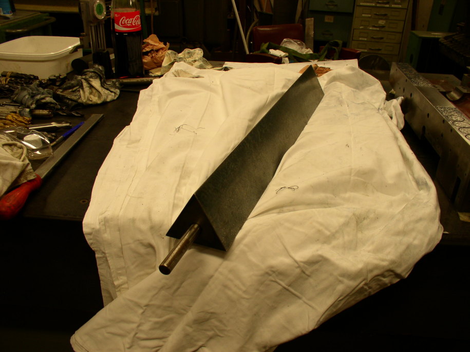

    I've never owned a machine with hand-scraped surfaces - will do soon though I hope. Just out of interest, the X axis bearing surfaces look quite long (it looks maybe 1500mm?). What are you using as a flatness reference to scrape this surface?
  4. #14
    Hi Tom,
    It is 1400 mm long and I have a special tool that I can use .
    I will tomorrow make a picture and show you.

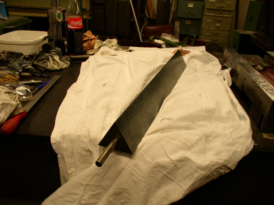

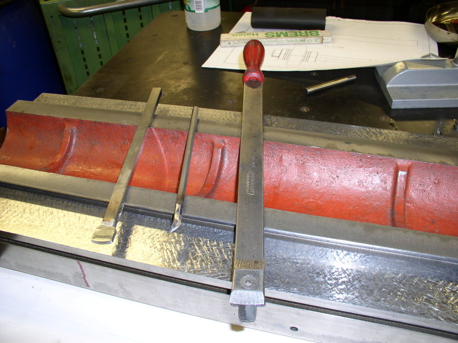

  5. #15
    Tom ,
    This is the tool that I talk about .
    There are many shapes and designs available.
    Or if you are in possession of a flat table, you can make one yourself.
    Are you planning to scrape your own machine?

    Thanks for the pics. Actually I was just curious about how to stabilise the flatness over such a long and thin shape. Of course a triangular section is obvious to me now! :)
    My machines do not yet deserve scraping. In the UK we have a phrase "making a silk purse out of a sow's ear". It means that I could try for a long time with lots of sewing to turn a cow's ear into a silk purse. In the end, maybe it would look a bit like a silk purse. But actually it would always be a sow's ear!
    It's the same with my cheap lathe! :) I'll save the scraping for another lathe...
    I had thought about making a small flatness reference by scraping 3 plates into each other - but that would take a long time too!

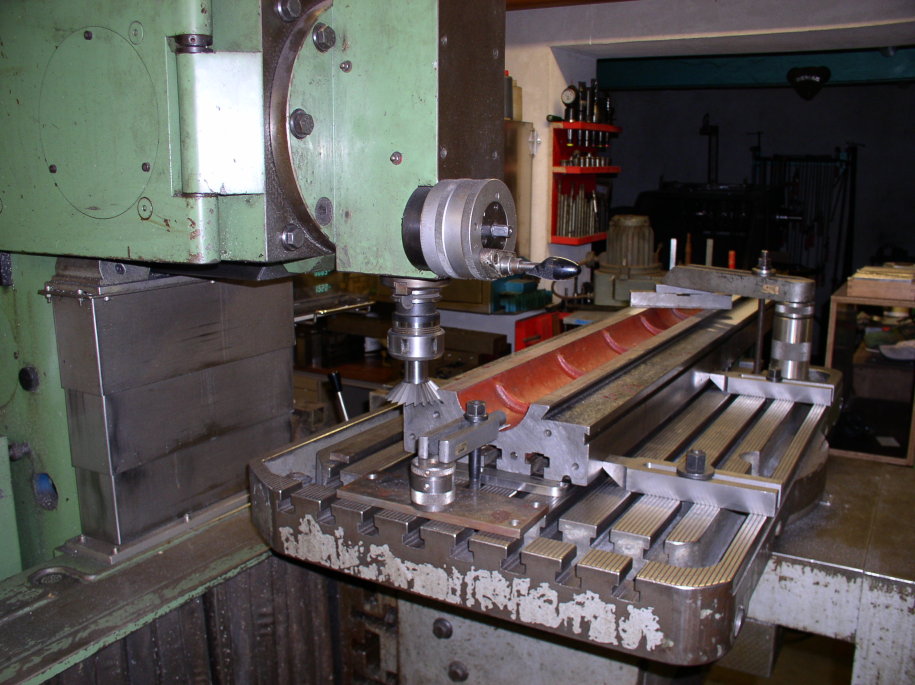

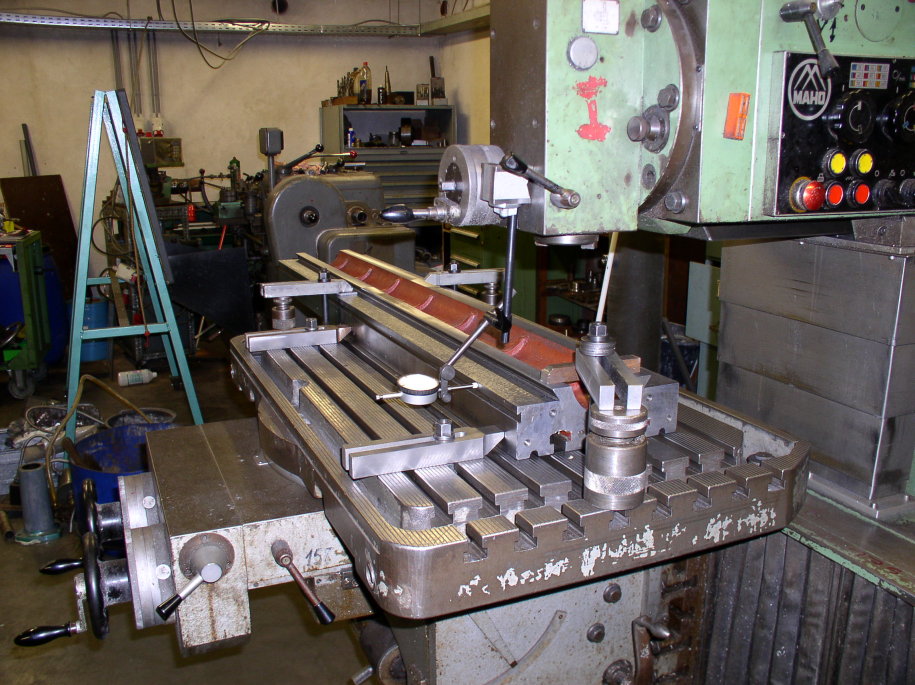

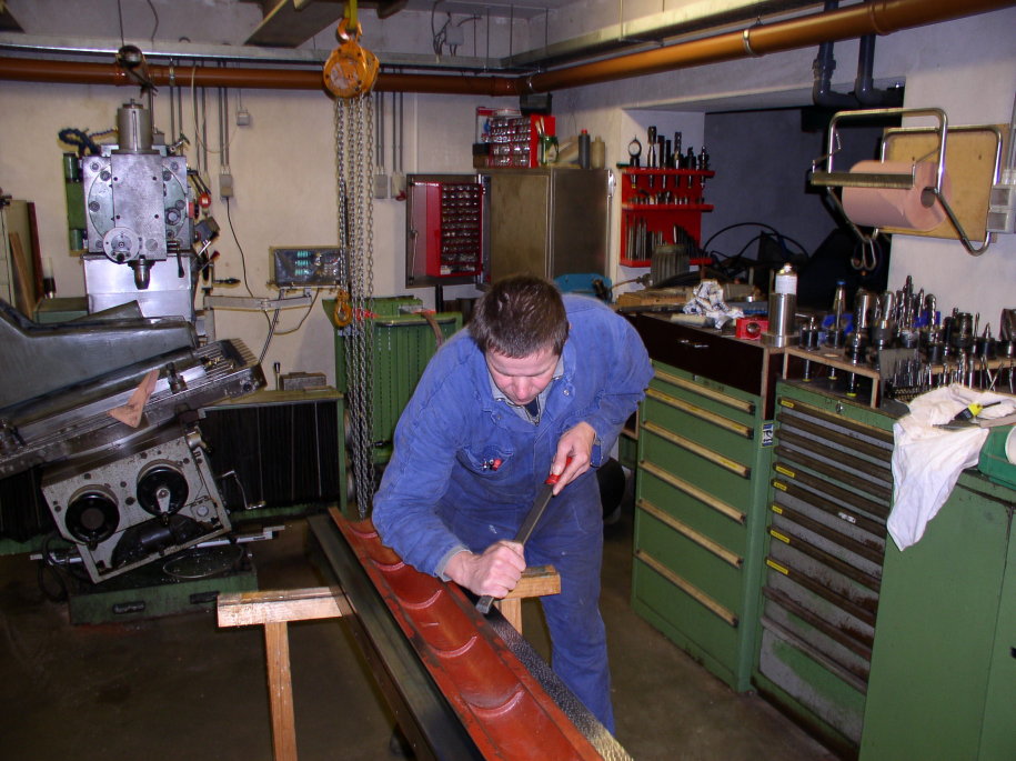

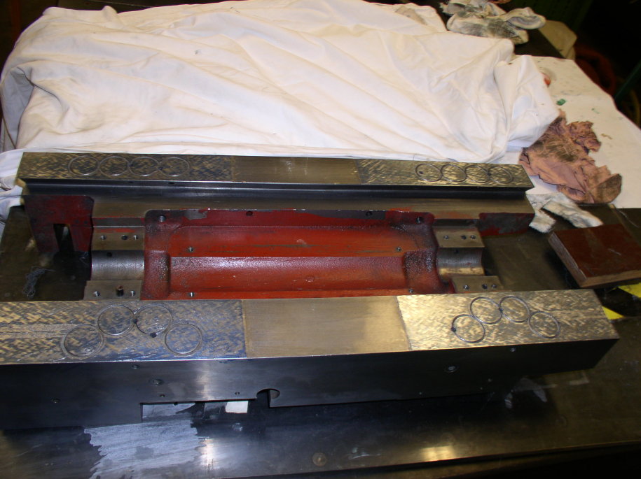

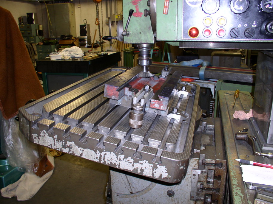

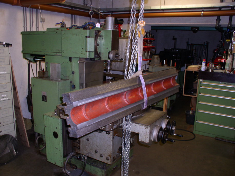

    Hello everyone,
    We finally have finished scraping bearing surfaces on the X axis.
    I decided to start from the basics because I had discovered that the table
    was bend at the ends about 0.4mm on both sides.
    I will show pictures of what I did to get it right.
    Maybe something that someone can use it for his own project.
    The first thing I did was to facemilling the carrier.
    Then I milled the pigeons tail .
    Then I finished it on the granite block with the scraper.
    So this is straigth.
    I will show you the tools aswell.
    1 small scraper and 2 larger tools.
ID:	1241   Click image for larger version.
ID:	1242   Click image for larger version.

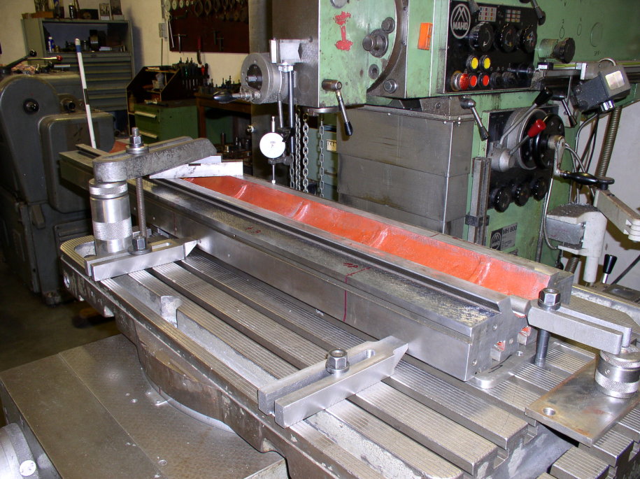

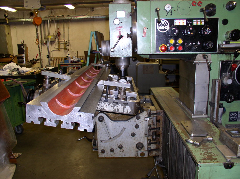

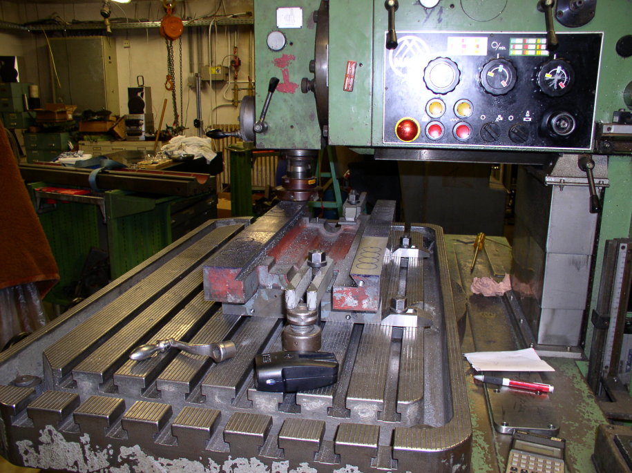

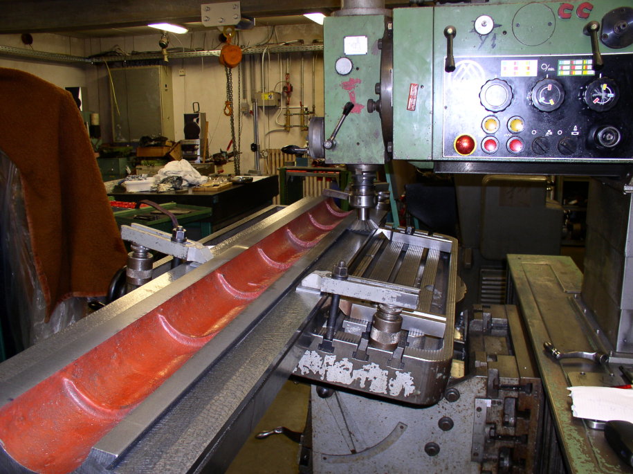

  9. #19

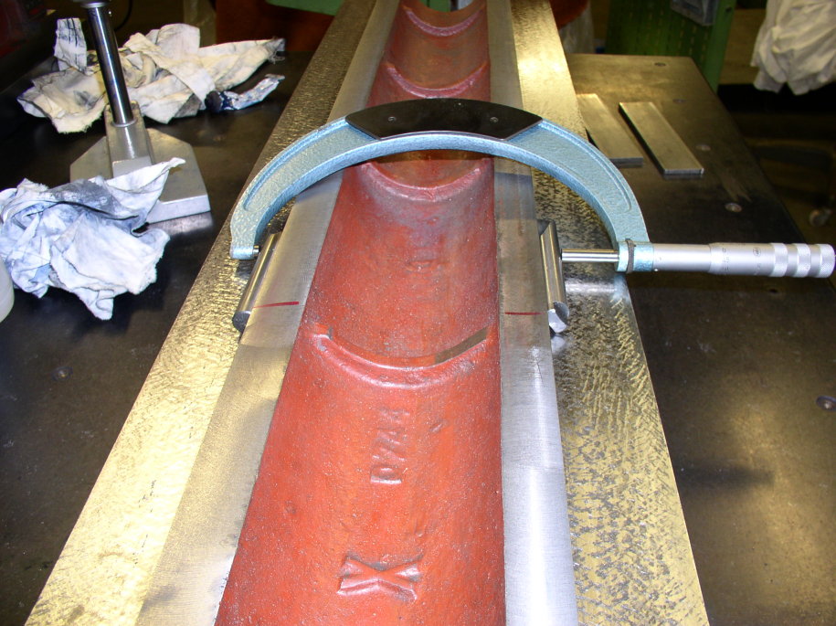

    Then I focused my attention on the table and have them placed on the milling table with a hoist because it weigh about 150kg and that is a bit heavy to manually manipulate.But first I have them measured and marked points with the correct height and recorded them on the piece.
    I then aligned them both height and direction .
    Next I face milled both sides and the top because the top surface was not straight olso.
    After aligning the table under the correct angle with a 3d measurment device I milled the pigion tail .
    Later I scraped the surfaces again .
    The end result is a maximum of 20 microns difference over the full distance 1420 mm
    both the flat faces and the pigion taile.
    For checking the flatness I used a clock and a triangle block for scraping and for the pigion taile a micrometer and 2 cilinders .
    And I use for scraping the Prussian bleu oilpaint to see what I did
    otherwise you will not know where to remove matarial.

  10. #20
    this is the triangle schape
