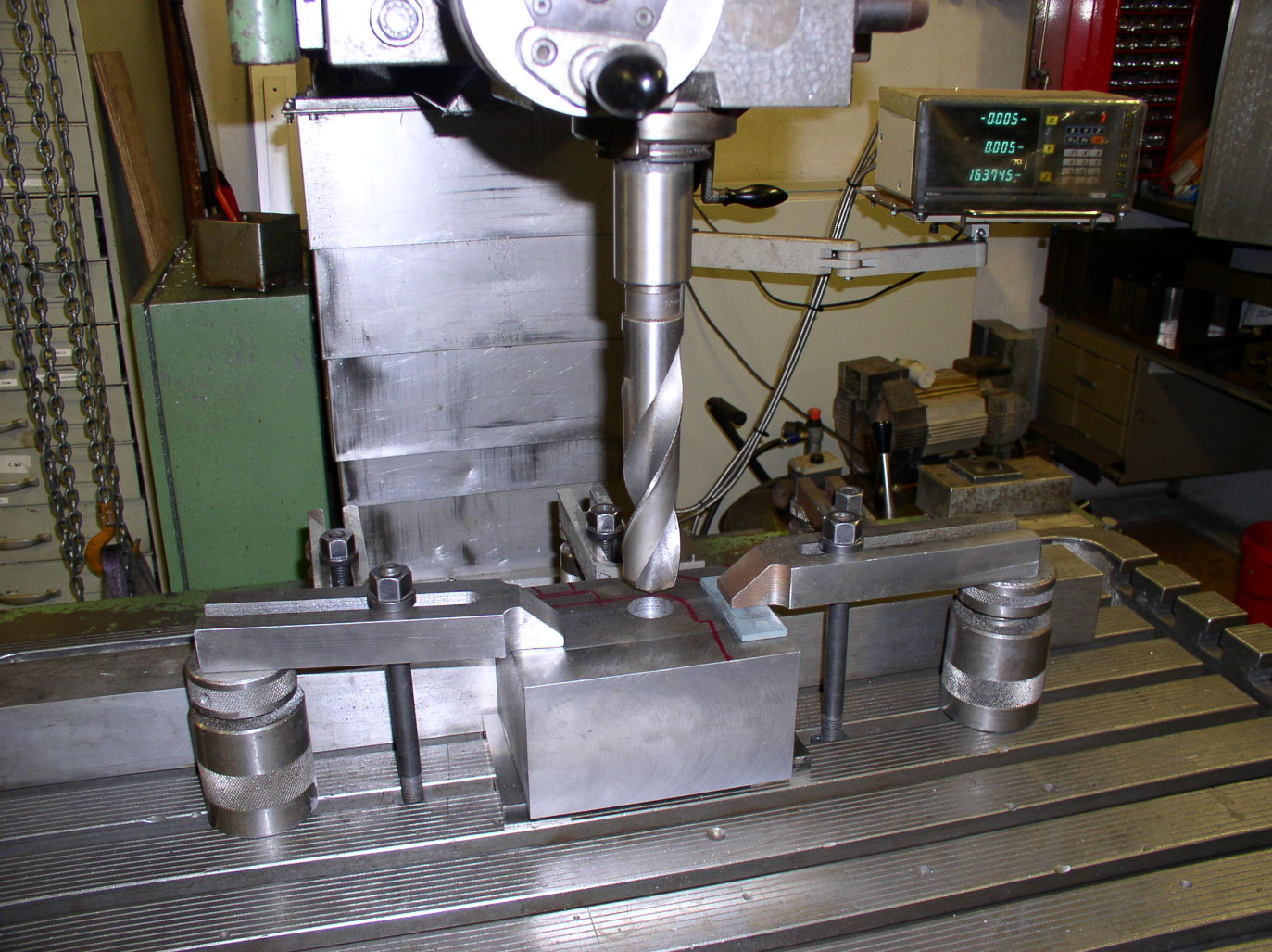

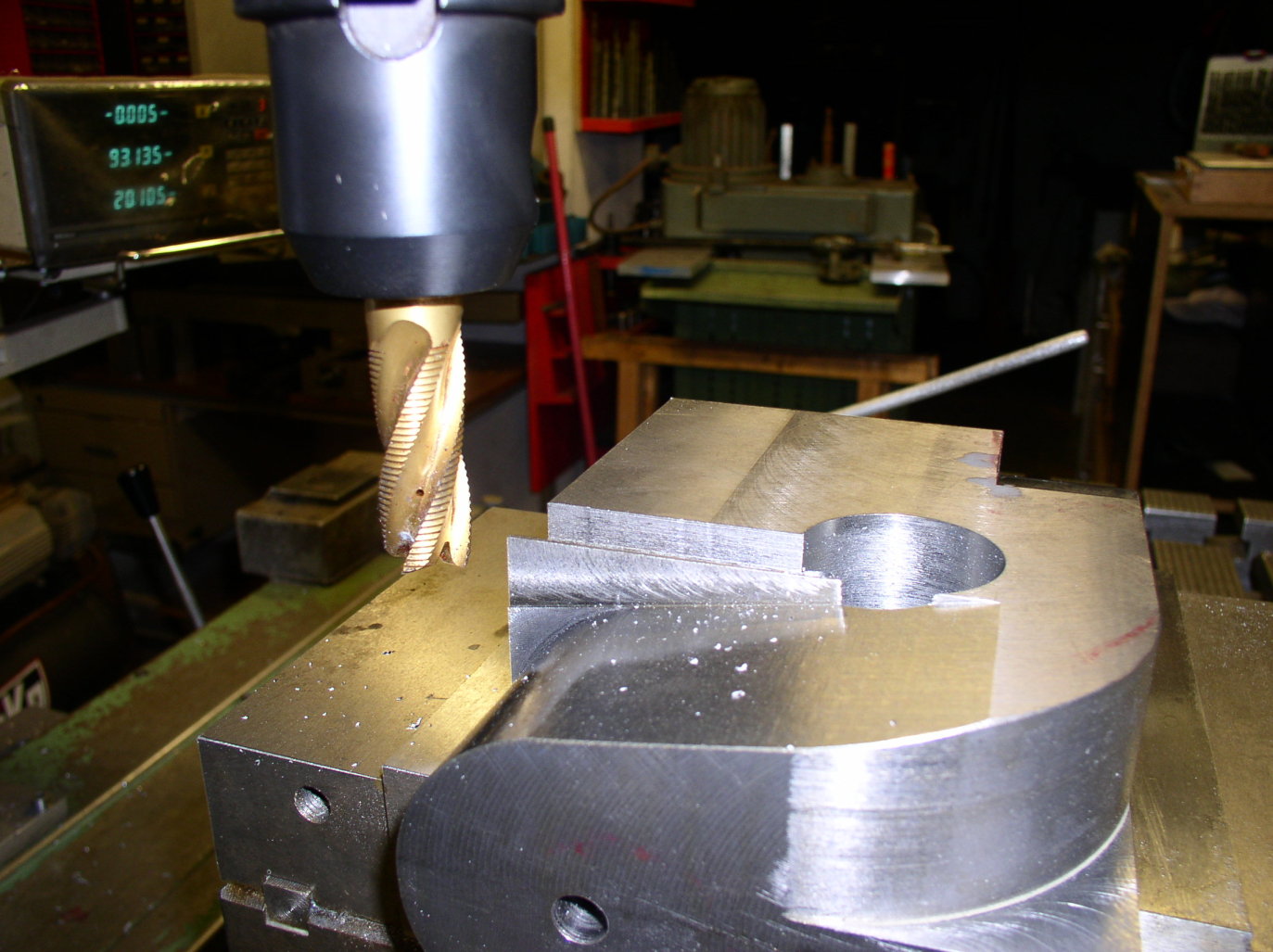

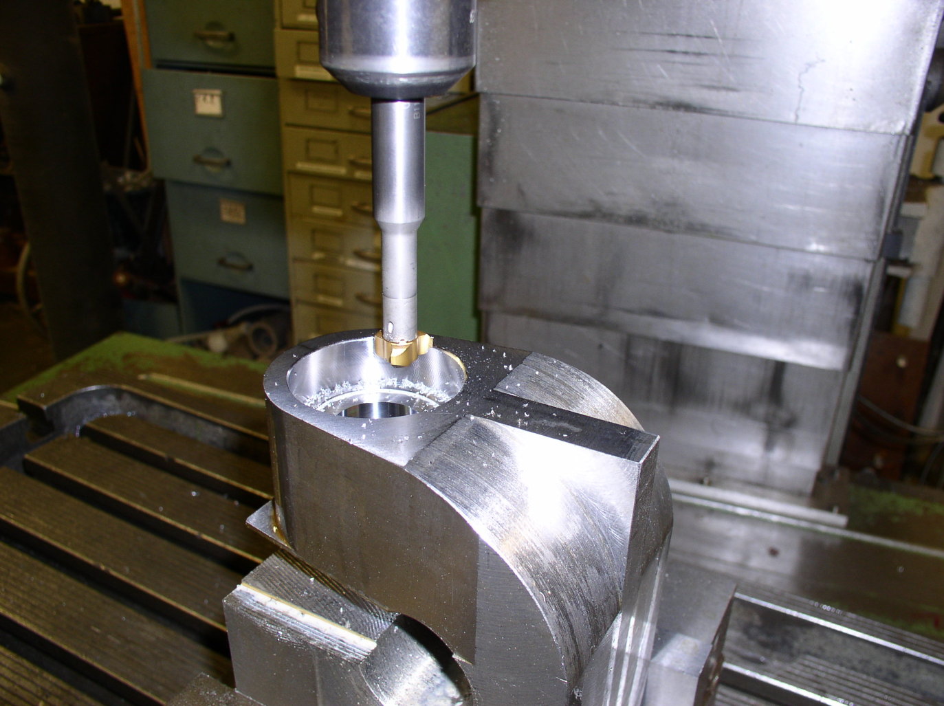

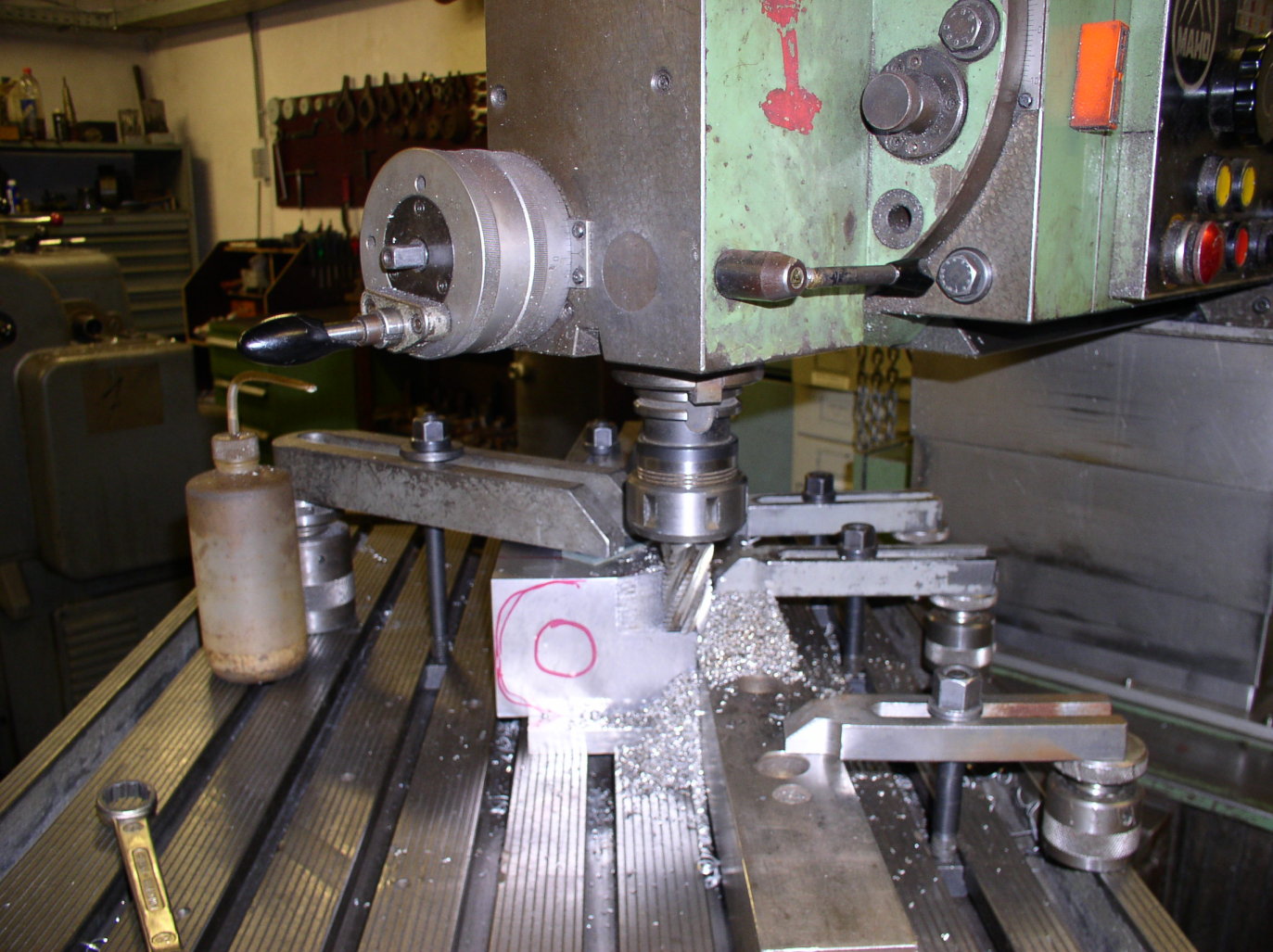

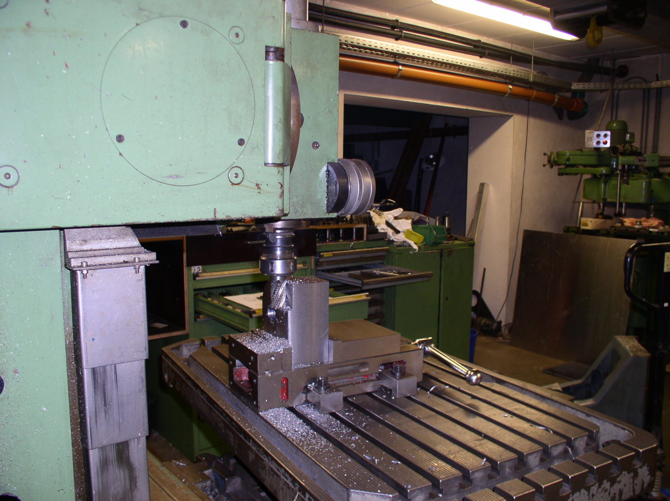

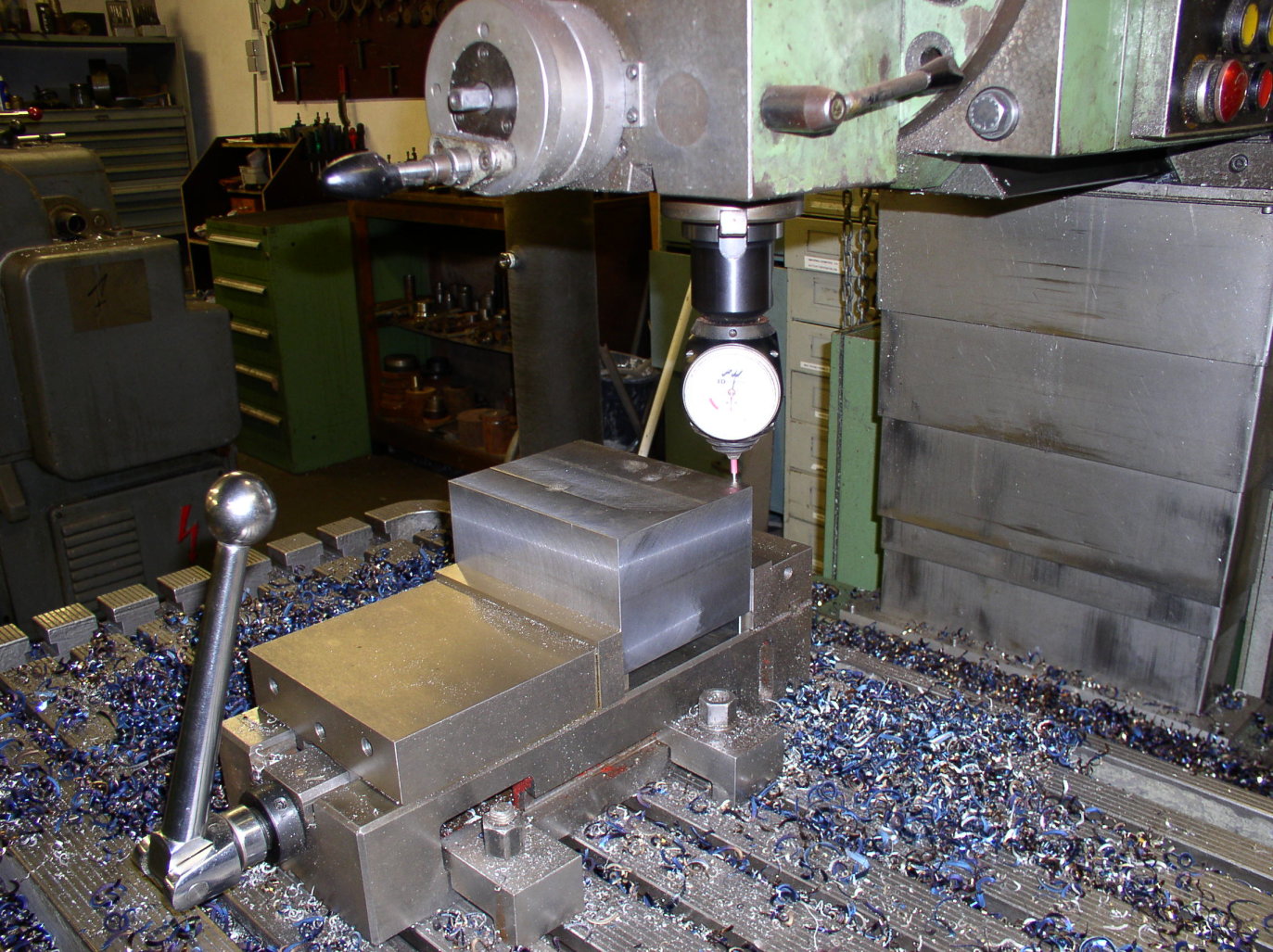

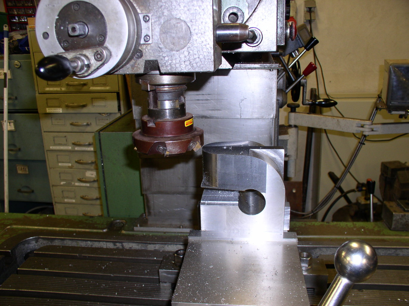

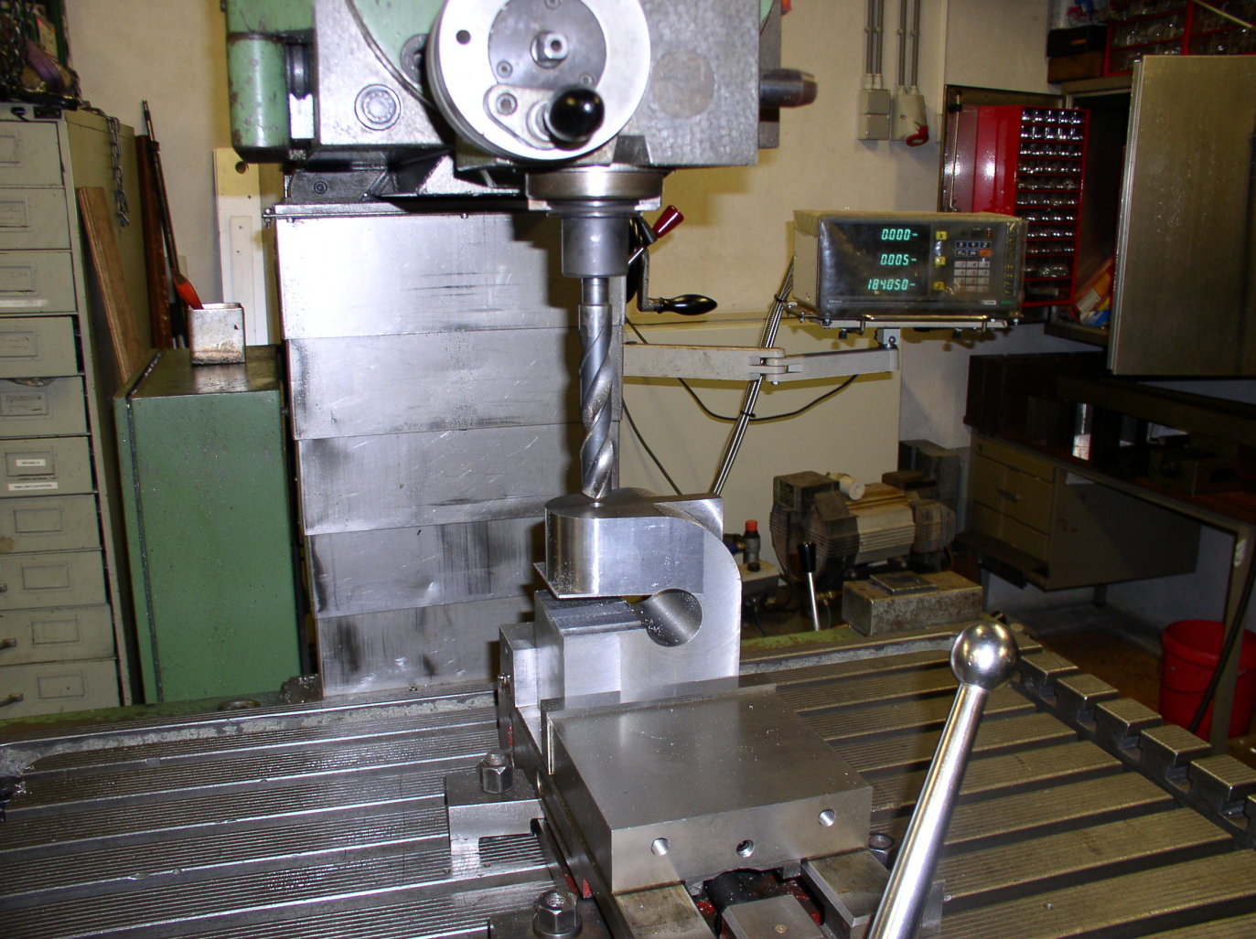

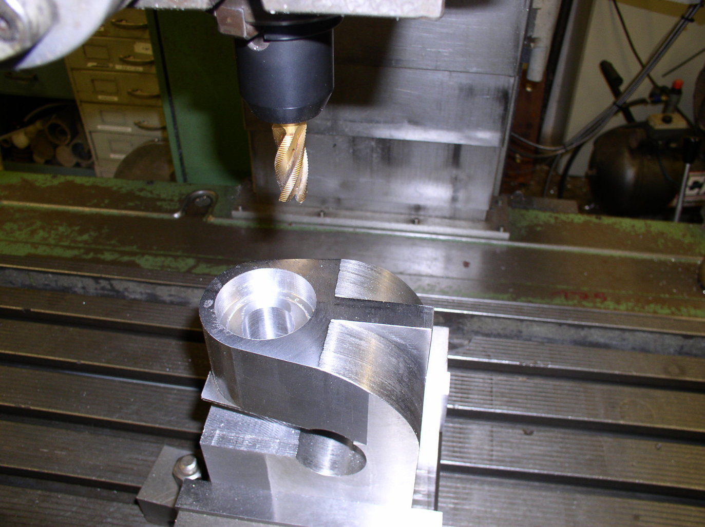

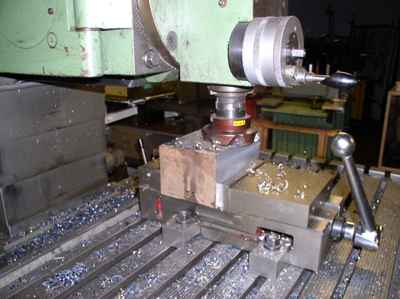

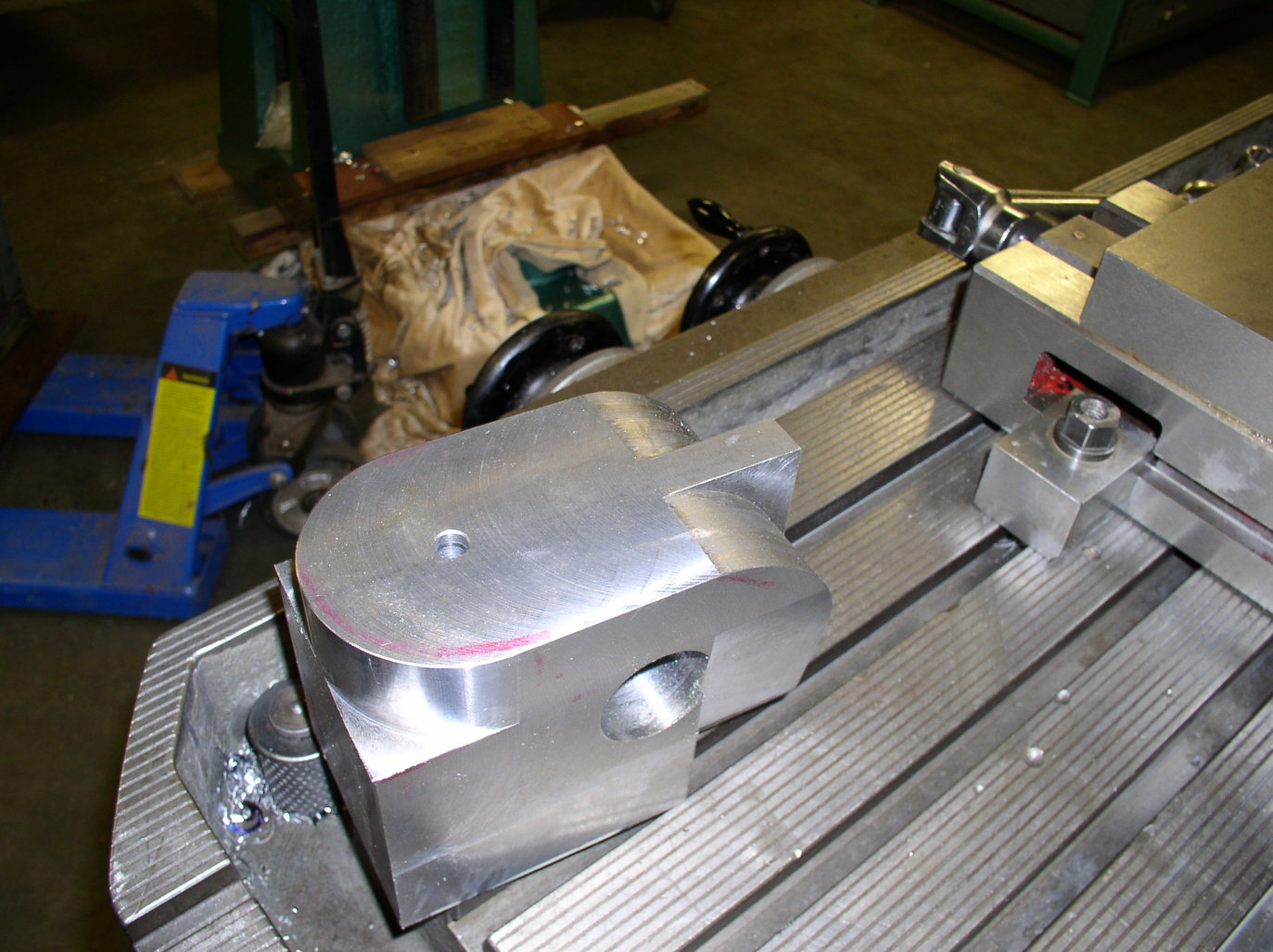

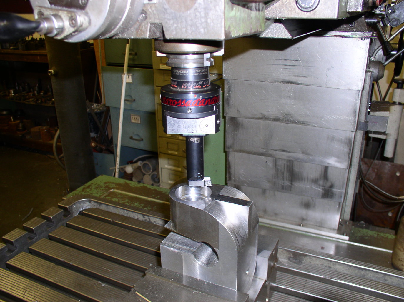

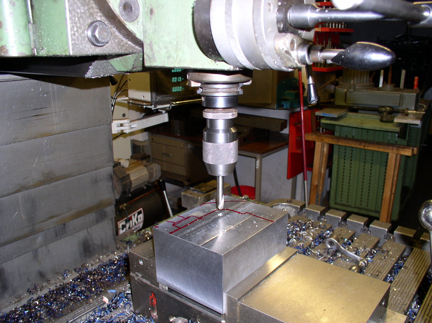

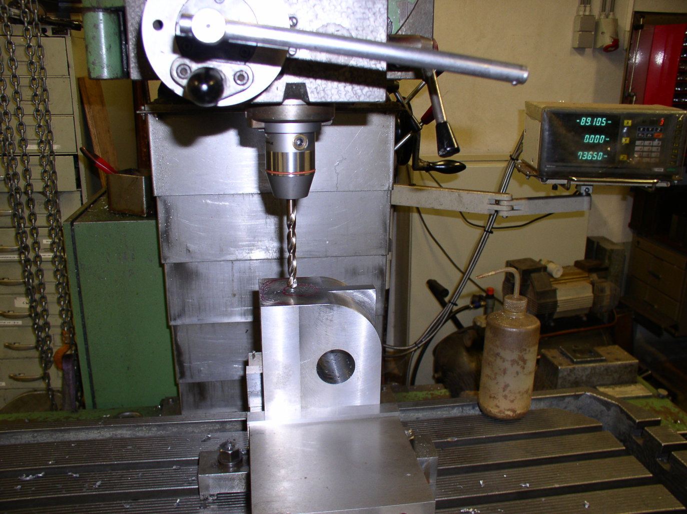

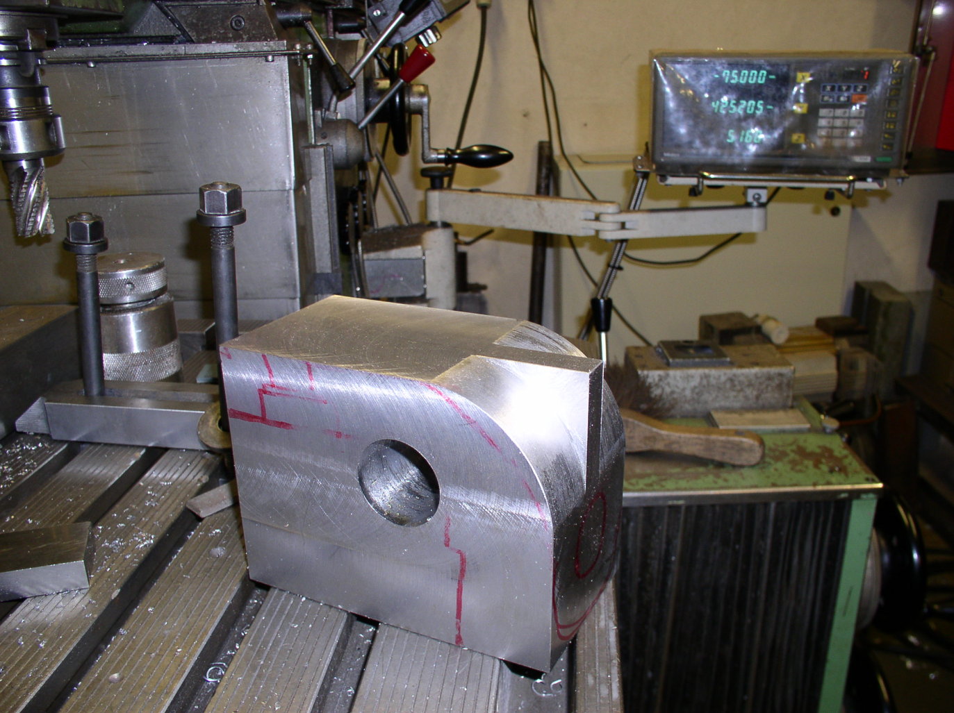

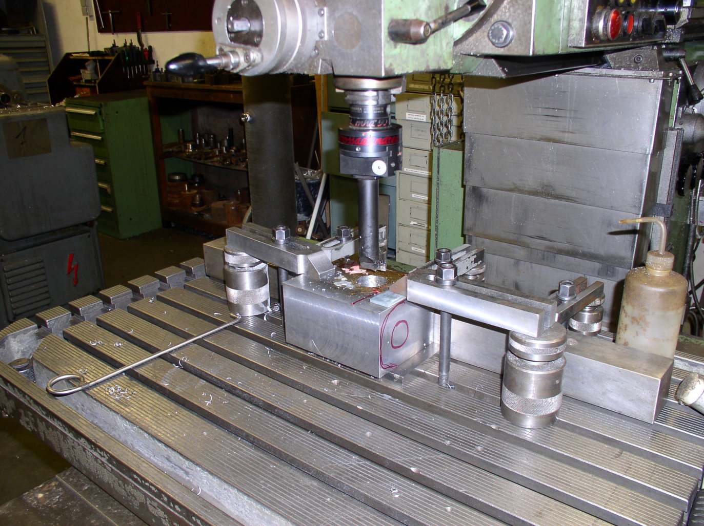

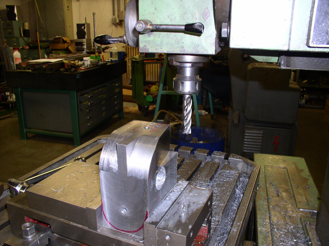

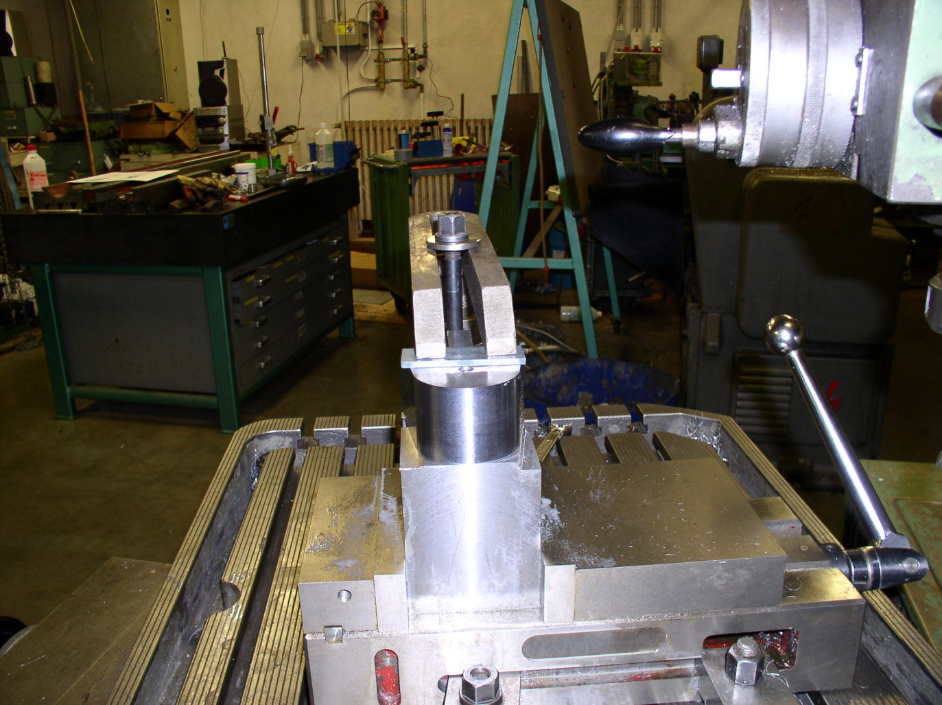

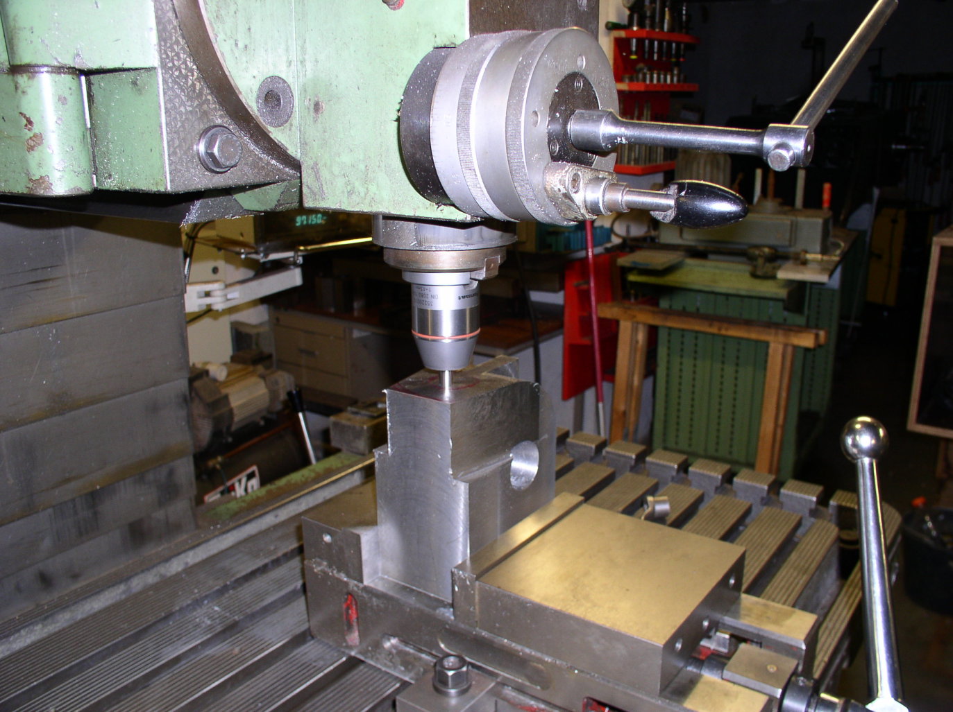

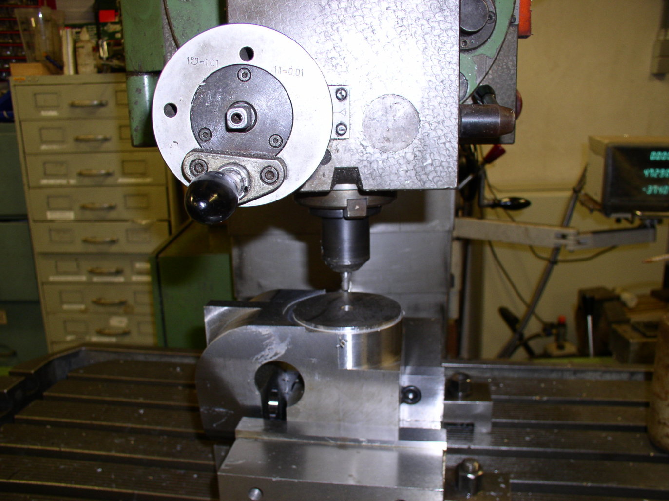

  6. #46

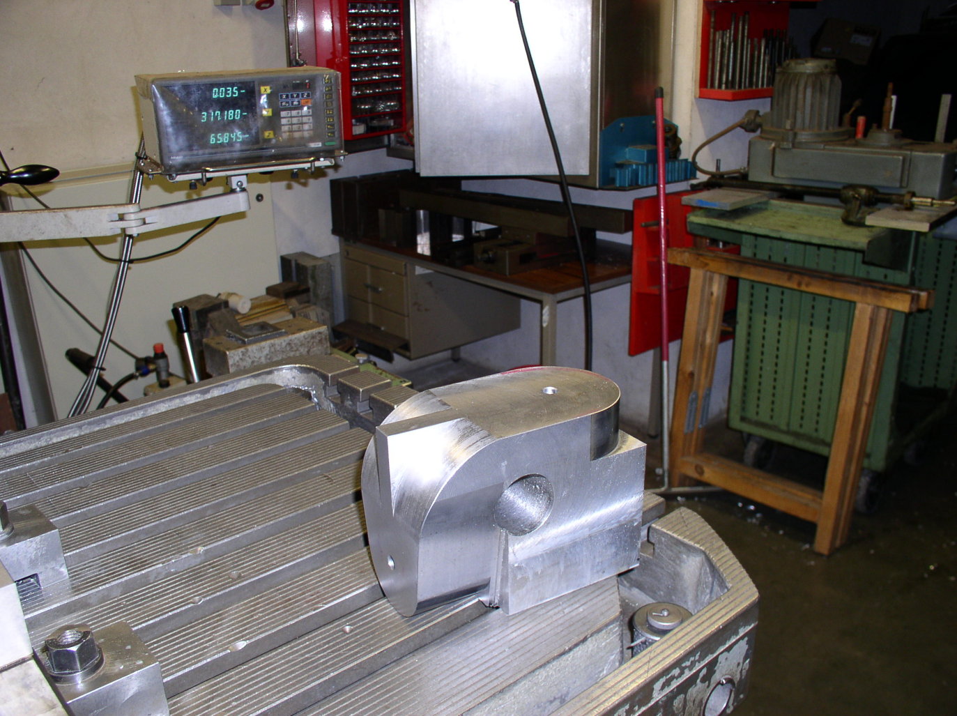

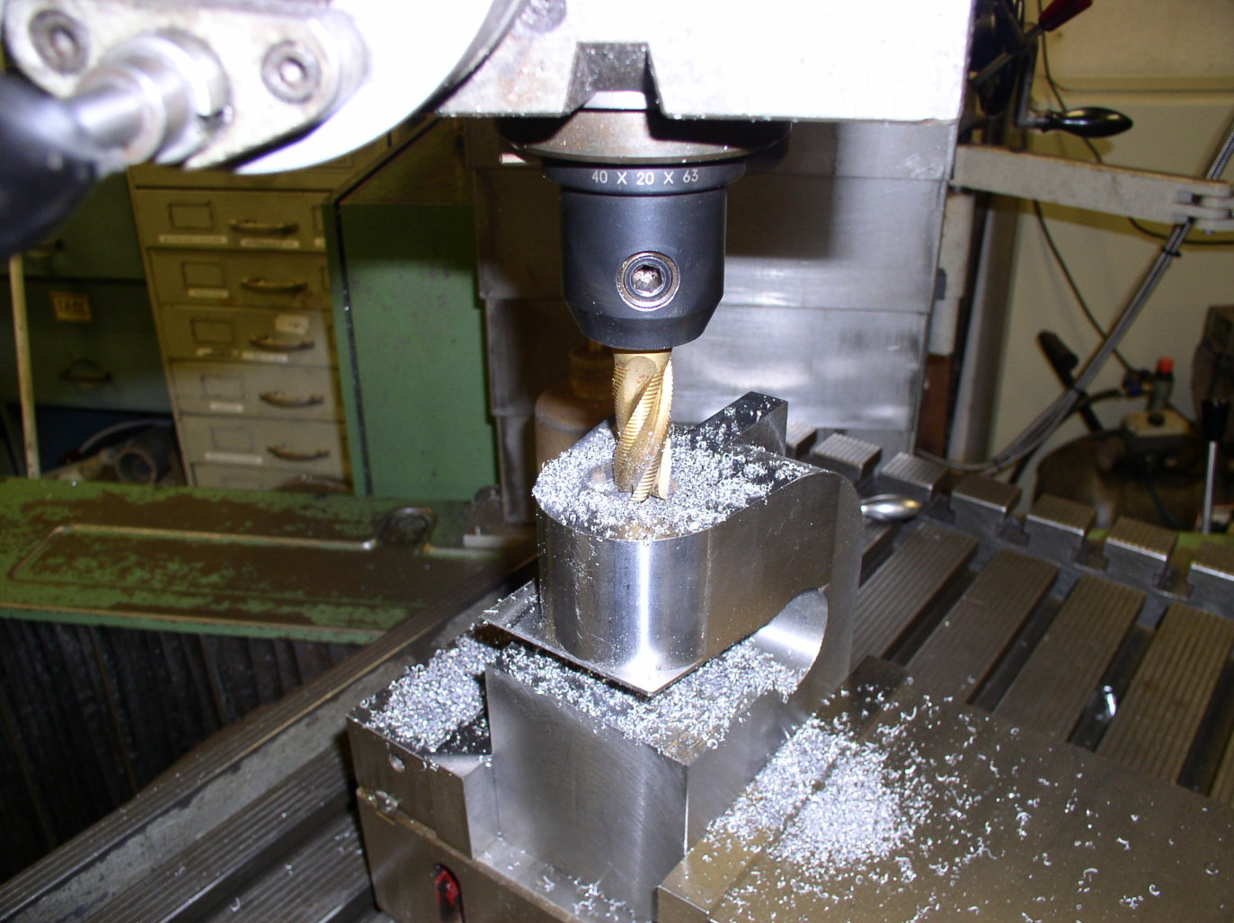

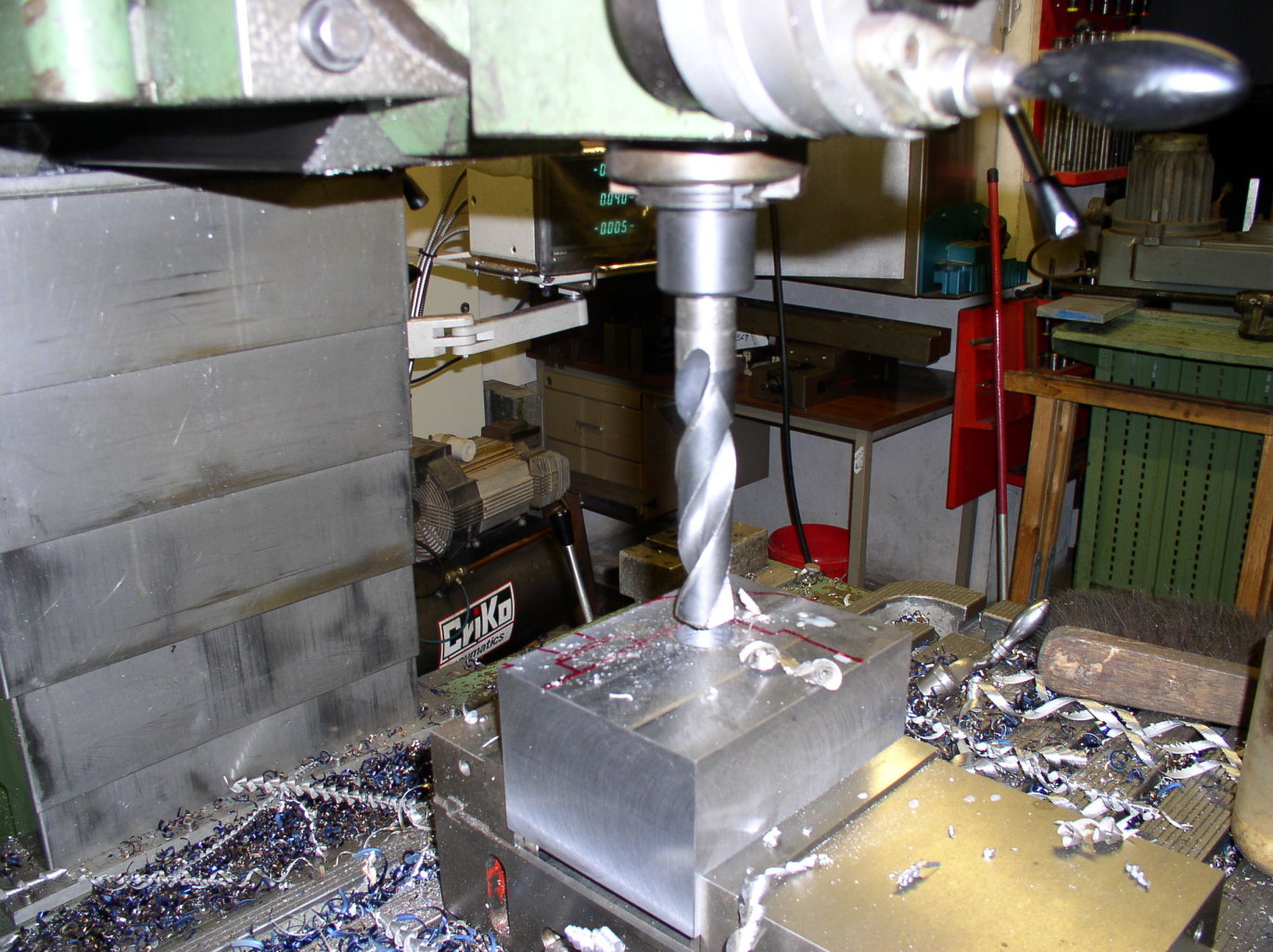

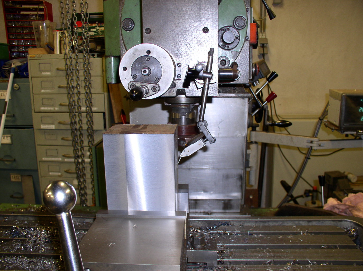

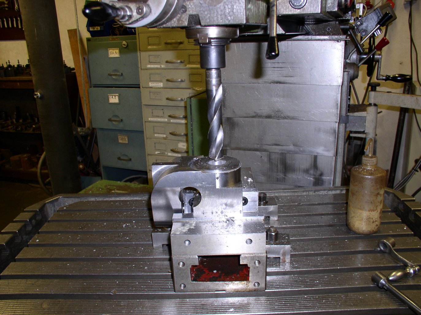

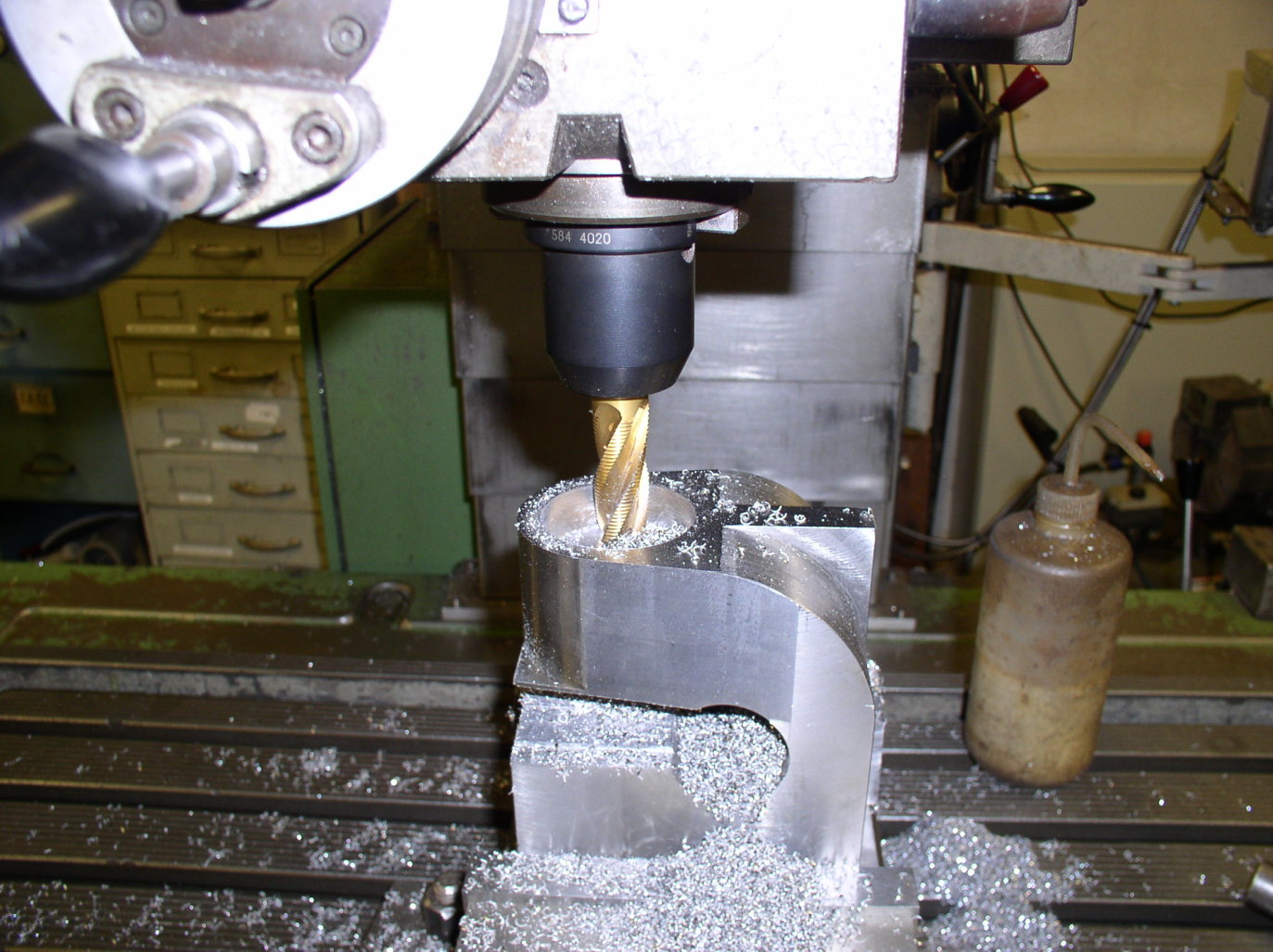

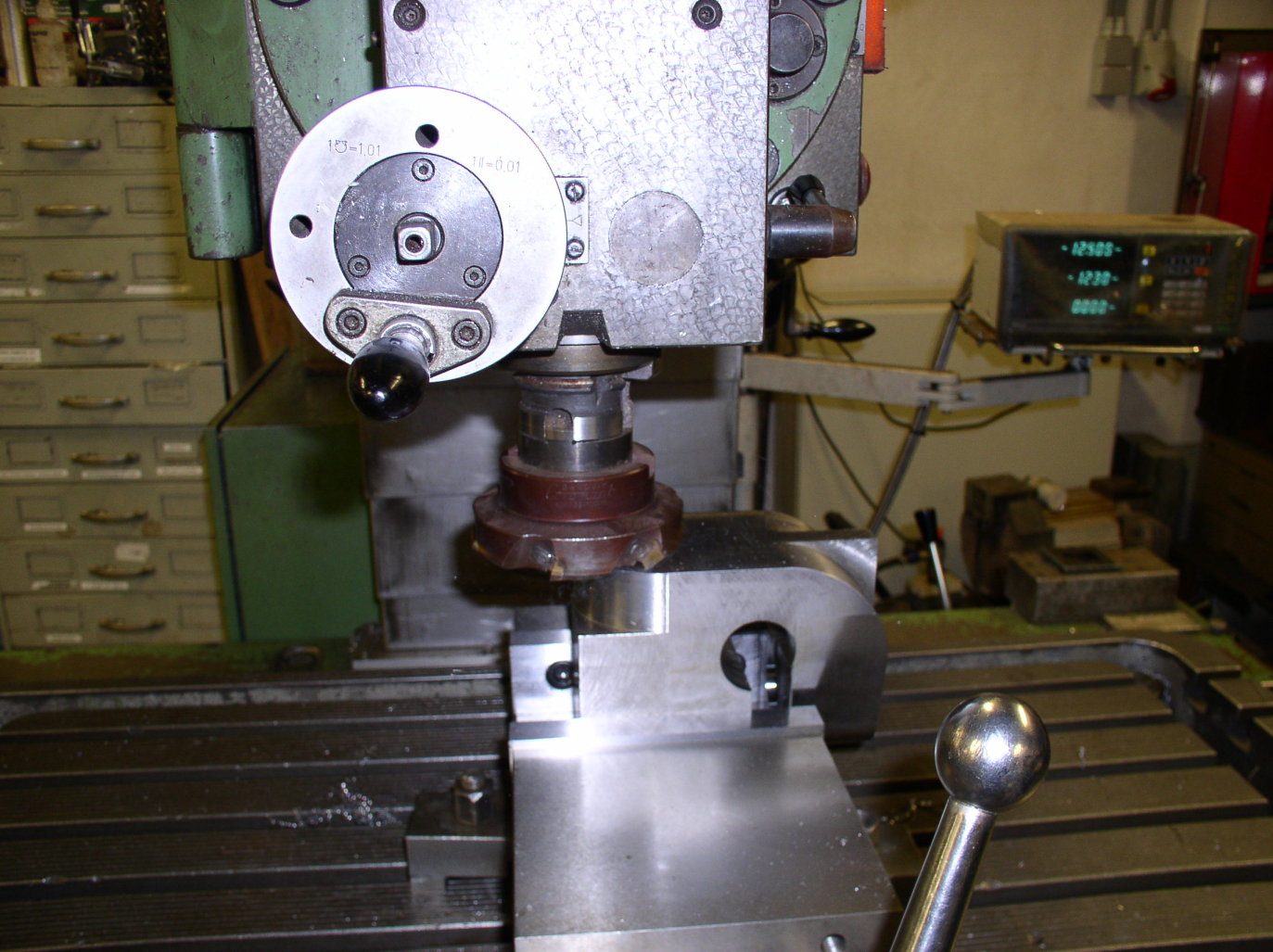

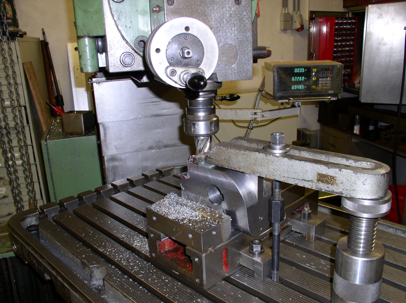

    Hello everyone,
    Here are a series of pictures of how a component from the Z axis is machined.
    This part is made of steel and it is one of the more complex parts I need.
    The series pics are self explanatory.
    And in the right order.
ID:	1514   Click image for larger version.
ID:	1521   Click image for larger version.
ID:	1522   Click image for larger version.

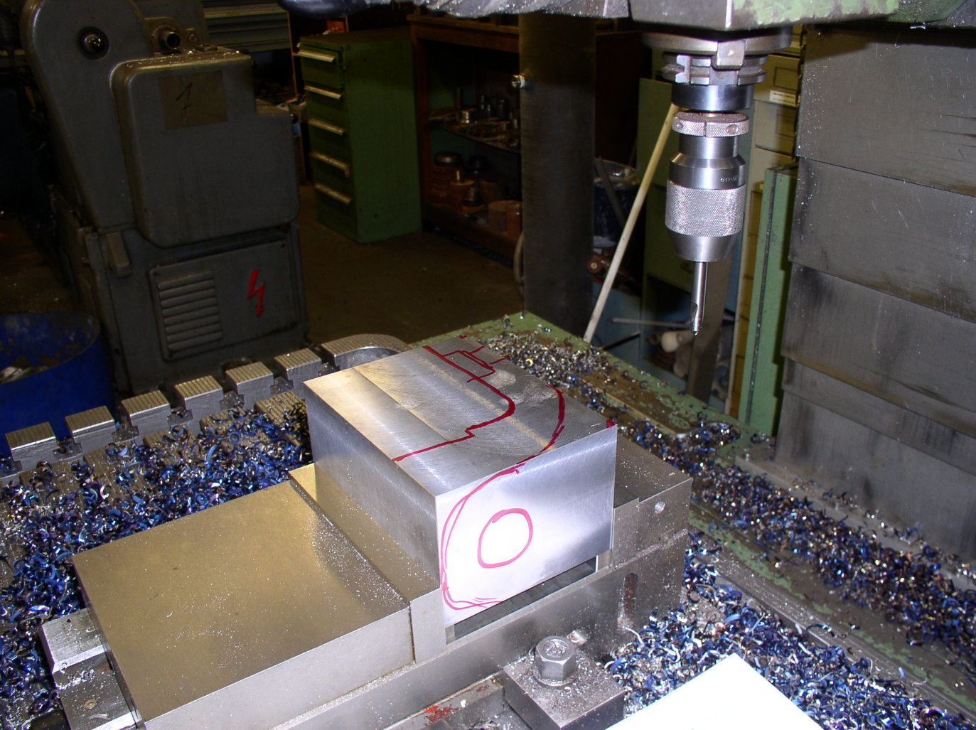

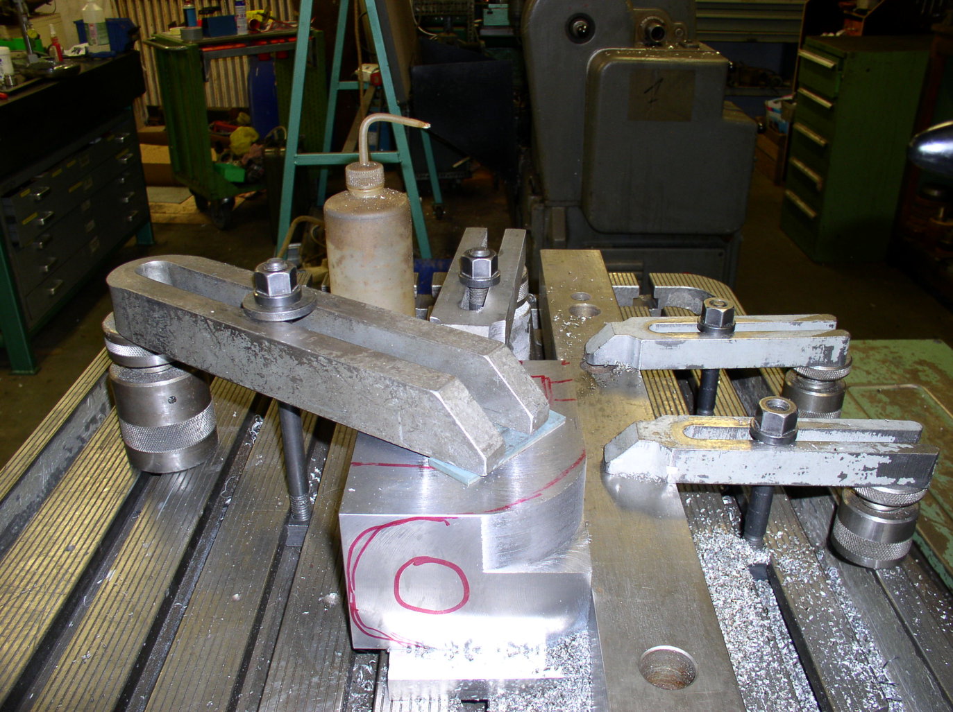

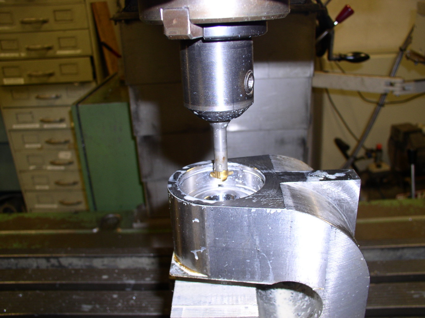

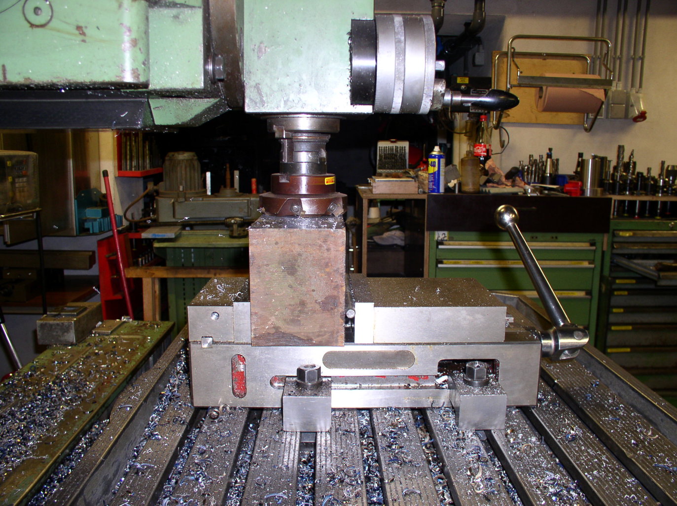

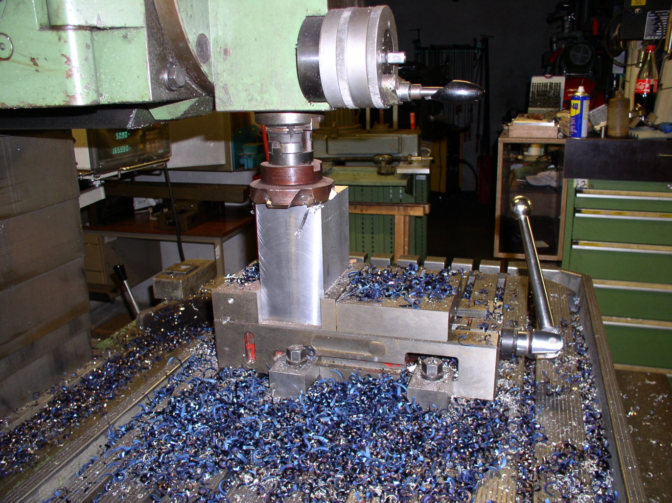

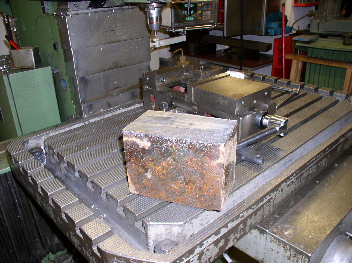

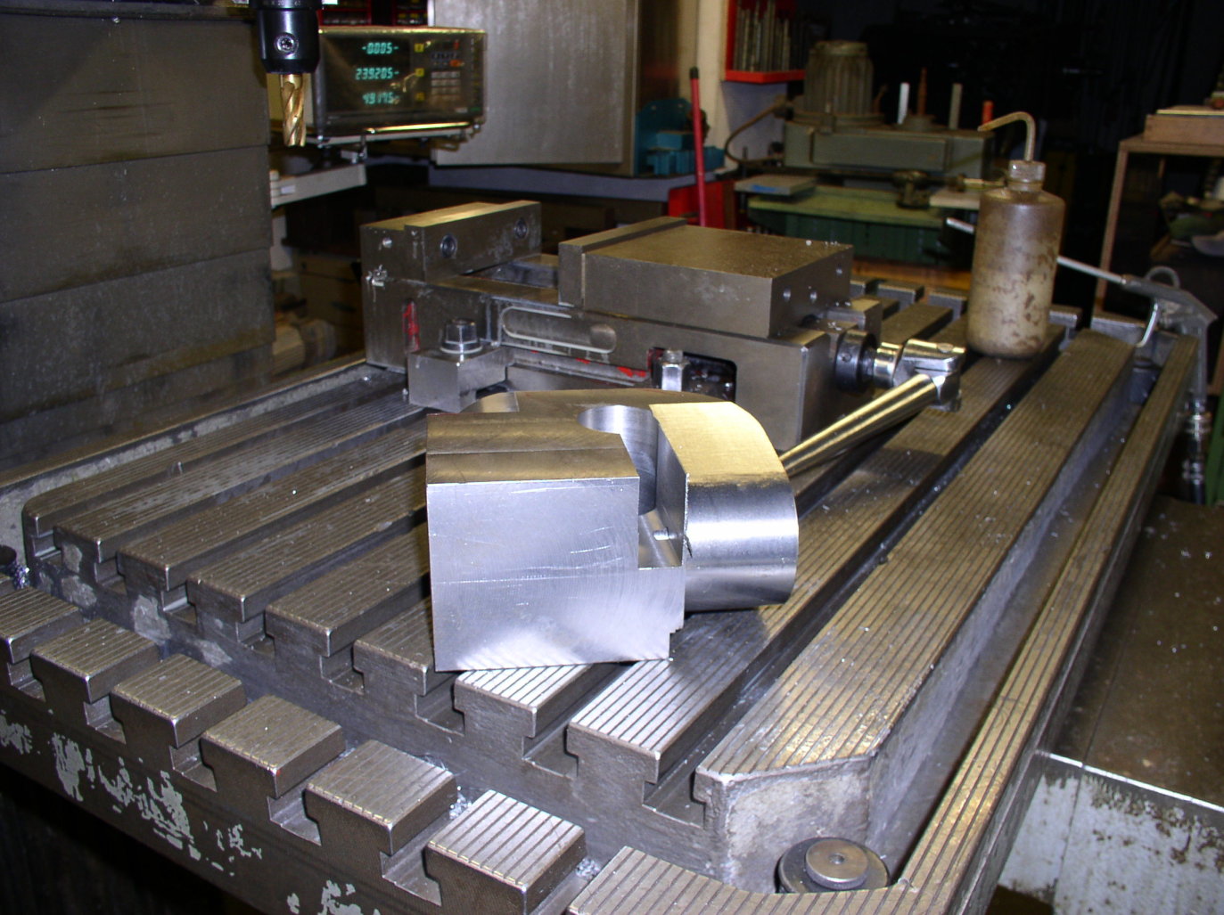

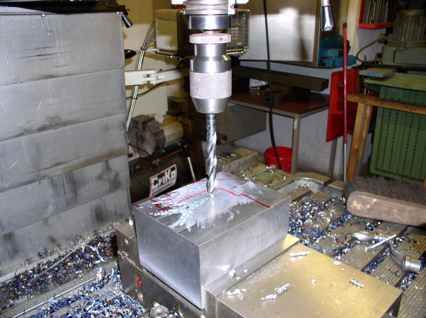

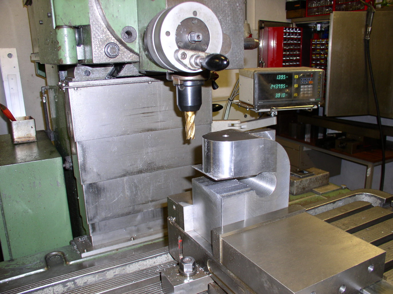

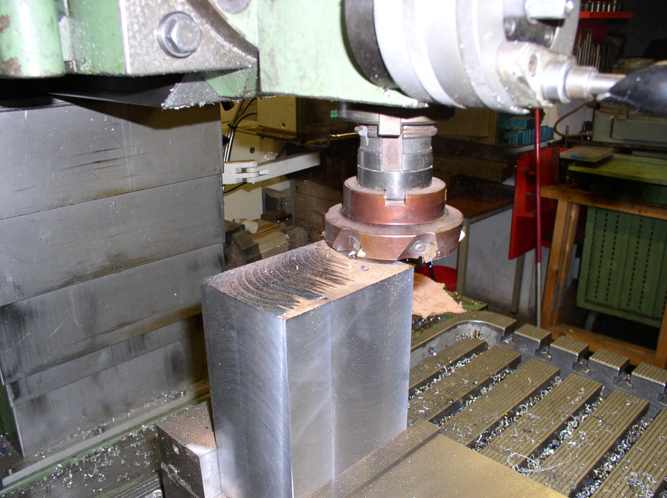

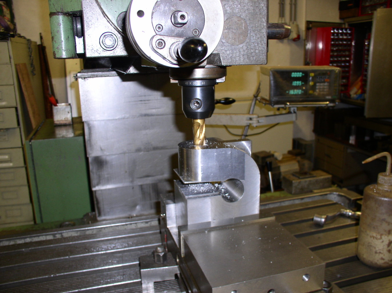

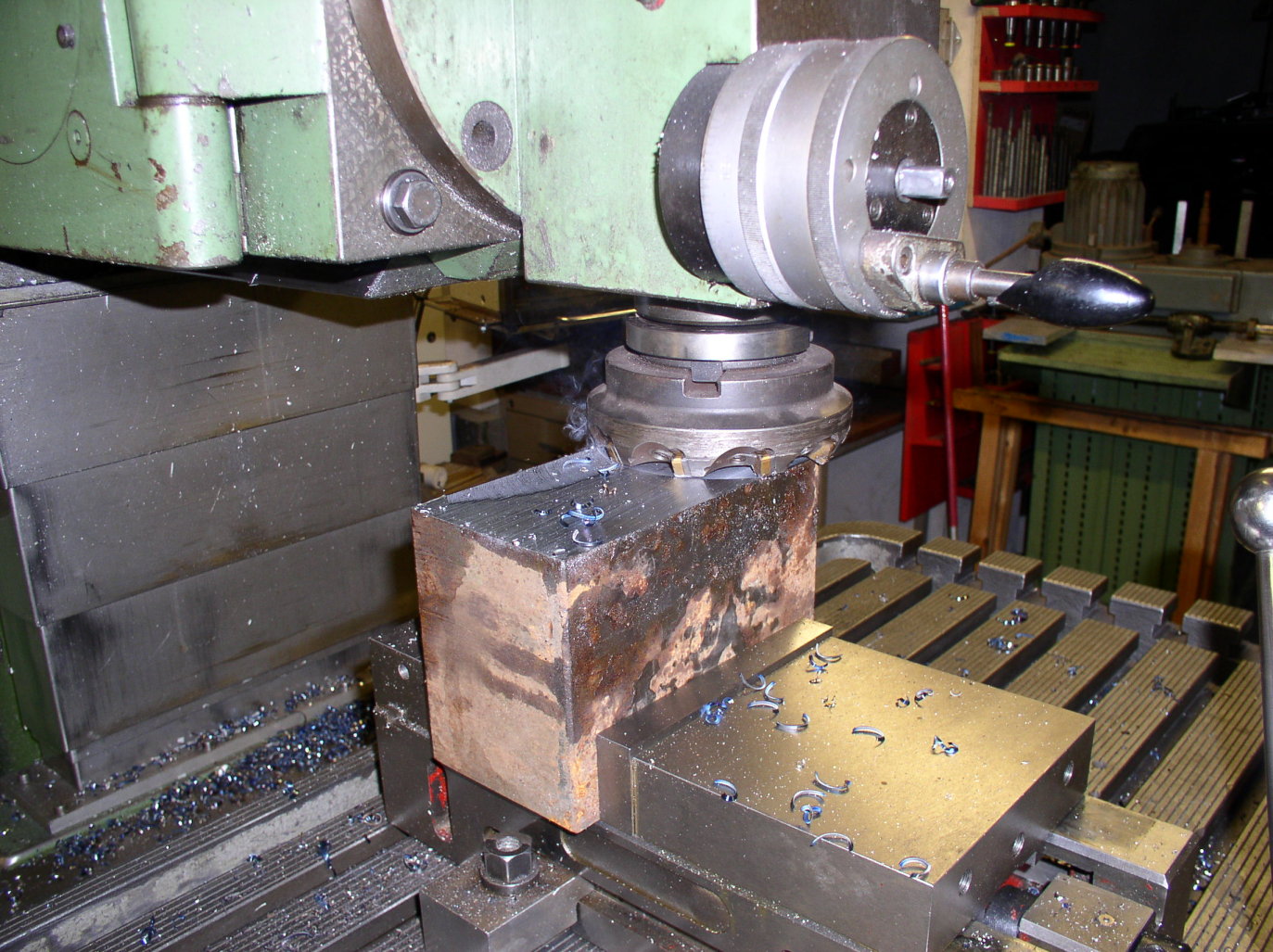

  7. #47
    More photo's
ID:	1515   Click image for larger version.
ID:	1516   Click image for larger version.
ID:	1517   Click image for larger version.
ID:	1518   Click image for larger version.
ID:	1519   Click image for larger version.
  8. #48
    Tip drawing the outline on the workpiece itself so you can see what ultimately the part will be.
    Also as much material will be removed make sure that there is material left
    to machine after the biggest piece is removed because the workpiece will deform by tensions in the material.
