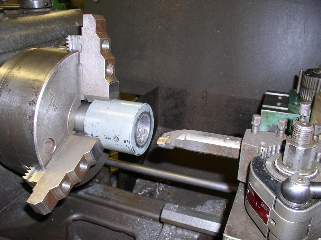

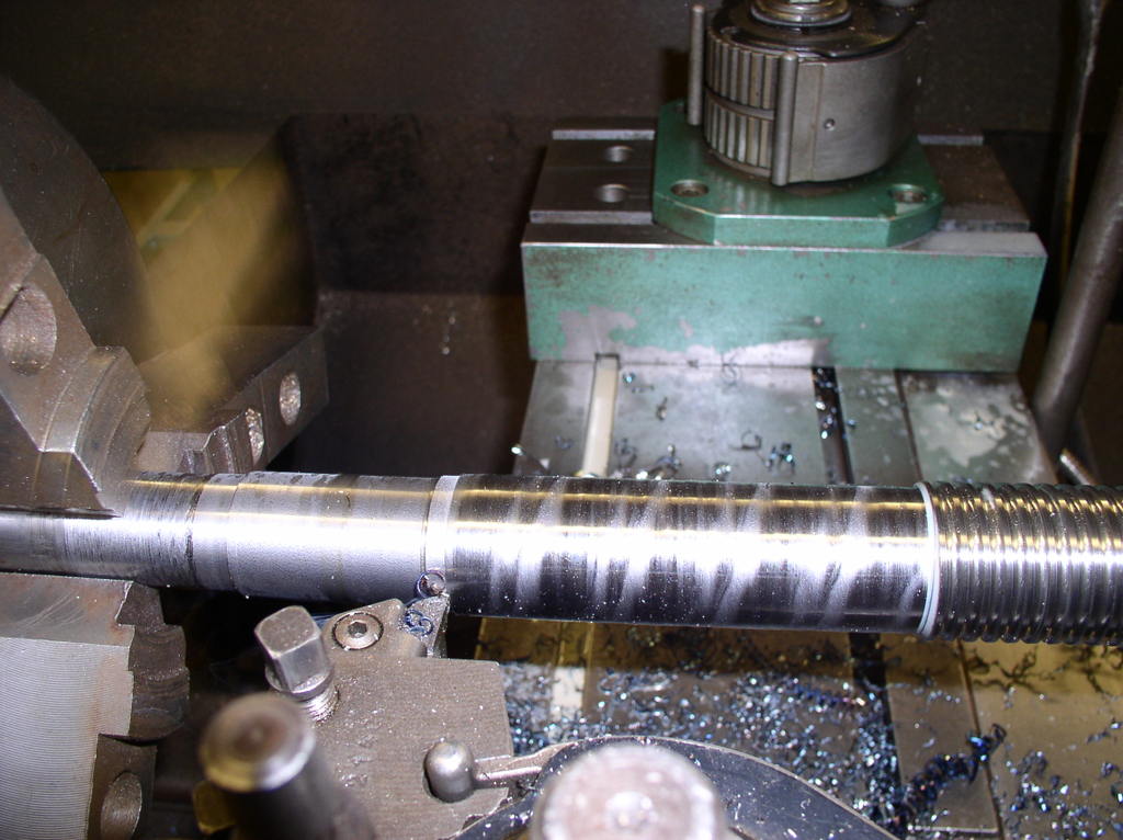

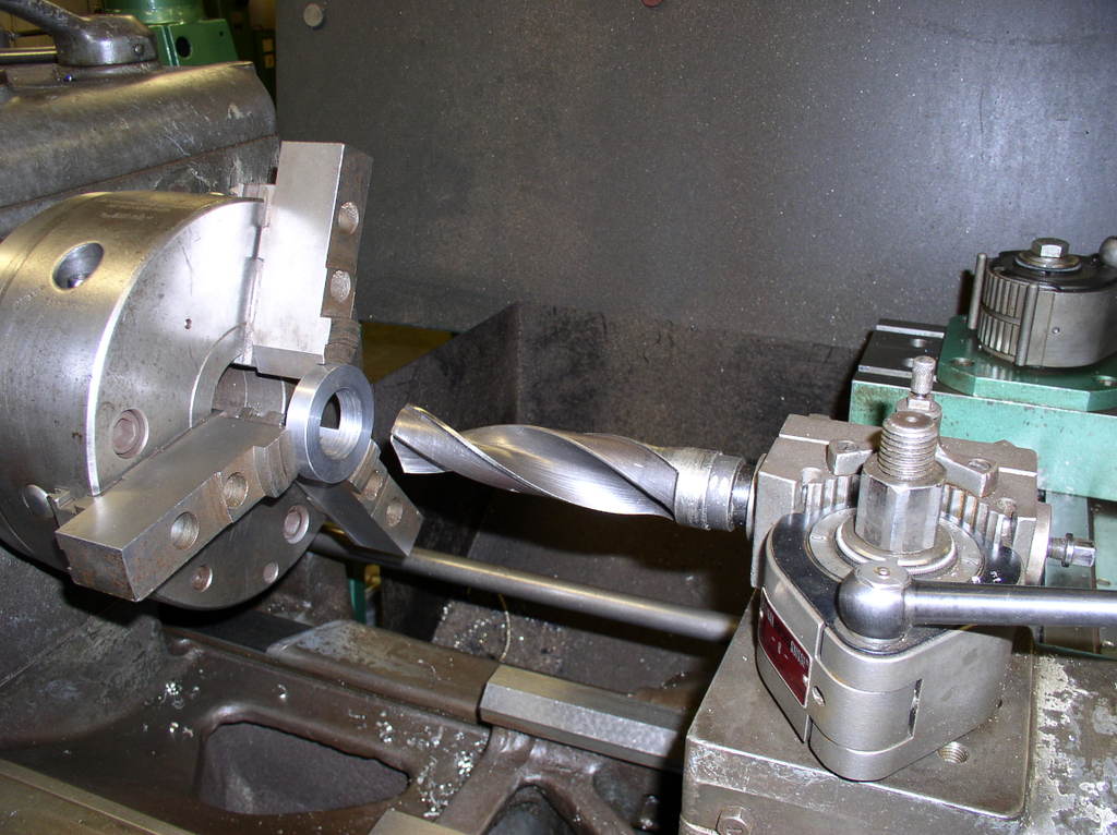

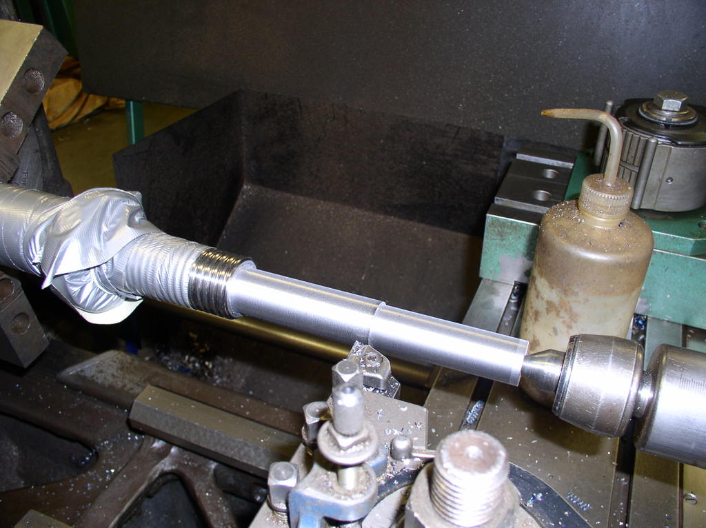

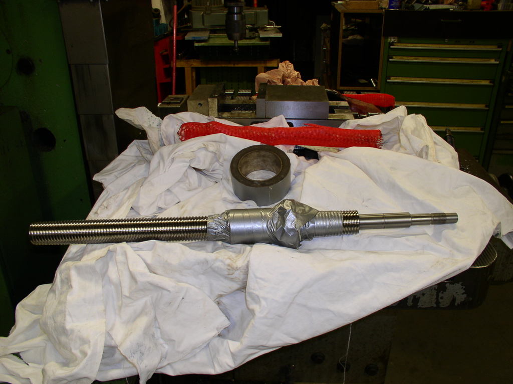

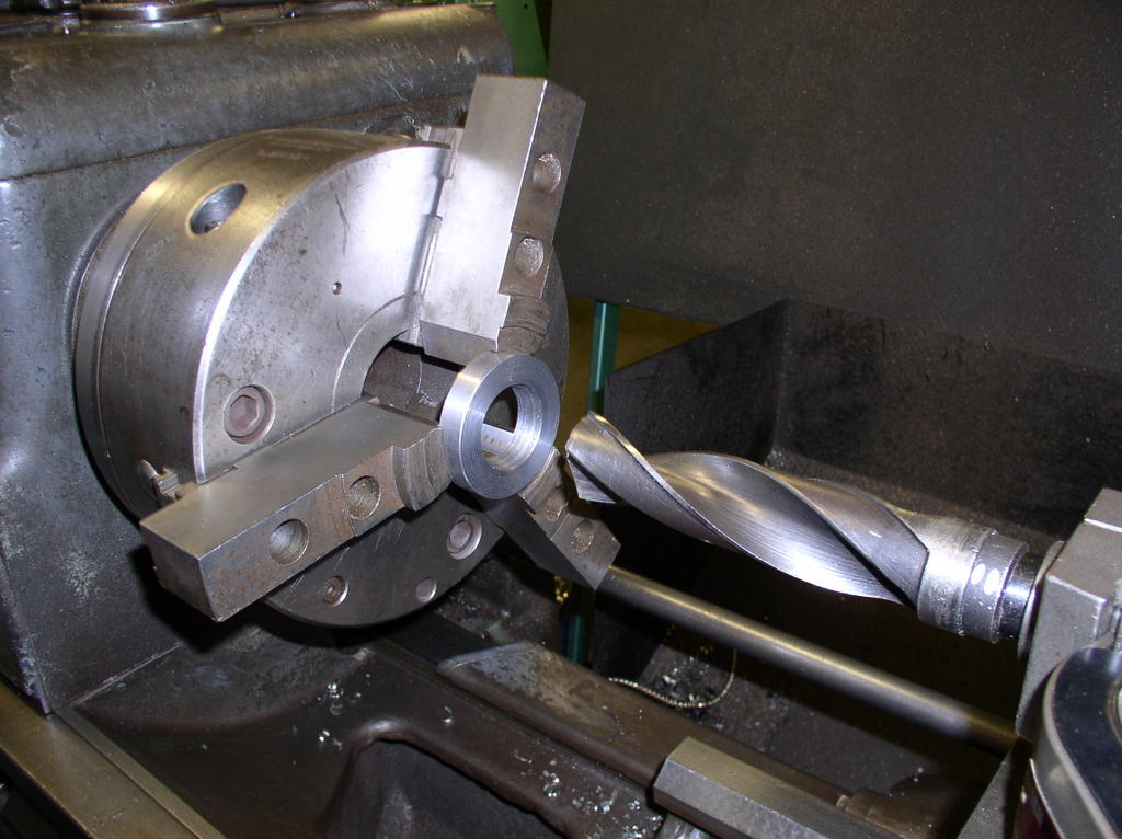

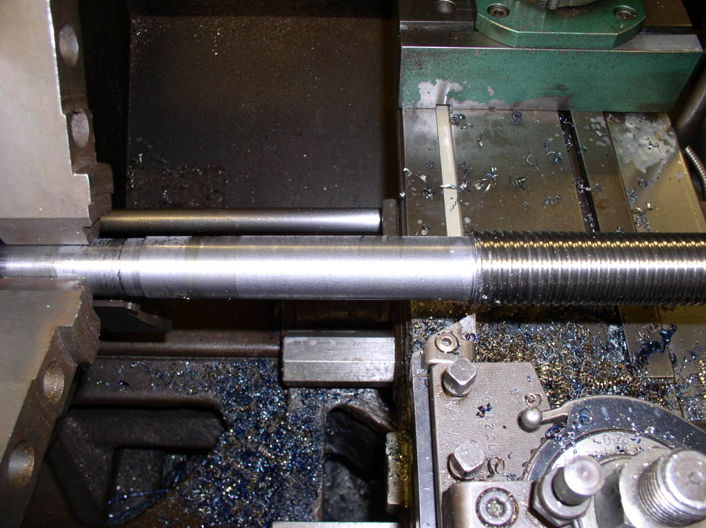

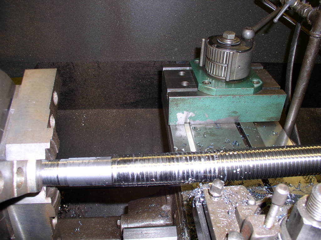

    Hello here we are again.
    After a number of other urgent matters I had to make do, I can focus my attention back to the beaver mill.
    The first thing I did was the existing ball crew adjusted to the new situation,
    Starting with the removal of the hardened layer on the lathe.

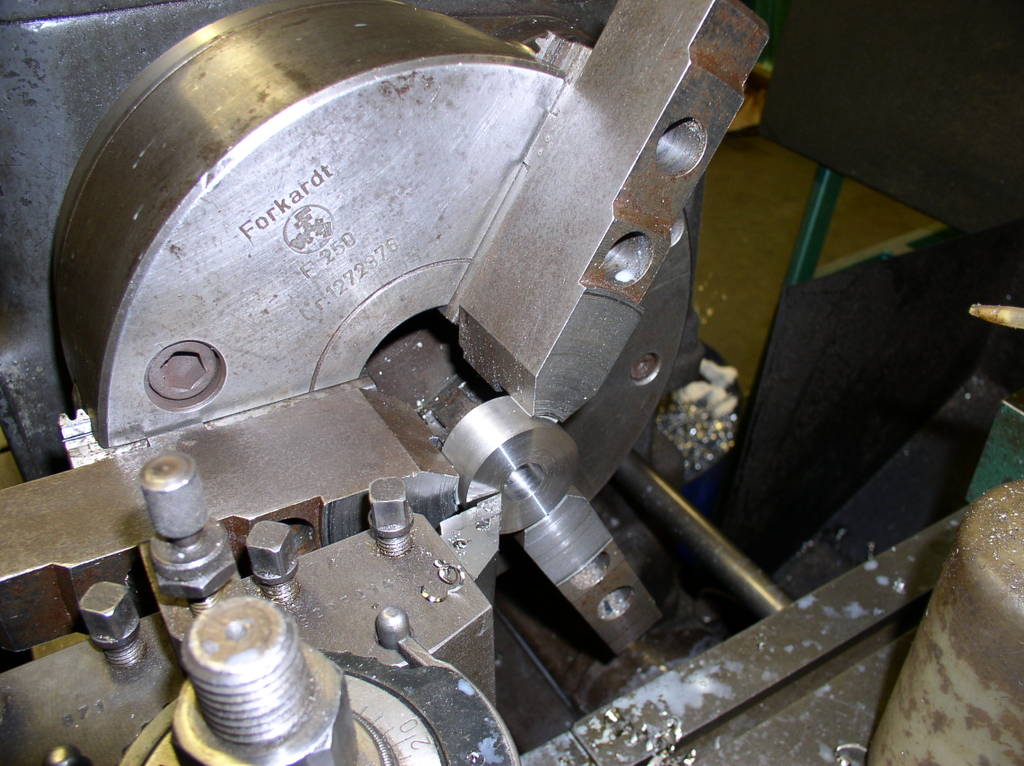

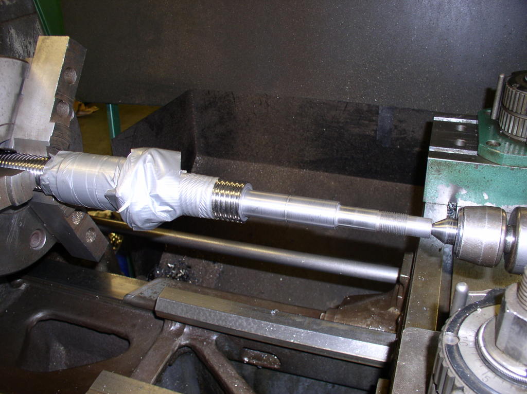

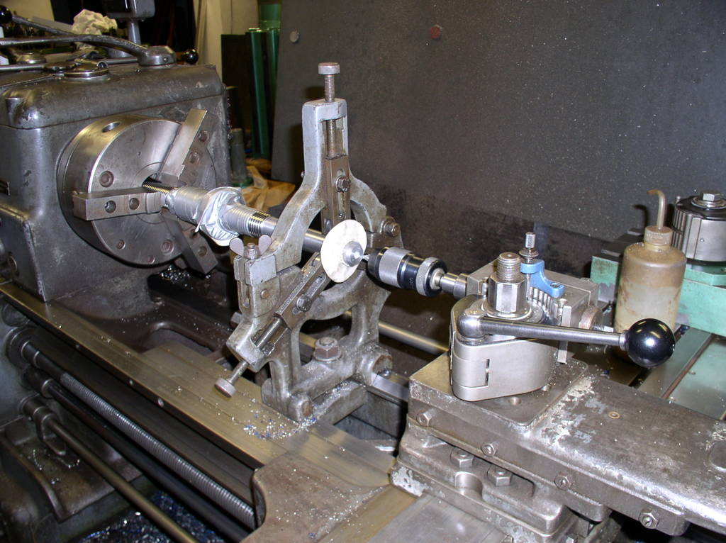

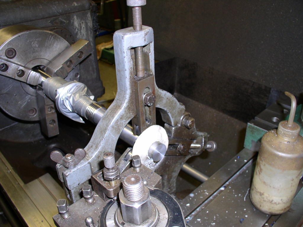

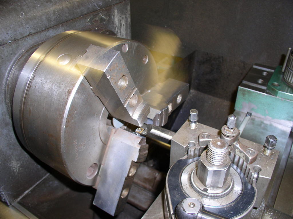

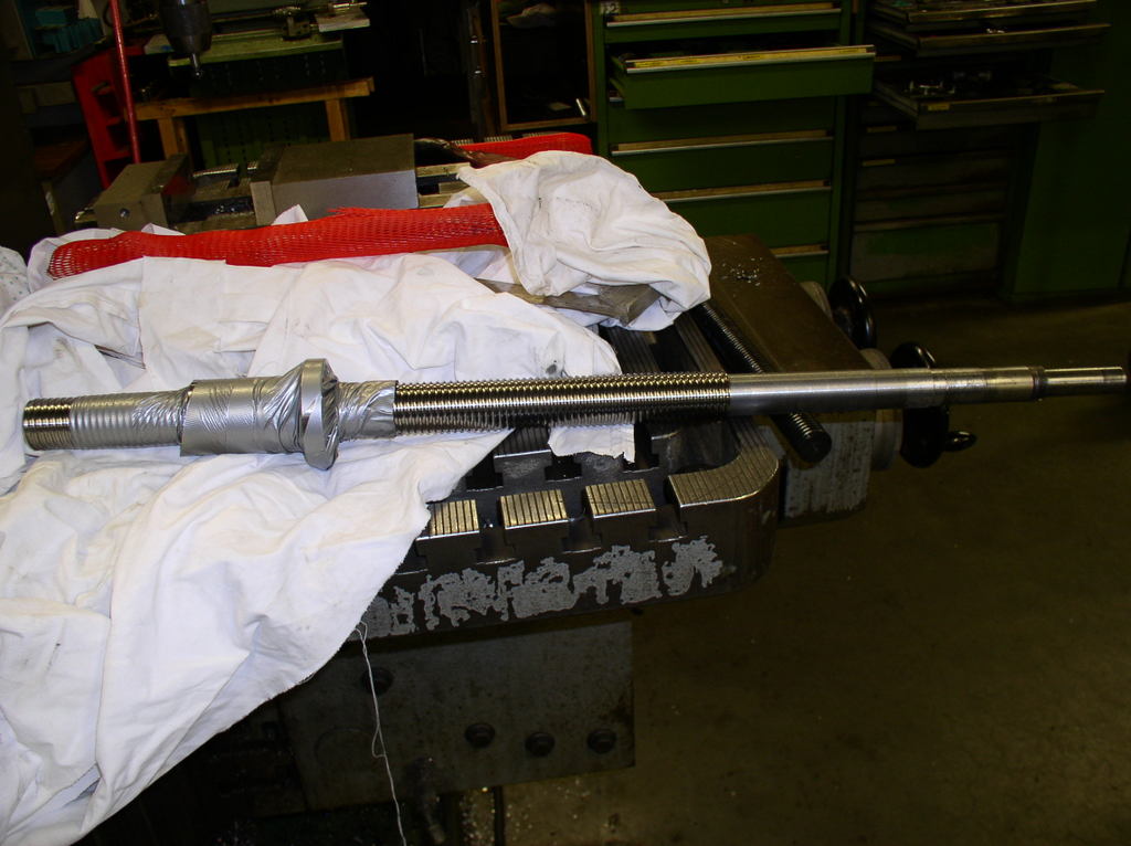

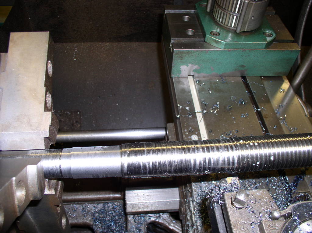

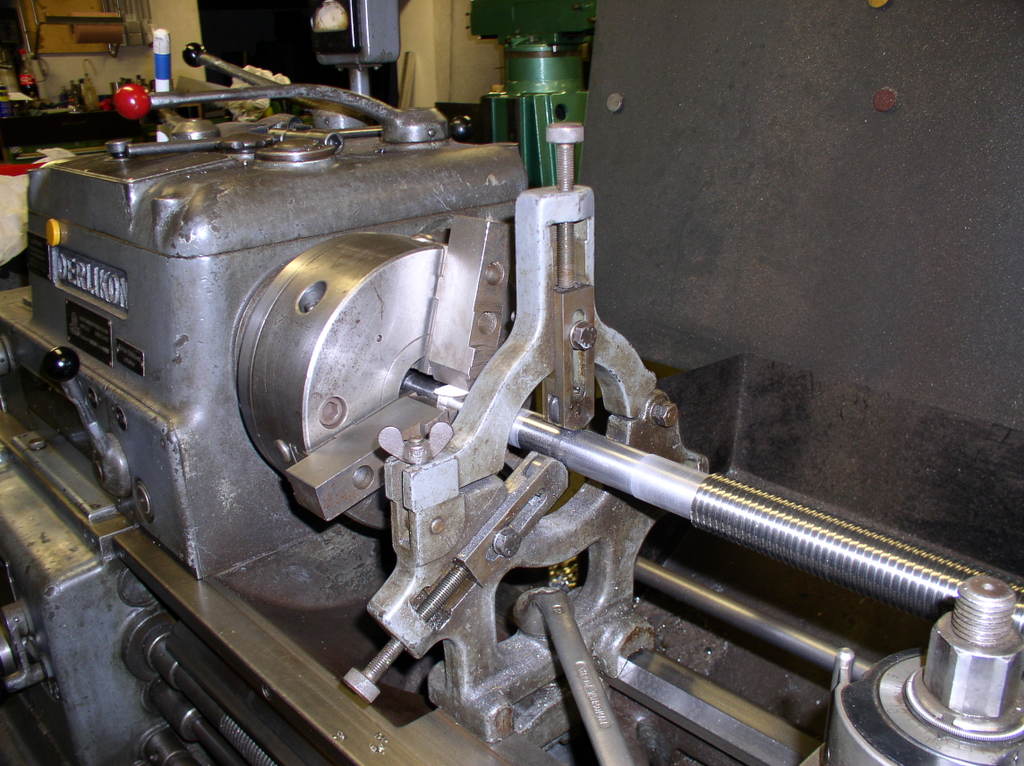

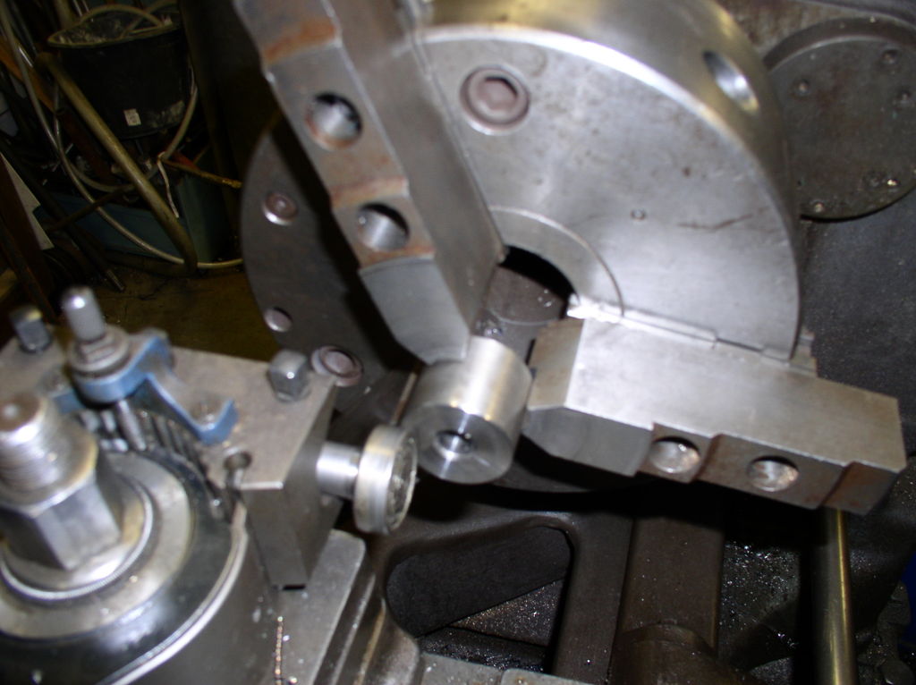

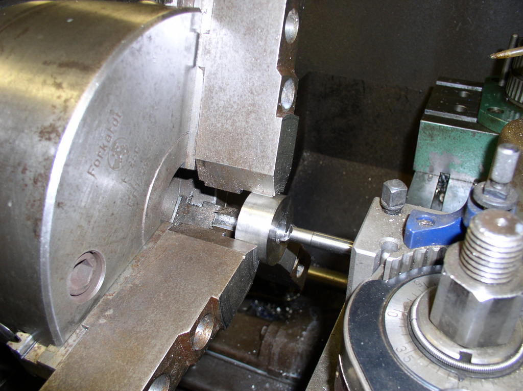

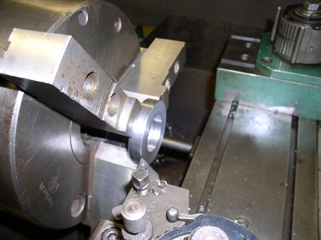

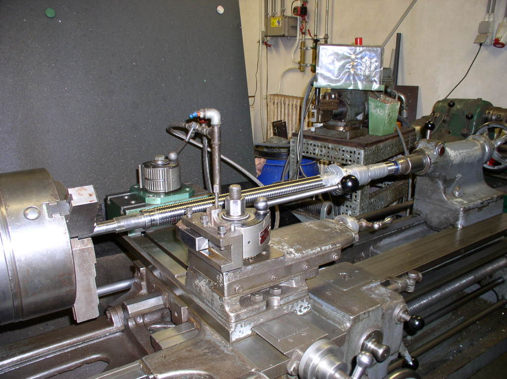

  4. #64

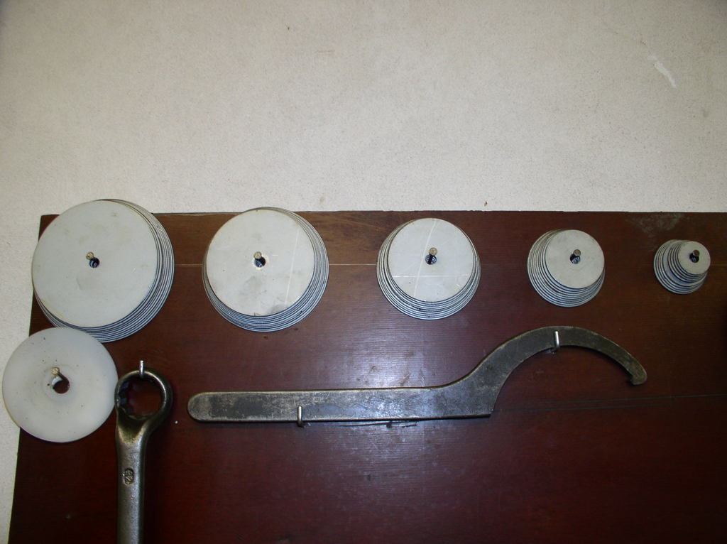

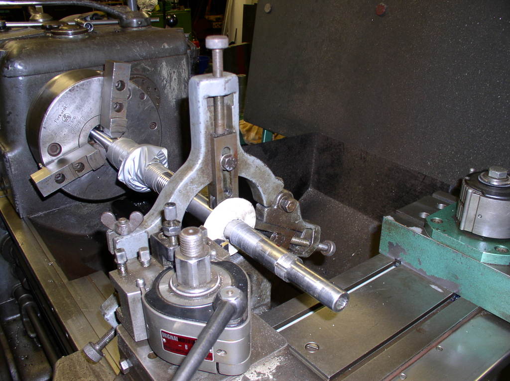

    After removing the hard layer I put on a steady rest (A support that is clamped to the bed of a lathe,
    used when machining a long workpiece. Sometimes
    called a center rest.).
    And then I flipped the piece and cut the rest matriaal
    off.
    But first I have the chuck jaws to suit the ball screw,I have a number of different sizes of washers to put between the jaws to support them during turning .I turn them to the right dimension in this case 40 mm so I will not damage the part. After cutting off the exes material I make a new center whit a center drill.

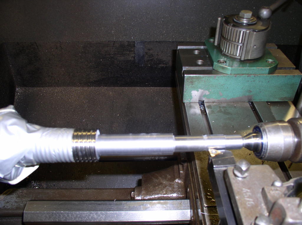

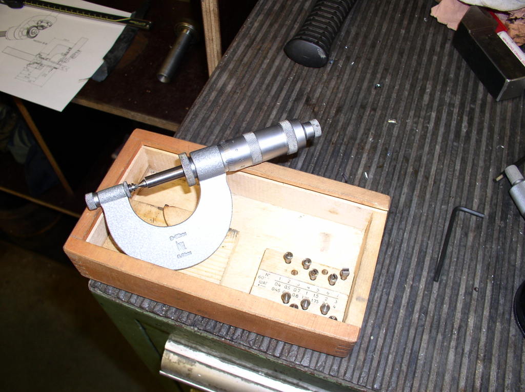

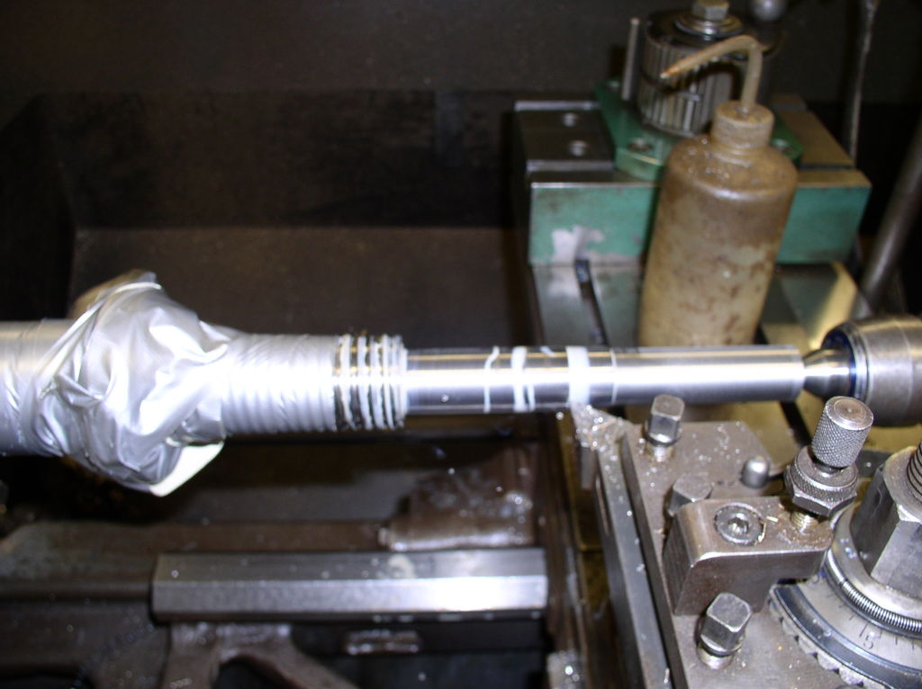

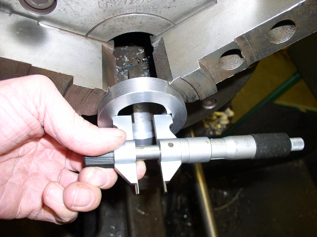

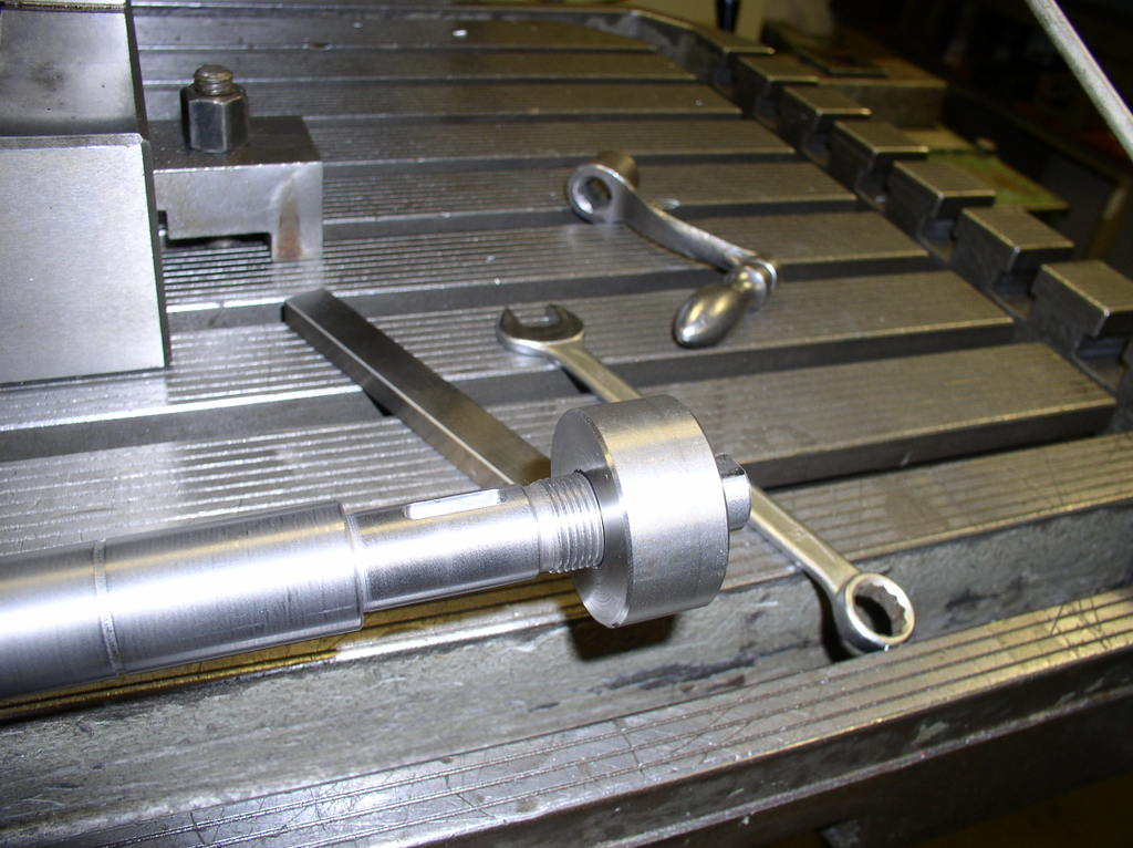

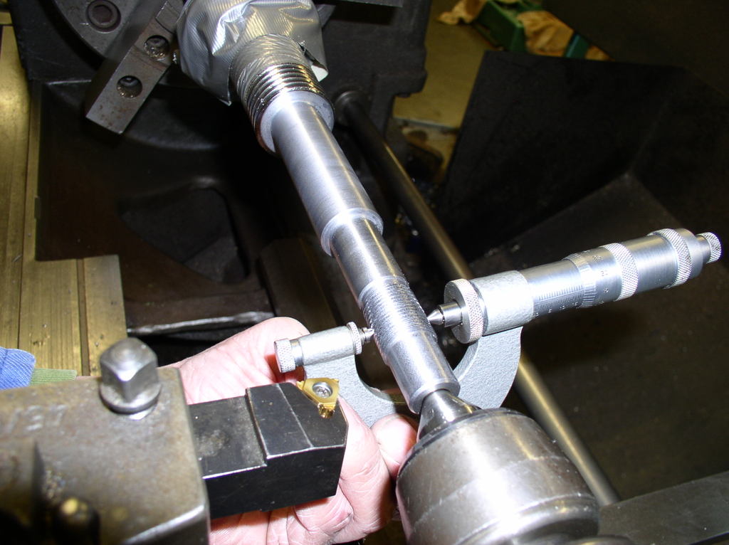

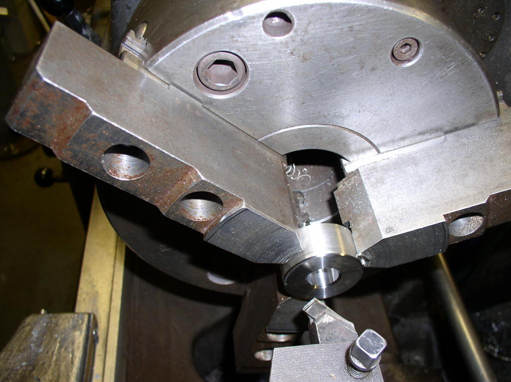

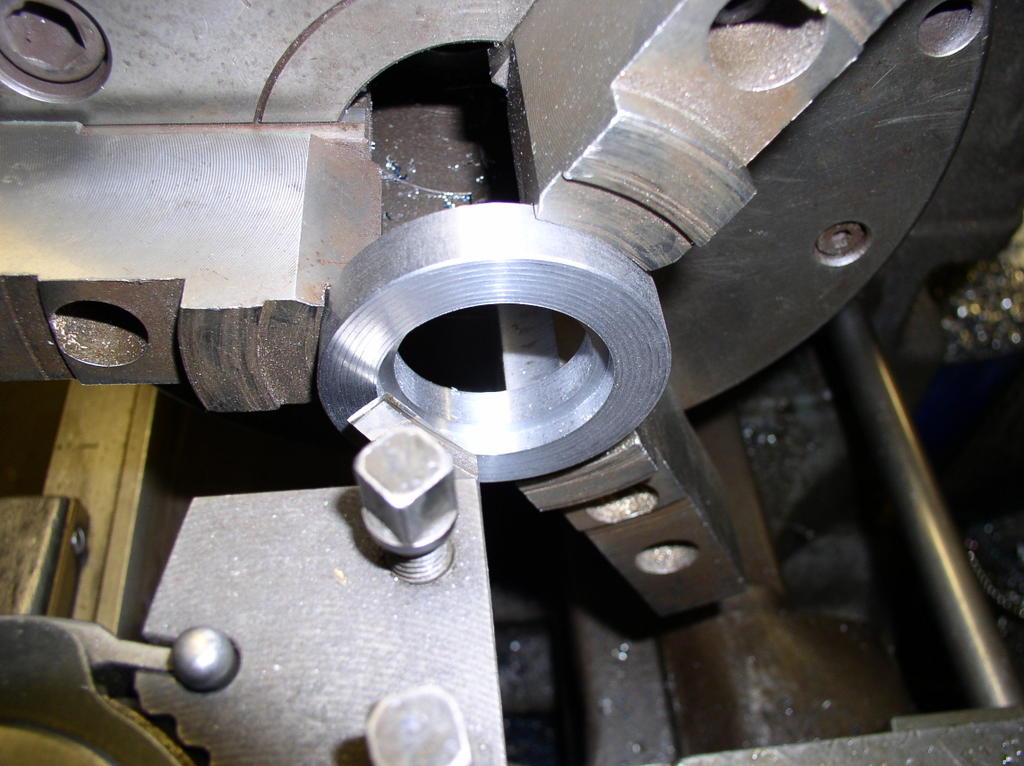

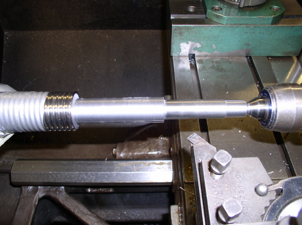

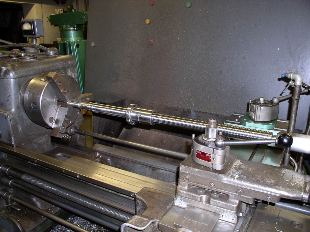

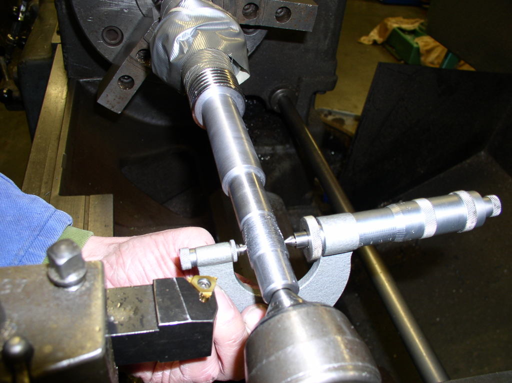

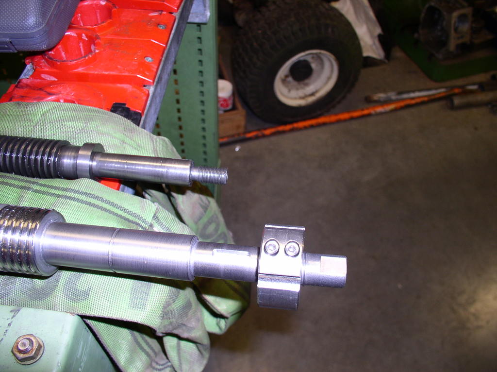

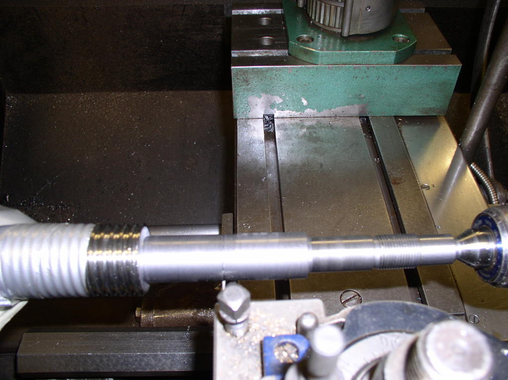

  5. #65
    Then I removed the steady rest and the finished part and Put On Some tread for the nut and make a groove for a circlips I am using a caliper to measure the tread

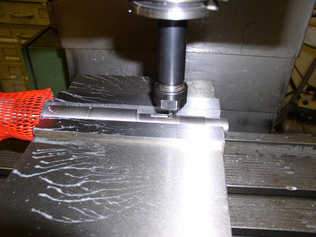

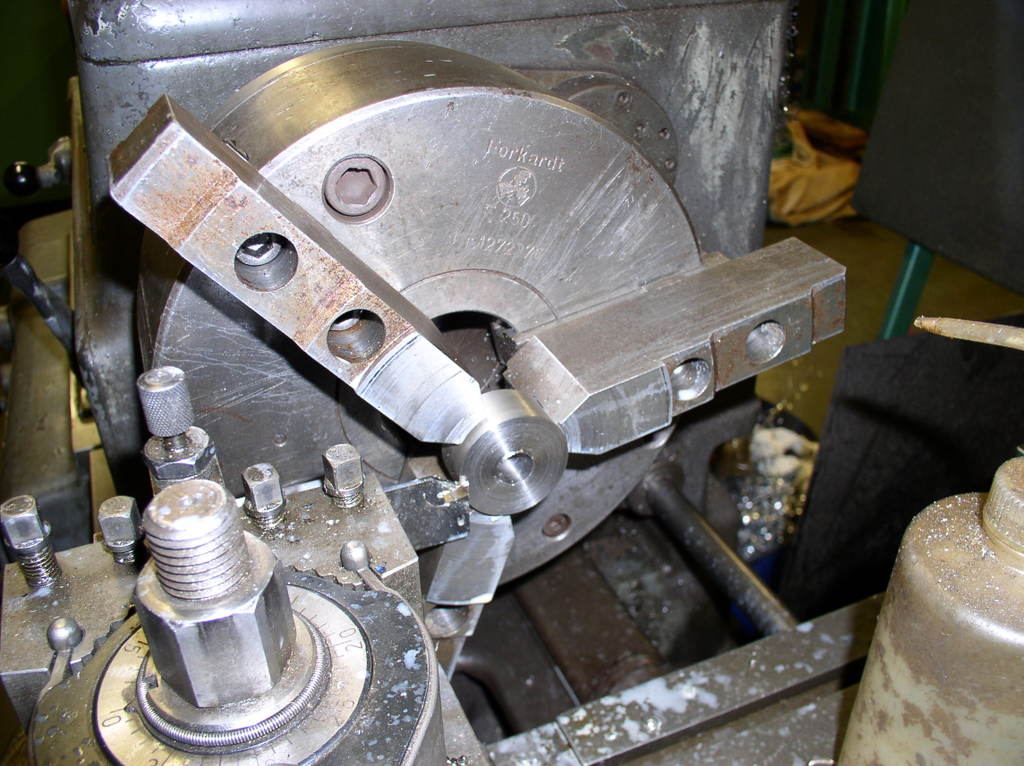

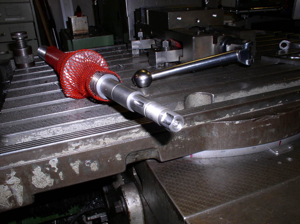

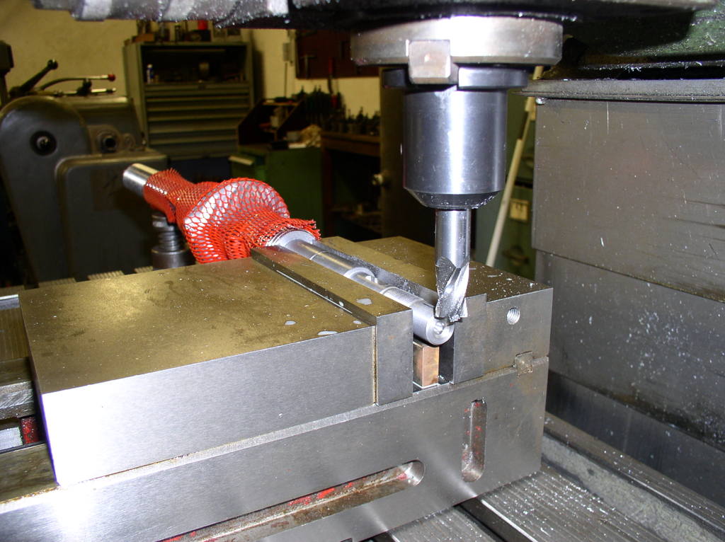

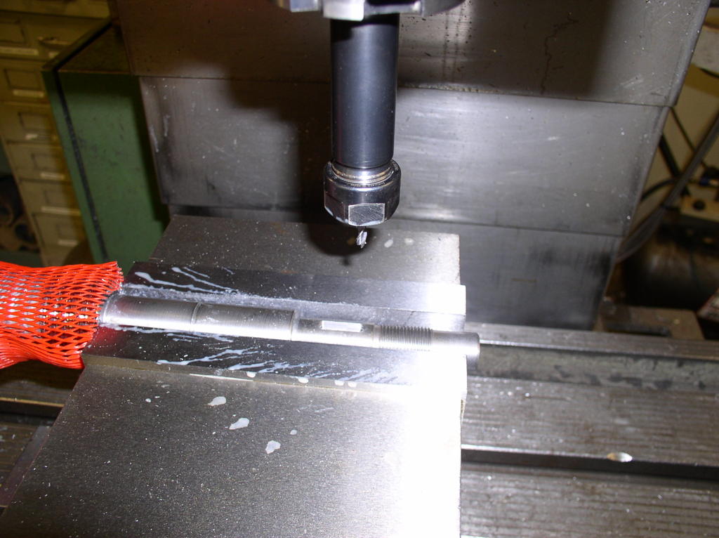

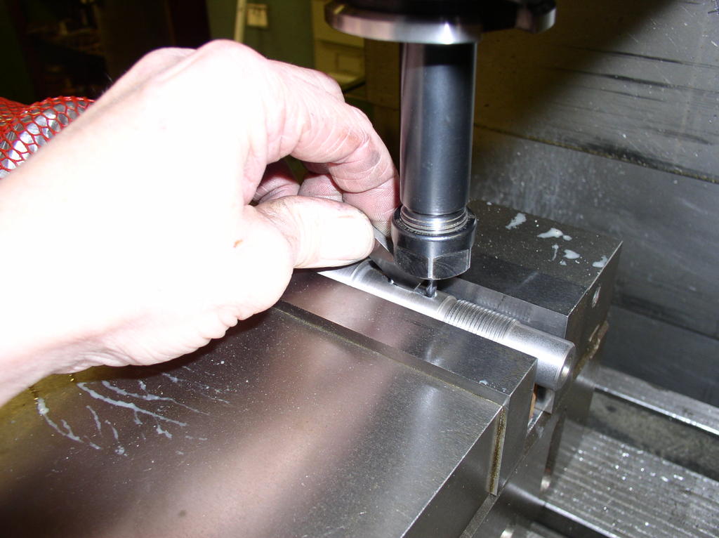

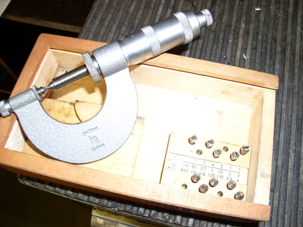

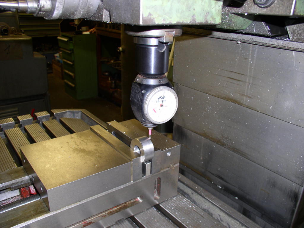

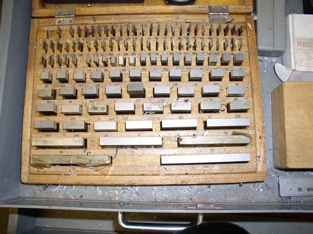

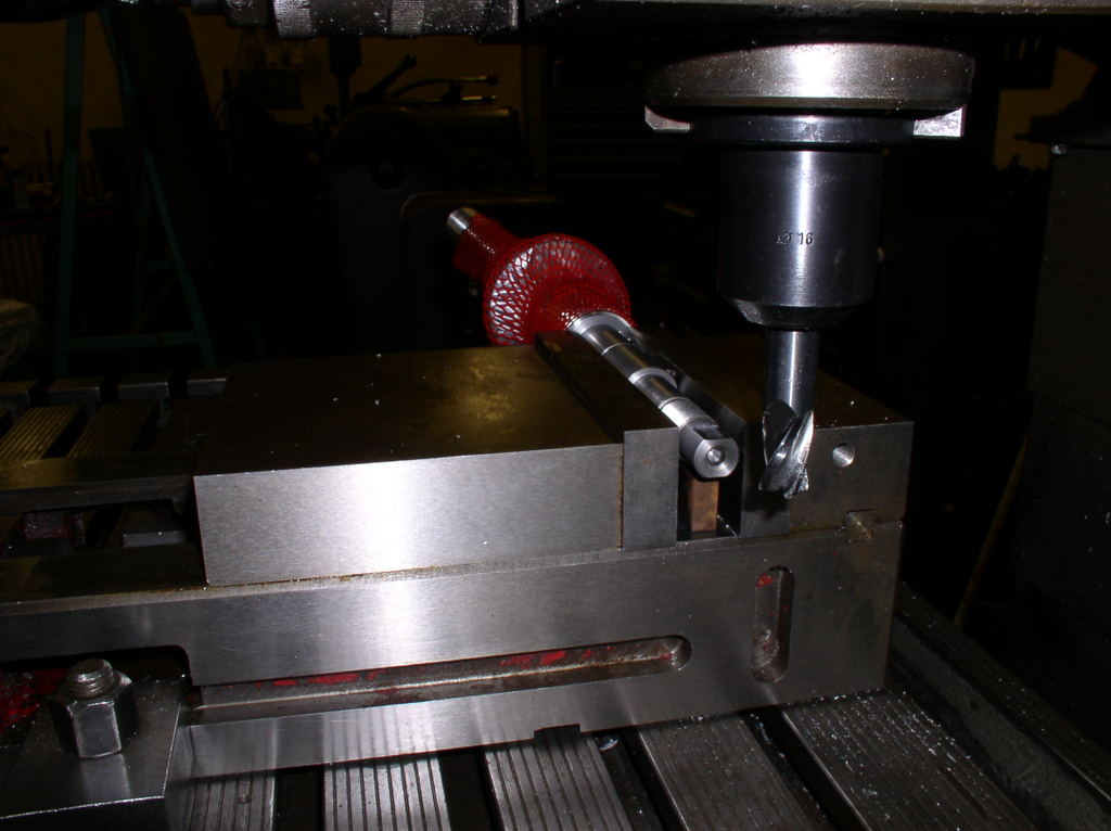

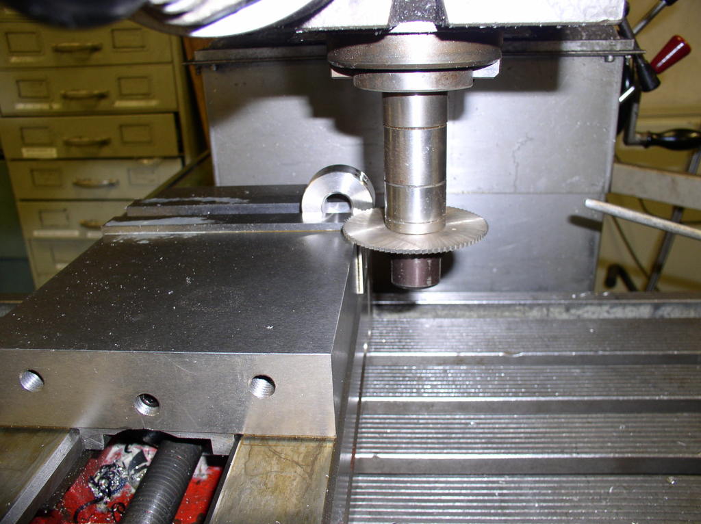

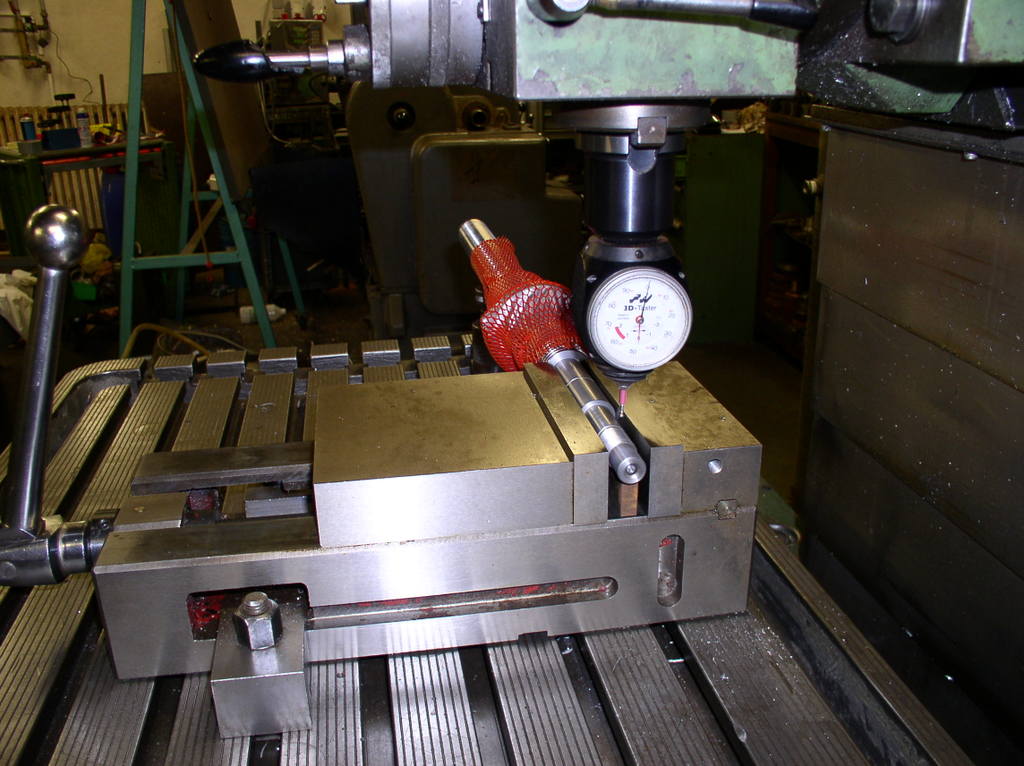

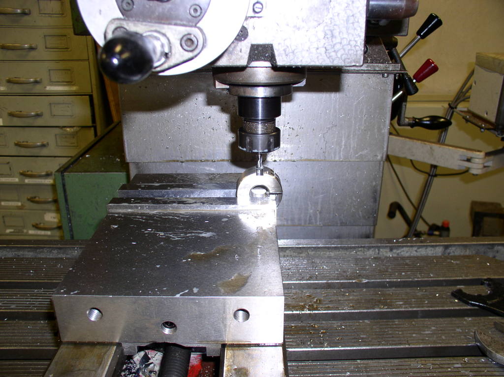

  6. #66
    Next thing we did is making the key way and two flat sides ,
    I always measuring key ways rectangular pockets with precise gauge blocks

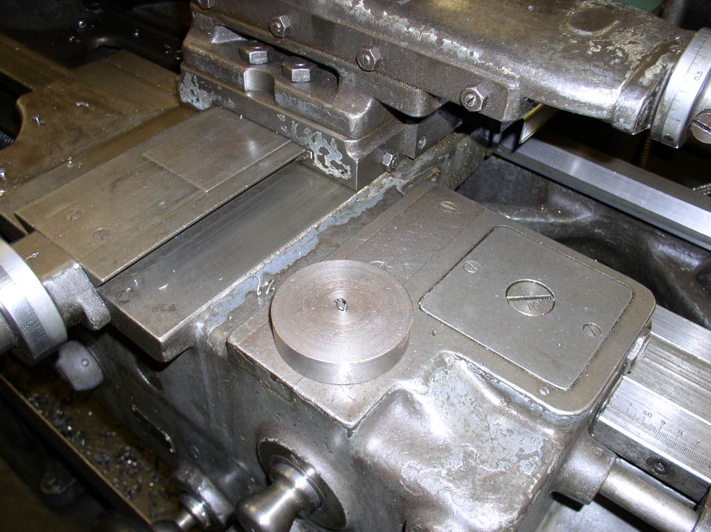

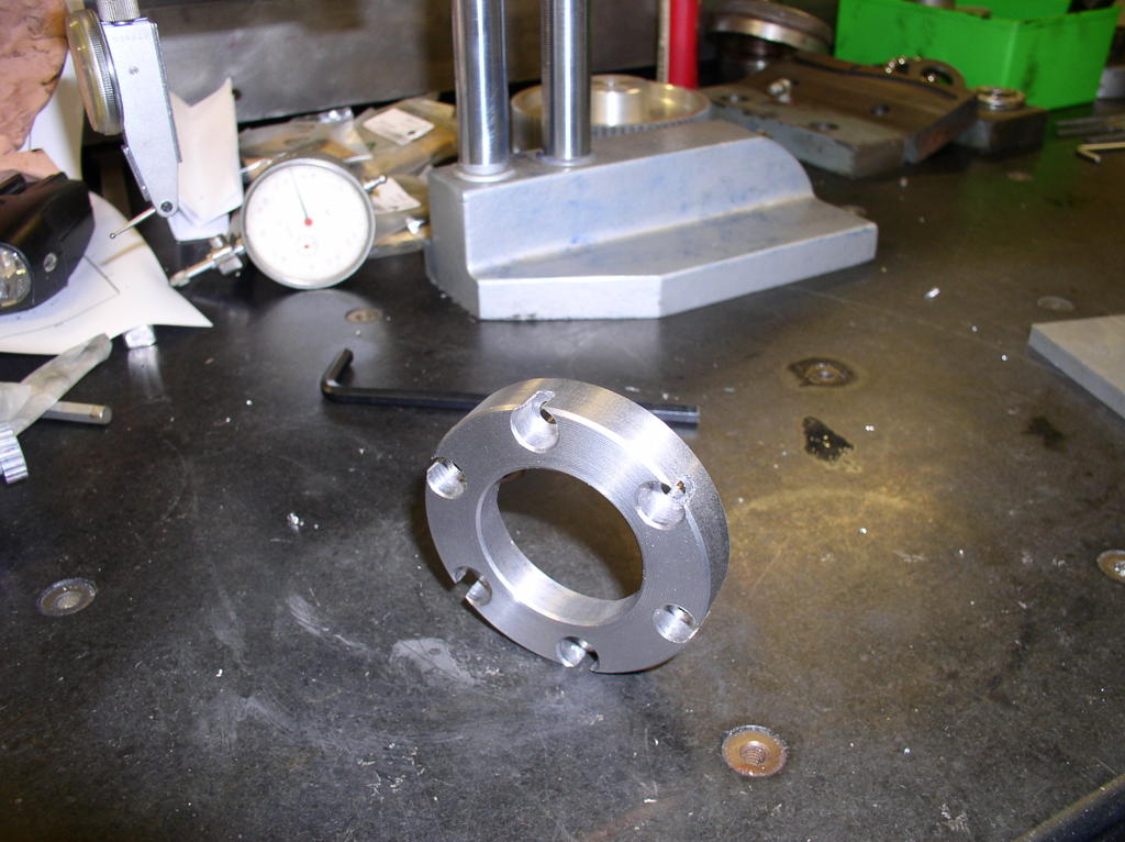

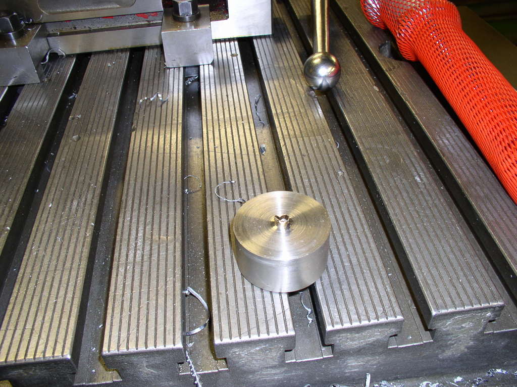

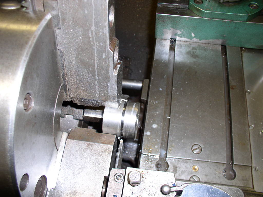

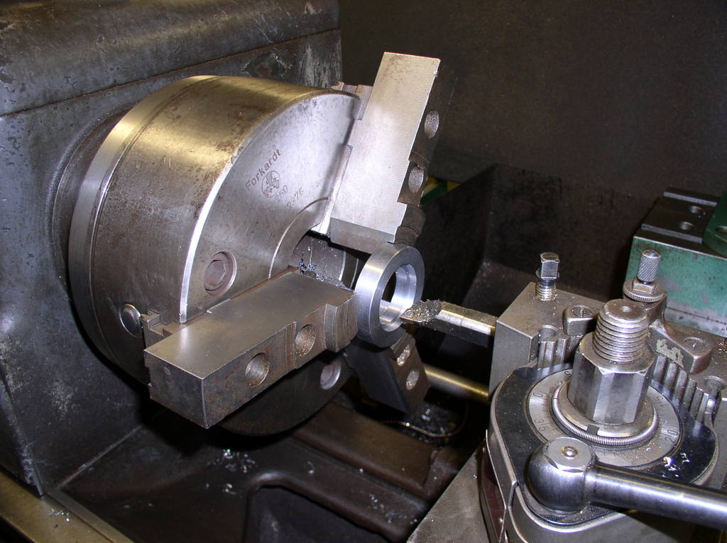

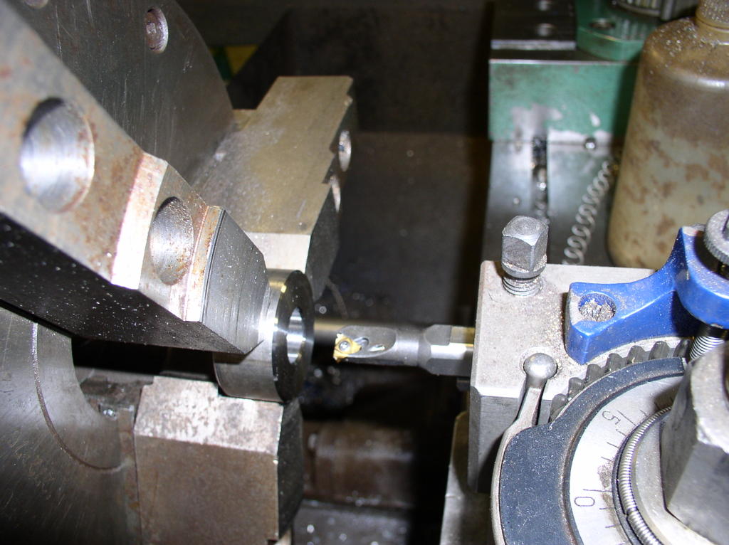

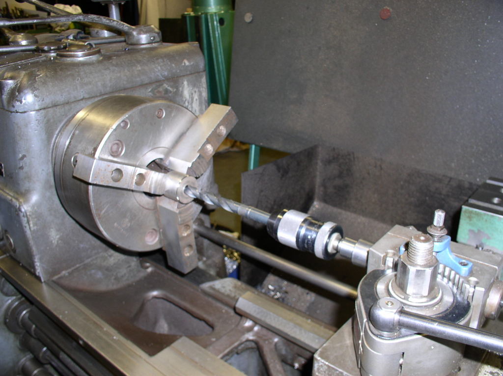

  7. #67
    Now we make the nut.
    As you can see, you can use a ball bearing for centering the workpiece.

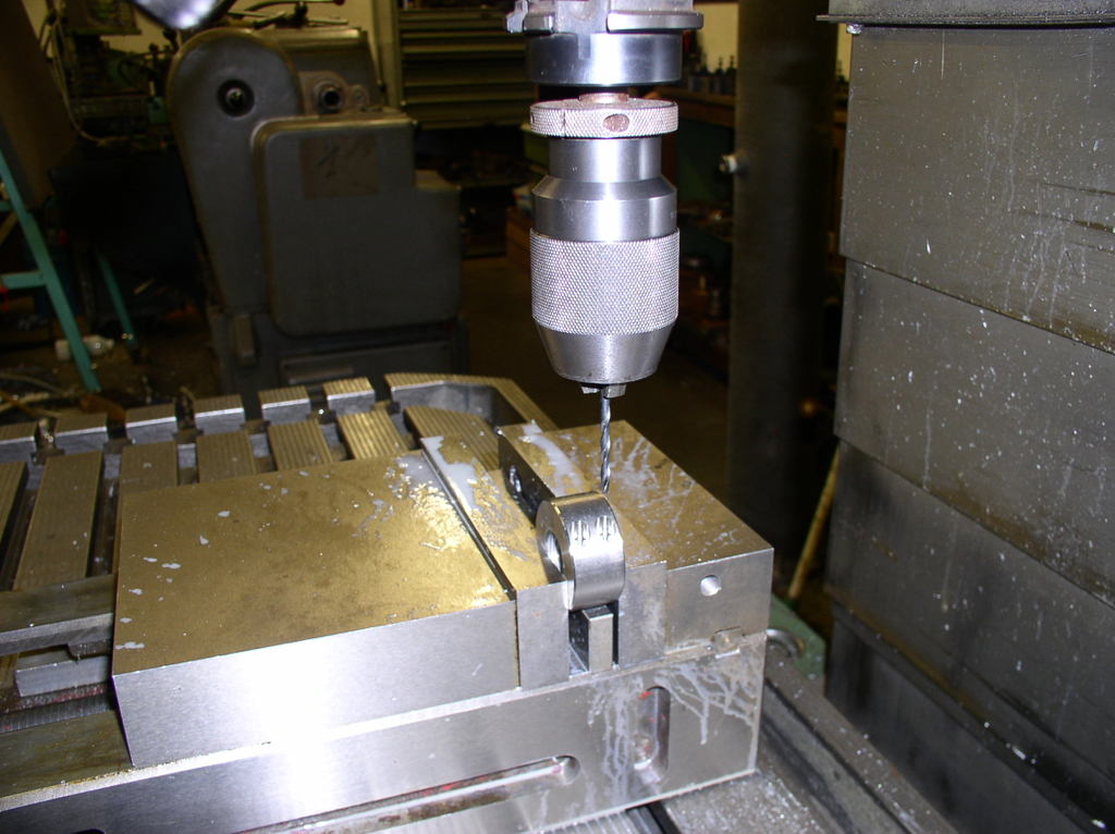

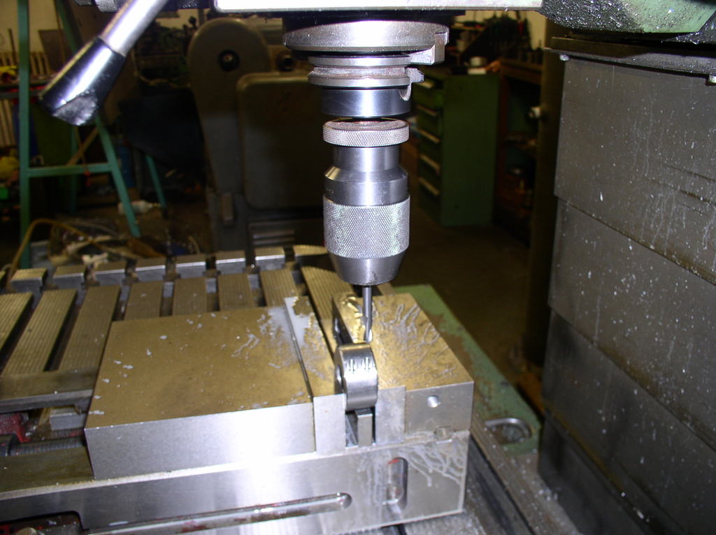

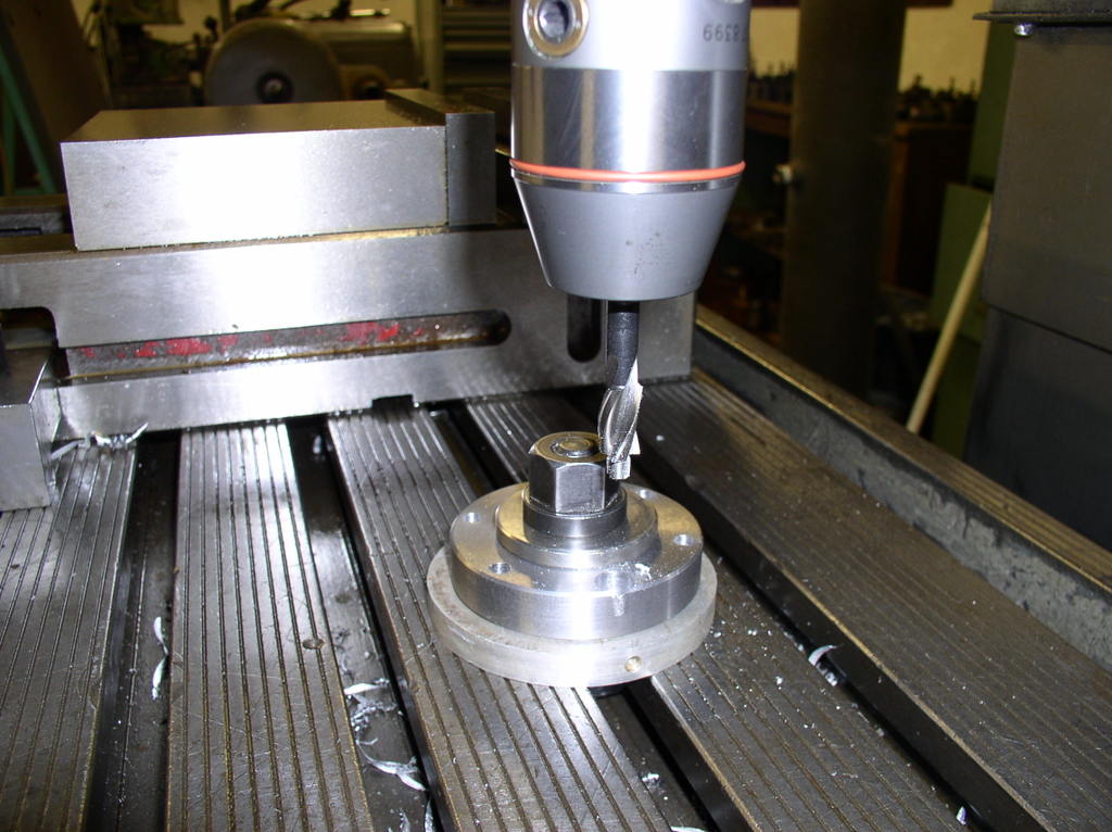

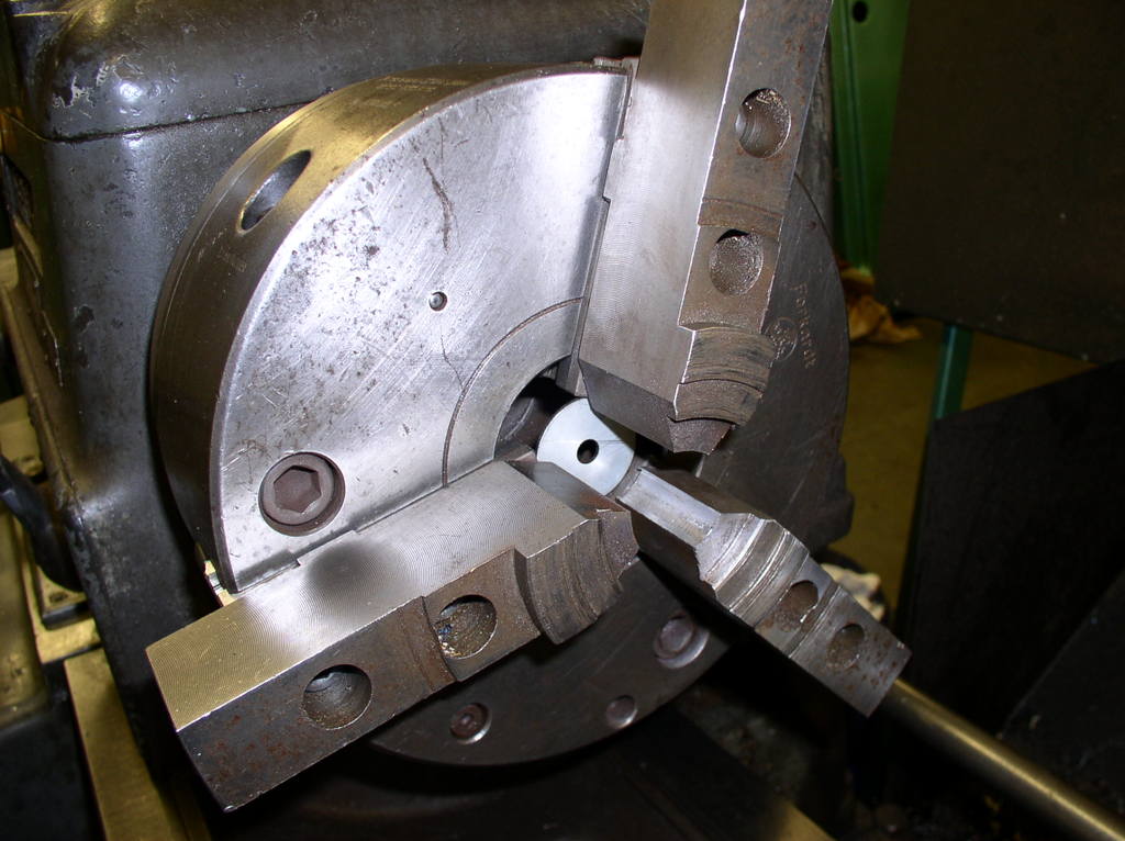

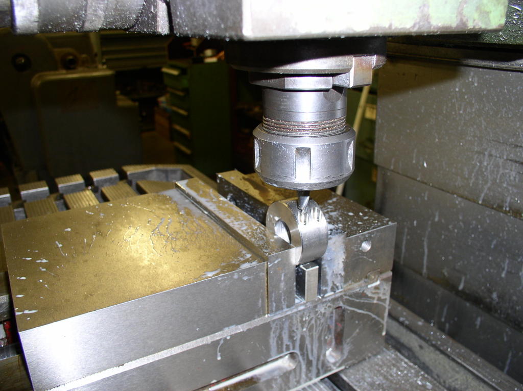

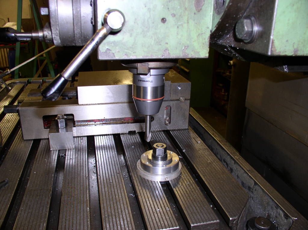

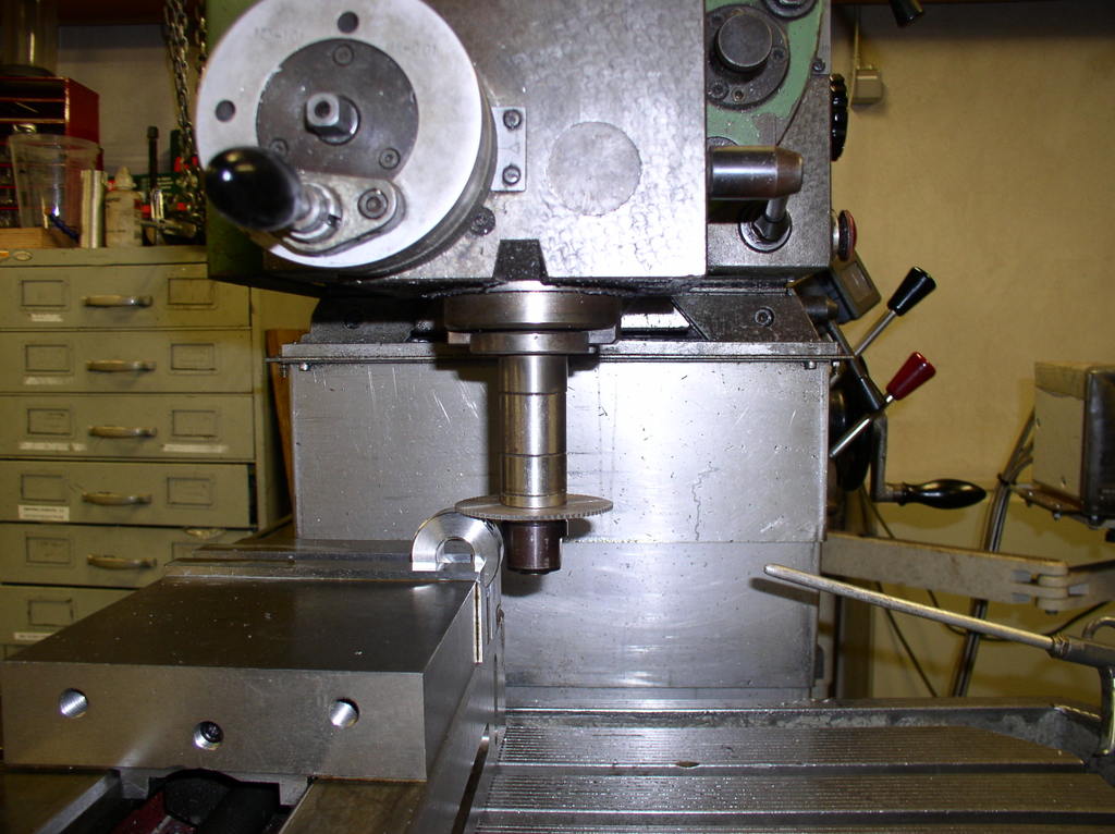

  8. #68
    After turning we are going to mill.

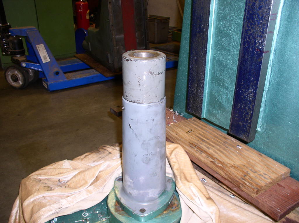

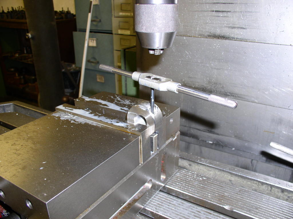

  10. #70
    We have adjusted the part of the base to the ball screw so they can be mounted together.
