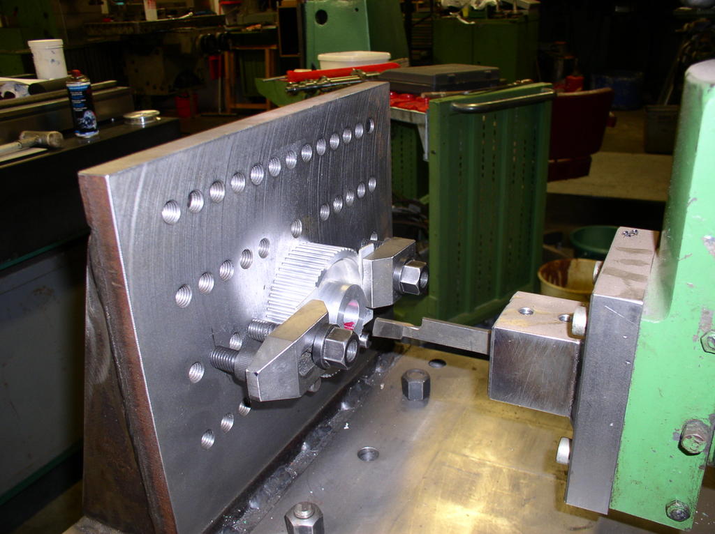

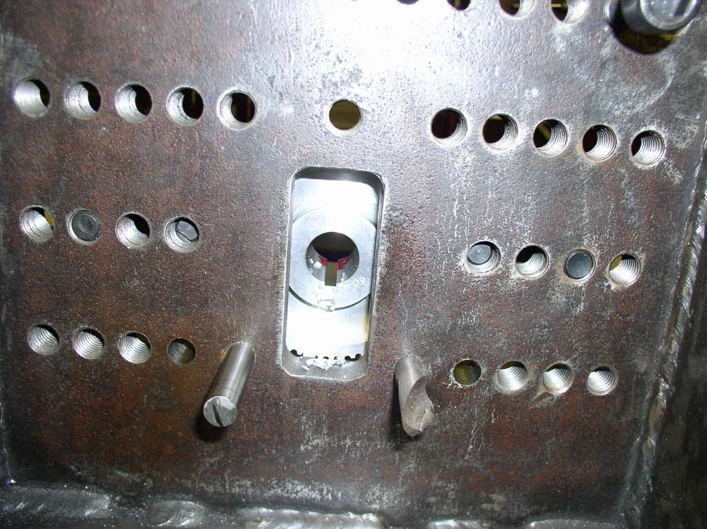

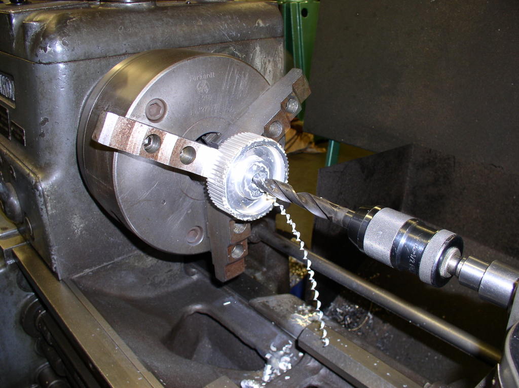

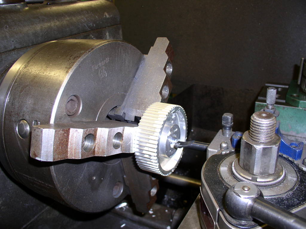

    Now we have turned the timing wheels and put in some key ways

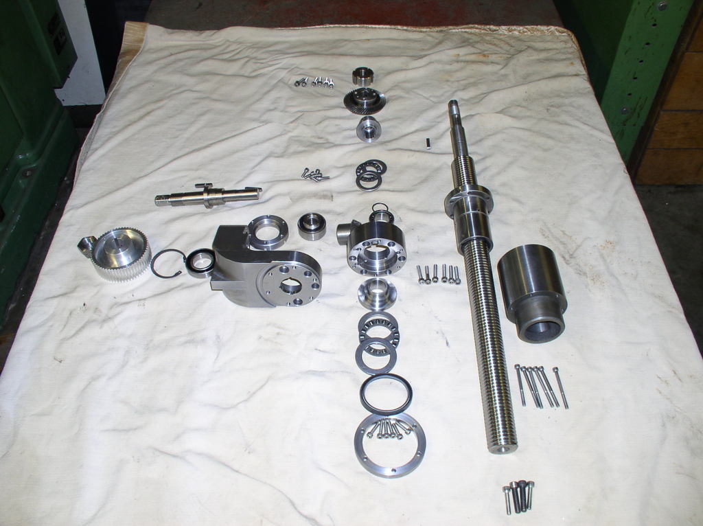

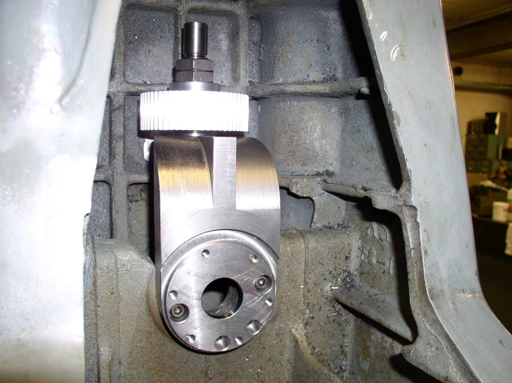

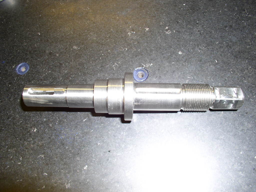

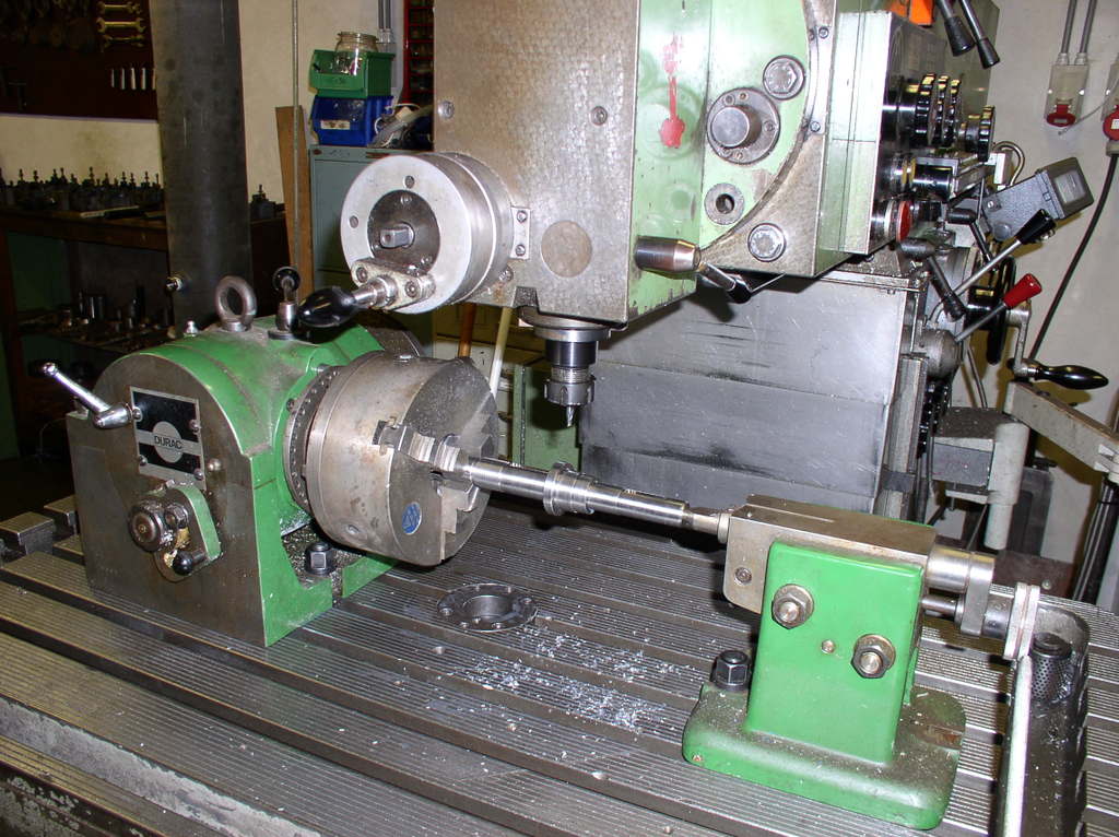

  2. #72
    Here some pictures from the small axis made of stainless steel
ID:	2051   Click image for larger version.

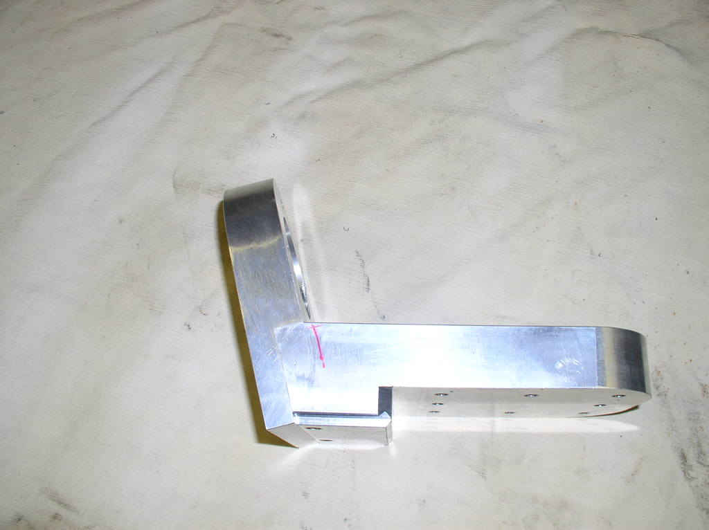

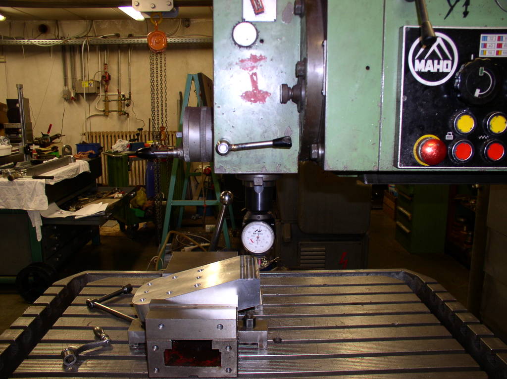

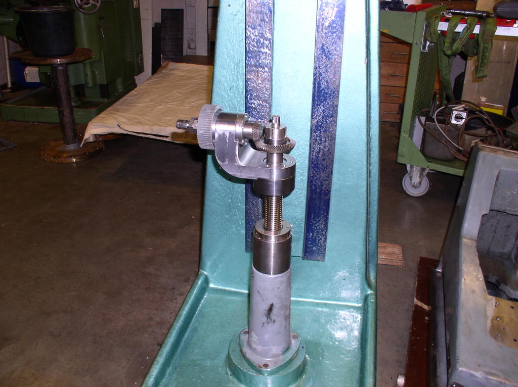

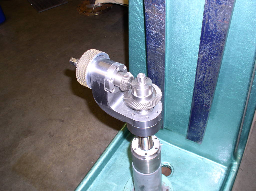

  3. #73

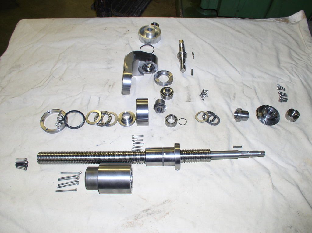

    Here some pictures of all the parts.
ID:	2053   Click image for larger version.
ID:	2054   Click image for larger version.
ID:	2055   Click image for larger version.

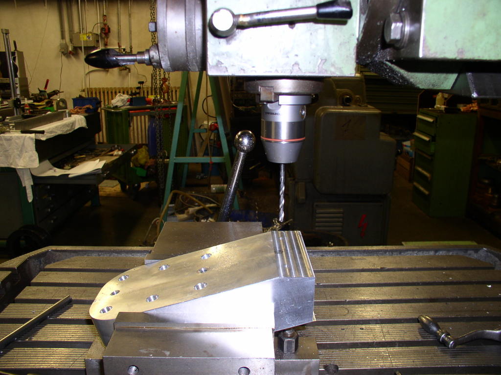

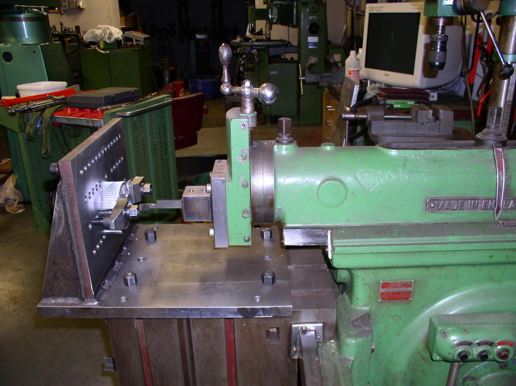

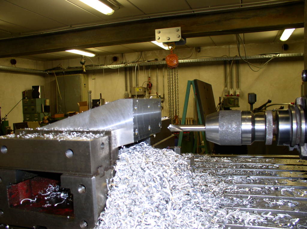

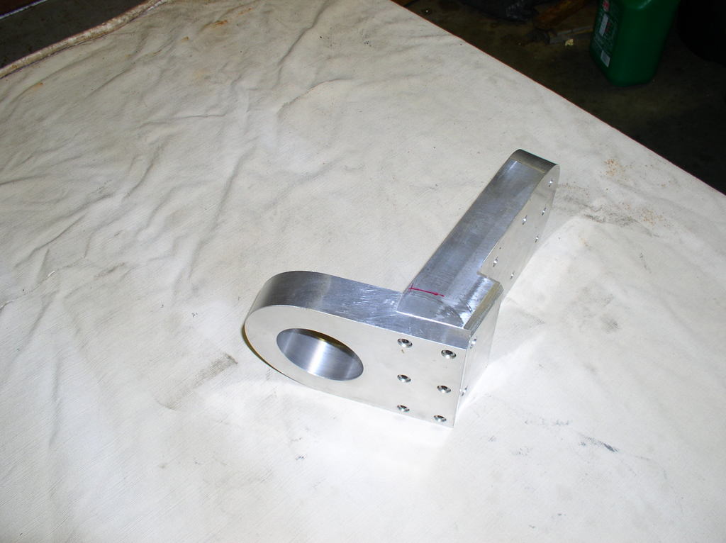

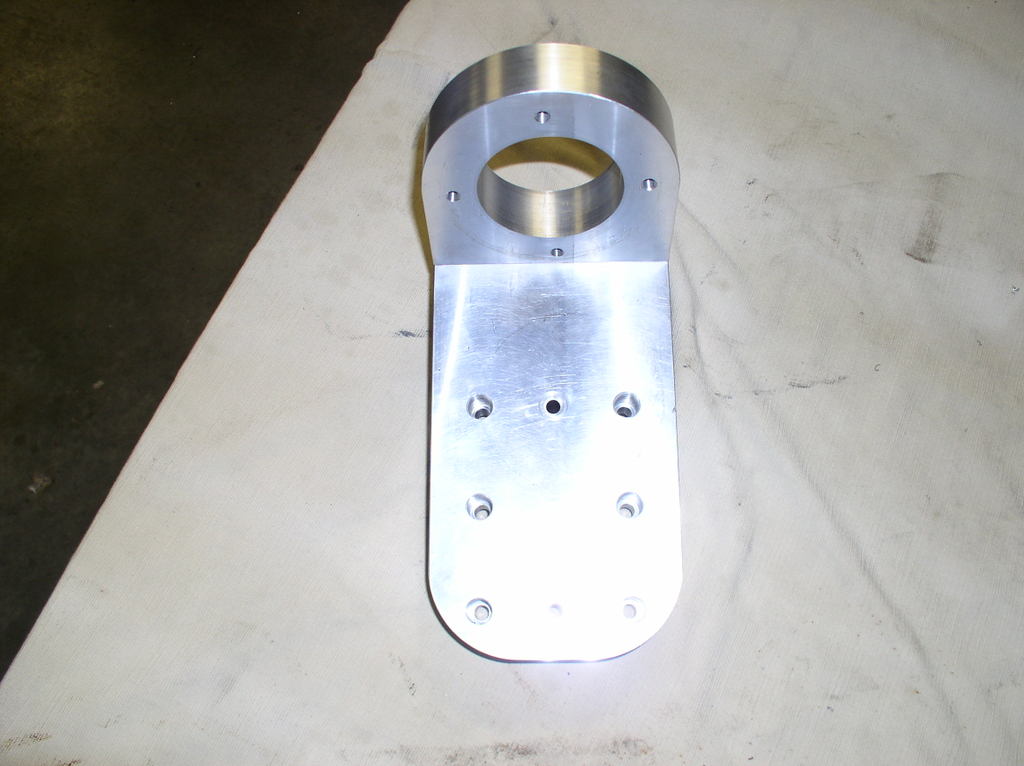

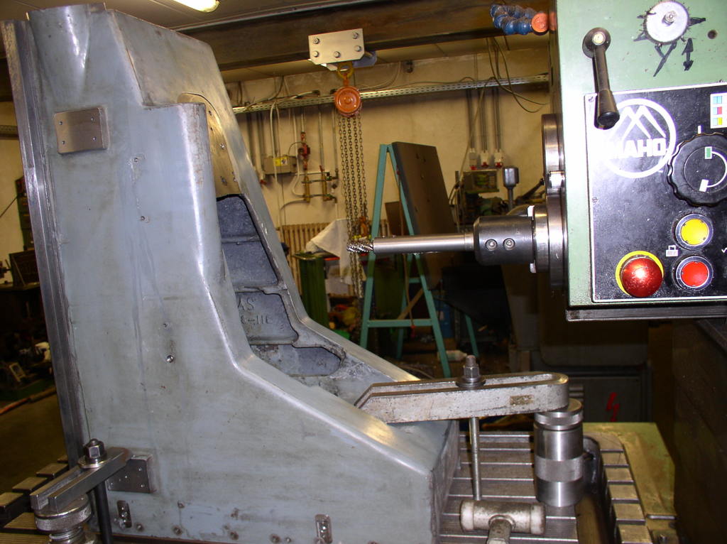

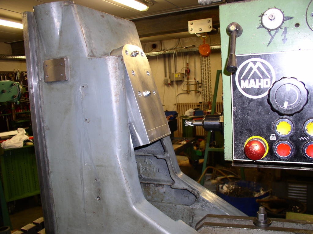

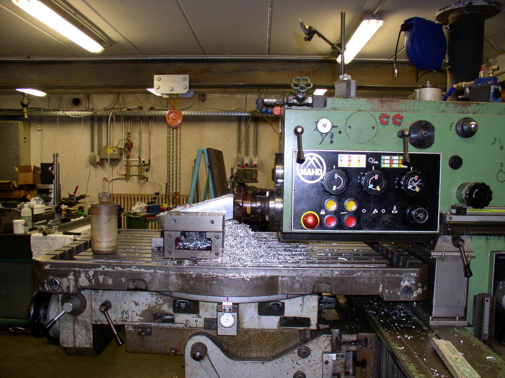

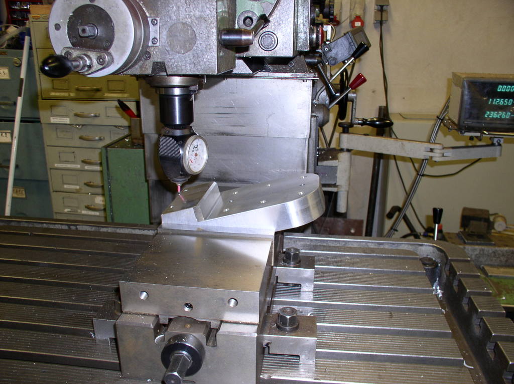

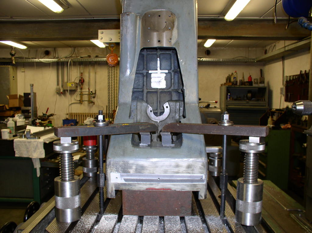

  4. #74

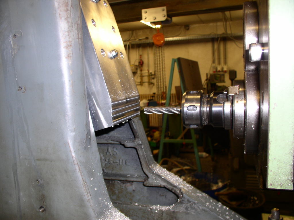

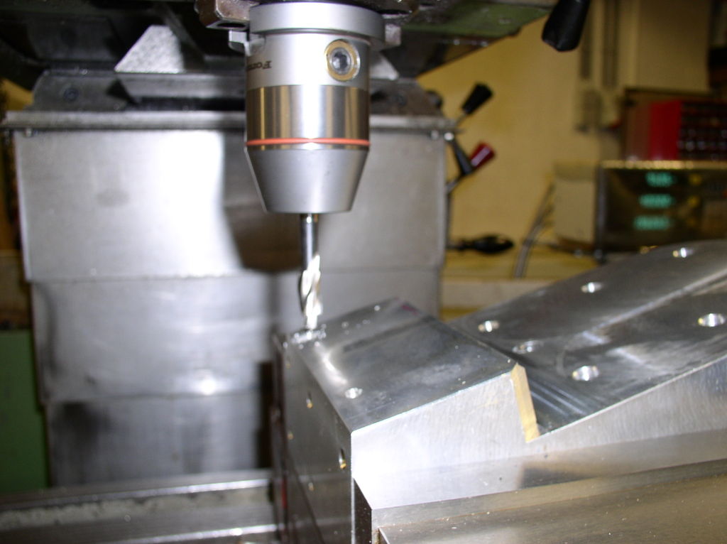

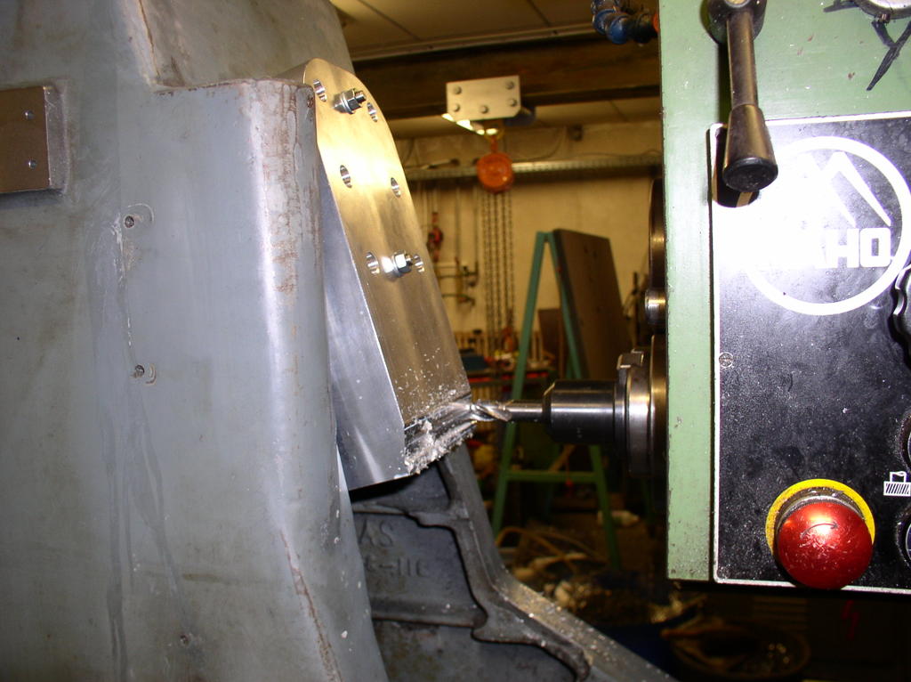

    We have also worked on the engine mount

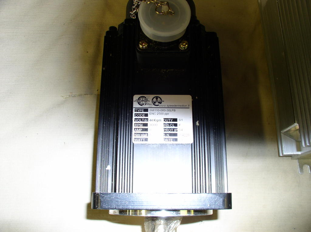

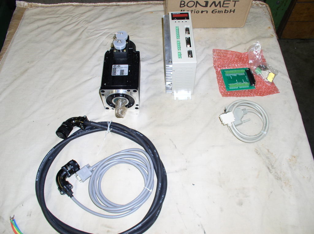

  5. #75
    A while ago I ordered servo motors and drives from Zapp Automation
    with 1600 watt and 6 Nm torqeu (Permanent magnet synchronous AC servo motor of sine-wave drive.)
