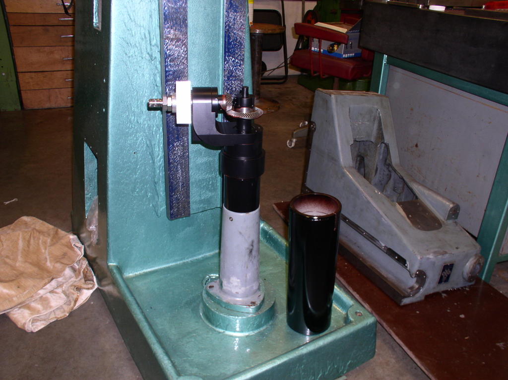

    Hello everyone,

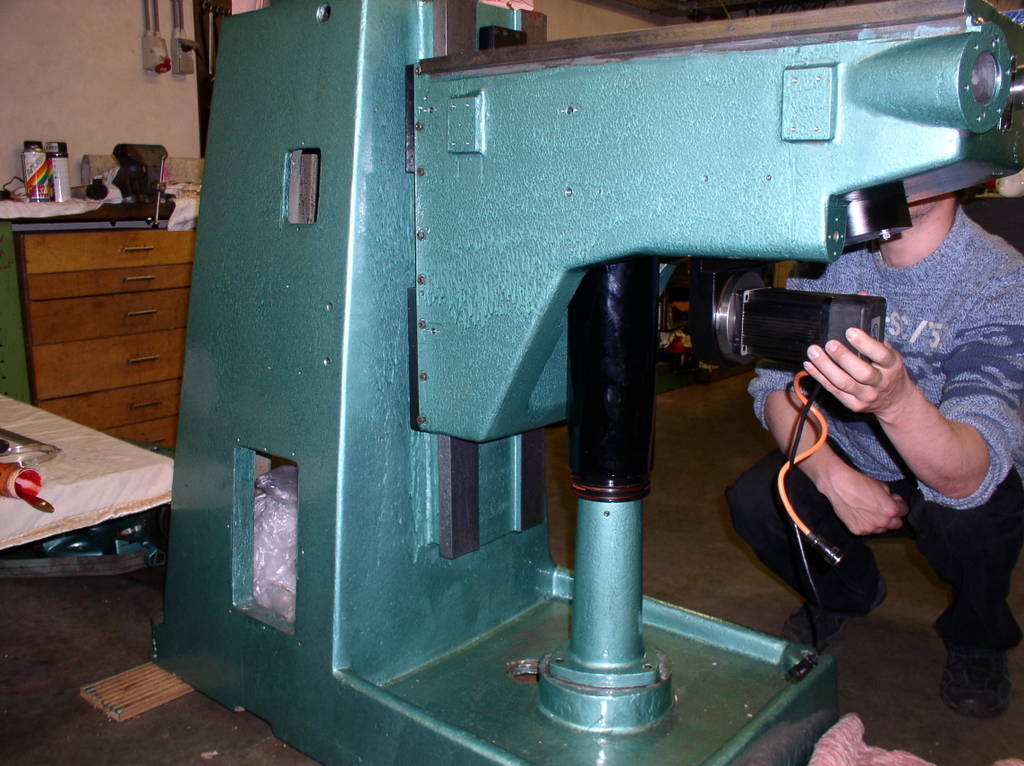

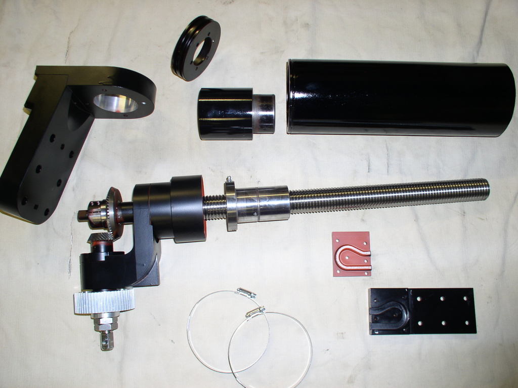

    I've been busy lately but here are some more pictures of the build.
    First I made some adjustments to the motor support
    so I have enough room for the motor for the Z axis.Click image for larger version.
    After making the assembly for the Z axis painting it was a pleasure.
    I've chosen a black paint to get a two-tone effect.
    On the picture we can also see the clamp that will be used for clamping the counterweight cable .

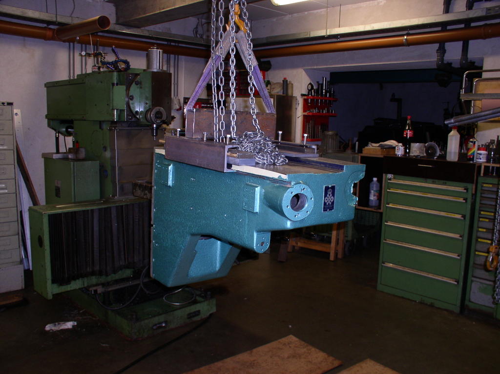

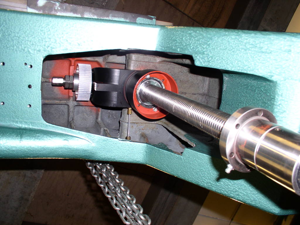

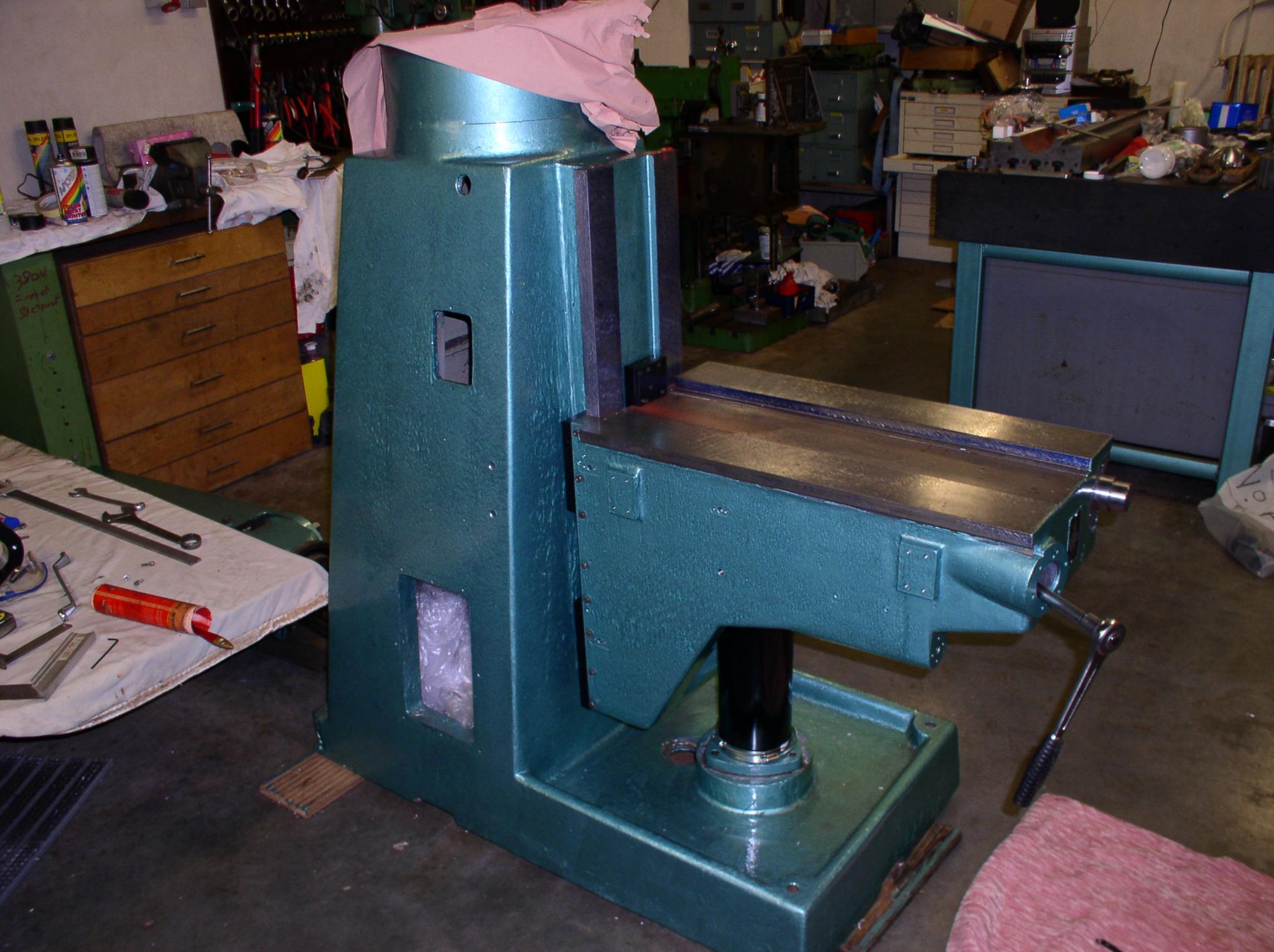

    Now I have some more to assemble.
    I builded together the knee.
ID:	2966Click image for larger version.

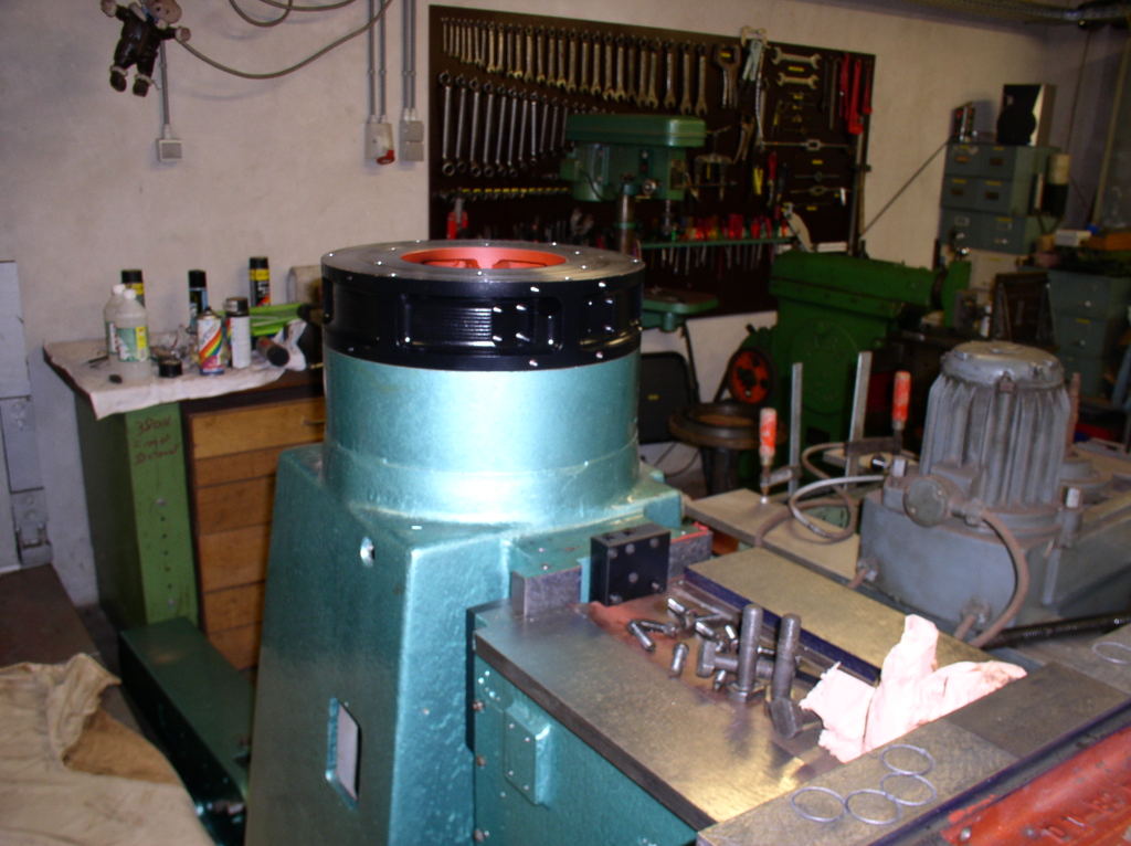

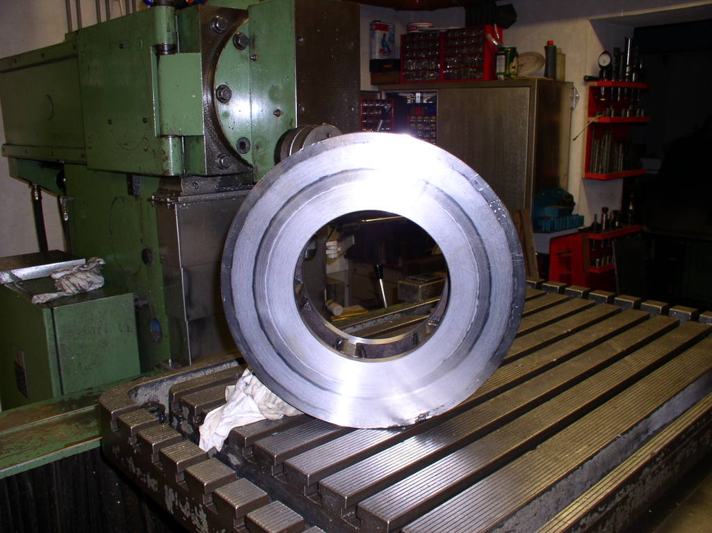

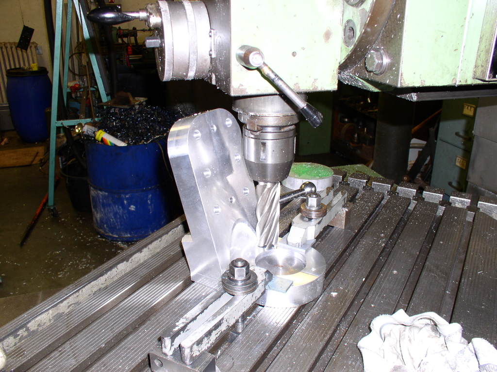

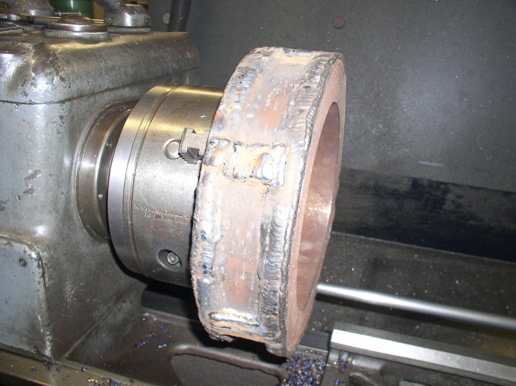

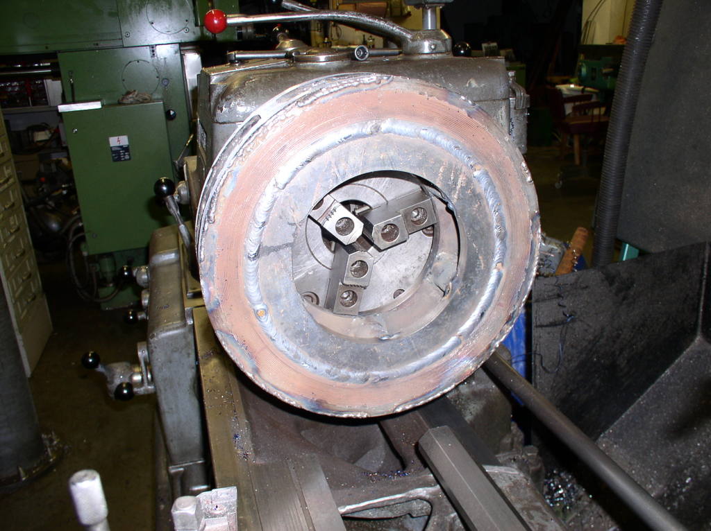

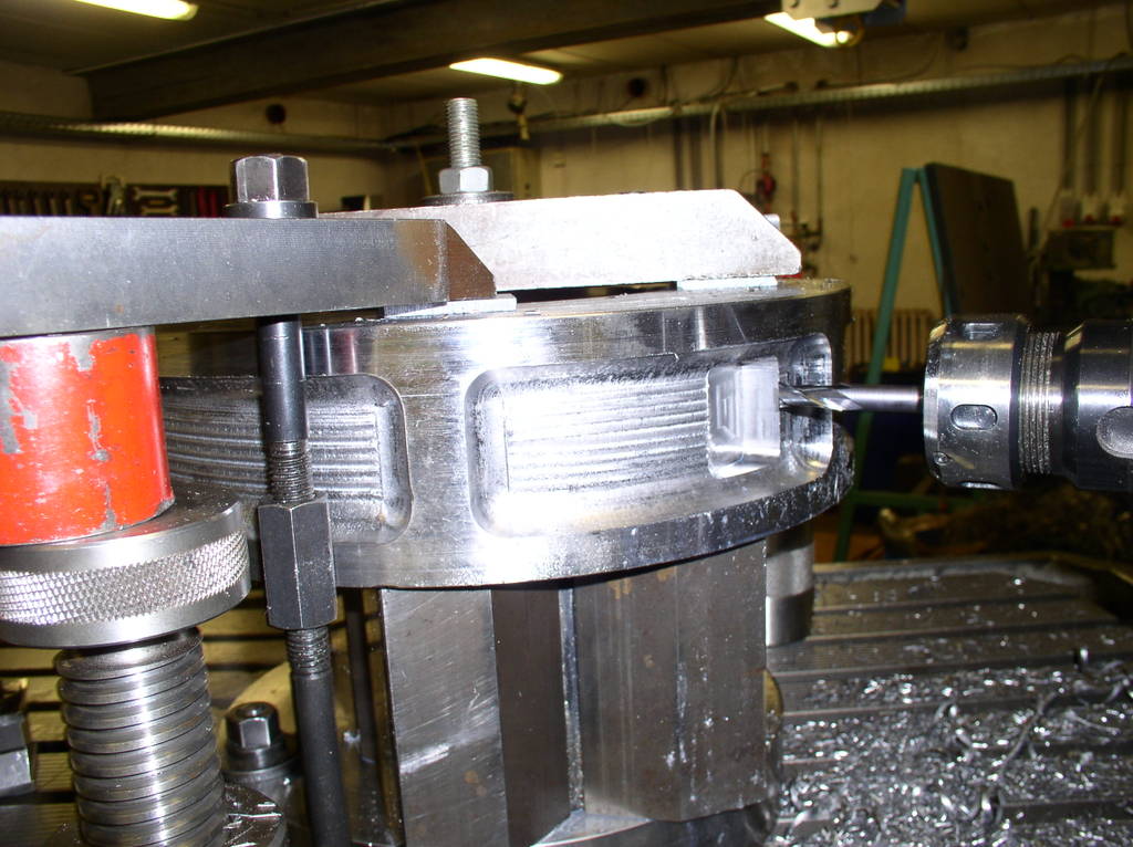

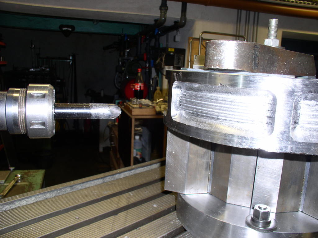

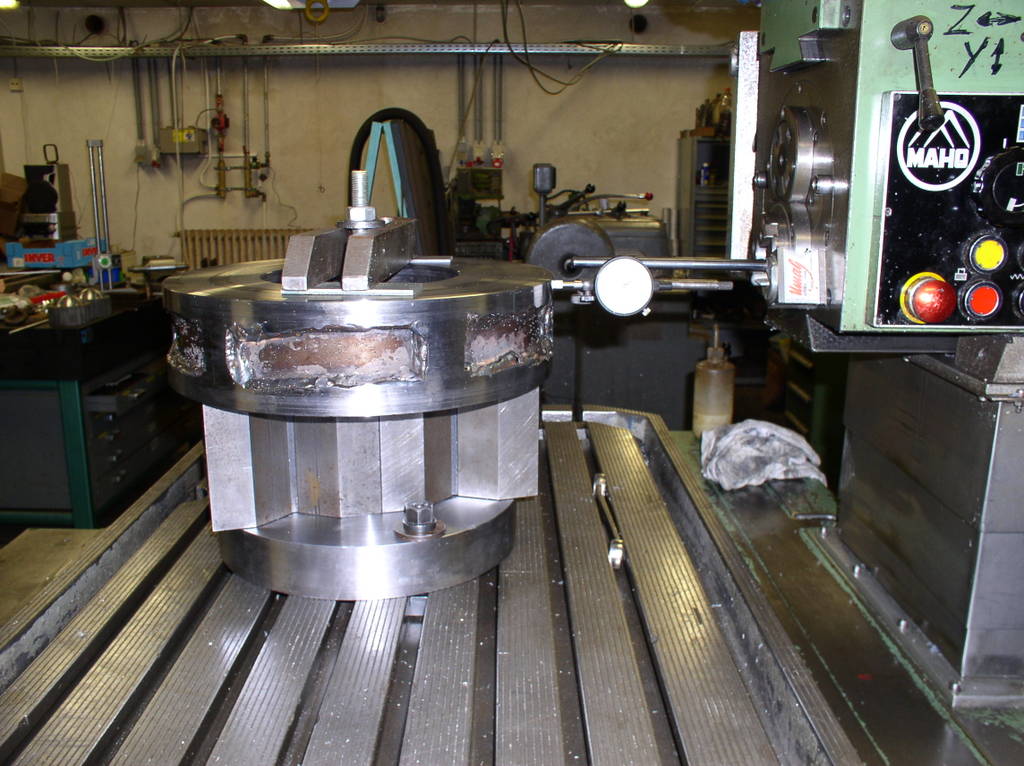

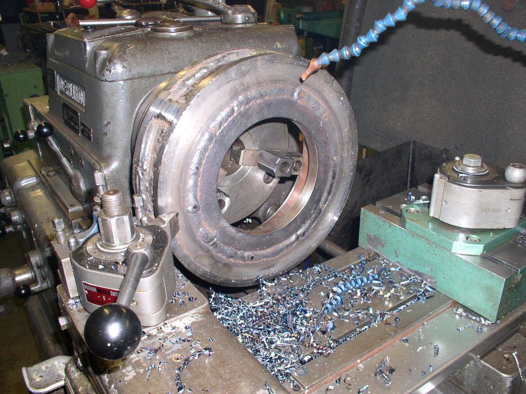

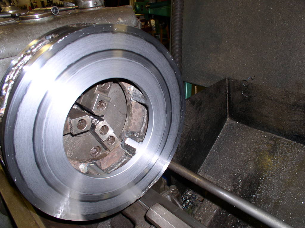

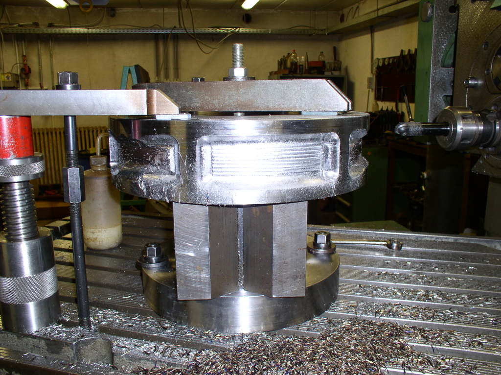

    Then I thought having not enough height in the Z so I started making a extension piece
    that was faster said than done because I had a metal ring that was to smale on the outside and inside .
    On te picture you see the ring when finished.

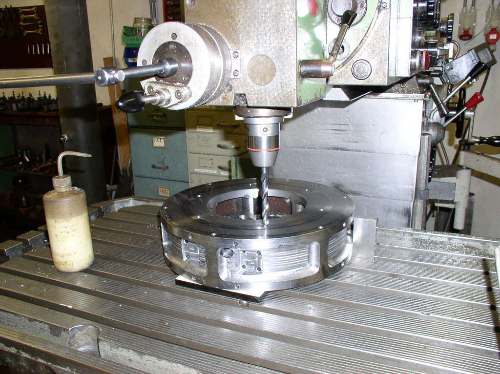

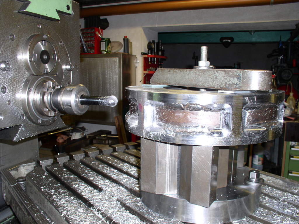

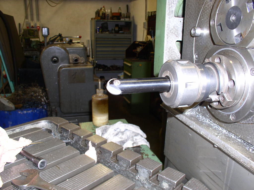

    Here are some pictures of work on the extension piece
ID:	2970   Click image for larger version.
ID:	2971   Click image for larger version.
ID:	2972   Click image for larger version.
ID:	2973   Click image for larger version.
ID:	2974   Click image for larger version.

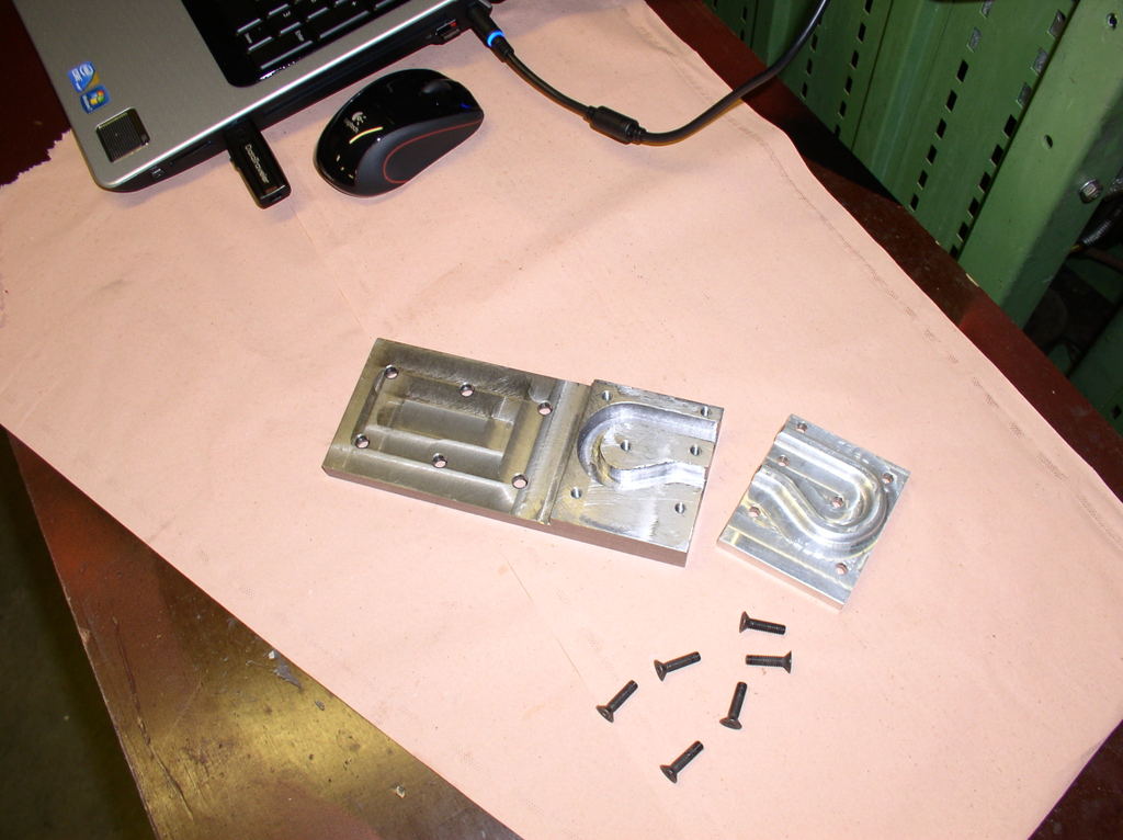

    more pictures and movie links
    have fun
    Kind regards Andre

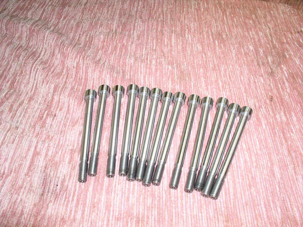

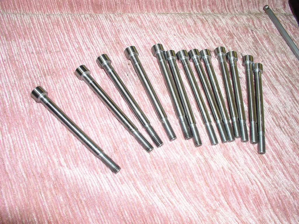

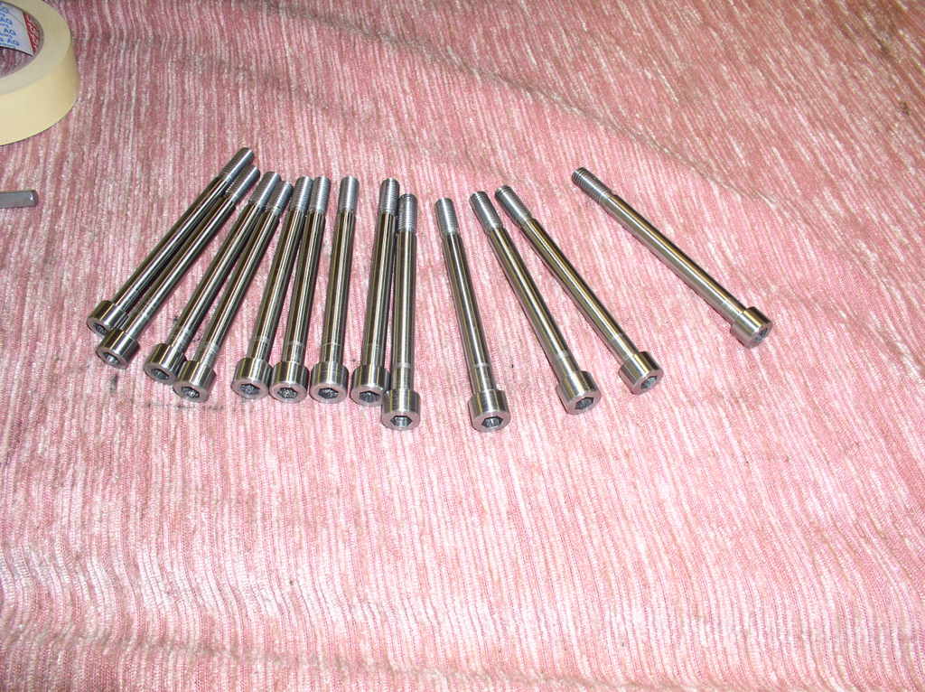

    To assemble the extension piece on the turret I had to make bolts myself because I could not buy these bolts in a store.
    A simple task if there is no hexagon slot in it.
ID:	3014   Click image for larger version.
ID:	3015   Click image for larger version.
