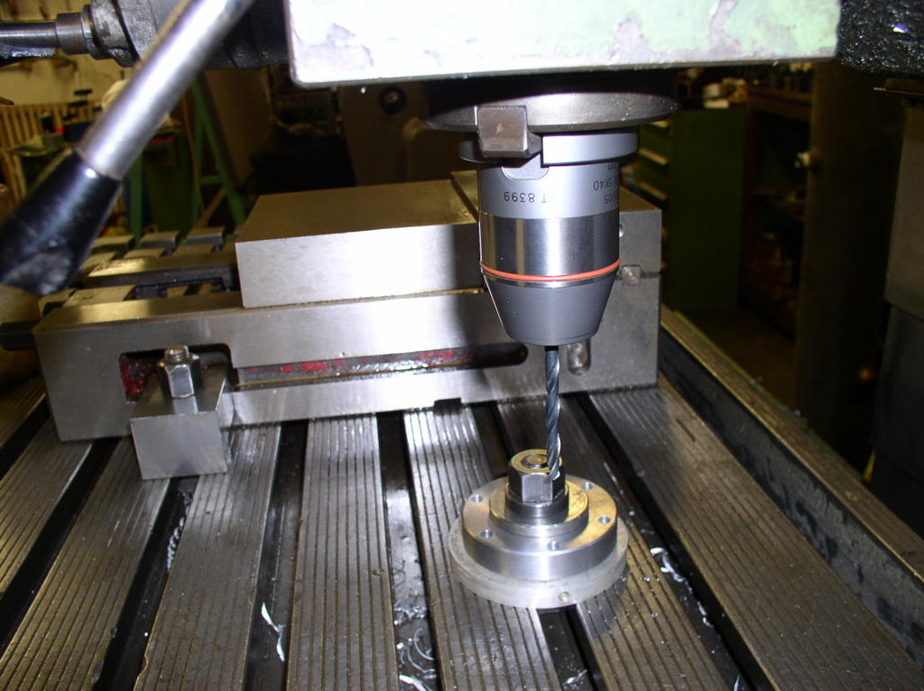

    After removing the hard layer I put on a steady rest (A support that is clamped to the bed of a lathe,
    used when machining a long workpiece. Sometimes
    called a center rest.).
    And then I flipped the piece and cut the rest matriaal
    off.
    But first I have the chuck jaws to suit the ball screw,I have a number of different sizes of washers to put between the jaws to support them during turning .I turn them to the right dimension in this case 40 mm so I will not damage the part. After cutting off the exes material I make a new center whit a center drill.
