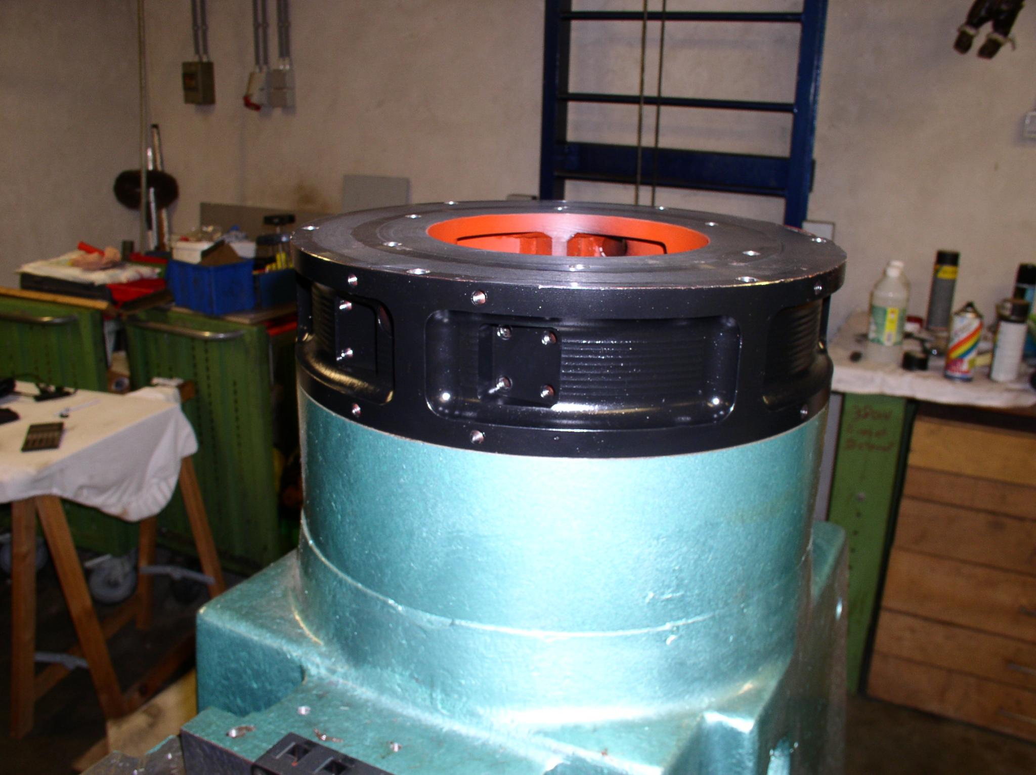

  4. #84
    Now I have some more to assemble.
    I builded together the knee.
ID:	2966Click image for larger version.
ID:	2967Click image for larger version.

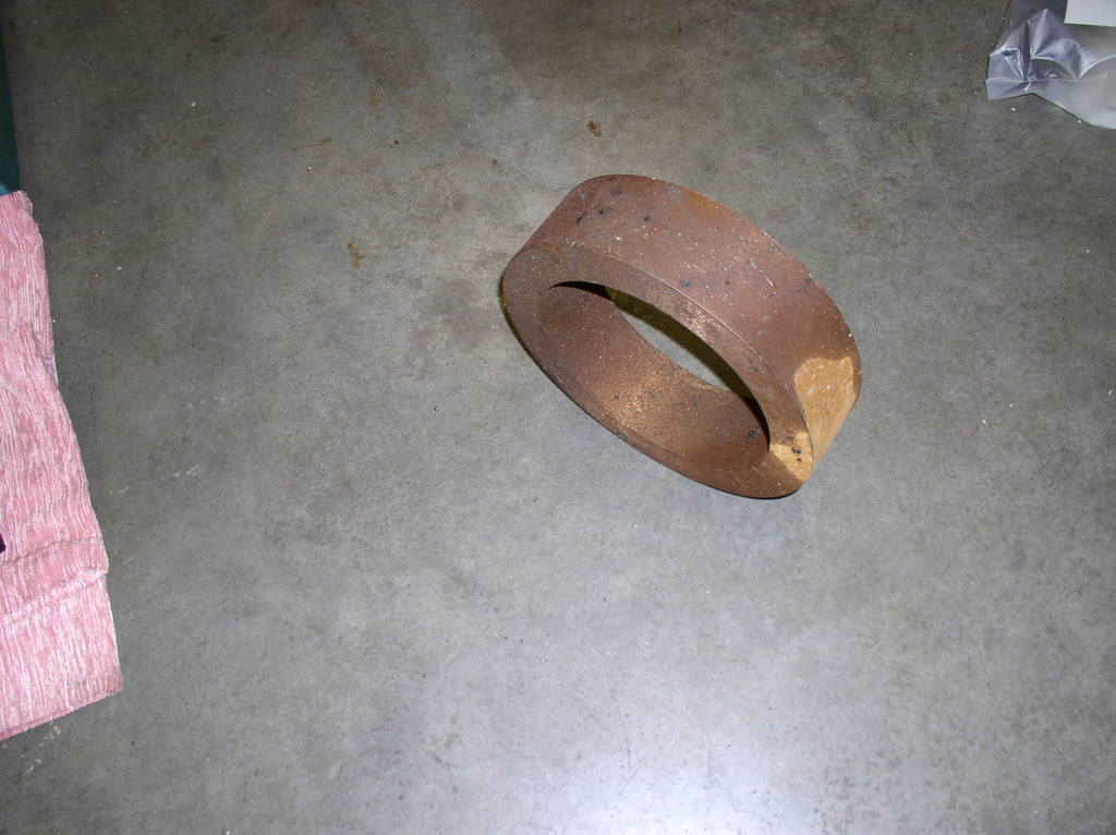

  5. #85
    Then I thought having not enough height in the Z so I started making a extension piece
    that was faster said than done because I had a metal ring that was to smale on the outside and inside .
    On te picture you see the ring when finished.

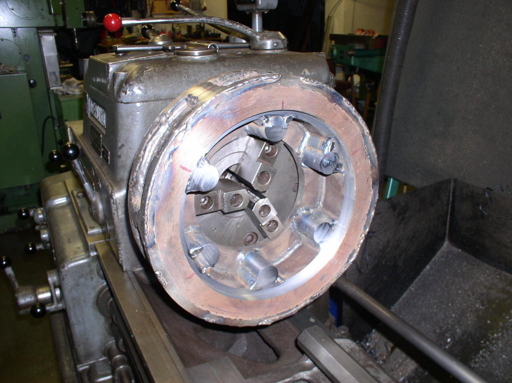

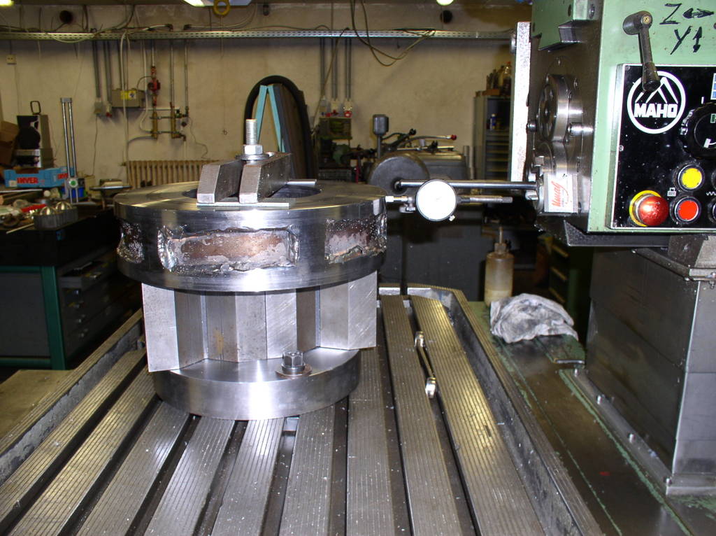

  6. #86
    Here are some pictures of work on the extension piece
ID:	2970   Click image for larger version.
ID:	2971   Click image for larger version.
ID:	2972   Click image for larger version.
ID:	2973   Click image for larger version.
ID:	2974   Click image for larger version.

  8. #88
    To assemble the extension piece on the turret I had to make bolts myself because I could not buy these bolts in a store.
    A simple task if there is no hexagon slot in it.
ID:	3014   Click image for larger version.
ID:	3015   Click image for larger version.
