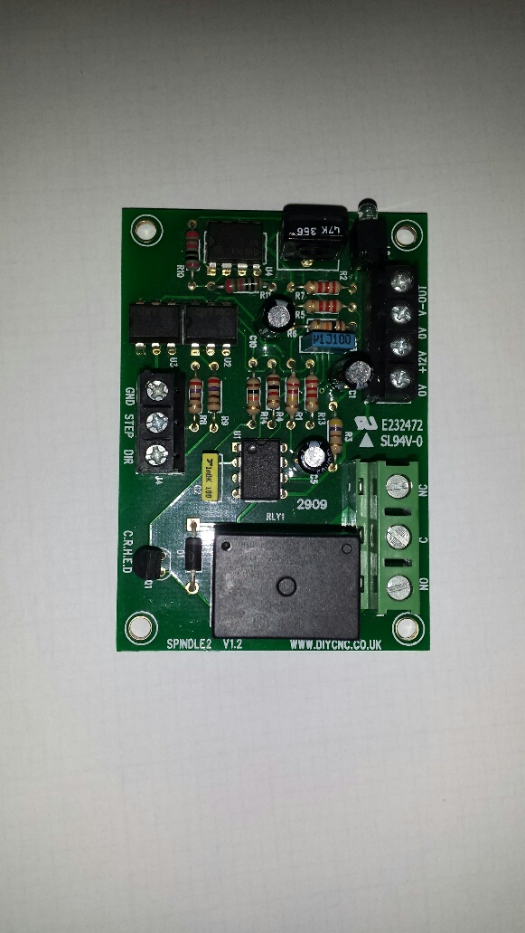

    From the circuit It seems that the motors require 24 V and on that basis I have bought drivers which range up to 42v
    It is my intention to get all the motions functioning, utilising Mach 3 purely to provide jog inputs , after which I will go for a linux option to provide me with a functioning machine.
    I am intending to use the existing power source (because it is there) It has outputs of 20v, and 9V which seem after rectification to yield 24v and 12v ( -ve) to the boards but the 12v rectifiers are integral in the board and I cant make out what its capacitor is . Will have to look more closely at it. Clearly I have to add a rectifier if I go this way.
    I have a selection of BOBs, one with 0-10v output but only make / break switching at the relay.
    I also Have a DIYCNC spindle board which might be suitable

    I am hoping that this will give me the the Fwd rev outputs shown in Inee's diagrams but I am not clear on the relay connections shown.
    RL1 and RL2 are incorporated in the board , so do I have to insert another relay into the circuit and could the above one fill this role .
    Finally with respect to the spindle reversing relay I dont see any numbers on the base . Is there a convention here that I am unaware of ?

  4. #14
    That diy cnc board is the exact board that I have used to provide step/dit from linuxcnc and from it you get a 0 to 10v output which is isolated to feed into the lenze speed controller
    You also use the relay to switch the lenze controller
    I can provide the lenze connections to the soy bc board if it will help you
    Paul

    Hi john
    i have one of those spindle boards, as depronman said it's a good little board.
    By spindle reversing relay i take it you mean Rl3 in your Boxford, if so the terminal numbers are printed/stamped into the relay holder ,just above the terminals so either use a mirror or take photos of the wiring and also take some more when you have removed the top set of wires.
    Or if i remember tomorrow i can pop a pic of the base up

    HI John,
    Equally I'm not an electrician, but I have wired up a few CNC controllers, so please take this as what worked /works for me as against how it should theoretically be done
    All of the mains (E) earths should be connected to a single metal bolt which is electrically and mechanically connected to the machines metal case. From an electrical noise and ground loop elimination point it is important to have one single earth point. I Bolt the power supplies to the chassis plate which in theory will cause the PSU to be earthed, but I always connect the E terminal to the single earthing point.
    Then connect the maines (L) live and (N) neutral leads to the Power supplies, you would normally take the lives through a fuse / breaker and some sort of contact breaker as appropriate.
    On the BOB side I would confirm using a multi meter in ohms setting that the 0v and the GND connections are one and the same. They are not always connected together due to the BOB possibly isolating say the PWM signal from the PC, therefore the GND connection and the PWM 0v connection ideally should NOT be electrically connected. Some better quality BOB are made like this, other cheaper BOB are not like this.
    When connecting to the Lenze Speed / Spindle controller for example its VERY important that the 0v of the PWM output is NOT connected to the GND terminals on the BOB or to the machine earth, the reason being the lenze controller needs a 0v to 10v signal to provide the speed control signal (0v = spindle stopped, +10v = spindle at full speed, +5v = spindle at half speed) BUT the Lenze 0v volts terminal is actually at 110v compared to mains earth and mains neutral and for that matter to the PC's ground. It goes without saying that it would be terminal for the BOB and the PC if 110v is applied to the PC ground.
    This is the reason why the BOB MUST isolate the PWM 0v from the BOB GRD connections.
    My BOB £8 from ebay, very common one with a single relay, does PWM and if used to control a VFD its perfect, however it is NOT suitable for the lenze controller as the 0v PWM on the BOB is electrically connected to the GRN connections on the BOB.
    I had to work around this by using a DIYCNC spindle controller board which is feed with Step / Dir from the BOB and a 12V and Grd power feed. From this it generates a 0v to 10v voltage and importantly this is totally isolated from the Gnd & 12v power feed into the board AND also isolated from the Gnd of the BOB
    So, in summary this allow the DIYCNC board to provide the 0v to 10v signal into the Lenze controller, which effectively means that the Lenze input voltage will vary between 110v and 120v
    On my BOB I found that all of the GND and 0V connections where connected together, this is OK but care needs to be taken with things like Limit Switches to ensure that when connected to the BOB that one side of the limit switch is not connected to earth by virtue of being attached to the machine frame.
    Hope that helps, fell free to give me a ring if anything is unclear

    Hi Paul
    I had thought that the isolation cad on the lenze controller gave that protection.
    If you look at the wiring diagram I inserted earlier in this thread , the 0v connection from the iso board ( term 5) come back to a common 0v buss which picks up the the drivers and rectifiers on its way back to a direct connection to the Mains Earth.
    I will be using the Bob which was repaired for me by Doddy which has the facility for a 0-10v signal but only a make/break relay.
    Does the DIYCNC spindle board generate its own signal output, so no need to connect the BOB 0-10 signal ? Or might it be better to take the speed regulation signal straight from the BOB and cut out the middle man as it were?
