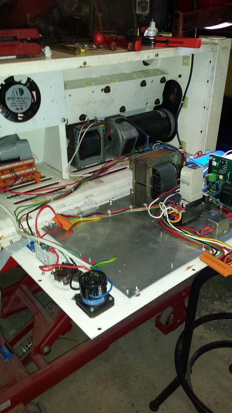

    So in the absence of new advice, I have gutted the machine. Boards out , removed all limit and interlock switches. I will replace those I feel are really needed. Will put in a new Estop , and home switches, so now looking at what is left of the spindle control circuit.
    This is me following the ancient Northern principle
    "Let the dog see the rabbit"

    Am currently trying to identify the wiring I am left with, so give me time on that one!
    I will be building a new panel, with stepper drivers and BOB, and am not expecting too much difficulty with making X and Z operate from the computer .

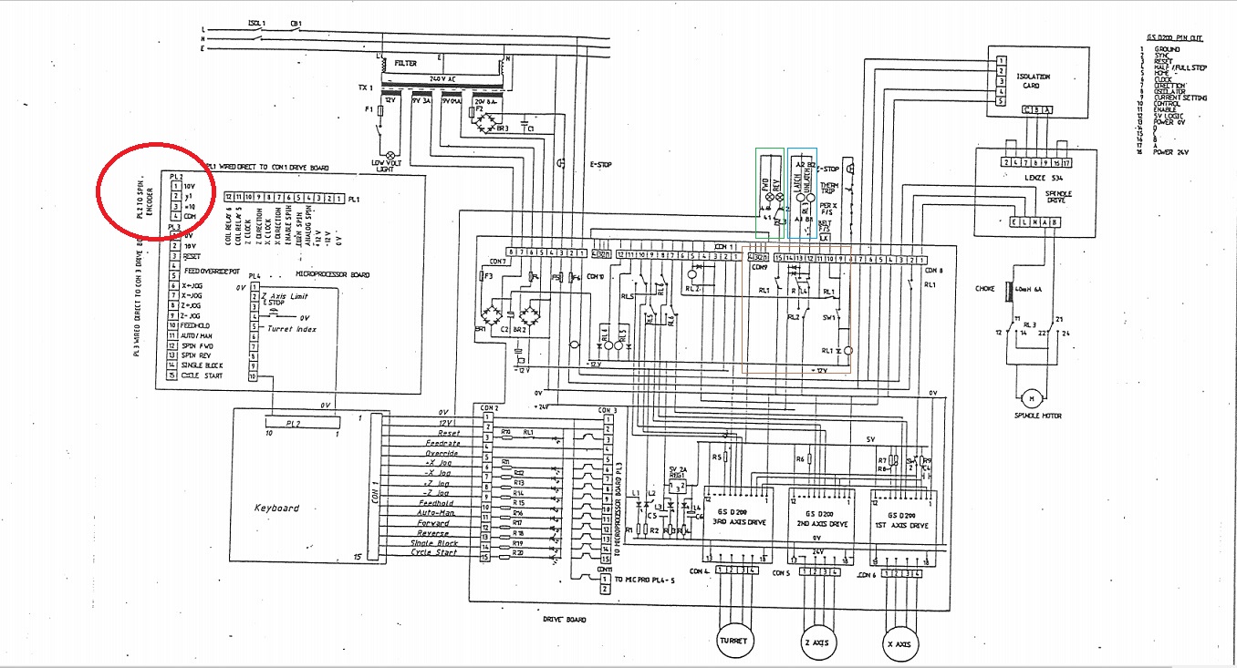

    Circuit here and I will expand on my issues .
    Please remember i am of the mechanical rather than electrical persuasion so Wiring diagrams are not part of my native language .
Name:	TCL circuit 1.jpg
    The spindle encoder Plugs into the processor board (highlighted red ) where I presume magical and mysterious things happen to the input , before it is sent on to the drive board .
    RL1 (brown) which is integral then seems to shuffle things in a manner I cant yet get my head around via the forward / reverse (green box) and Latch /unlatch (blue box) which I am presuming is controlling the big grey external relay RL3 for spindle direction
    So the function of the spindle seems to be dependent upon both boards ????

    Hi John
    For now ignore the green box you have drawn, they look to be a connection to the FWD/REV bulbs in those 2 switches on the control panel (most likely 2 thin wires going from rl3).
    The spindle speed is reliant on a 0 - 10v signal coming from whatever control board you will use.
    FWD /REV will also be dependant on the controller you use, at switch on Relay3 will switch to one position, this will be either Forward or Reverse. Lets for the sake of argument we'll call it default position.
    You will need to copy the circuit with additional relays.
    Most s / controllers have a relay on board for fwd reverse if so, there will normally be a nc / no and com connection.
    So you would connect the com(mon) to 0v from pwr supply.
    NC(normally closed or for the sake of quickness On as it is directly connected to the com terminal). would go to one ov side of Rl3
    NO(normally open or for the sake of quickness Off as it is only connected to the com terminal when selected and at the same time Nc will disengage). would go to Tudder ov side of Rl3.
    Sorry if it's too simplistic as i don't know your comfort level with electrics.

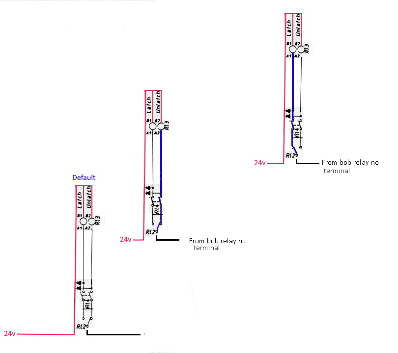

    Now if you look at the diagram you posted you will see that one live terminal is also relay driven from RL1 , This is a safety relay to ensure lenze board powers up after the pc connection is made, However as you will be using your own electrics simply connect the new relay (make sure it is a mains spec relay as it will be switching the live supply to the lenze controller) and needs a dc coil ,connect the coil via the on off switch ,so the spindle only has power when that switch is on.
    You can add another change over relay to the spindle drive in between rl3 and your bob relay, will attach a diagram for that option based on the circuit diagram but bear in mind you wont be using the boxford board so these relays will need to be sourced. (PM your address and i will pop an omron my4 relay and holder in the post to you, will be the end of next week though).

    a I've attached a diagram which should hopefully guide you in how the fed/rev relays work, bear in mind that rl2 represents the no/nc connection on a bob and although d
    drawn with one wire in from 0v there will be two, i purposely left it like that so you can see hoe it works, the blue wire simply represents the way the 0volts is switched to trigger rl3.
