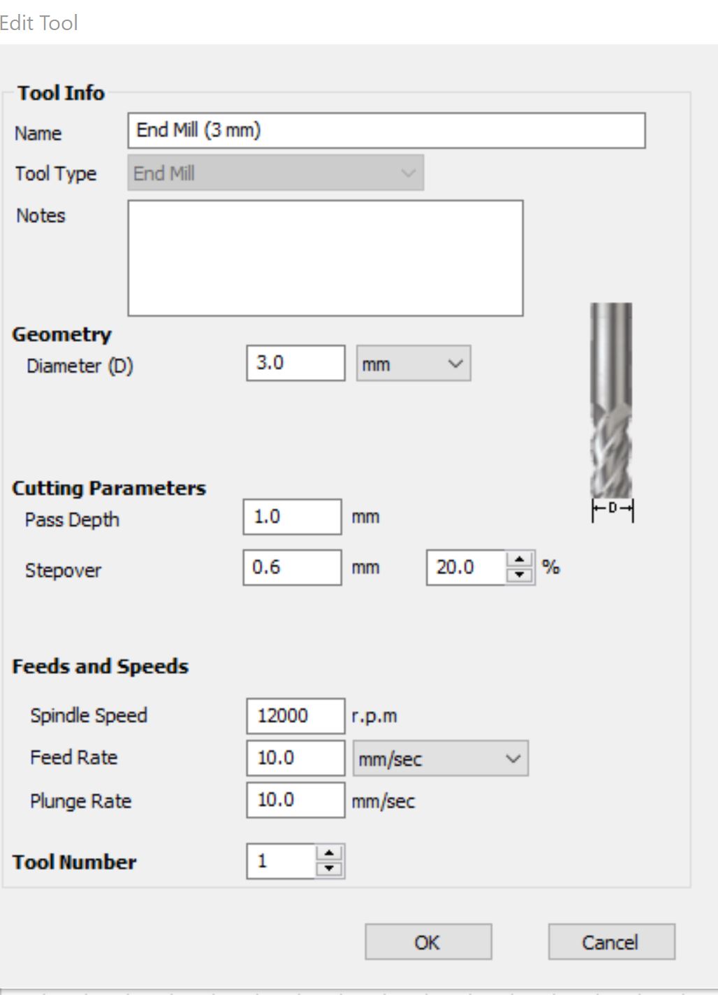

    Material is chipboard (just to practice on) RPM I have varied from 10,000 to 24000 (max) machine is a C-Beam from Open Builds

    Well, that's two details which don't help.!. . .But you didn't answer my questions regards speeds n feeds your using.
    perhaps this will help

    I am new here, and I am using a Chinese 6040 machine with a 2.2kw spindle, for plywood I run at 10,000 rpm 254 feed and 80 plunge, with a 3mm end mill,and get excellent results, the top edges are very clean.
    I intend to try Aluminium next, so some experimenting is needed.

    How many flutes ??
    That is way too slow. I don't know what machine you have but I would start by triple those speeds ie. 1800mm/min at 14000 rpm
    Be prepared to break a few cutters.
