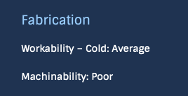

    Ok,just found the receipt, it is 5083 aluminium.The cutter is a 6 mm straight 2 flute at 32 mm long

    Quote Originally Posted by erniehatt View Post
Name:	Screenshot 2020-10-23 at 09.13.00.png
    Good luck!
    Worth reading about the spec before investing a lot of time or cost with cutters.
    (source: http://www.aalco.co.uk/datasheets/Al...Plate_149.ashx )
  3. #23
    Ok well, it's a good grade to cut, not so sticky. However, your cutter is quite long and being straight flutes not ideally suited to aluminium. The stick out will have a large effect on feeds and the straight flutes won't clear chips very well. So I'll say it again because cannot stress enough how important it is to clear the chips away, lots of Air and occassional spray of WD40 will be needed.
    Given these new details, I would start with halfing those settings I gave before and work up changing one setting at a time to see the effect. 1st I would play with RPM, then Feed then DOC.

  4. #24
    Good luck!
    Tells you absolutely nothing of any value for deciding cutting parameters other than hardness, which in aluminium doesn't mean so much because it's often full of hard n soft spots.
