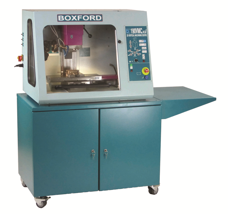

    Paul, if the 190 is fully function with the boxford software would you still recommend changing it to linuxcnc?
    bernie
  11. #9
    Quote Originally Posted by BernieNUFC View Post
    bernie
    If you have the boxford software and it’s all functional then maybe not
    I’ve never tried the boxford software myself. I was told it was about £600 and the boxford would deal with educational establishments so even if my pockets had been deep enough then boxford would not sell it to me anyway
    Also bear in mind that it was aimed at education as against industry and as such may be far from std in terms of G code etc
    Are there any post processors that spit out boxford std g code ? As without this your life will be much harder
    Linuxcnc is at least current and if there are any hardware issue then the electronics being replaced with new stepper drivers etc makes it all new and compatible
    This is the root that I chose but I didn’t have the boxford software as an option
    Paul
  12. The Following User Says Thank You to depronman For This Useful Post:
  13. #10
    Quote Originally Posted by depronman View Post
    Paul
    Its better than i thought, its in brilliant condition and has all the cd's with manuals and software v10, it is loaded and working via usb on a win 10 pc and i have downloaded a 260 post processor for fusion that has been created by someone and i have asked the question if this will work on my 190, i am in a very very new area to what i am used to so need to go slowly, but i have to say i am excited :-)
