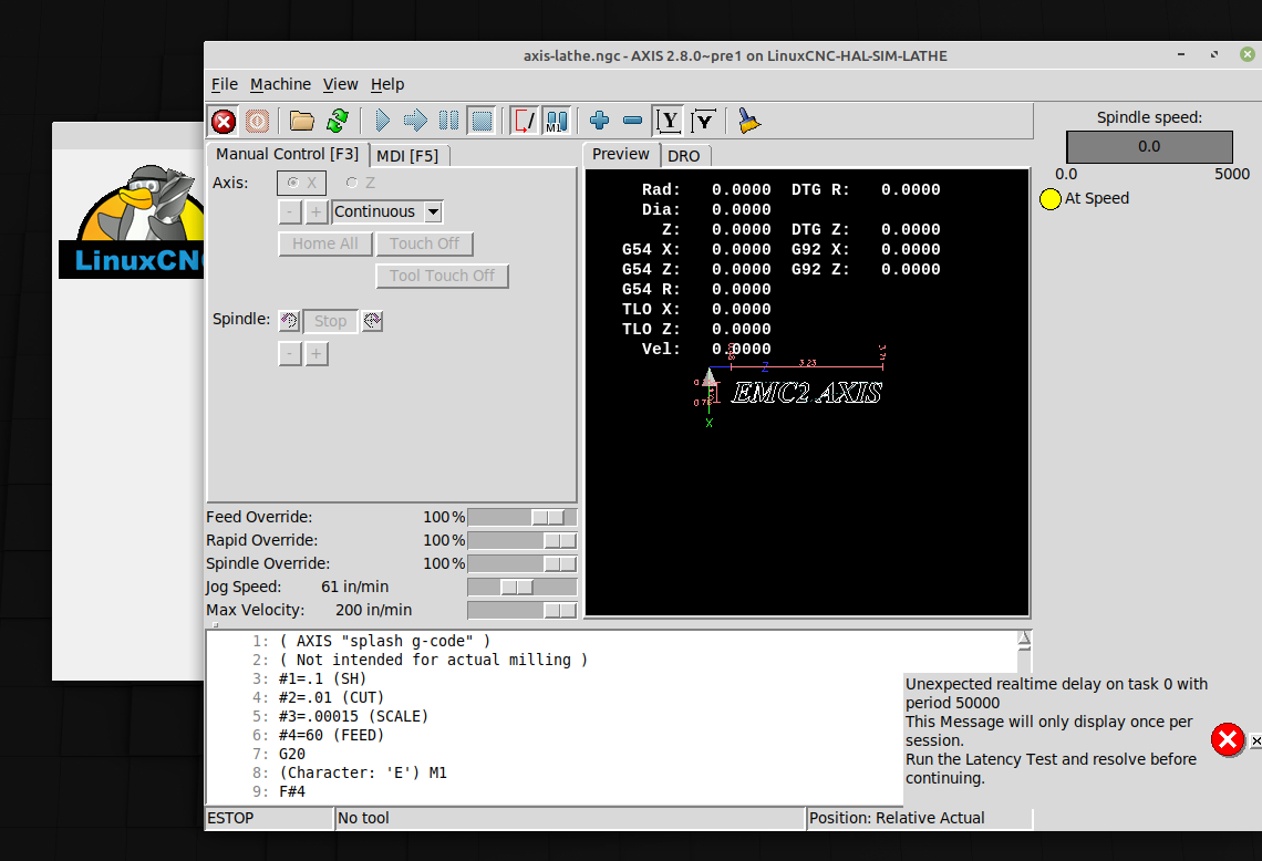

  9. #68
    so this is what I was looking at
Name:	Screenshot at 2020-10-18 18-25-23.png
    Maybe I just need to send Clive a pen drive .
  10. #69
    Quote Originally Posted by John11668 View Post
    Pat yourself on the back you have the pendrive
    Ok you have linuxcnc loaded but what you have there is the sim. you have Linuxcnc but the error is showing that the pc might have to be setup by changing some setting in the bios
    Now find the wizard and use stepconf to make a real working config.
    are you going to use a P/port ?
    See my post with the link to stepconf
