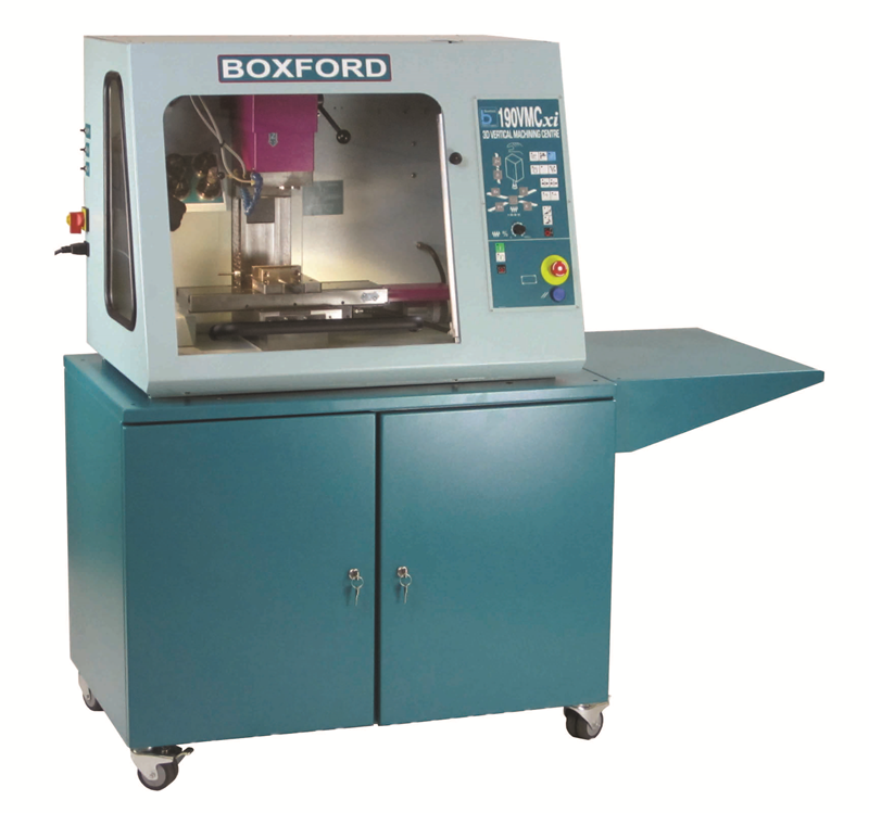

  9. #78
    Any change of a picture or two of the front of the machine please
  10. #79
    Mine is identical to this
  11. #80
    So a slightly newer version than mine is
    What does the blue button at the large section of the control panel do. Mine does not have that
    Paul
