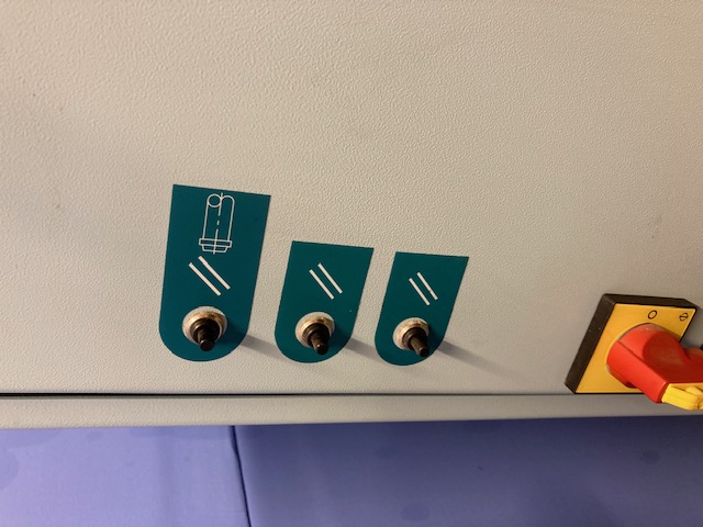

  6. #76
    Anyone tell me what these buttons are for please?
  7. #77
    Quote Originally Posted by BernieNUFC View Post
    I would think trip reset buttons for various thing
    Maybe axis movement is one. Spindle / cutter rotation would be another
    Paul
