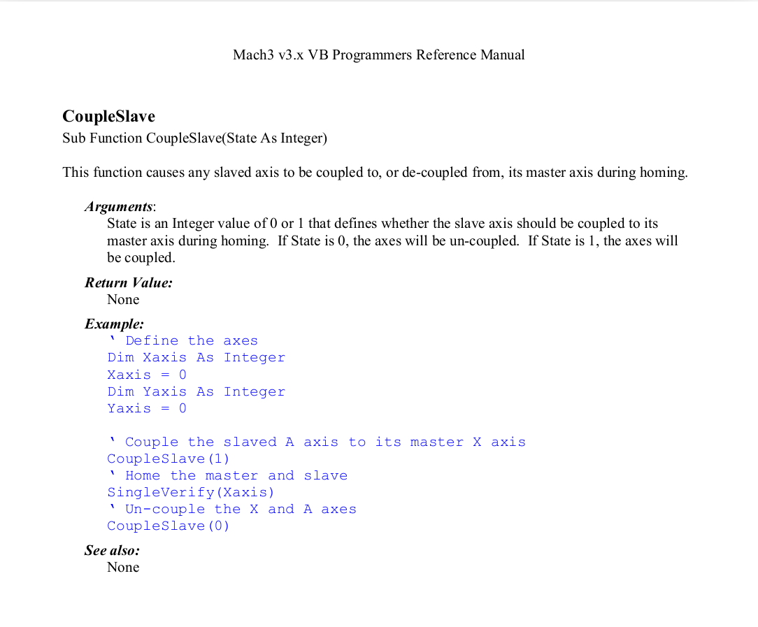

    If you have slaved axes on your gantry, in Mach3 v3.x VB Programmers Reference Manual you will find the following:

    Also, from CNC Zone:
    "Art wrote....
    > Common problem. When you home , the slaving is disabled till the home is
    > done. This is done to auto-square the gantry of such a system, thats why
    > the
    > lack of slaving when you stop the homing.. The solution is to make the
    > homing go in the correct order. This is done by modifying the Homing
    > button.. If you open the 1024.set file in the screen designer and double
    > click the "Ref All-Home" button, you will see the code is
    > DoButton( 24 )
    > DoButton( 23 )
    > DoButton( 22 )
    > DoButton( 25 )
    > This basically calls the Z, then X then Y and A homes. This needs to be
    > changed to ..
    > DoButton( 24 ) ' this homes the Z
    > DoButton( 23) ' this homes the Y
    > RefCombination( 9 ) ' this will home the X and A at the same time.
    > RefCombination accepts a number where X = 1 , Y = 2, Z = 4, A = 8, you
    > simply add the values of the axis
    > you wish to home, so X + A = 9..
    > The squaring will be automatic and can be adjusted by your settings for
    > the home position of the switches..
    > Thanks,
    > Art
    > www.artofcnc.ca

    ZASto is quite right - that is the way to do it. I was using Mach3 with my CSMIO for so long that I had forgotten about this. However, it does need the A and Y home switches to be separate and taken to different input pins on the BOB, and then you need to configure these in "Ports and Pins." Apologies if you have already done this, but it's easily overlooked.
    This capability is one of the nice things about Mach3 - you can home multiple axes at the same time. I used to home Z, then Y and X+A simultaneously. Saves time on a big machine to do X and Y at the same time. As mentioned, though, it only works if each home switch goes to a separate input pin, which can be a problem with the old parallel port BOBs (not enough pins).
