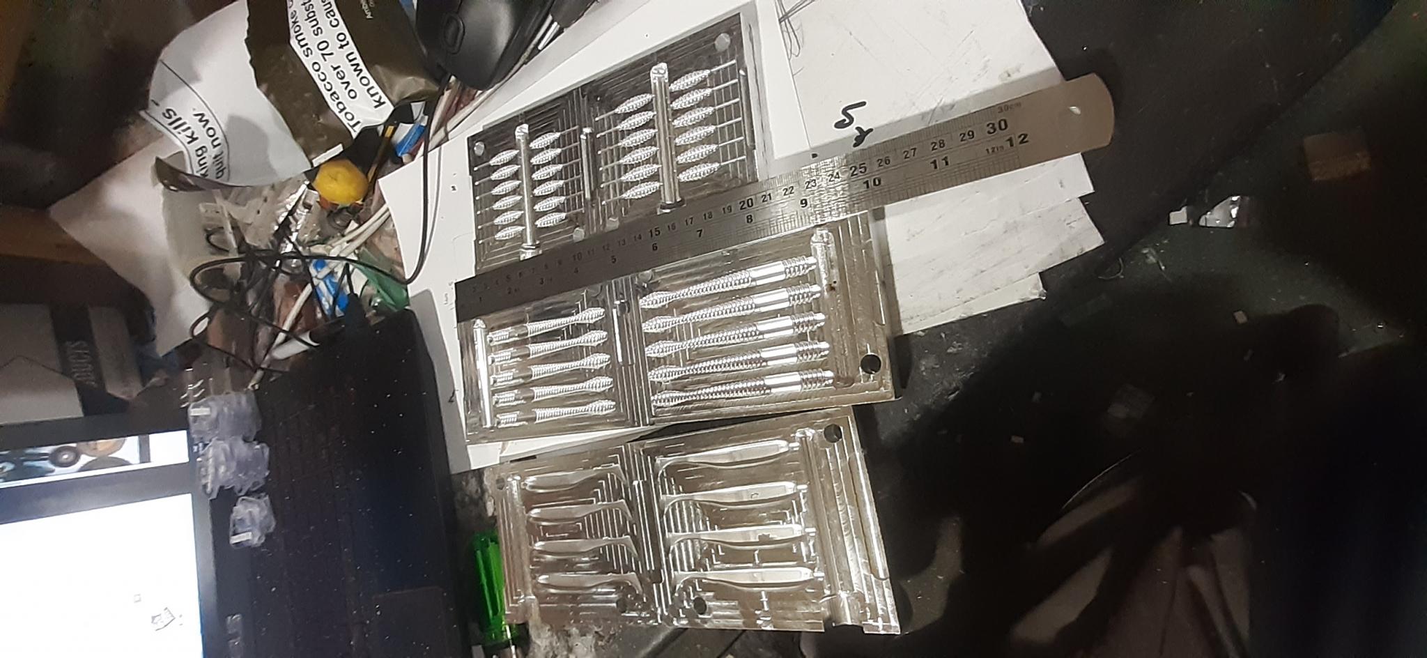

    Depending what you want to cut you may get away with a Denford Router, though it isn't the recommended route it would give you well over 9" x 9" you are looking for. Most of my work is engraving or fine detail aluminium where the biggest cut I need is a 0.2mm deep facing cut with an 8mm tool and the majority is roughing and finishing with 1, 2 and 4mm tools so I bought a Denford (it may be a Pro 2600 but I am not sure) and fitted a chinese 2.2kw water cooled spindle. Click image for larger version.
