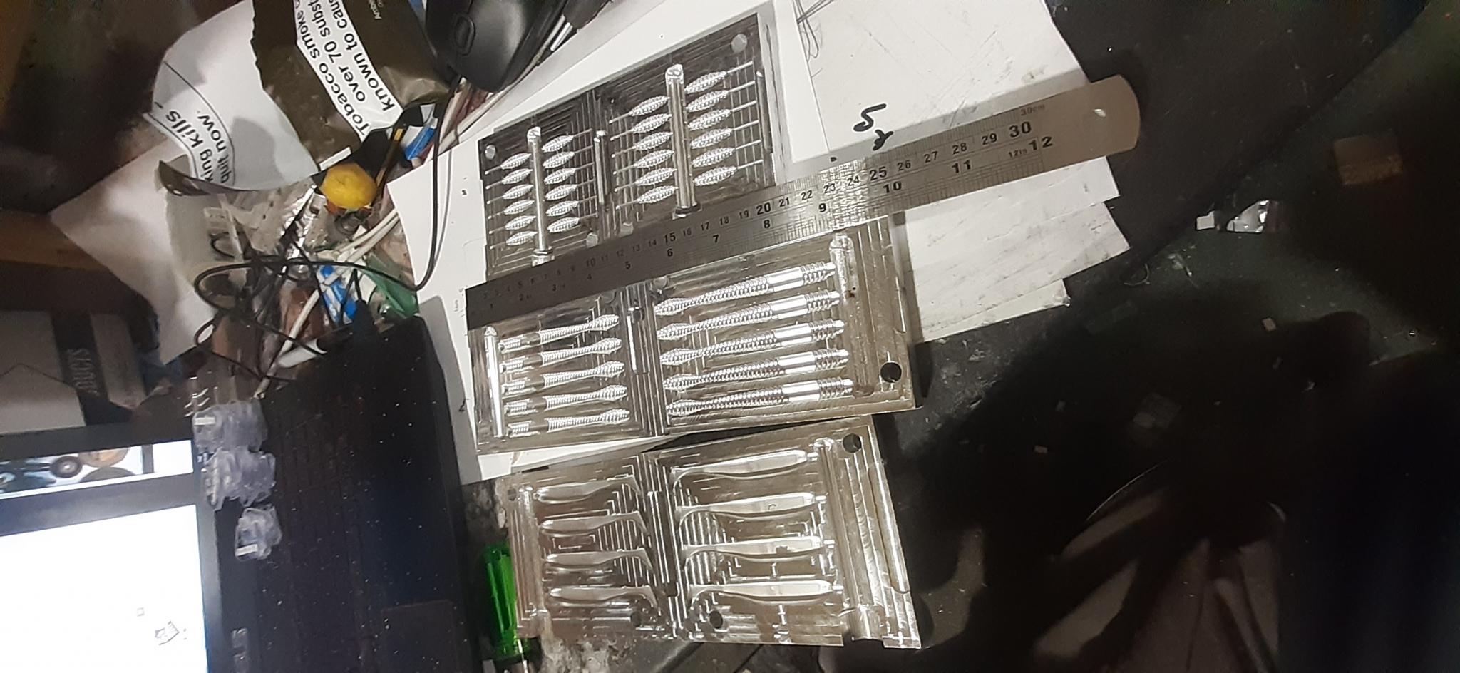

    Depending what you want to cut you may get away with a Denford Router, though it isn't the recommended route it would give you well over 9" x 9" you are looking for. Most of my work is engraving or fine detail aluminium where the biggest cut I need is a 0.2mm deep facing cut with an 8mm tool and the majority is roughing and finishing with 1, 2 and 4mm tools so I bought a Denford (it may be a Pro 2600 but I am not sure) and fitted a chinese 2.2kw water cooled spindle. Click image for larger version.

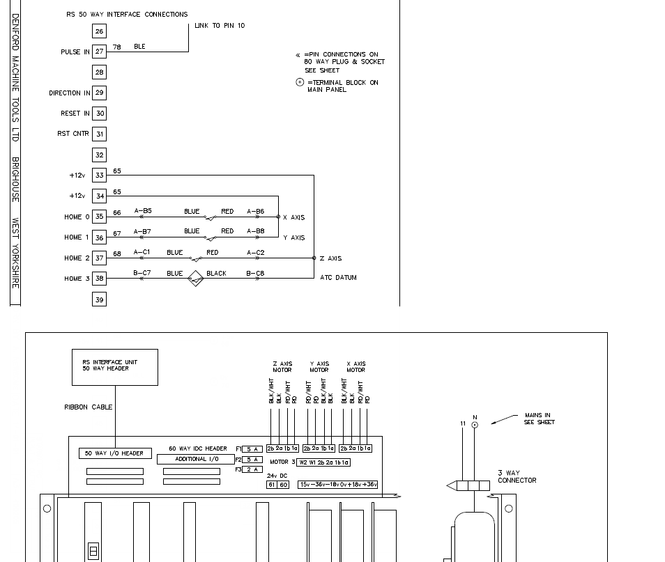

    hi Just a quick question I am getting a starmill that has mach 3 on it , could you advise what tool probe do you use and how did you set this up with the machince. Mine has the original controller board and can see a spare connection for the tool probe, next to the xyz datums ?

    Hi Thanks for the reply
    Where did you connect the sensor to as I can not see a spare connection on the board and or rs connector

  12. #18
    My star mill is converted to mach3 so I connected to the BOB
  13. #19
    :) which BOB did you use :)
  14. #20
    One of the eBay specials from China. The one with the 3 relays on it
