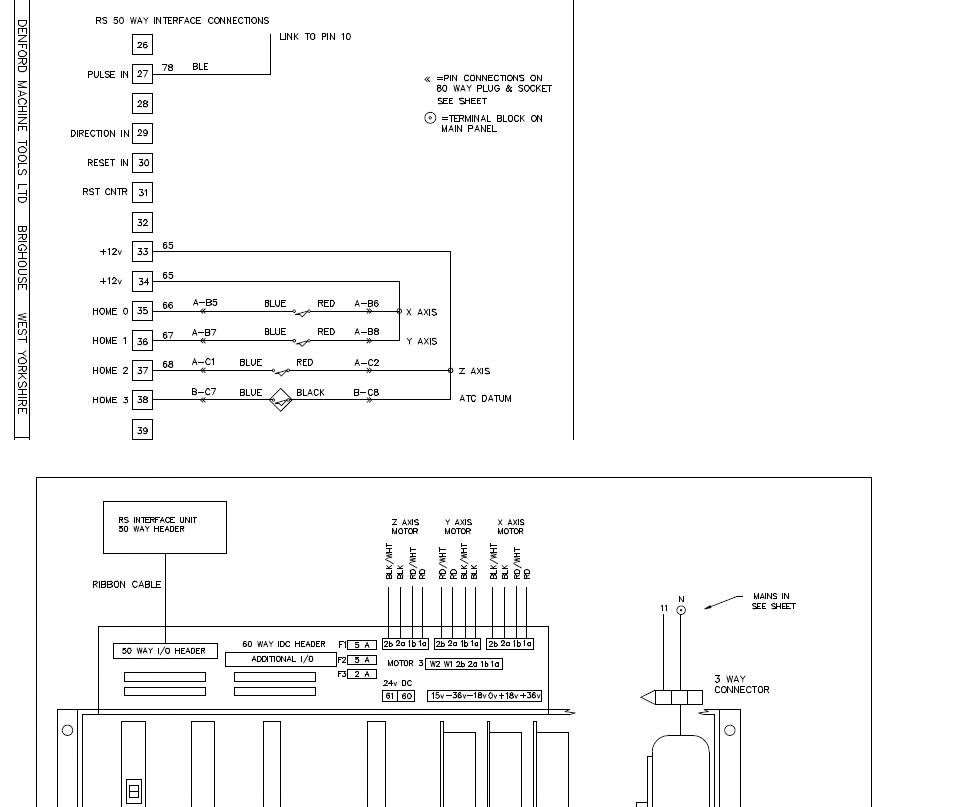

    Quote Originally Posted by Manny View Post
    Hi Thanks for the reply
    Where did you connect the sensor to as I can not see a spare connection on the board and or rs connector
    Attachment 29246
    If the mill has been converted to Mach 3, then those wiring diagrams will most likely not apply.
    Also, Denford never had an option for a touch probe, so there will be no dedicated wiring in the original Harting connector for one. You'll either need to see if there are any redundant wires in the plug from the retrofit, add new pins, or run wiring externally for a touch probe.
  3. #23
    I ran an external wire
