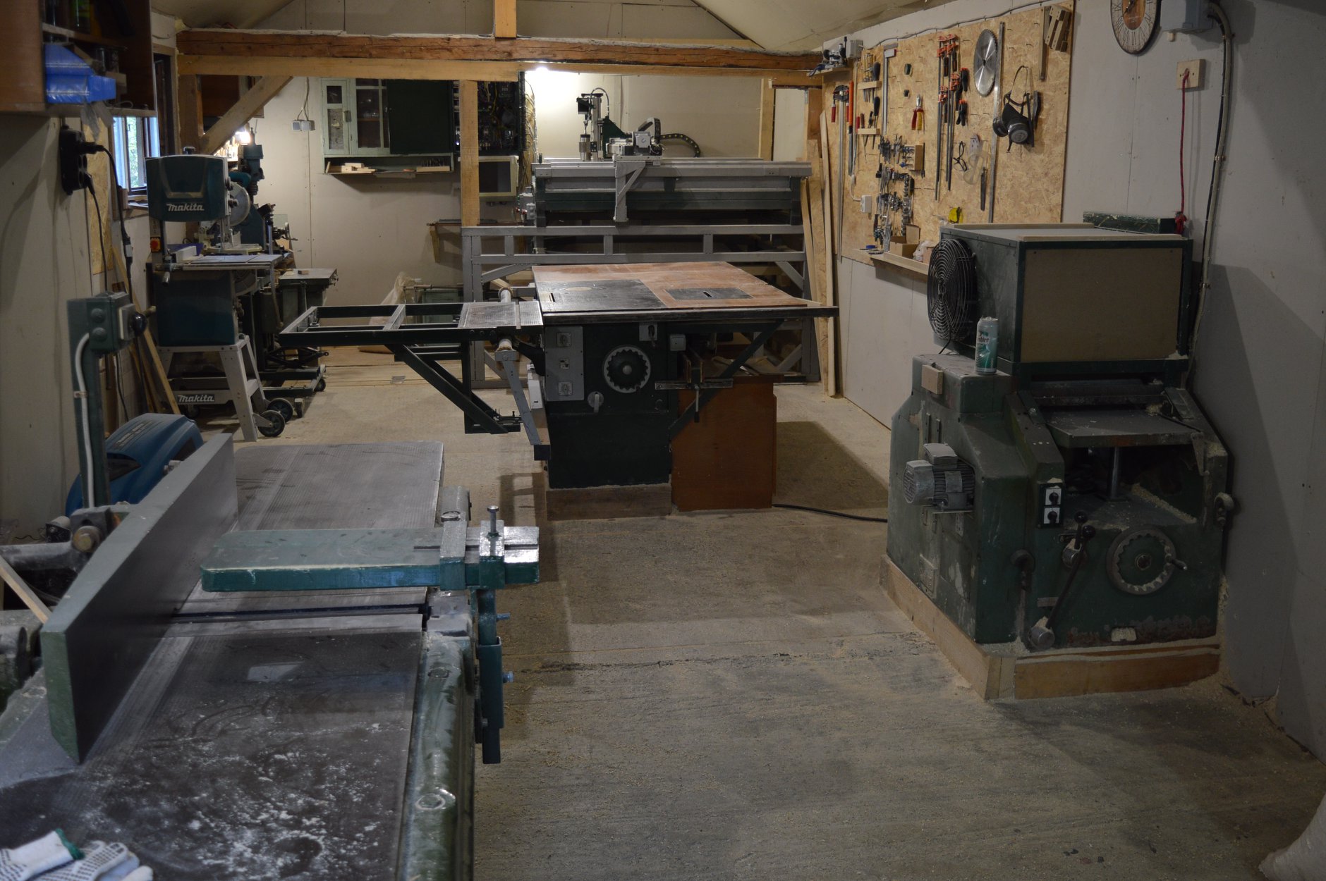

    Hi. I would very much like to figure out how to do a mechanism, including a display and keyboard control panel and a stepper motor, in order be able to imput manually the distance I want to raise and lower the table saw blade, and get away of the handle and ruler method. Preferably without involving a pc unit. So if you have any ideea, please let me know.

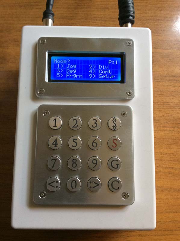

    There is a small controller you built yourself that drives a stepper motor via a keypad with a small screen so the user does not have to input G-code or use a computer, all it takes is a key press that would work on this saw project for you.
    You can set up a program with it to do division so a certain amount of turns of the stepper lifts the saw blade to a given height and same in reverse to lower, this you would need to workout yourself.

    Phill

    No problem,http://www.worldofward.com/rotarycontroller/shop/

    If I understood right from what you said, a DRO unit is just an indicating unit. It is not a bad ideea, but I am inclined to attemt to make a magnetic device with a dial indicator on top, or something far more simpler (I do not know what yet :P) that serves the same purpose. I'll keep in mind the ideea. There are a few unit on ebay that can indicate 2 axis, and come with glass scales, around 200$ + transport. The approach it different from what I had in mind. (one home switch that zeroes the blade, and then a metric command given to a motor), but it might still work. Thank you.

    The thing that bothers me when working, is getting on my knees to see the ruler indicator on the thicknesser and to position a metal ruller next to the blade when cutting tenons or other similar stuffs on the table saw. I had in mind the stepper motor approach, because a couple of years ago, with the assistance of some very patient guys on this forum, I managed to build a cnc machine, so I know a bit more about this things, rather than arduino. But it is on my bucket list to learn arduino, and conquer the world with an army of tiny drones..whuhaha. :P

    Hi phill05.
    I like very much how this thing looks. Just to make sure, I got it right. I need to order those 6 items, then do some soldering, then do some settings via the keypad. No programming required. No pc.
    It totals around 100 pounds plus international postage in my case. Can be payed via paypal. Did I get it right? Also, is is possible to buy an already assembled unit, or this is the only way available?
