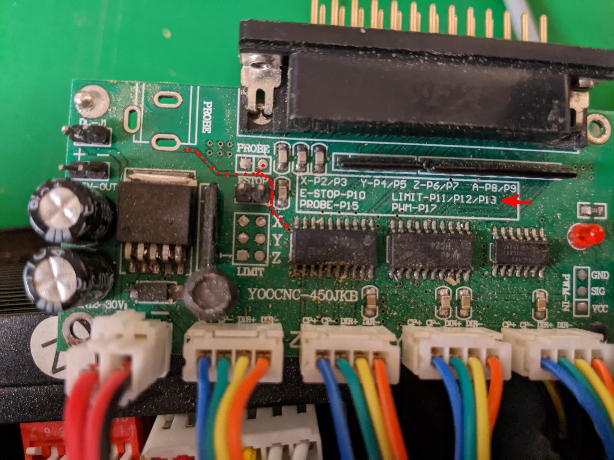

    My opinion : The BoB should be suited for the mod.
    Squinting at the PCB images, it appears that there's a SIL resistor package that pulls-up the parallel port "inputs" (X/Y/Z/E-STOP) to the onboard 5V, and the pin-pairs allow the connected switches to ground these through to ground. Apart from a failure on the board there's not much to go wrong.
    Power OFF, disconnect limit switches, disconnect computer cable:
    1) Verify the three pads marked "GROUND" have low resistance between each (100% confident they will)
    2) Verify continuity between pad marked "11" and pin 11 on the DB25 connector. Yes, the long row are pins 1-13, the short row 14-25. The pins are usually marked in the connector, but at 51 years old I can't read them. Pin 13 is the one closest to the jack socket that you want to add.
    3) Verify continuity between pad marked "12" and pin 12.
    4) Verify continuity between pad marked "13" and pin 13.
    5) Verify no* continuity between pad marked "11" and the adjacent "Ground" pad.
    6) Verify no* continuity between pad marked "12" and the adjacent "Ground" pad.
    7) Verify no* continuity between pad marked "13" and the adjacent "Ground" pad.
    (* : "No" - certainly a lot higher than a few ohms - these signals are pulled to the onboard supply line, so there can be/will be some measurable resistance but would expect this to be >1kR)
    8) Verify high resistance between pad marked "11" and "12" (high = at least 2kR, depends on the SIL resistor values)
    9) Verify high resistance between pad marked "12" and "13" (high = at least 2kR, depends on the SIL resistor values)
    10) Verify high resistance between pad marked "11" and "13 (high = at least 2kR, depends on the SIL resistor values)
    If you're prepared to test "powered" - reconnect all power, computer and switches:
    11) X-Axis switch "closed" - voltage on pad "11" = 0V (measured, with respect to the ground plane on the board.
    12) X-Axis switch "open" (or removed from board) - voltage on pad "11" = 5V.
    13) Y-Axis switch "closed" - voltage on pad "12" = 0V (measured, with respect to the ground plane on the board.
    14) Y-Axis switch "open" (or removed from board) - voltage on pad "12" = 5V.
    15) Z-Axis switch "closed" - voltage on pad "13" = 0V (measured, with respect to the ground plane on the board.
    16) Z-Axis switch "open" (or removed from board) - voltage on pad "13" = 5V.
    If all these measure okay - and I'm confident that without a failure on the board that they will, then the BoB is okay.
    As an suggestion for your experience yesterday, with nothing working, double-check that your supply voltage to the BoB was present - the BoB depends upon the pull-up to the local board supply to get the "logic 1" (switch open) sense level.

  6. #36
    You have already pins for limit switches on DB-25 connector:
    XLimit - pin11
    YLimit - pin12
    ZLimit - pin13
    For probe, just solder a barrel connector to the board. Central pin is the probe input and it IS connected to the rest of electronics.

    Thank you Jazzcnc and ZASto I did see the marking that Dodgy did, and I have the probe wiring sorted, I could not work out what size barrel connected to get, so I got wired the pads and brought the wires out to a connected strip on the back of the control box.
    With Doddys help we have confirmed the board is working and the limit switches work, unfortunately the switches activate the BOB at regular intervals, due to noise interference, again with Doddy's help we are sorting that out, then the next step will be setting up the home switches, followed by the soft limits then machine coordinates, but I am getting ahead of myself.Thank you all
