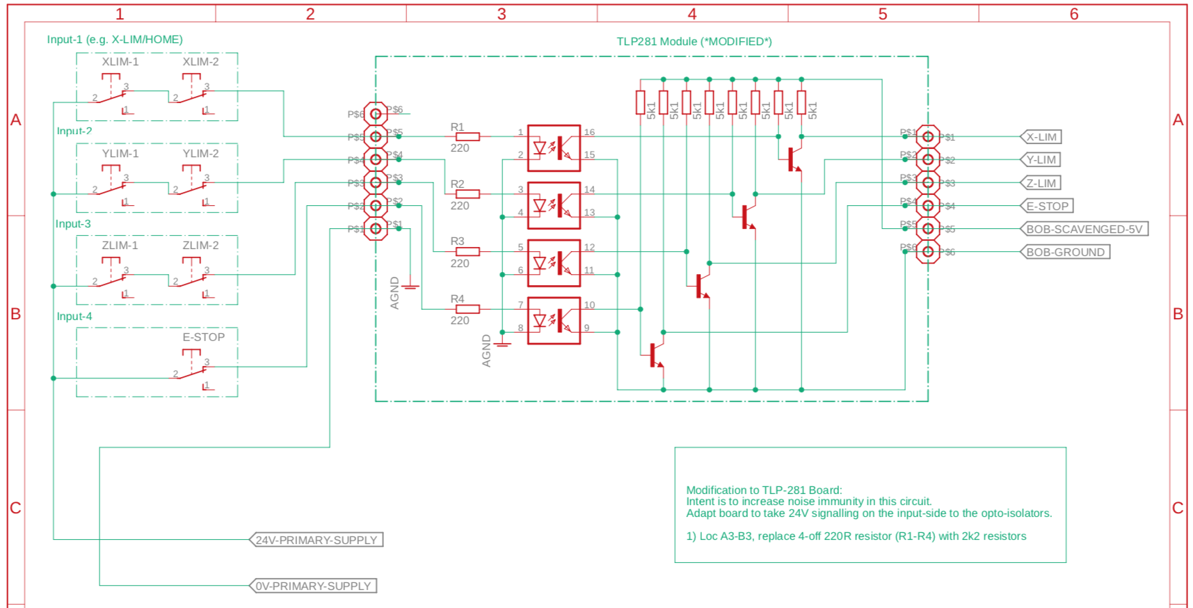

    Okay, Richard, there's a lot of information missing for people outside of our conversation here, and in particular what a "filter board" is in this context. Let me fill in the blanks that people will otherwise ask, and perhaps ask a few questions myself...
    Quote Originally Posted by RichardR View Post
    Having set the programme and machine up so the limit home and soft home all worked I fitted a noise filter as per instructions both having been supplied by a forum member
    "Having wired the machine with independent X,Y,Z limit switches, each axis wired with two switches in series in a Normally-Closed mode, onto a modified BoB (shown in images on page 1 of this thread), there were problems experienced with noise on any/each axis limit switches that generated spurious limit triggers with Mach3. We did try to address the noise issue by increasing the 'Debounce' value in the Mach3 configuration settings, however, whilst increasing 'Debounce' did reduce the occurrences of spurious limit trips, they were still evident.
    Some kindly soul suggested that, in reviewing the board layout, the BoB simply presents the limit-switch input straight to the parallel port interface with nothing but a pull-up resistor (and privately, possibly a filter capacitor). This means that any electrical noise picked up by the wiring in the machine is presented directly to the parallel port input into the computer, and could be a mechanism for noise susceptibility.
    To try to counter this, it was suggested to introduce a commercially-available opto-isolator board, in this case a 4-channel device. In reviewing the schematic for the opto-isolator board, noting the positive-side switching, a wiring scheme was introduced (and modifications made to the board) to support 24V switched limit switch inputs to attempt to improve noise immunity, thus:

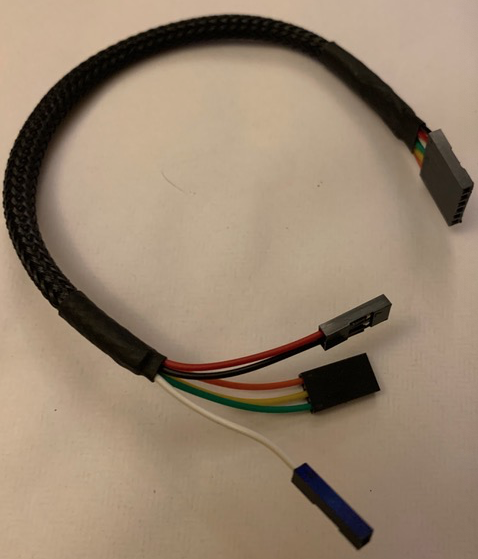

    and provision of cable assemblies, thus:
Name:	Screenshot 2020-10-31 at 06.56.14.png

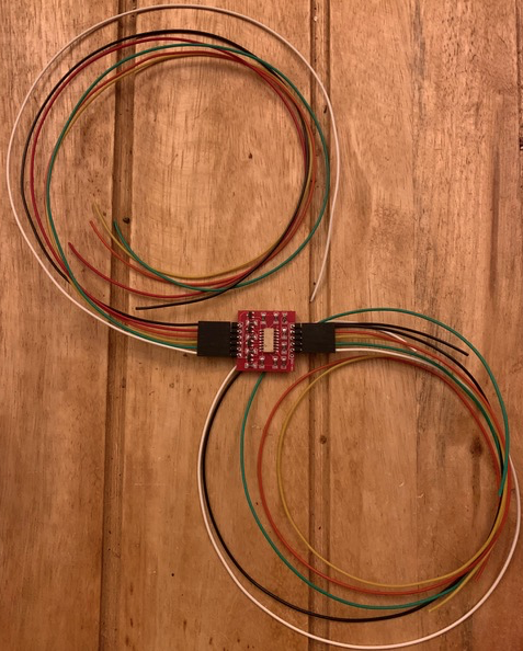

    and finally with a special-to-type cable assy to connect the opto-isolator board directly onto the board, previously modified with pin headers to access the X/Y/Z limit switches...
Name:	Screenshot 2020-10-31 at 06.57.44.png
    now the limit and Home switches do not work, it had gone into e stop mode
    Quote Originally Posted by Kindly Soul's reply
    Quote Originally Posted by Richard - Private Email
    I have no e stop fitted yet, should I connect the e stop connection to the 24 common so it looks as if one is fitted
    It’s a plan, or set it active high/low in Mach3. ESTOP is normally N/C so wiring 24V to the ESTOP filter board input would work
