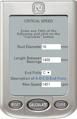

    @NordicCNC
    You still need a 32mm ballscrew at 1500rpm and 10mm pitch for 1400mm travel. Calculator for critical speed.

    Quote Originally Posted by jarjar View Post
    @NordicCNC
    Many thanks for the link! Seems like if I would use fixed bearings in both ends, I would barely make it!

    Quote Originally Posted by NordicCnc View Post
    Yes, price difference seems to be only about 15-20% for either 25mm or 30mm rails. If it is bringing me added value and it isn't overkill, I think I am ready to go for the 30mm rails.
    Don't forget to include the carriages in the cost estimate.
    You'd be just about okay with a 1200mm 2010 screw @ 1500rpm.
