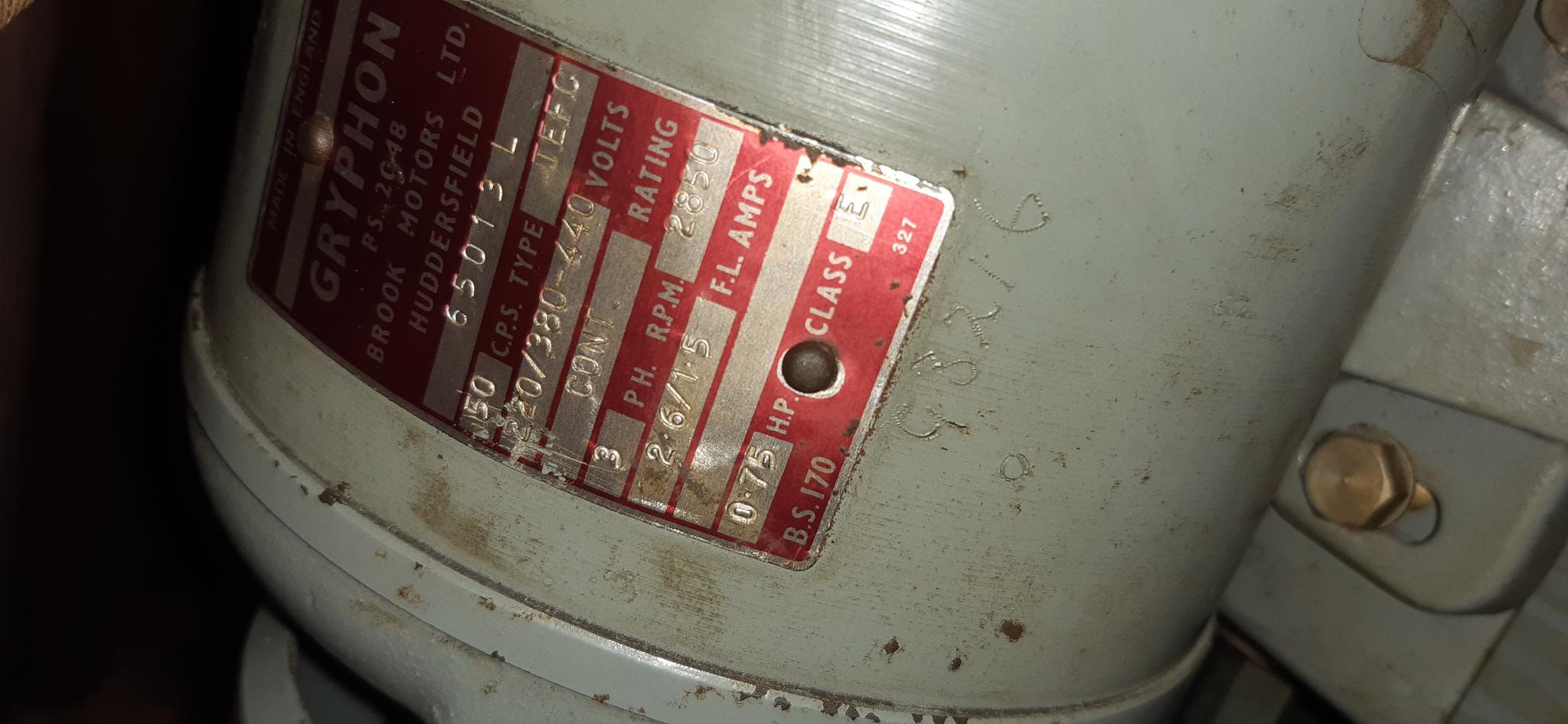

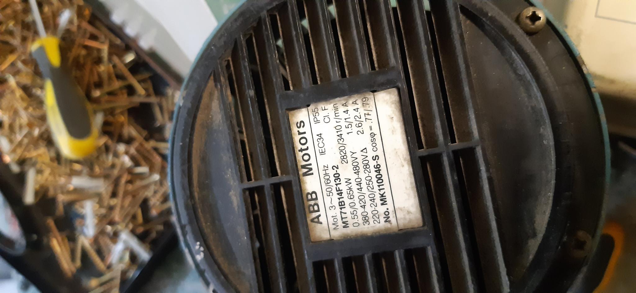

    Not pecifically CNC but I thought someone on here may be able to help. I have obtained a Clarkson cutter grinder which came with a dust extractor, both being 3 phase and I have been looking at the possibility of running both off the same VFD with frequency fixed at 50Hz. Searching the web leads me to think this is possible but I am looking for the settings for the VFD. I have HuanYang 2.2Kw VFD hanging around so would like to try and use that.
    Has anyone on here done anything similar or have any tips?

    Overboard?, perhaps. I was perhaps a little concerned with starting two large-ish motors in parallel off a single VFD - gonna be a chunk of amps there. But overspending the VFD may well help a bunch there. The motor plates add up to about 1.5HP which is around 1100W, so a 2.2kW VFD is not stupidly large.

    Hi (again) from what I have read (and possibly misunderstood) I have two options:
    a) start both the motors at the same time in which case the VFD controls the ramp up speed of the motors so the VFD can be sized by adding the power requirements of the two motors.
    b) If both motors aren't started at the same time then the VFD must be sized by adding the FLA of the motor started first to the locked rotor amps of the second motor.
    Thsi is where it all becomes hard for me to follow - why do they mix HP and Kw confuses me.
    https://www.automation.com/en-us/art...ultiple-motors
    At this point I am leaning towards wanting to turn on the dust extractor independantly so I can use it with another machine as well as the grinder in which case I think it best to either get another VFD for it or convert it to 240V unless I put a switch in that would make the dust extractor become the primary motor instead of the grinder. Both motors being the same size helps here (I think).
