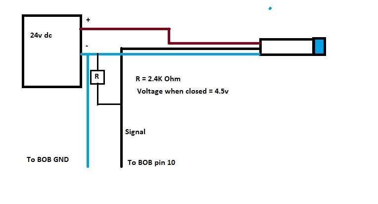

    Hi Guys
    I am using NPN Proximity switches from here and a 5v BOB from Zapp Automation . I fitted a 2.4k ohm resistor between the black signal wire and the blue (-ve line) and connected up to a 24v dc power supply. When the switch is open, the voltage between the signal wire and the blue line is 4.5v ok I think for the input to the BOB. When the switch is closed, it drops to 0.7v - measured using a DMM and the LED on the back lights up. I connect the black wire to pin 10 of the BOB and the blue wire to the GND. When I activate the switch, the LED does'nt light and nothing is detected via the diagnostic screen of MACH3. And yes the port & pins is set for the Home to pin 10.
    The 24v power supply buzzes and the indicator LED on it goes out. What have I done wrong?

    Connect one end of the resistor to +24V, not to PSU -ve. What you then have is the BOB input driven from the 24V with the resistor lowering the voltage to the BOB to a nominal 5V. When the proximity switch operates, it shorts out the BOB input to ground. Should be OK although it's not quite a conventional way to wire things, and it might not work reliably as it depends on the proximity switch bringing the BOB input voltage close enough to ground to trip the BOB input. You will have to figure out whether you then want active high or active low configured in Mach3 to do want you want - probably active low.
    Unfortunately the ZP5A manual is very vague on the details of the input connections. I don't remember now if the limit switch inputs have a common ground or if they are separate. I used to use one of these BOBs myself but that machine didn't use any limit switches so I never had to sort this one out. Can you check with a meter if the limit switch input ground connections are all connected together? It's possible that they are not, and in that case there is a better way to wire the switches. Take +24 via the resistor to the BOB input. Then connect the BOB input ground to the black wire on the prox switch. Brown and blue wires stay as they are on your diagram. This would probably need active high in Mach3 and from an electrical point of view is the "right" way to do it. However, it does depend on the limit switch grounds being electrically isolated from each other.

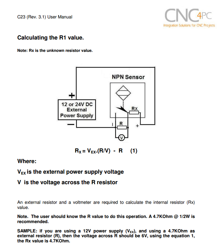

    Some of these switches have a 10K inside and limit the current to a few mA I have used these on 5V inputs without any other R's without problems

    Absolutely right. Here below is how to check if that is the case / credit goes to C23 BOB manual/

    People seem to be over complicating this.
    Given the BOB in question requires switched to 0V to activate the input, all you need to do is wire 24V to BN, 0V to BU, then connect the BK to the BOB input. You may need to also connect the BOB 0V to the sensor, however I'd assume this BOB doesn't have fully isolated inputs, and the 24V and 5V supplies already have their 0V connected at some point.
    An NPN sensor simply switches the output wire to 0V, and should go essentially open circuit when unactivated. You should not need any kind of pull up resistor on the sensor output.
    However as has been mentioned already, the sensor may not switch perfectly to 0V, and may struggle to reliably switch the BOB input. In that case, adding a small relay into the circuit would be needed.

    Hi Neale - I gave up on this for a while but now my machine is working nicely I really do need to get my "fish brain" around this and get the homing set up with these proximity switches so that I can do auto tool setting height etc. So if I understand your post correctly I need to do this as shown in the attached picture

    Choosing the appropriate value of R drops the voltage down enough for the input and away we go (hopefully!) .

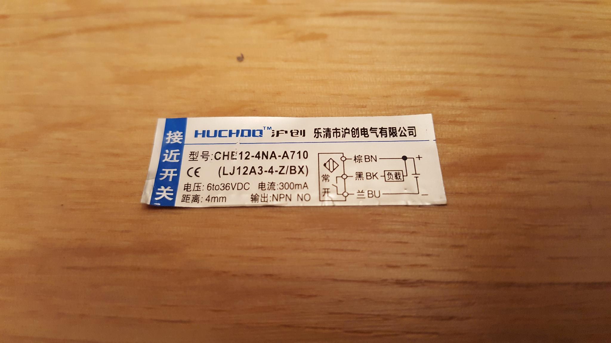

    Useful post Boyan. Applied the formula to the NPN I had with the external 2.4K ohm resistor I used and got answer of 10.4K ohm for the switch internal resistance. This seems consistent Clive S post. The switch does have 300ma printed on it. But I think this is too much current for the BOB input. So back to the Neale's suggestion. Will let you guys know how it works out.
    What that means is that the switch can source 300mA try putting a mA meter in circuit and see what you get.
