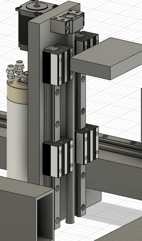

    I have made plans today after all. The whole square tubes are 100 x 80 x 6.3 mm tubes. The plates on the Z axis are 25 mm flat steel. There is one thing I would like to adjust that is not in the plans yet. I will weld 10 mm of flat steel on all support surfaces and have it milled flat. These are 25 mm guides and ballscrews with 20 mm.
    This is all still very rough, but I would be happy if you can tell me if I am on a real path or if there are already huge mistakes in there.

    I would swap the Z motor so that it is stationary .
    Like moving the ball screw to the back plate
    Add bracing within the tubes or at least rigidly cap the ends.
