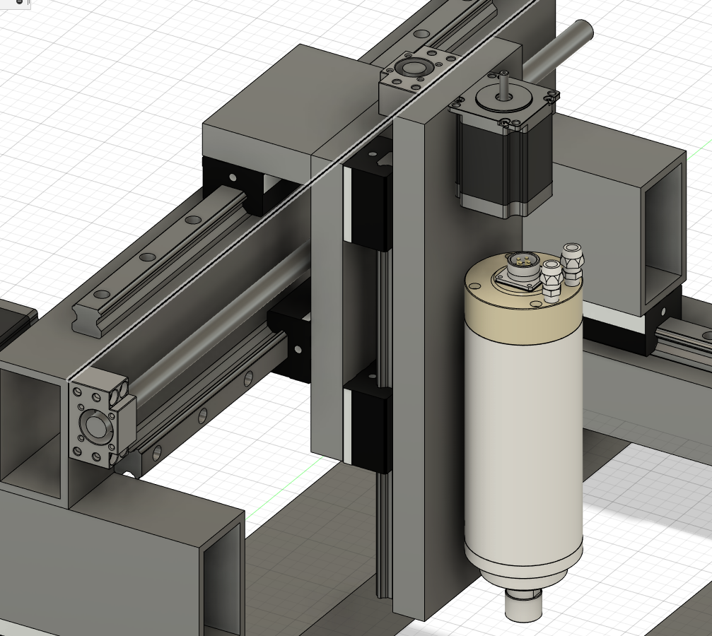

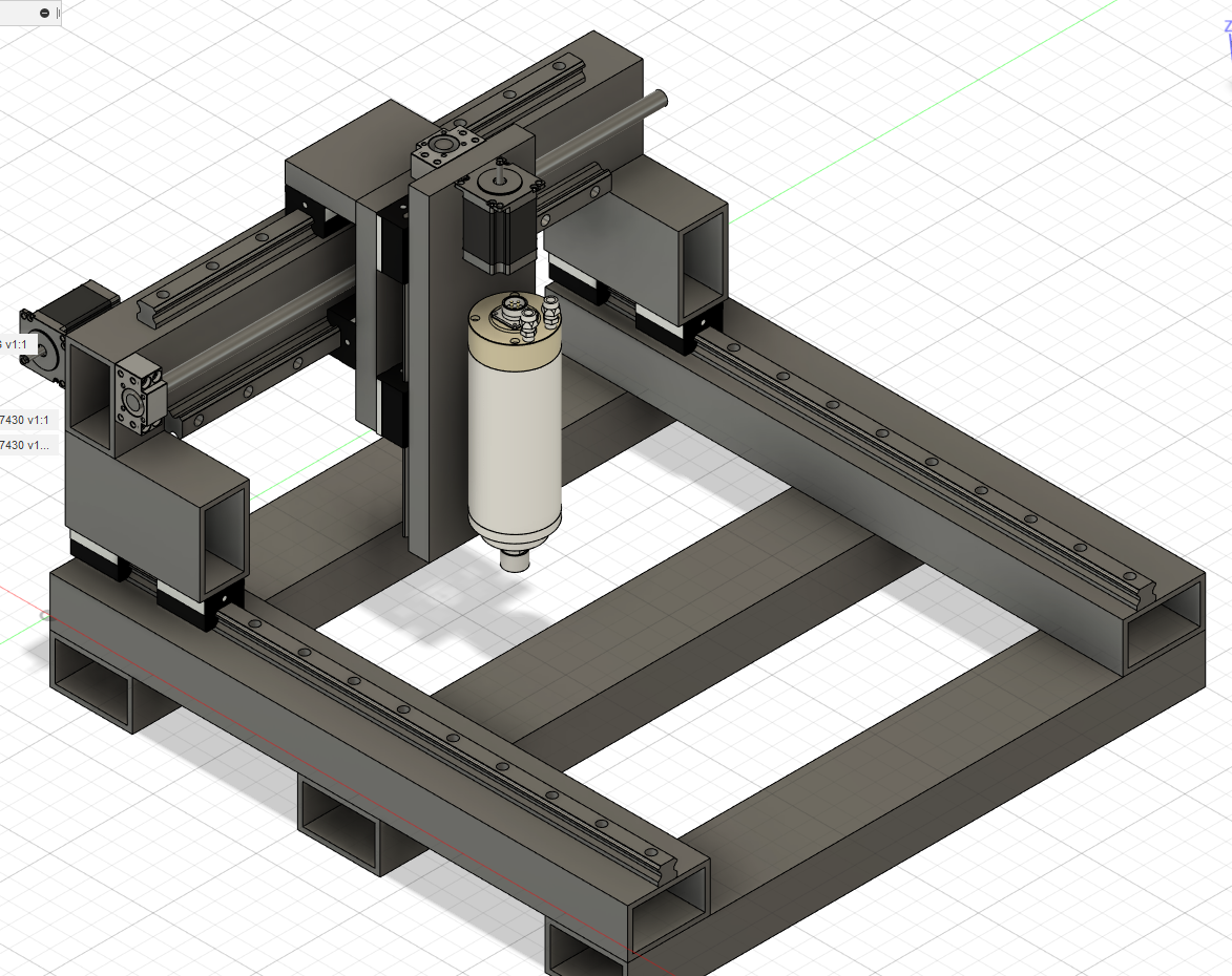

    I have made plans today after all. The whole square tubes are 100 x 80 x 6.3 mm tubes. The plates on the Z axis are 25 mm flat steel. There is one thing I would like to adjust that is not in the plans yet. I will weld 10 mm of flat steel on all support surfaces and have it milled flat. These are 25 mm guides and ballscrews with 20 mm.
    This is all still very rough, but I would be happy if you can tell me if I am on a real path or if there are already huge mistakes in there.

    I would swap the Z motor so that it is stationary .
    Like moving the ball screw to the back plate

    Hello iGyros,
    Look like you could use my design to refine yours.
    I have used 120x80x4 mm and 80x80 for the bed..
    Did you already decide on 1 or 2 ballscrews on the long axis?
    The linkage on those are a weak point in my design. I have no real world problems with it yet but would rethink it when done all over again.
    Grtz Bert.
