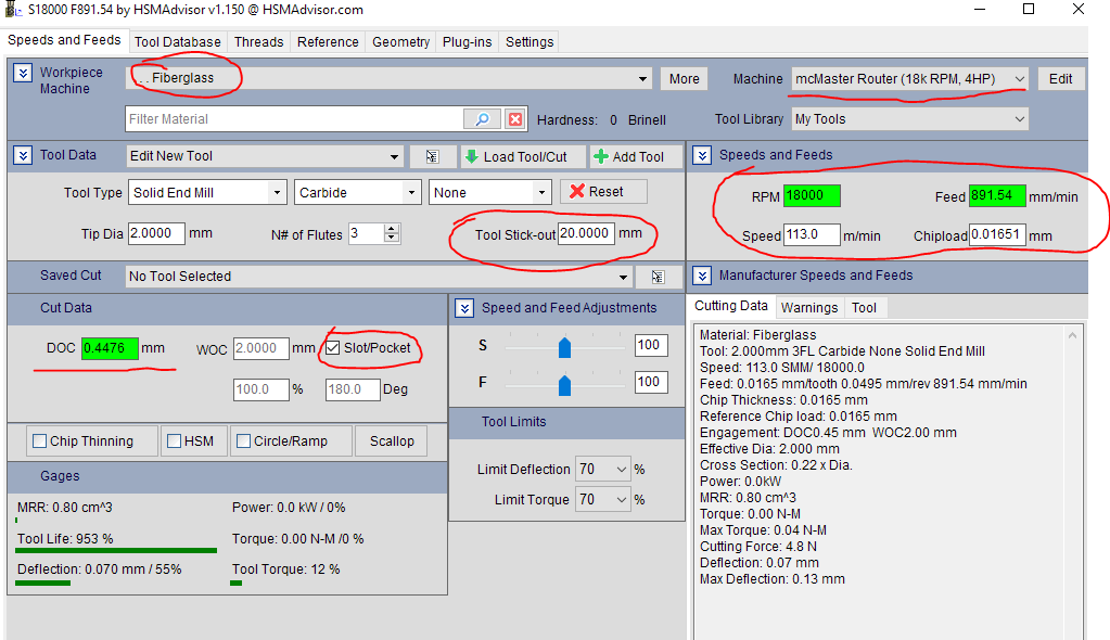

    I have never cut but should be similar to fibreglass. Take care of the stick out as this severely could change things. I calculated all based on 20mm/ the tool shows 20mm from collet/
    Hope that helps

    Ended up downloading an app came back with this info
