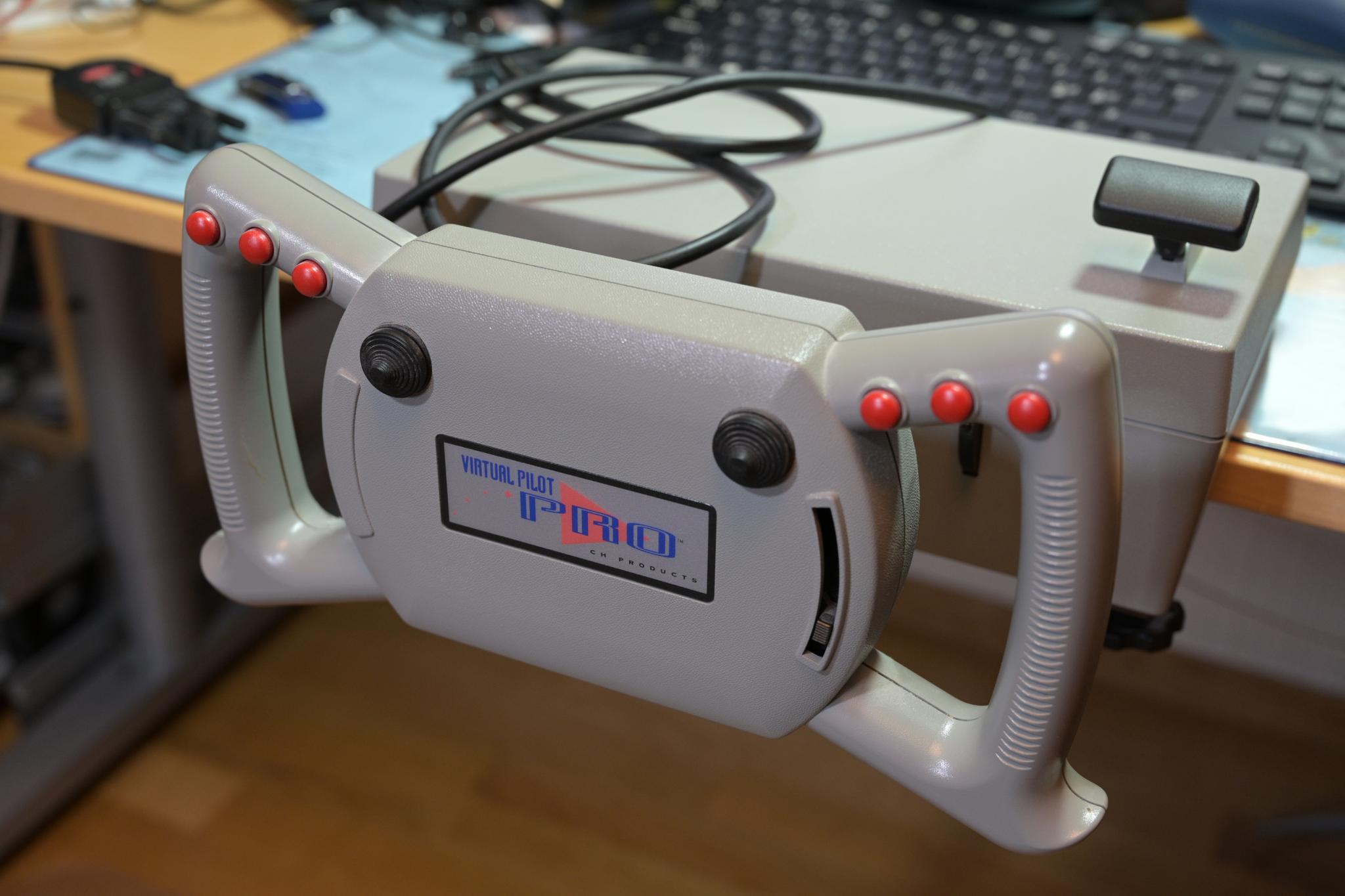

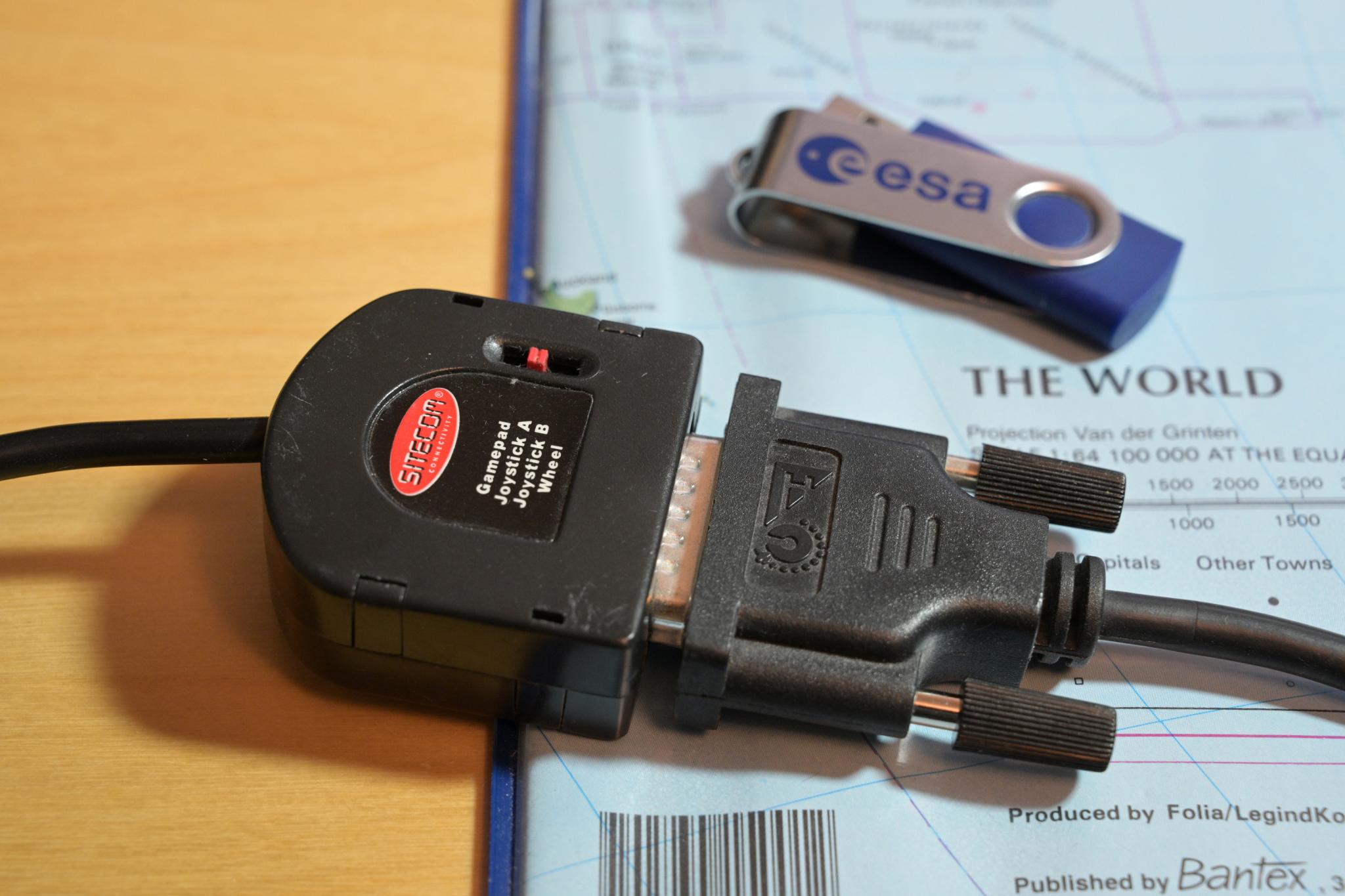

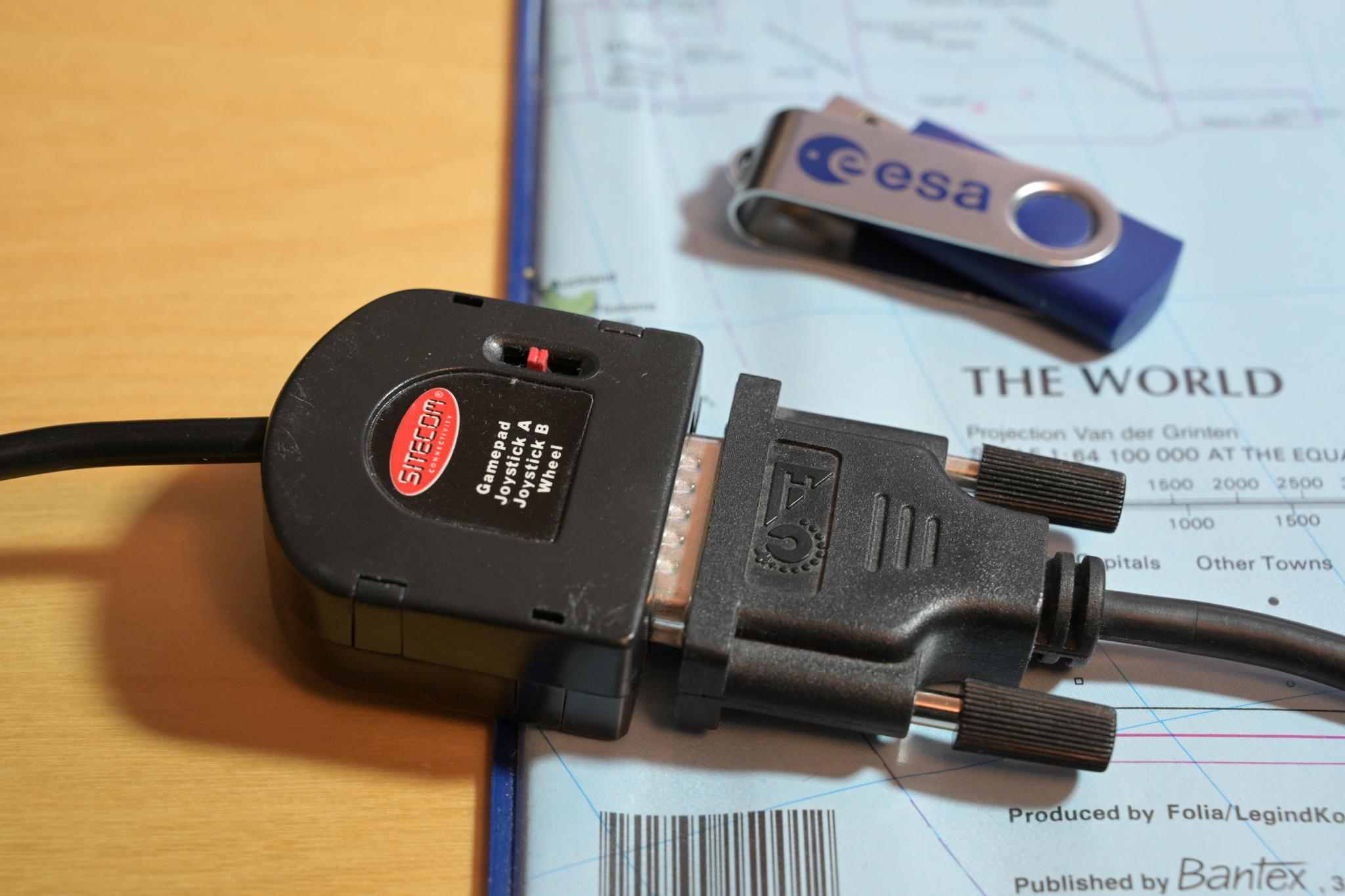

    I built my own over 25 years ago, but mine was of course not as nice as yours, even though they worked well. My flying days ended (for real and for simulator) about 10 years ago and I sold my pedals, only have the yoke and the USB Gamport adapter today, which I used. In fact, having read your thread, I connected it to my computer since I never used it with W10, and it seems that it still works, calibration and all buttons and controls are confirmed by W10.

    I don't have the actual wiring, but I remember that it was pretty simple to connect it together with the yoke. The game port has enough analogue inputs to do it, but you have to google since I don't remember exactly. In any case, analogue potentiometer is the best. Those have normally enough motion, just center it so that it can freely turn left and right. and make sure you set the pedal stops so that you don't break the potentiometer in case you have too much motion. Afterwards, when you connect it to the PC you can calibrate, so don't worry for now. Also, use a second potentiometer in series to add the possibility of trimming the rudder, like in a real plane. The second advice is to add two micro switches, or two potentiometers, one to each pedal, to allow the breaks to be realistic. Remember that a plane is not a car, so you have two breaks, one for each main gear, those are normally not synchronized, so you can break the right wheel or the left wheel separately if you need to (which happens when you fly for real).
    Anyway, I think easiest and best is to connect using a USB Geame port adapter. The advantage of that solution is that you can have almost any number of analogue inputs, while in the old days, we were limited to one or two game ports maximum, if I am not wrong.
    ...but this is far off topic for this forum, I believe you can ask for more detailed advice on a flight sim forum, or just simply google after information. Good luck and enjoy flying. The new MS flight sim is said to be fantastic, in fact, I may give it a go as well when I retire from real work in a year or two.
