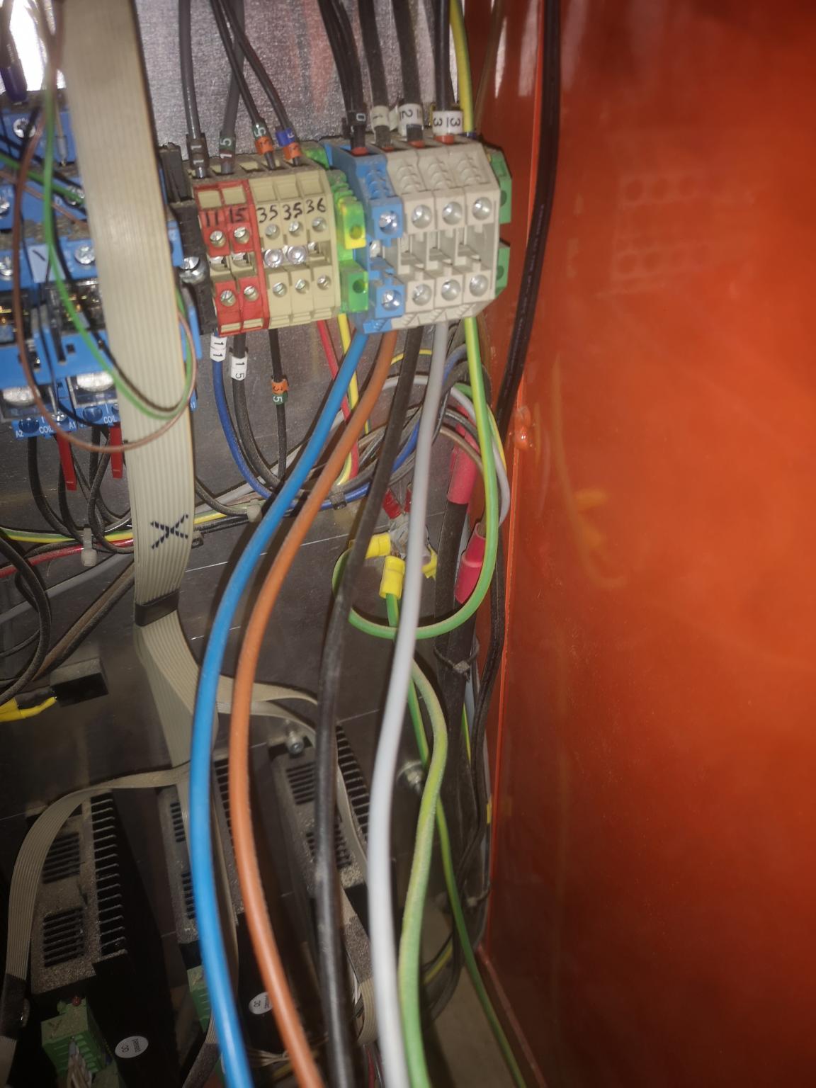

    I would love to keep my cnc, and get it setup in the home workshop, i have space. But what i dont have is 3 phase power.
    Now ive looked at my machine control box, and motors ect, and done believe i need 3 phase ?
    The only 3 phase power needed was for the suction bed, this i never used as i never got a pump for it. (was on the todo list)
    below ive attached some pics,

    Now as i wont be needing the 3 phase output to the vacuum pump, do you think its possible to convert this machine to single phase.
  3. Should add my spindal cutter is a hsd, at/mt 1073-060. only 1.5kw, nema 34 on x and y, nema 24 on z. all driven from motion msd 542's. the hsd spindal cutter is driven from a optidrive invertec e2
    Lives in East Lothian, United Kingdom. Last Activity: 1 Day Ago Forum Superstar, has done so much to help others, they deserve a medal. Has a total post count of 2,971. Received thanks 369 times, giving thanks to others 9 times.
    Having had a quick look at your diagrams, it does look like you could run this from single phase.
    It looks like the 3 phase was only used for the vacuum pump, as the inverter and main transformer use a Live plus Neutral, so should run of 240V just fine.
  5. The Following User Says Thank You to m_c For This Useful Post:
  6. This was my thinking, and if 100 percent correct, music to my ears. and about the best news ive had this week lol.
    what kind of power do you think it needs. 32amp ceeform. 64amp ect. currently my workshop can handle up to 64amps. on the main fuse board. but i do have the abilitty to re run the mains power to workshop upto 125amps.
    Now looking at the parts in my machine the schneider lc1k09 004p7 are rates to 230v. should i replace these with the 230v to 240v versions.
  7. #6
    You could probably run it off a 13A plug.
    Spindle is only 1.5KW (~6A), and I doubt the axis motors (I'm guessing this is a stepper driven machine going by the look of the drivers?) will use much power.
    Biggest issue is likely to be any surge current from the initial power up of the transformer and inverter, but any surge can be limited with a suitable surge limiter, but I'd try it with just a normal 13A fuse first. Worst case scenario is you just blow the fuse.

  12. So if i connect live to l1, neutral to neutral and earth to earth, on the original, inputs. would i need to disconnect the l2 and l3 ect. or leave as is.
    And if instead of the 3 phase output to vacuum pump, if i connected a single phase pump, just to the l1 out on the lr2k0321, would this work.
    lr2k0321 below the lc1ko9.
  13. #10
    Quote Originally Posted by Ben-bee View Post
    That should work fine.
    However you'd have to check the current limits of the LR2K0321, as a single phase pump is likely to need more current, so may exceed the current limit. The worst case scenario is you need change the protection device, and if you go too big on the vacuum, you may even have to upgrade the other contactors.
    What you may find is an easier option, is to add another inverter to run a vacuum pump, as 3 phase vacuum pumps will be more common/cheaper.
