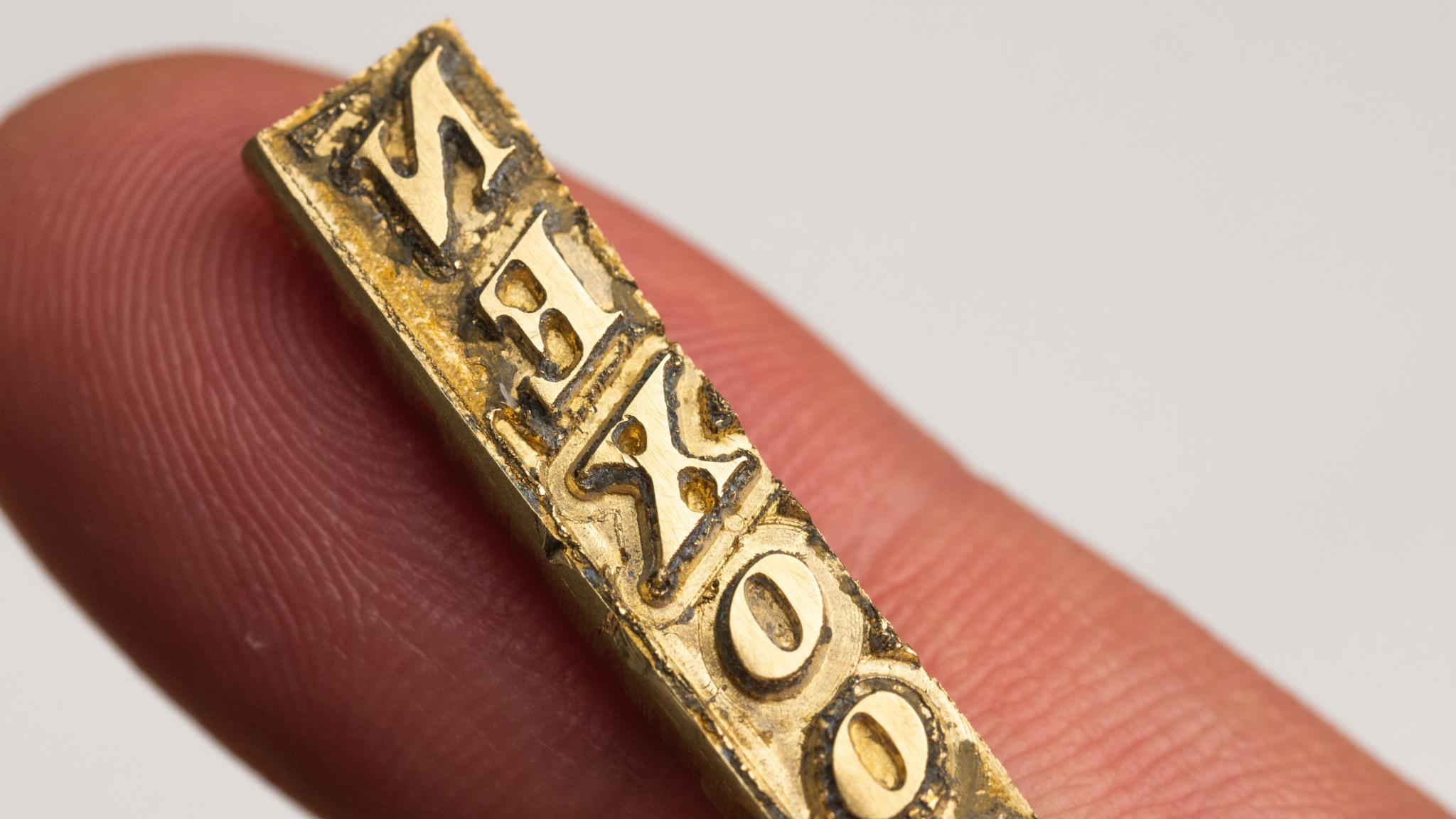

    i was able to engrave some nice fine detail on my 3020 Omio CNC, as you can see its nowhere near perfect but definitely usable for hot foil stamping. Im afraid the 3018 are far less rigid than even the entry level machine I have.
    CNC: OMIO X4 800L
    HG15+20 Linear Guide Rails
    1605 Ball screws
    0.8kW Air-cooled spindle
